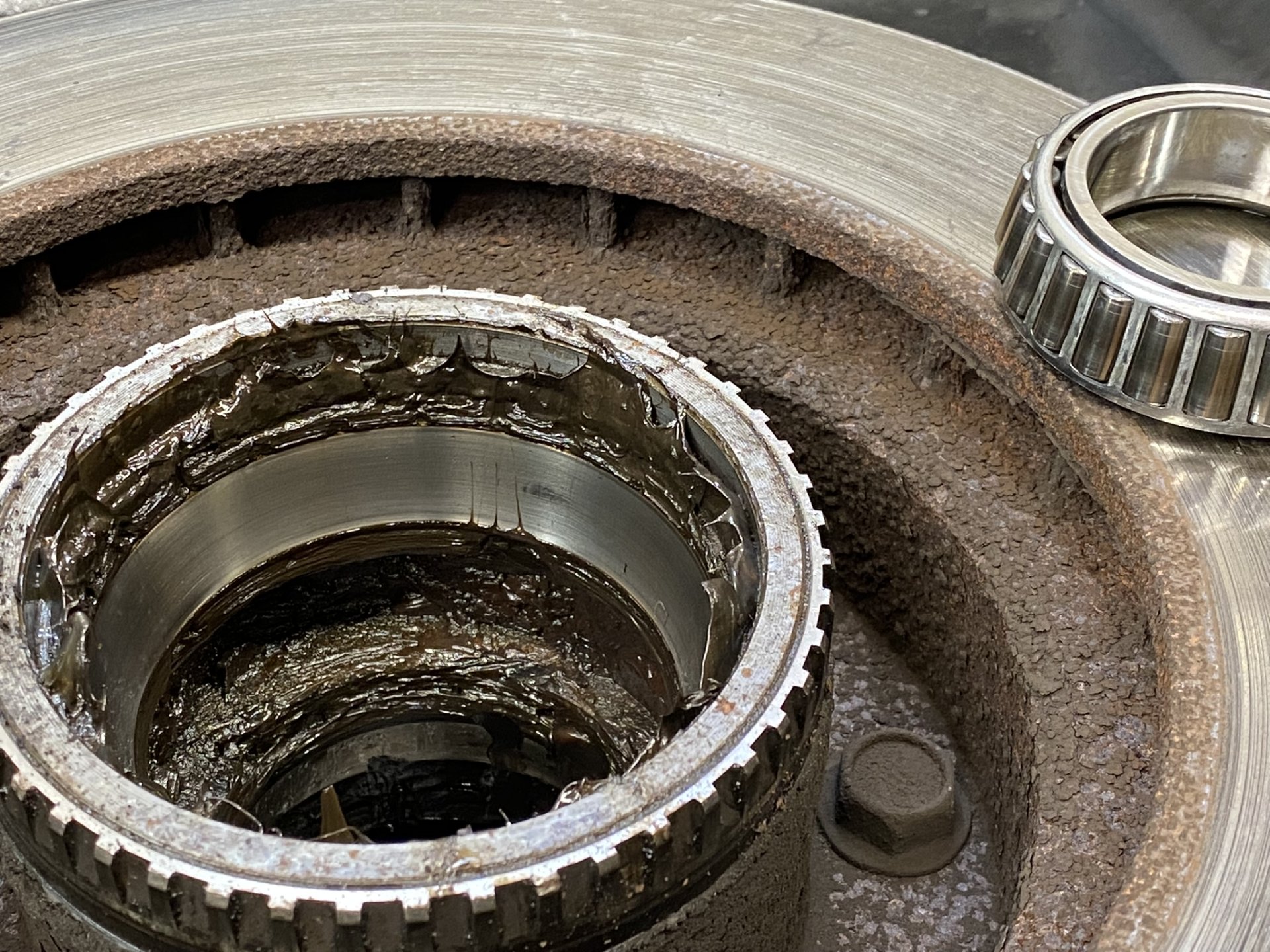

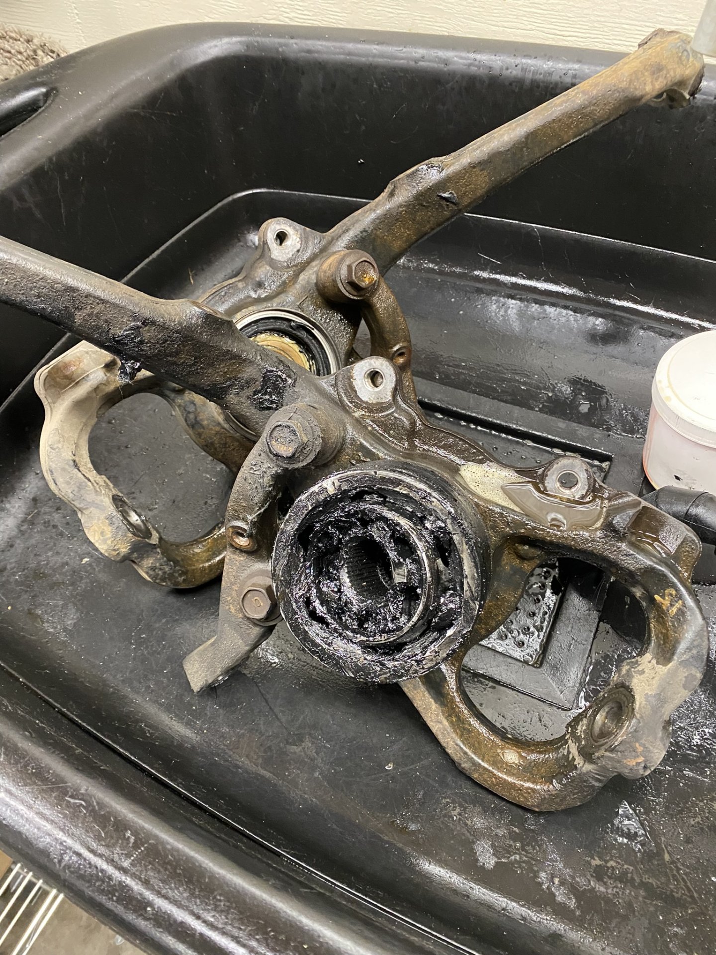

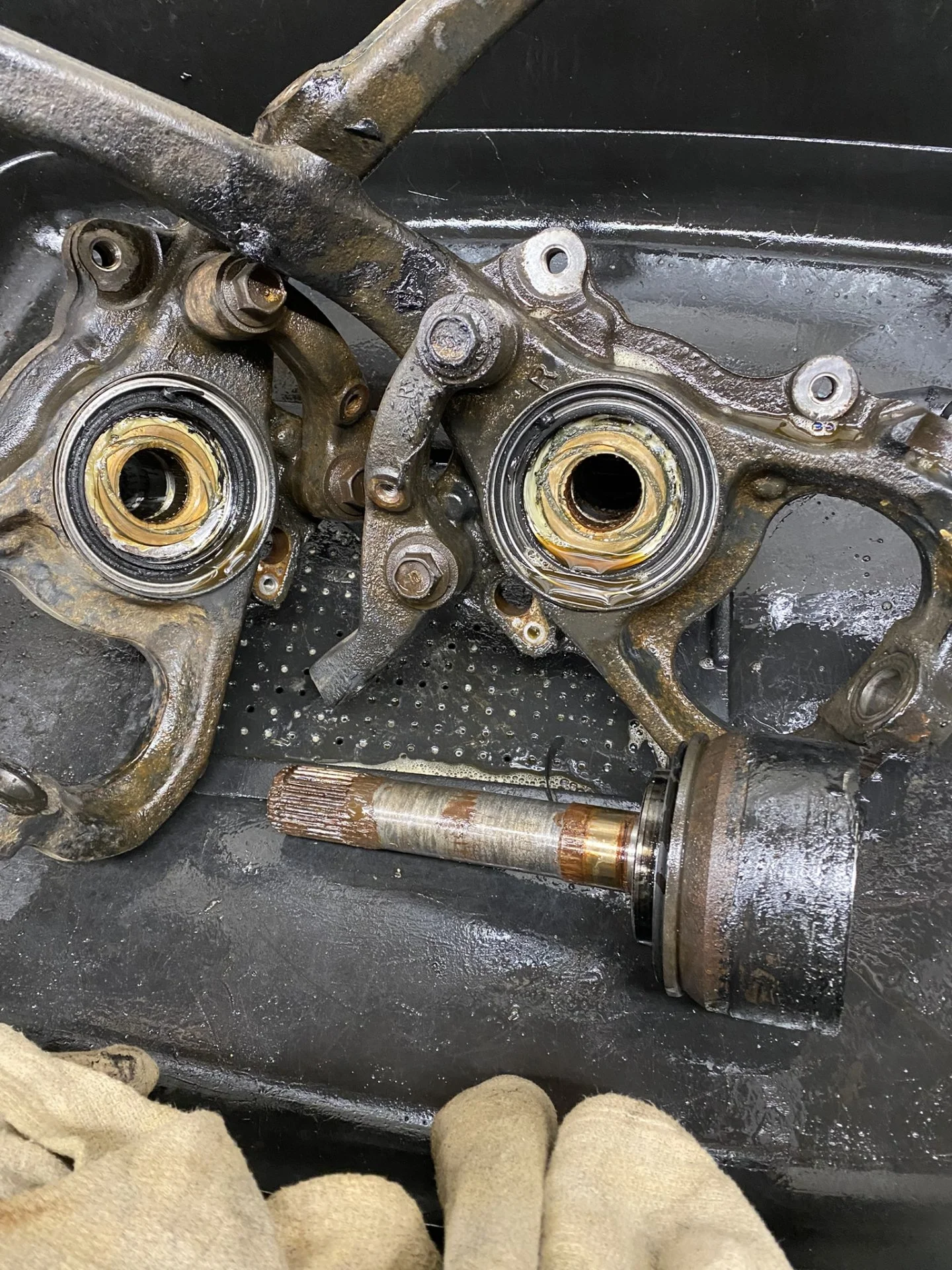

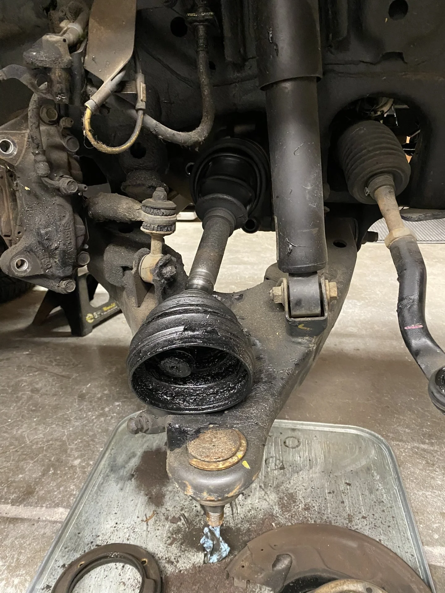

She was limping coming in the shop, with busted aftermarket FDS
Hard to say if it was aftermarket junk FDS. Or very improper wheel bearing service, one where wheel hub cavity not filled with grease causing bearings to over heat. Or combination of. That resulted in busted Front Drive shaft outer tulip (FDS, AKA: CV). The axle pulled itself from the outer CV. The outer CV bearing and cage feel frozen in tulip.
Grease on axle discolored. That brown indicates water entry. Not supersizing, as grease cap nearly fell off in my hand.
No grease was in cavity. I can see someone wiped out most of old grease, but failed to clean or repack cavity. Lucky it was older woman driver, that apparently was not or no longer going on cross country trips. Otherwise these wheel bearings would have gotten so hot, with HWY speeds. They could fuse the axle and hub flange together. Which we saw this happen in a mud posting a few years ago.
Bearing is a bit discolored from heat. I'd reuse but it a bit scored also. The outer bearings are made in Mexico. Inner are from Japan (Koyo) which may be factory installs.
That is small outer bearing side to side after I cleaned it. With back side look in wheel hub cavity and inner large race. Wheel hub cavity is just as I found it.

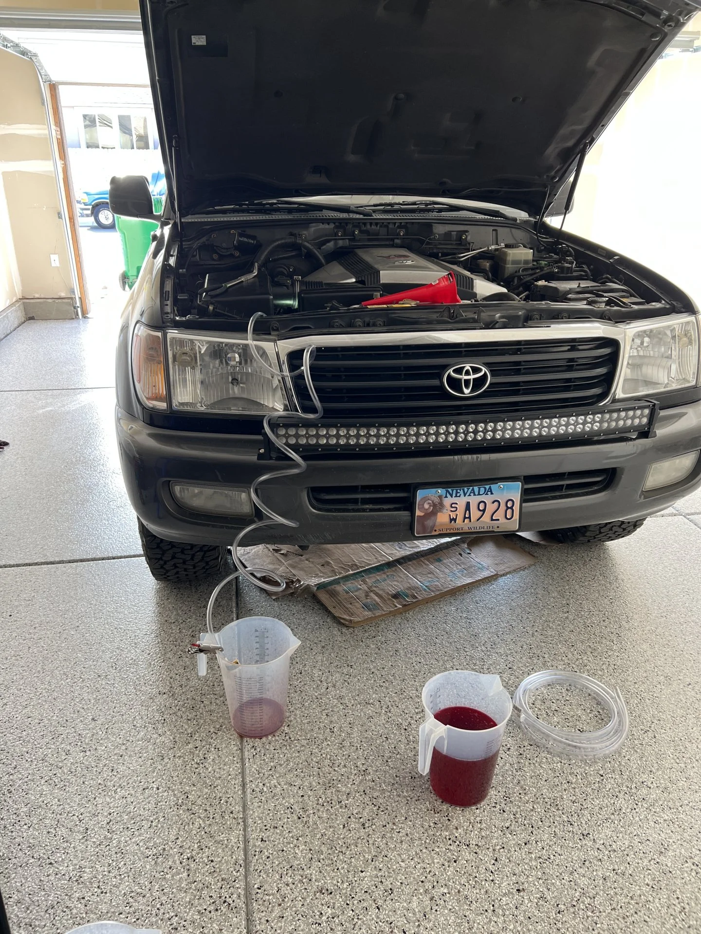

This is so incredibly helpful! I am finally getting around to doing the transmission flush on my 99 and I was just wondering how fast the pump moves the fluid through? Seems like it might be really difficult to keep up with it if you have to go stop the car, add fluid, start car, stop car add fluid etc....Or do you have time to open a bottle while the prior bottle is almost pumped through?
This seems like one of those things that you do the first time and make a huge mess and possibly run your transmission dry. The second time it's easy peasy.
This is a wonderful write up for the transmission exchange procedure. Thank you, from someone who has not done any type of work on cars before other than oil changes. Looking forward to more of the PM guides.

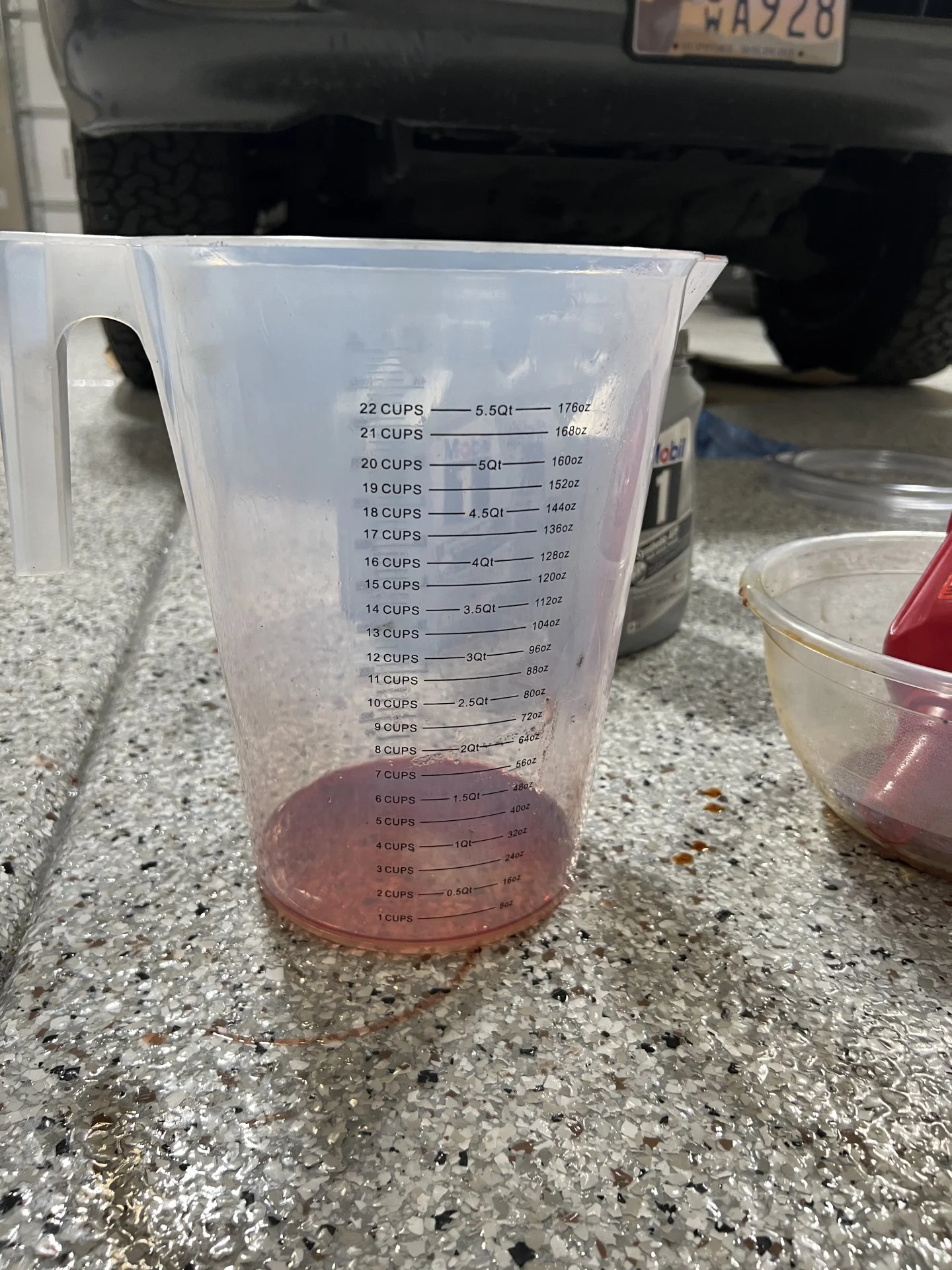

I have not much to add other than these 5.5 qt hugs from Amazon (come in packs of 3) made the process easy. I highly recommend for anyone going to tackle this job
Please provide a link or more description, such as brand name…
Step 3) Next is to remove dip stick and place transmission funnel in it's place. Then add back the same amount of new ATF as was just drained from pan. It is fine to overfill pan at this point if you like.
How fast does the fluid come out, and what diameter of clear hose are you using?
I plan to start the vehicle, and then just be ready to dump a couple quarts in as 2 quarts come out. I plan on doing mine just a couple quarts at a time until I've replaced 12 or so quarts. I have a perfect 2 quart measuring jug, so that' s just how I plan on doing it.
IDK the hose diameter. Just grab one that fits, out of box of various sizes.
I usually get in about 1, as 2 come out while engine running. Then add in 1 while engine off. I start with transmission at least 1/2 qt overfill. I end with transmission 1/4 low, than top later in the 98-03. 04-up I end with 1/4 to 1/2 qt over.
AT/fluid temp:
98-03 158f to 176f
04-07 97F-115f (AT1).
I usually get in about 1, as 2 come out while engine running. Then add in 1 while engine off. I start with transmission at least 1/2 qt overfill. I end with transmission 1/4 low, than top later.
Wow that’s coming out fast. Thanks
Comes out fast and pressurized- use a Home Depot bucket or something with tall sides to minimize splash- fix/clamp the hose against the inside of the bucket-
Don’t try to drain too much as once - it will run low and you get air in the circuit - just do brief intervals - even better if you have a helper to shut the engine off while you monitor how much fluid is draining out-
