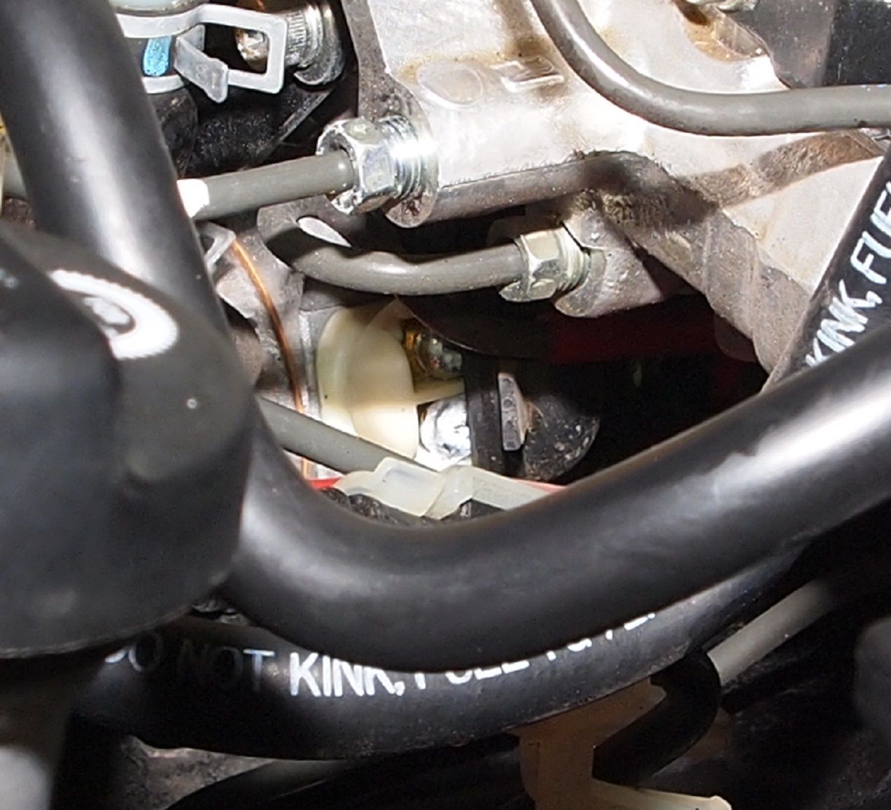

One of my newer inspections, I also checked the "control wire" on the brake master.
It's the wire from bottom of black plastic ABS unit to booster motor.
It looked okay. No corrosion!
Had I found these corroded, I'd R&R and inspect booster motors commutator.

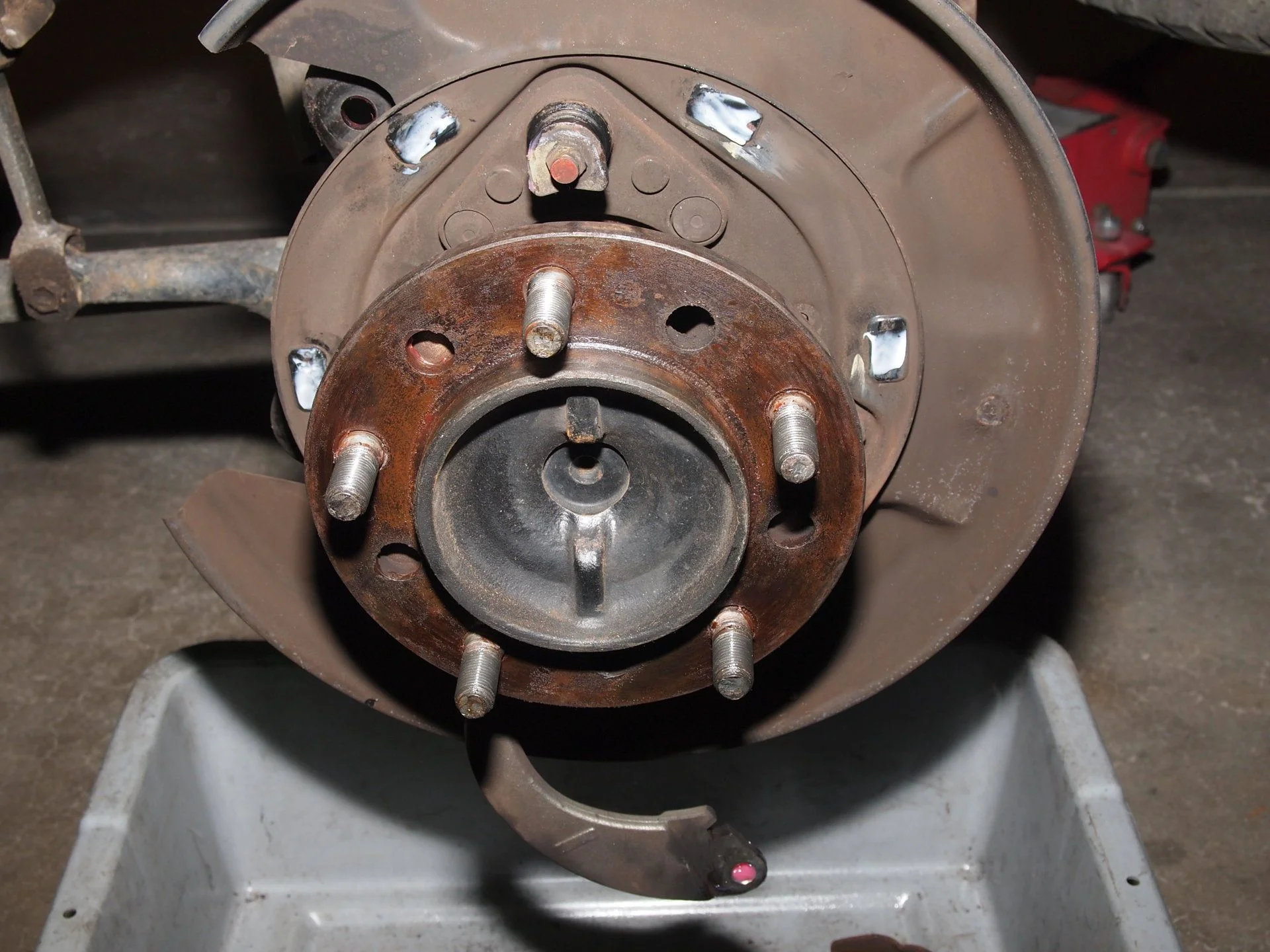

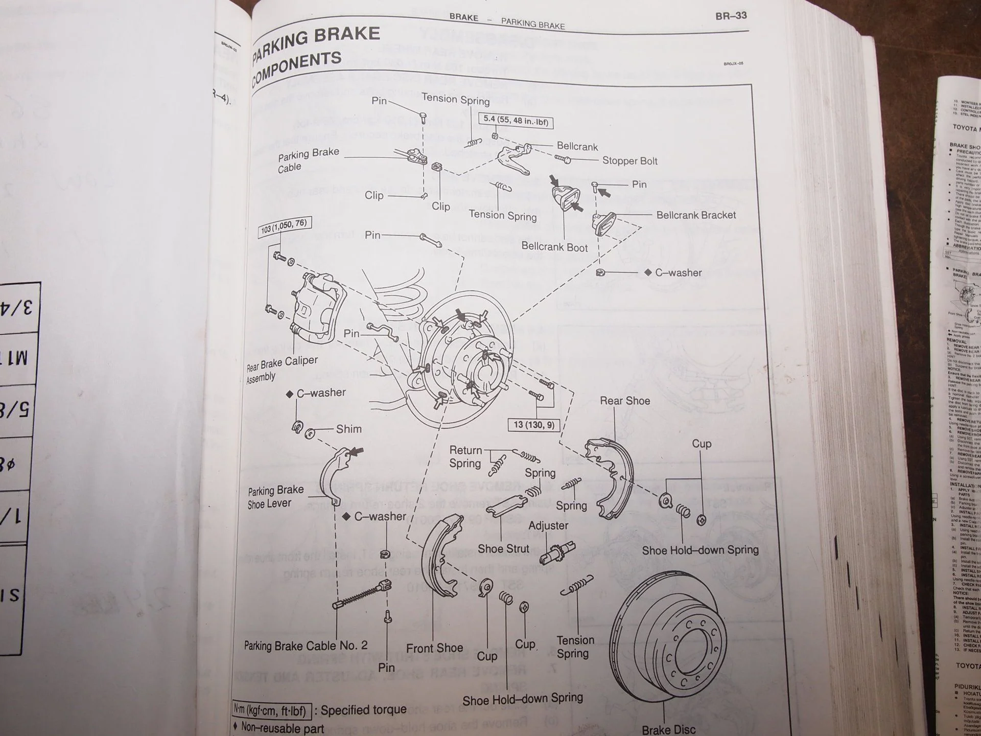

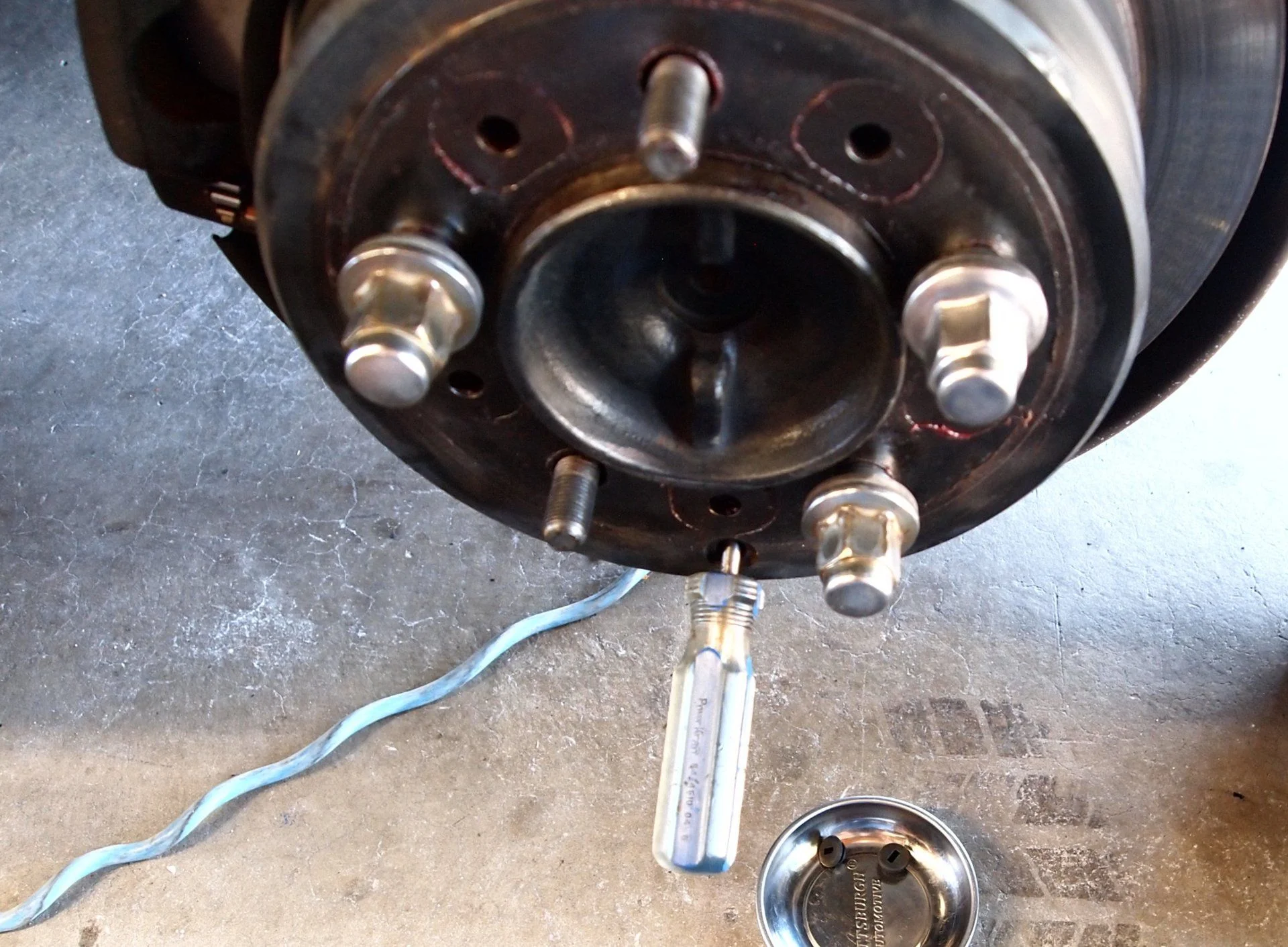

To remove rear rotor. Back off park brake shoe adjustor, first. See post #90 below.
E-brake shoes barely held the vehicle from rolling. I had to pull it's handle so hard, my GF couldn't release. Found pads very bad condition. Thickness was okay, just the pads were kind of crumbly and glazed. So I swapped them out with new OEM shoes.
Used some of the very pricey Toyota brake grease on backing plate

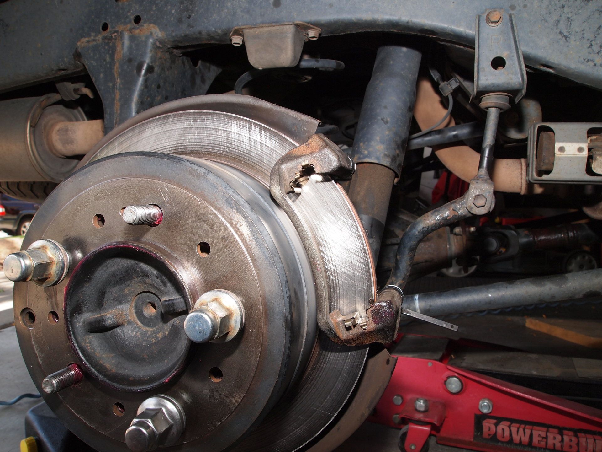

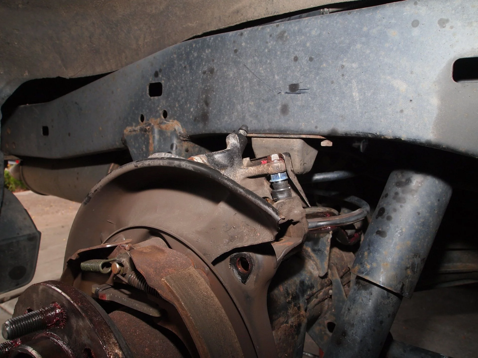

With near 20 years and ~350K miles on calipers, I decided to rebuild them. While working on them I noticed the backing plats or dust shield are bent. I work to straighten them the best I could. I suspect I may be getting a little rub on rear disk/rotors and wheels from them.
RH Rear

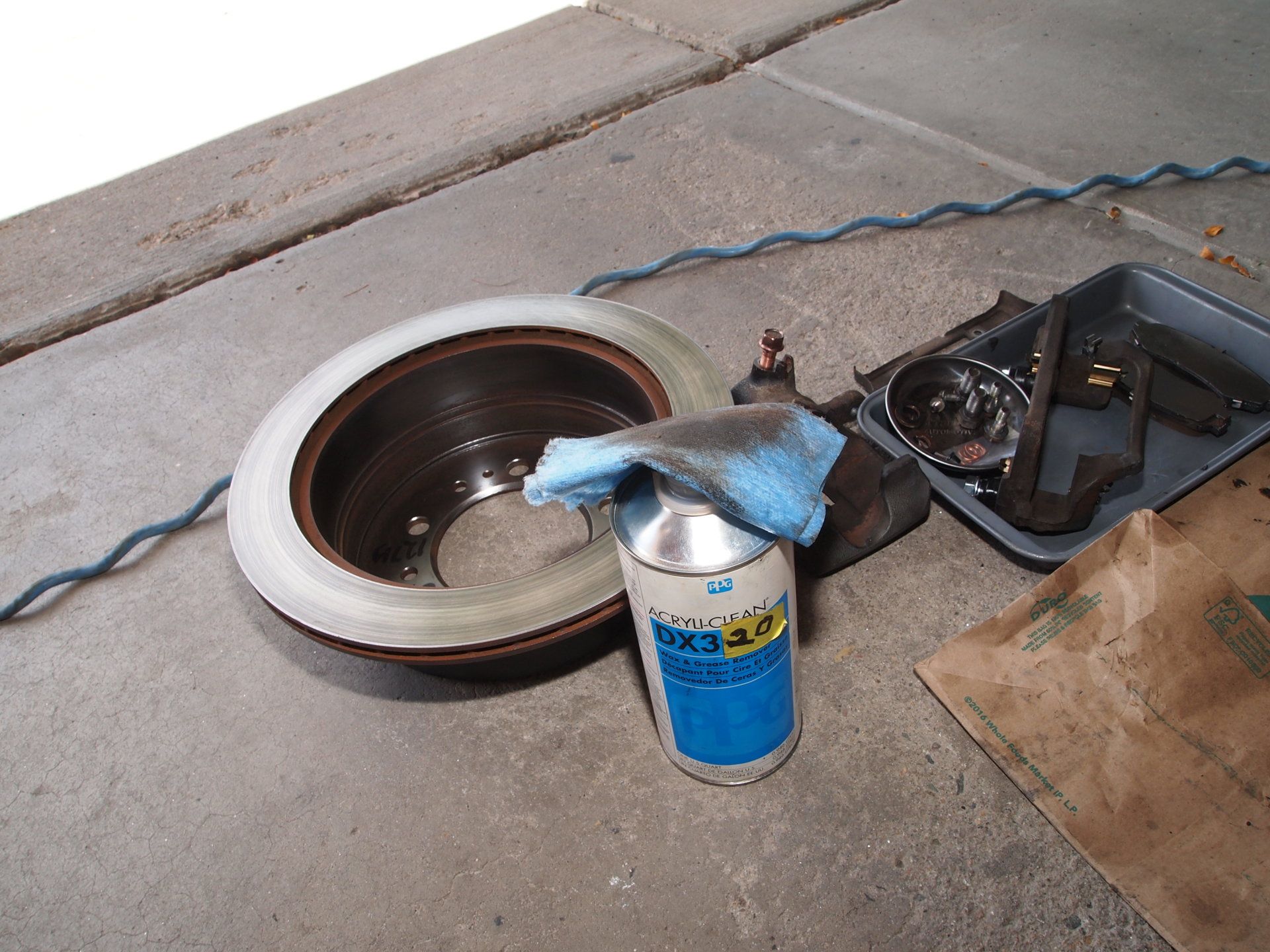

Sanded disk at angle creating hatch marks, to remove uneven glaze and rust from seating park so long.

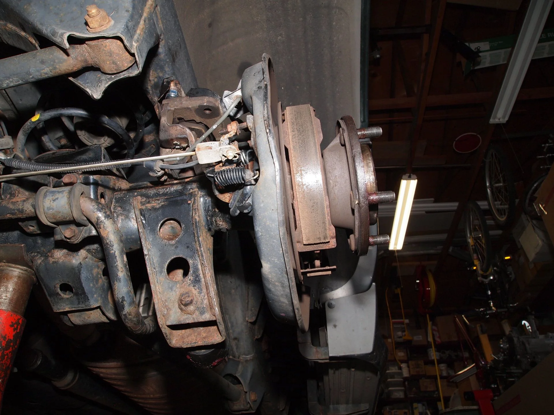

LH Rear.
As with RH rear I start by backing off e-brake adjuster, before pulling off drum/rotor.

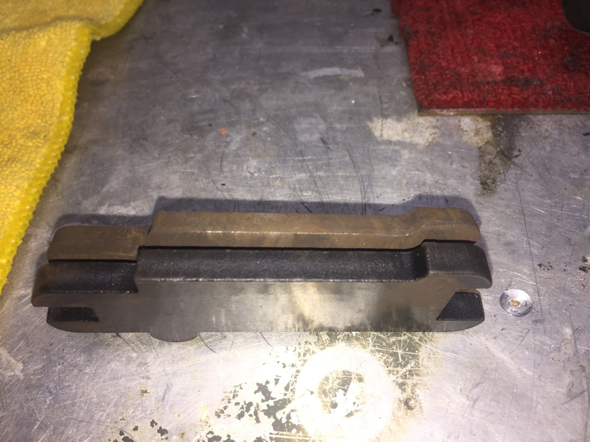

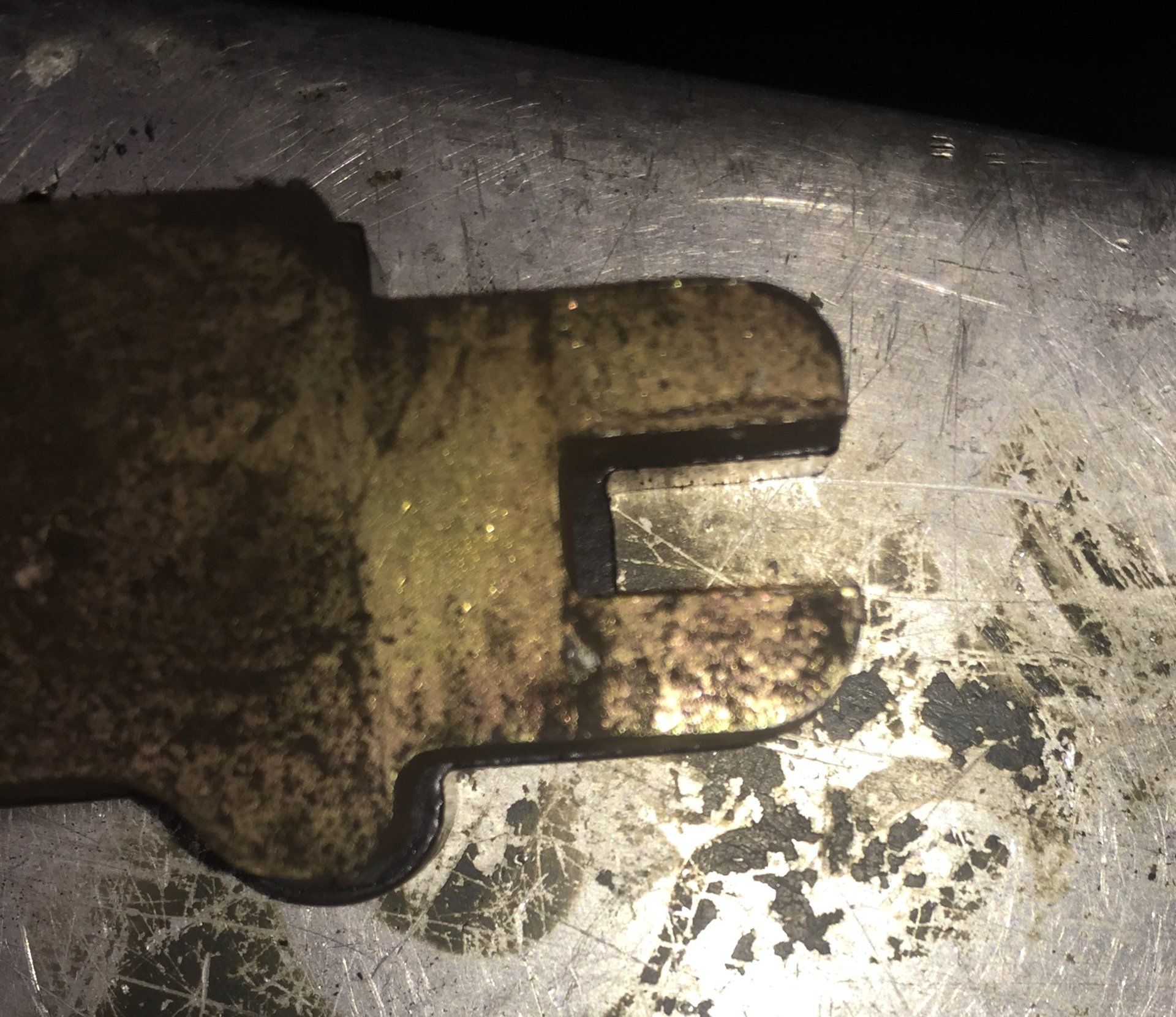

FWIW- There is a different dog-bone available that better positioned the shoe more evenly (makes the brake shoe expand more evenly) for better grab- holds it much better from rolling forward. Its a miniscule difference between the two parts but it does actually make a difference.
Interesting. "dog bone" (aka shoe strut) where did you get those?

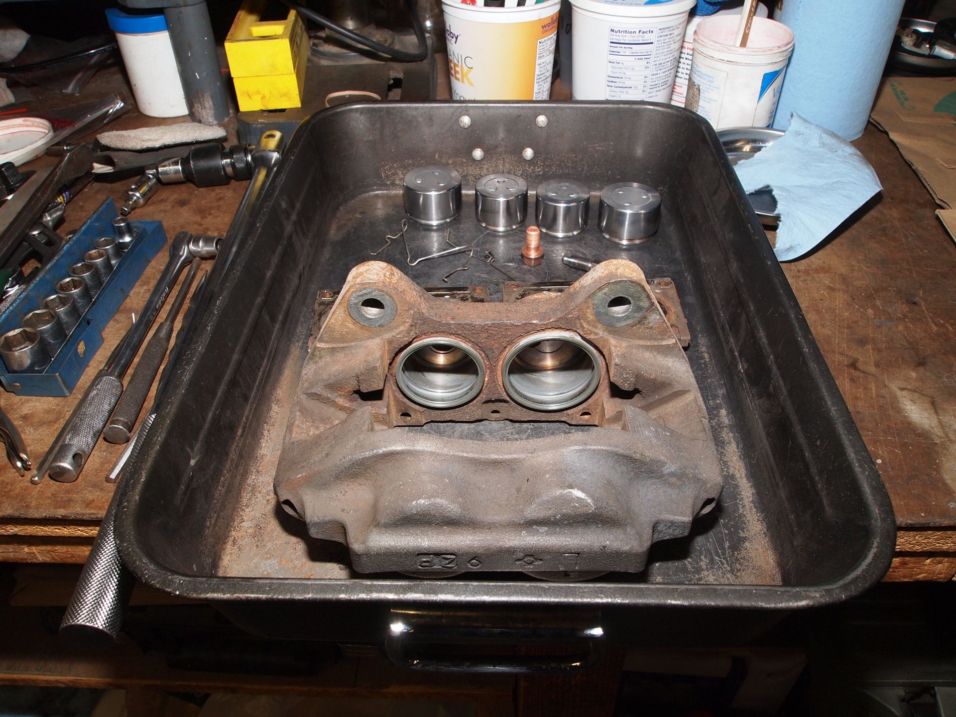

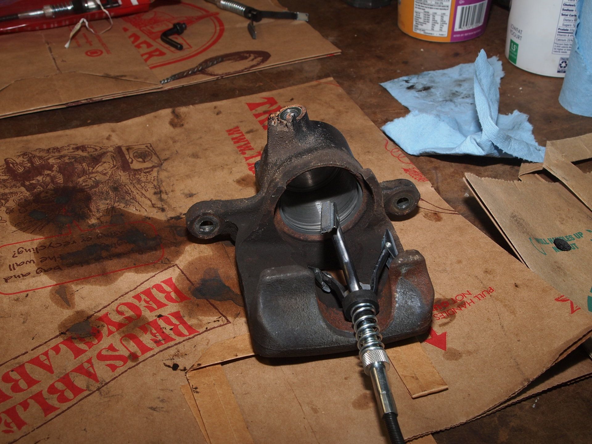

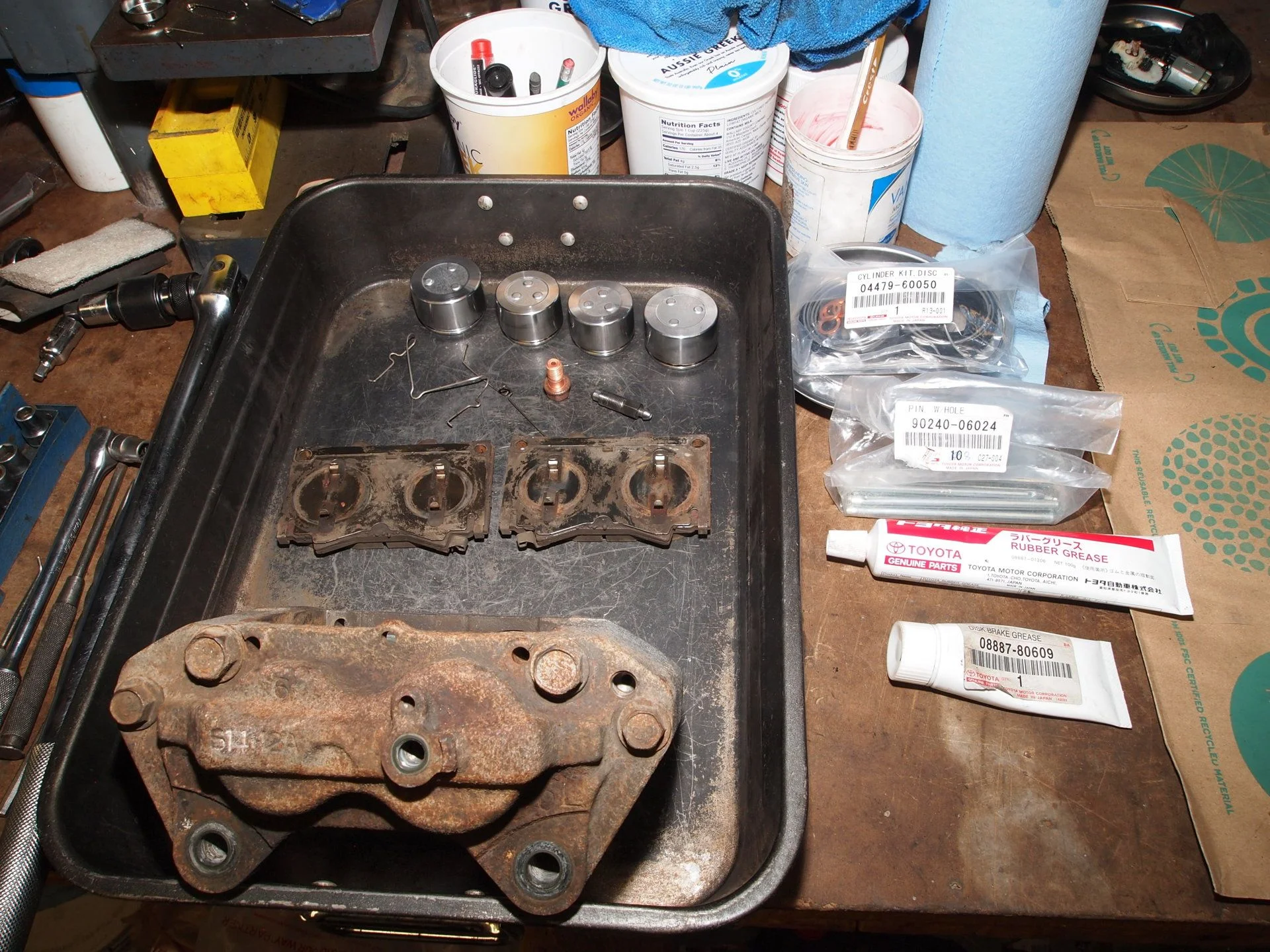

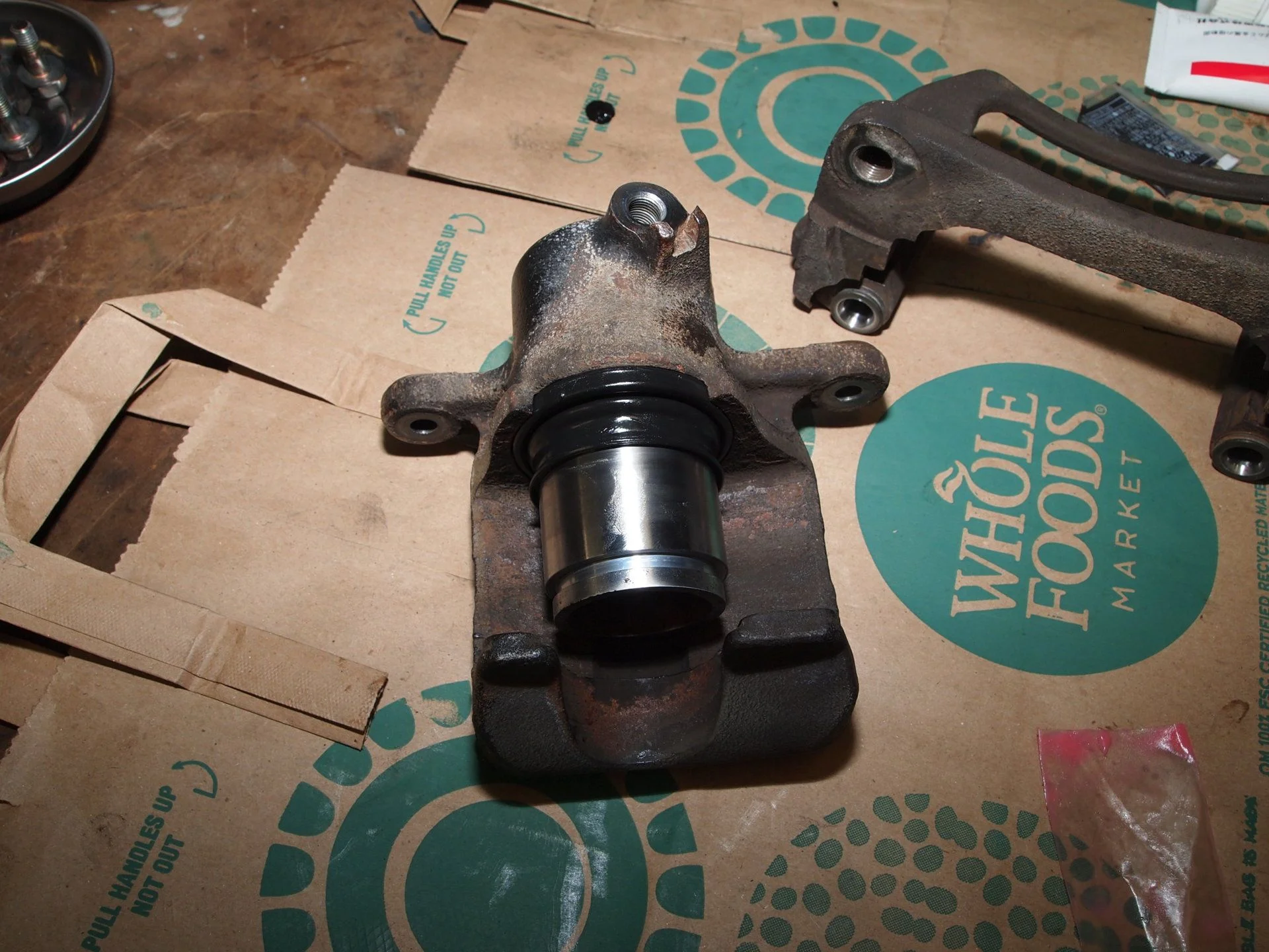

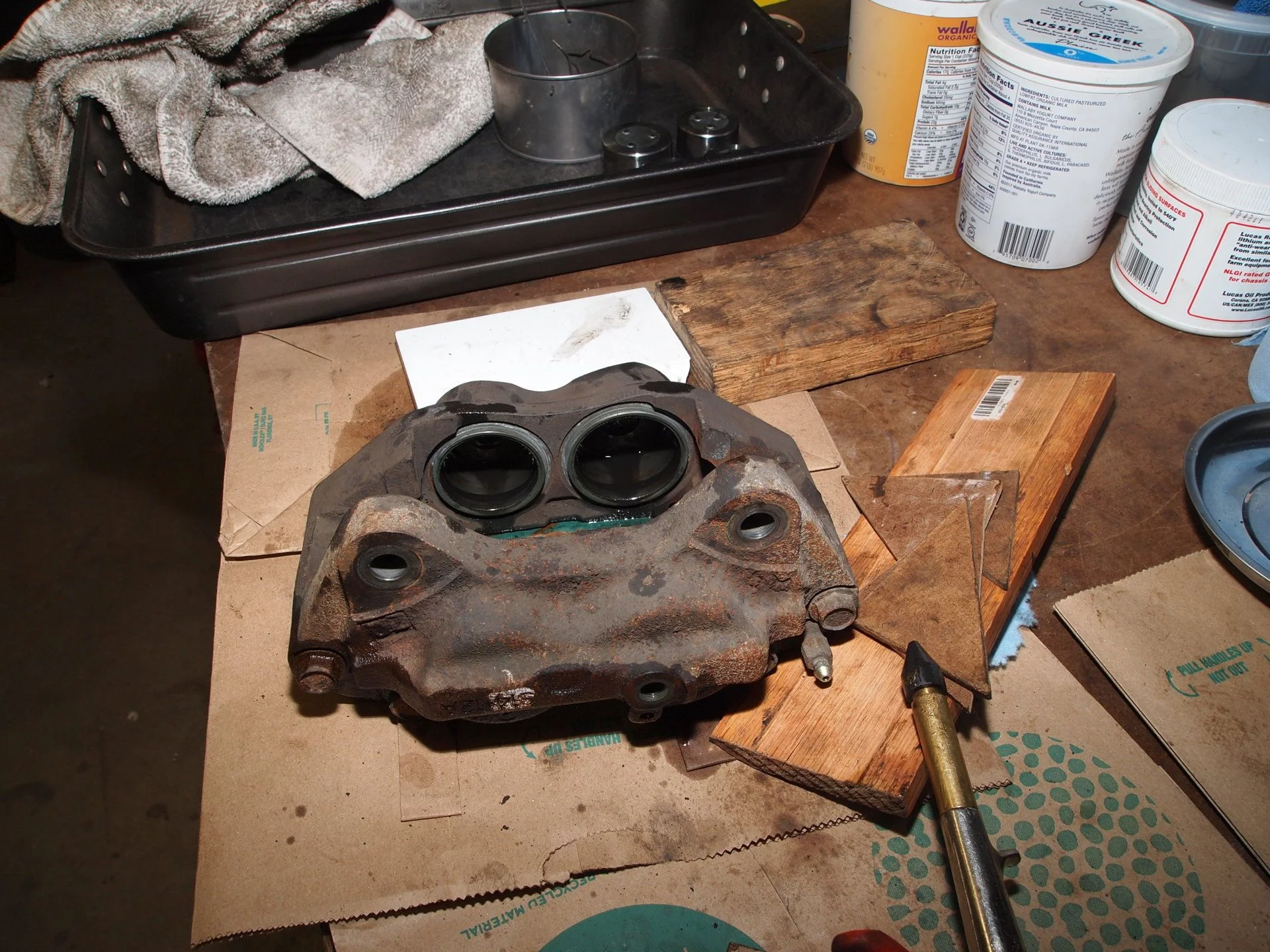

Front caliper.
HP air is used to blow out pistons. Wooden blocks are placed between pistons, to keep from damaging them as the pop out.

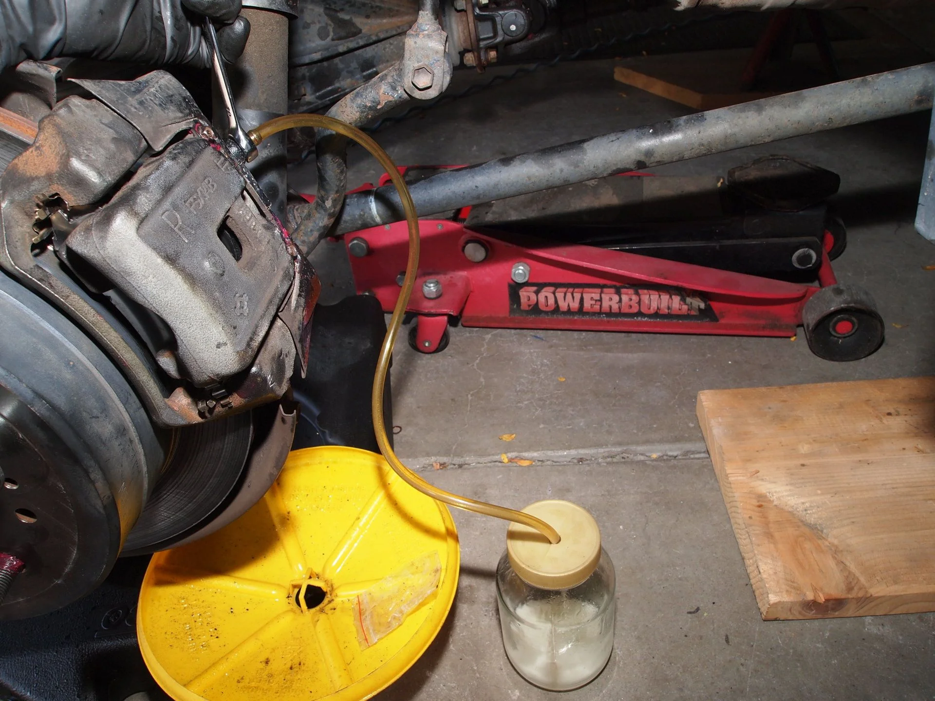

Bleeders are in surprising good condition.
Honed, cleaned and ready for assembly

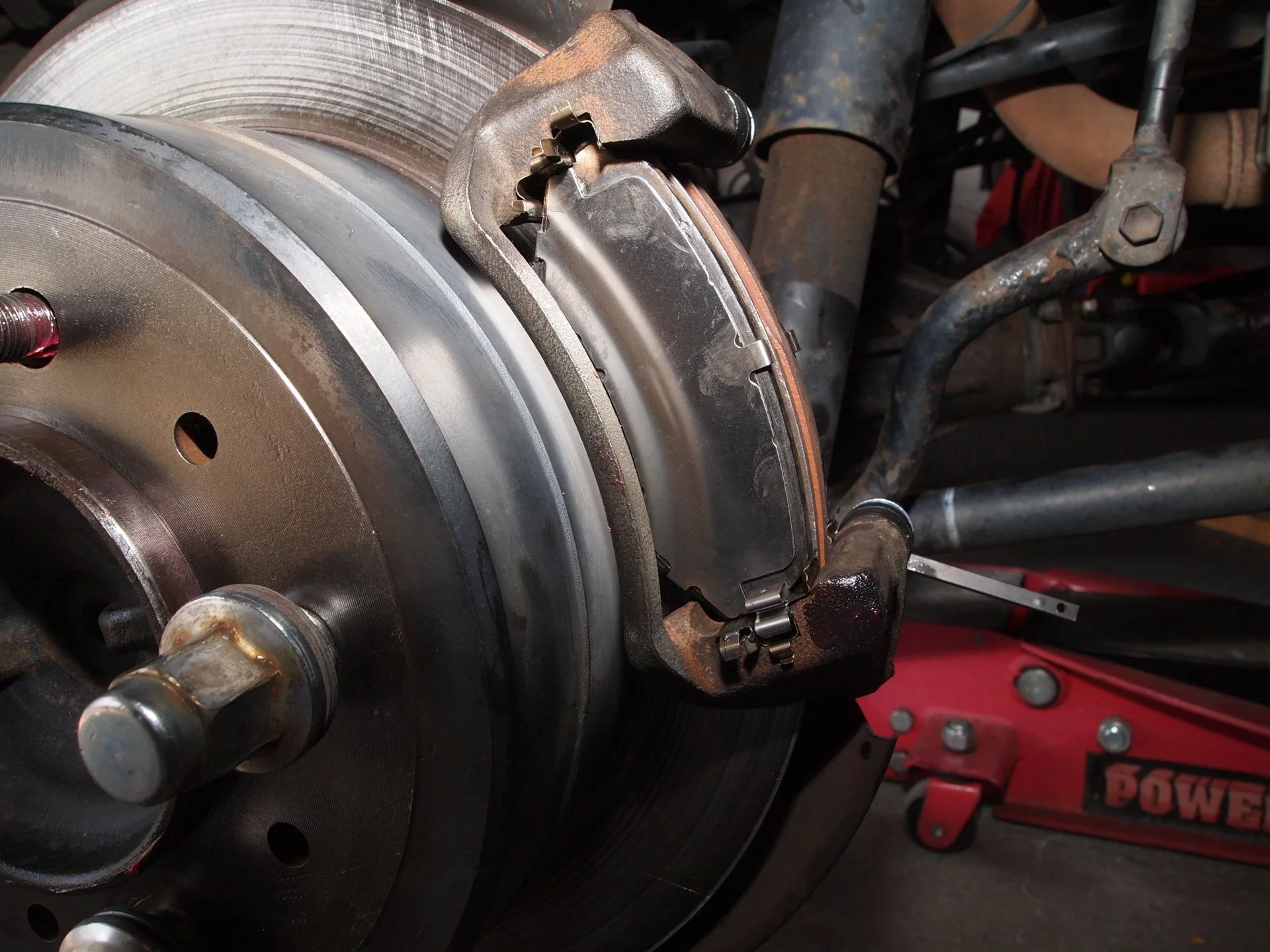

All the pads, shims and rotors were good. They just had some rust and glazing on them. So I reused after sanding pads and rotors. I then re-bed them on first drive.
Flushing is next.

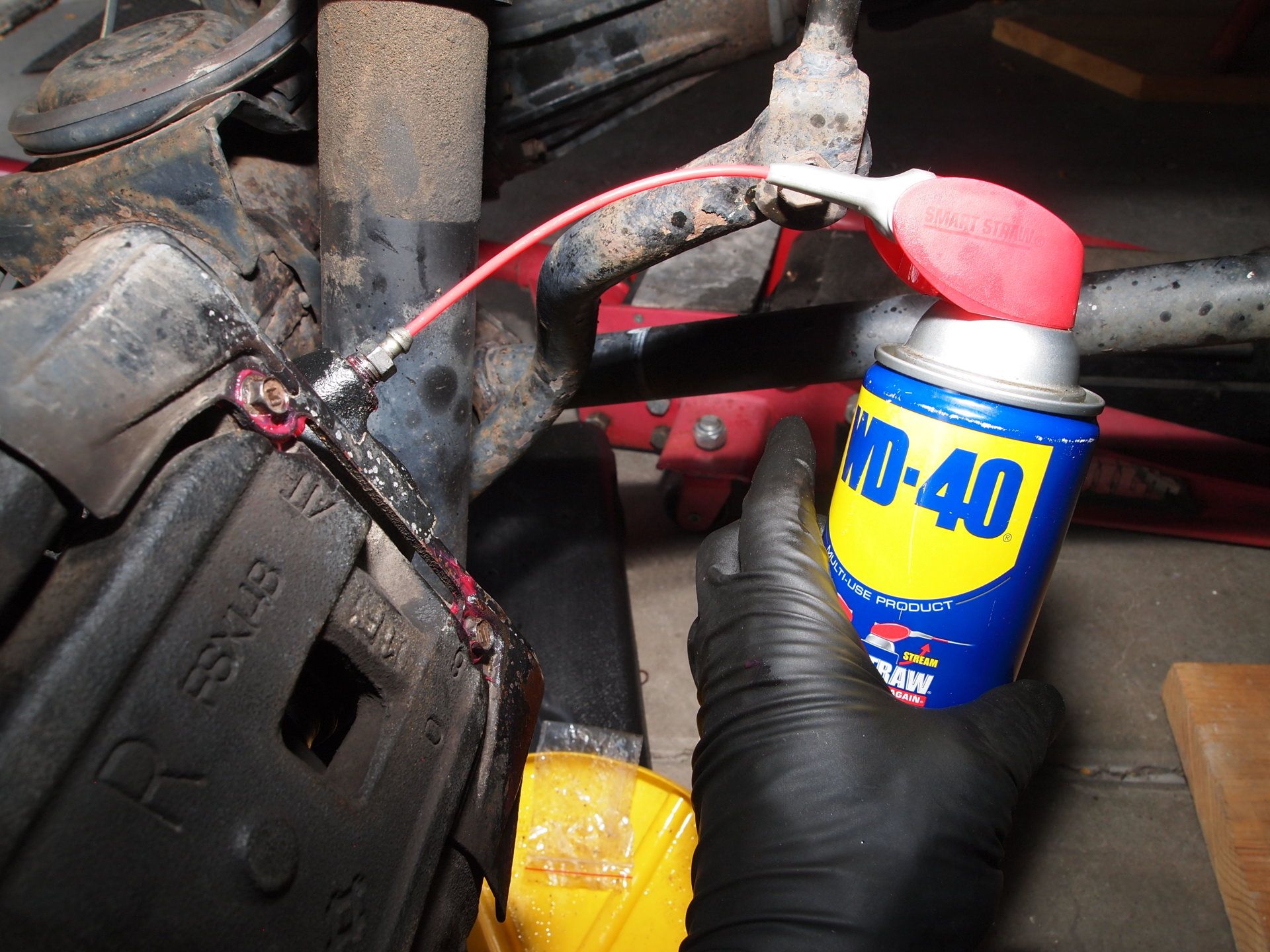

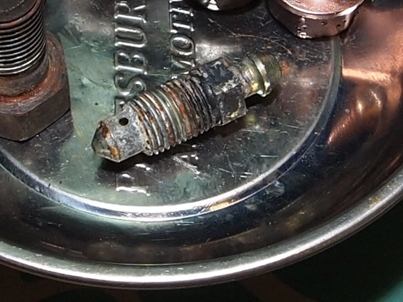

After flushing or bleeding I tested for leaks. Final step is blowing out the bleeders. I like to get the brake fluid out of them. Brake fluid is hygroscopic. If brake fluid remains in bleeders, it may promote rust by absorbing moisture. So I blow out with air, then WD40 or brake cleaner then air again. I then let set exposed to air to dry before capping.
Bleeder Caps:

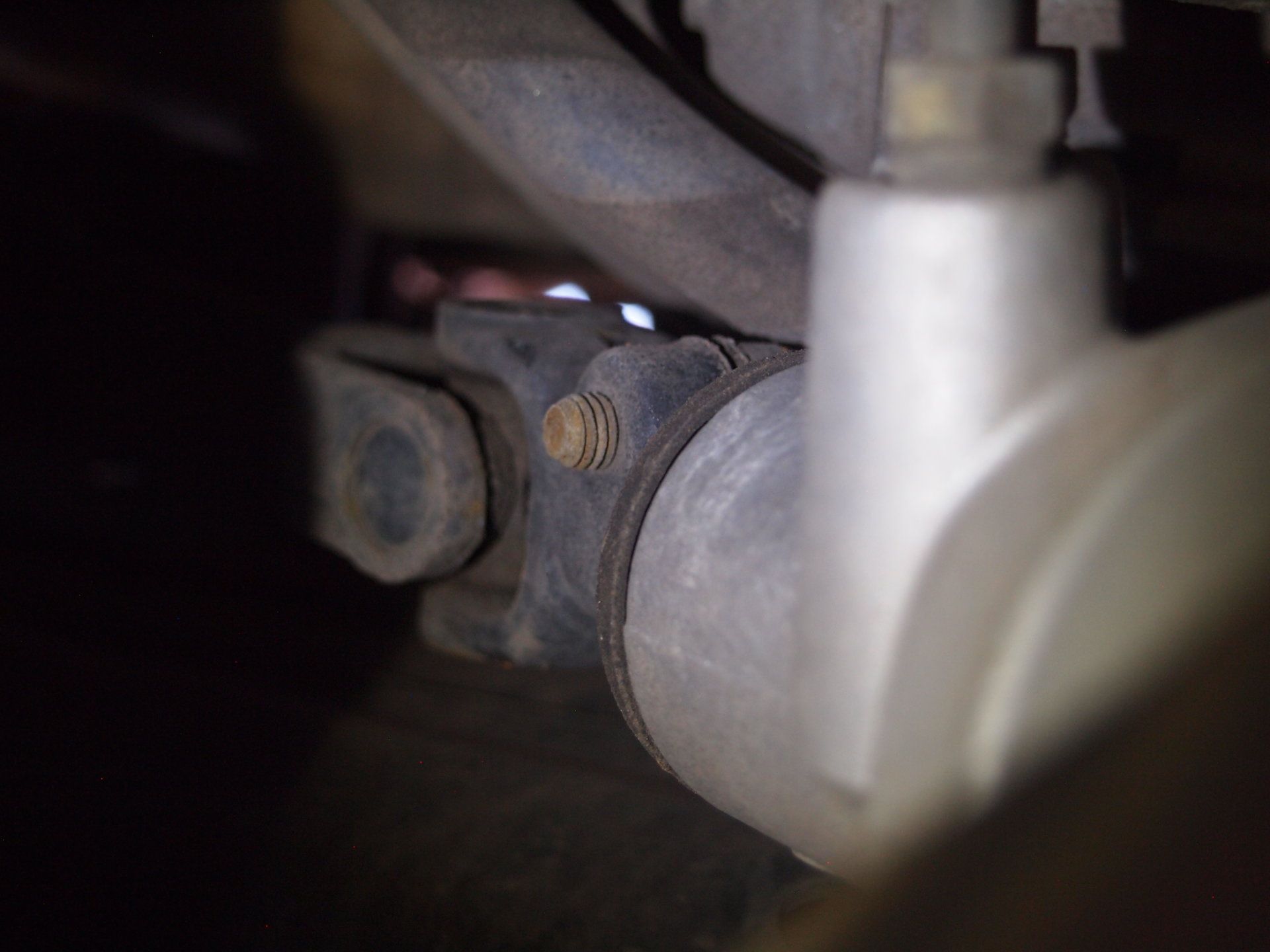

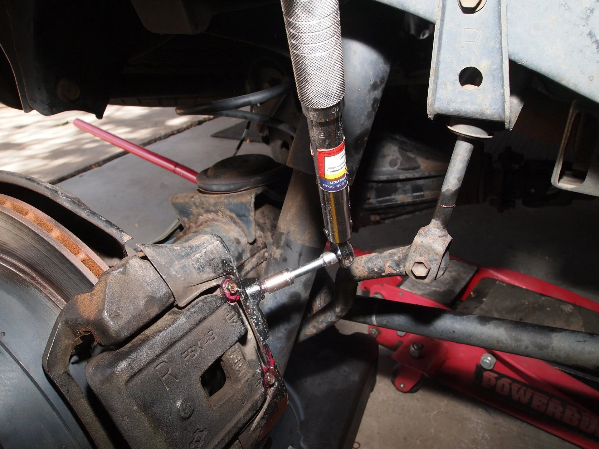

I so often find bleeders rubber caps missing or cracked. The moisture gets in bleeder and causes corrosion. The bleeder become plunged best case. They can also become frozen in and weakened, then break when trying open/removing. Worst case, if the corrosion gets bad enough it will damage seat in caliper where bleeder seats. Then we end up with a bleeder weeping during normal operation. The weep or leak causes booster pump to run way to much trying to keep up the brake fluid pressure. This leads to brake pedal fade and may prematurely wear out booster motor. If caliper seat is damage, it must then be replaced. All because a good bleeder cap is not maintained on the bleeder at all times. This is especial true of rear calipers, due to angle bleeder sit at.
Tip: Check your bleeder caps!

I do not replace if they clean up good and seat is not damaged. But if they weep even after I torque a little extra, up to 12IN-lbf. Then I replace with OEM only. That's provided it is an OEM caliper. I see aftermarket bleeders weep to often. I keep some OEM bleeders on hand. Both fronts which are longer and rears just in case. I also keep some used on hand. They come in handy to plug caliper when I pull bleeders to recondition.

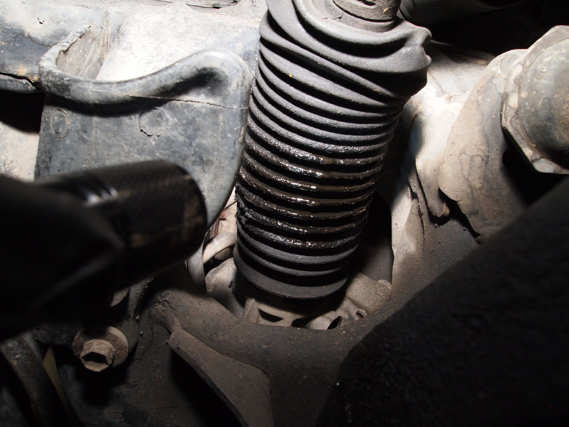

Boots, if wet, tend to keep weeping even after leak stops. They just are full of fluid, so takes a long time to dry if ever. So I use reservoir's level as my indicator.

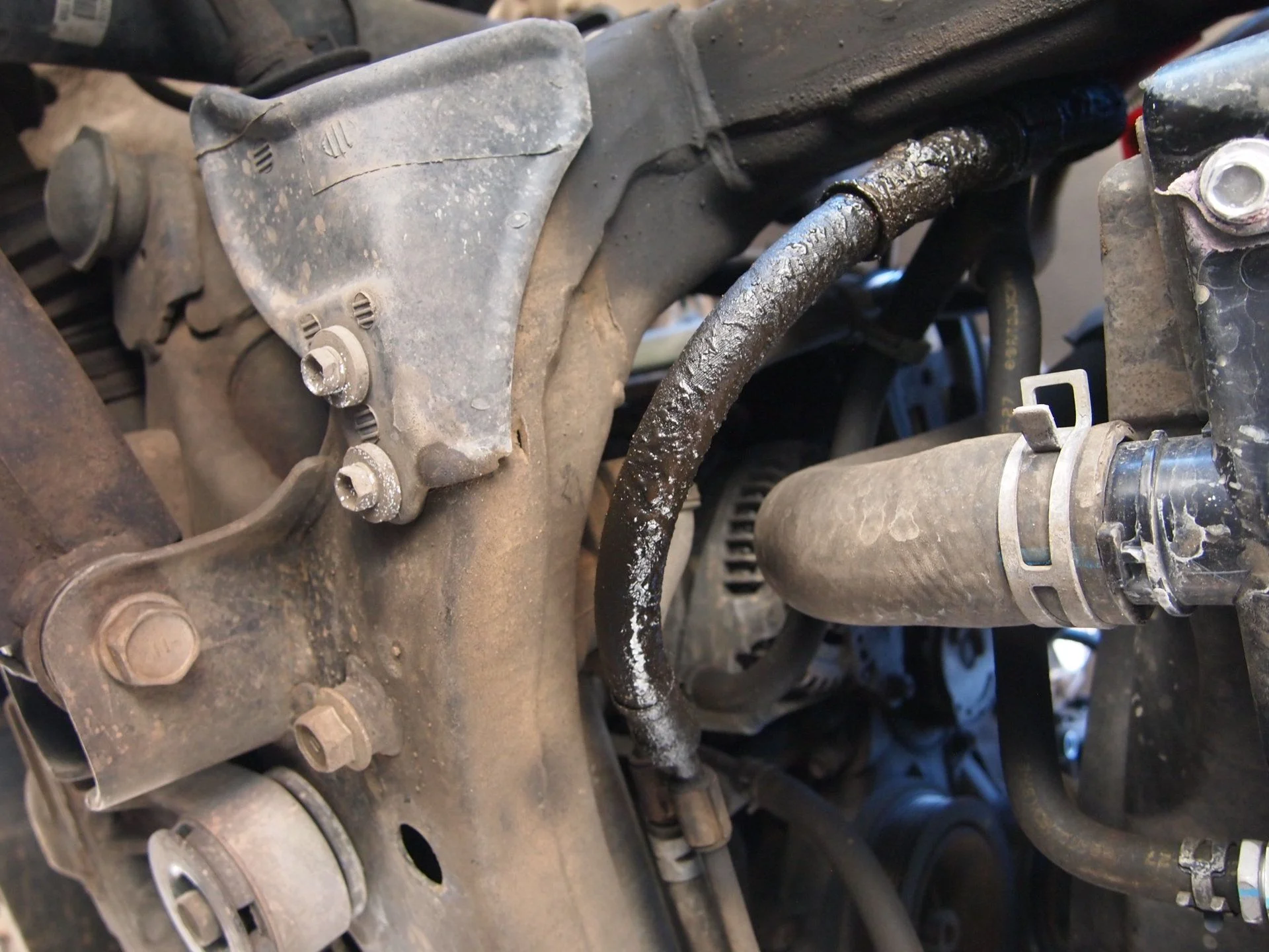

Another leak I see about 1 out of 10 inspection. Is the flex hose portion of high pressure line.
I clean really good than watch, just like all leaks. Then tend to weep, so must be watch close.
