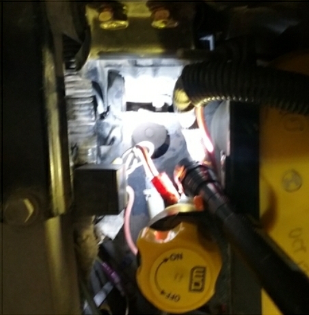

In that case, tomorrow will be the day that pull your battery box in order to get to the DS lower bracket bolt, and will find that the round, circular depression in the bottom of the battery box you've removed is the perfect place to drill a 1.5" hole which will allow future-you to change the radiator in about half the time, using that new hole to access the lower bolt with every extension you own hooked together.
You're welcome, present-day-you!
