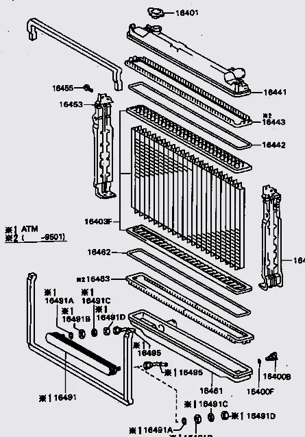

Yeah this is all valid, but the radiator portion of the cooling system in the cruiser is also designed to be “sealed” around the edges. When I did mine, it made a difference.
The factory radiator had closed cell foam that you may have some remnants of sticking around. I’ll see if I can find some photos of it, but it came pre-installed on the factory radiator for a while, though not anymore. Lot’s of folks just pick up weather stripping at a big box shop and use it. The purpose is to push as much air as possible through the radiator rather than letting it leak around it.
Foam Discussions
Another
lots of good points here, although the waterpump is very unlikely the culprit unless somebody put a very low quality aftermarket one on that isnt designed right or something. One of the most common things I is the foam missing around the radiator, its very likley they just put the new radiator in with no foam on it, should have some on the top and bottom and this forces more air though.
No foam around the radiator.... Any ideas of where to get it?

You can use whatever foam you feel comfortable with. I'd go with higher quality and resistance to heat/uv/etc. so that it lasts longer and is less likely to break down. The foam isn't exposed to too much though so quality may not matter that much.
if you
it comes with a genuine radiator, napa sells different foams and I'm sure hardware store do also. Make everything really clean before trying to stick it on. sometimes I need to use some superglue too.
here's a diagram of the foam try to make it look like that. the piece on the bottom is even taller then it looks in the picture.
