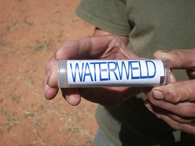

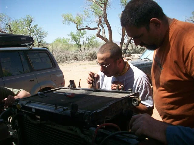

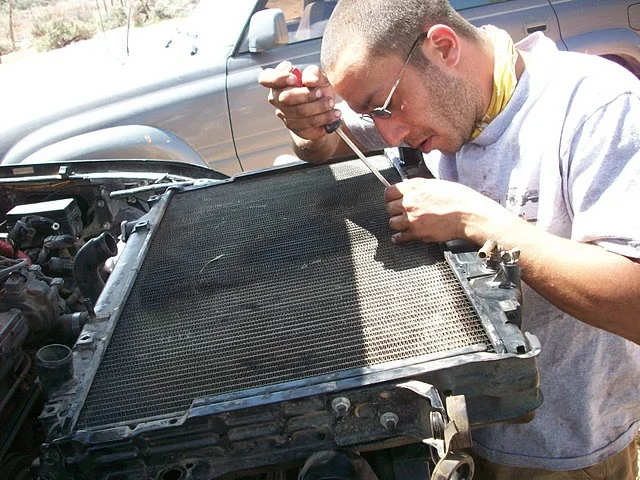

Ironically, I fixed my radiator with some epoxy in the middle of nowhere Utard with the OP @alvarorb many years ago… 2008? IIRC.
In a knarly sandstorm…. There he is in all his bigness!! 😂😂 (Damn, I was fũcking 33 in this picture; I’ll be 50 in January).
In a knarly sandstorm…. There he is in all his bigness!! 😂😂 (Damn, I was fũcking 33 in this picture).
