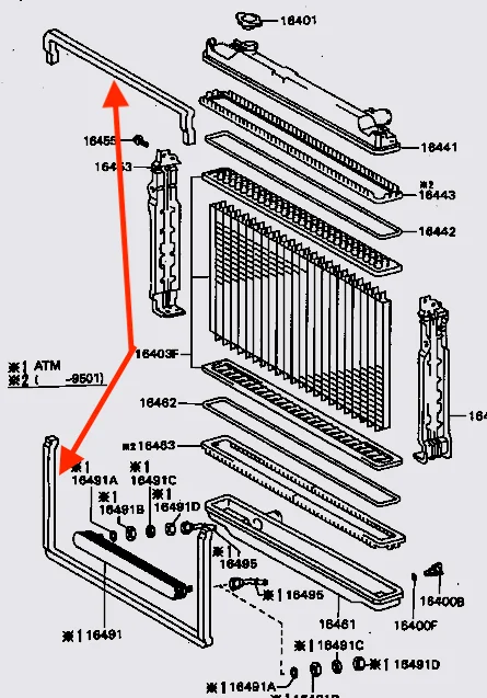

it comes with a genuine radiator, napa sells different foams and I'm sure hardware store do also. Make everything really clean before trying to stick it on. sometimes I need to use some superglue too.
here's a diagram of the foam try to make it look like that. the piece on the bottom is even taller then it looks in the picture.
I have the "OBD I" OEM radiator, which was ordered from Toyota in 2021 but did not come with the foam. The dealer parts rep said they don't anymore. There is a long thread about it here somewhere. As already stated, you can use commercially purchased closed-cell weatherstripping to fill the gaps. Any big box store or Amazon can take care of you.

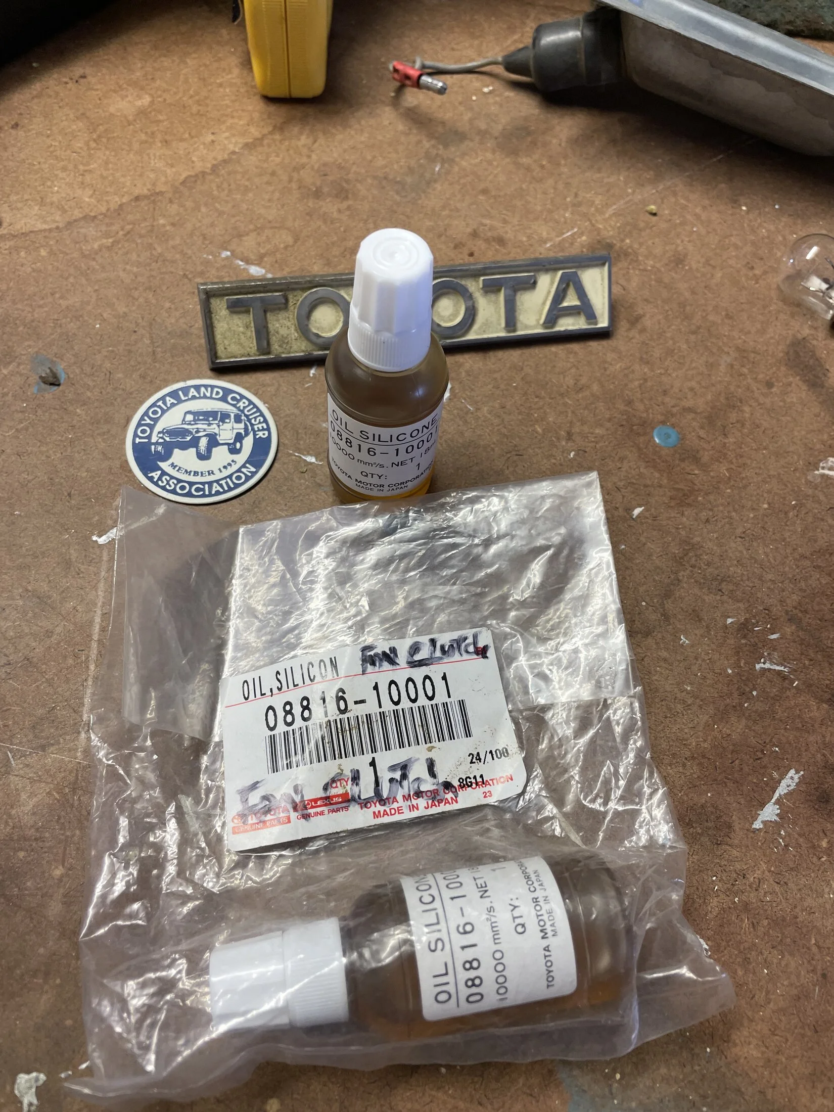

I went to my local Toyota dealer and they are out of the blue oil/silicone. I did however watch a YouTube video where the person replaces the factory oil for an oil he got at a hobby store. My dealer won't have the oil for a week. Any ideas what the oil from the hobby store is?
Alvaro, I may have some at home. Forget what thickness it is...
@jonheld has the most comprehensive list of things to look at, including the radiator cap, often overlooked. I would definitely do the fan clutch mod, including adjusting the temperature at which it begins to open, and when it's fully opened (hot water bath and a GOOD thermometer). I put (I think) 15,000 silicone in mine and adjusted the opening temps, and temps live at 190 degrees most of the time. It goes up on long crawls, but it's mostly happy right around there. Mine lacks the weatherstripping around the radiator. I'll fix that soon.
New radiator, thermostat, hoses, silicone, and weather stripping on their way. I got 10,000 cst oil.

10K is pretty good. I think I did 15K. Out of the box I think the blue hubs are around 6K.
