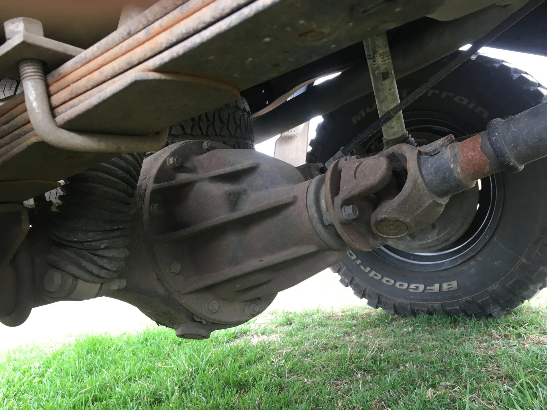

Mine is stock after the transmission to transfer case adapter.
That’s a DC driveshaft on the rear (not stock)...and a 62 3rd?
Sorry Will Van, just saw this was your thread...
The driveshaft was cut and rebalanced and yes it is double cardan. By stock I meant differentials and gearing.

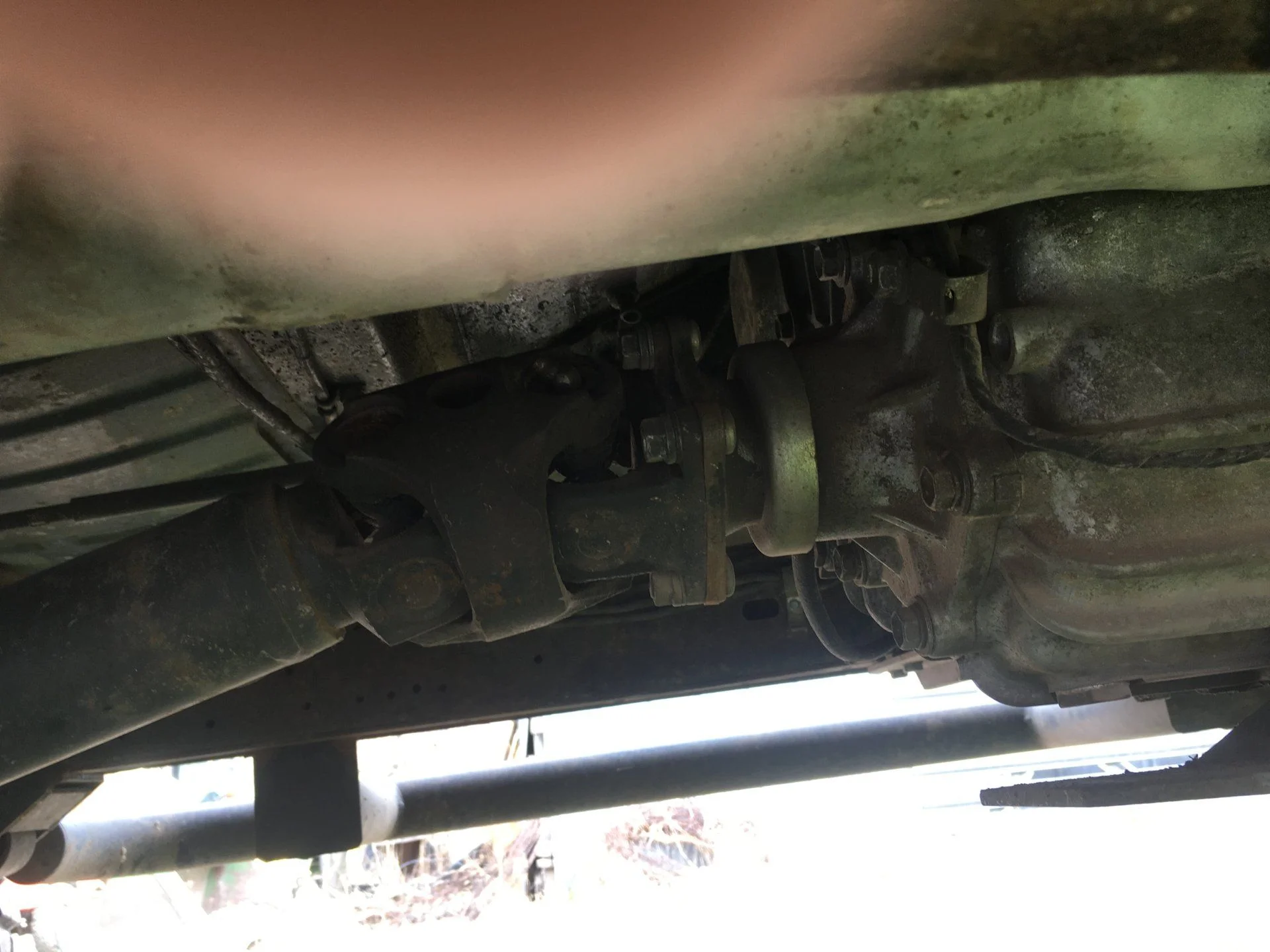

I am attempting to swap with 6bt without SOA. My 60 has a 2" lift and 33" tire. On my first try, the sump got close to the axle, but I think it seems to fit in there, maybe a slight modification on the sump, but not sure yet. By the way, I am using the H55F behind 6bt.
I think I may have committed all the sins. :D
Measure from the front bump stops to the axle housing hit pad + 1.5 inch to determine how far the oil pan will drop on a big bump.
If that distance is greater than the space you’ve got between the oil pan & axle housing — then indeed you’ve committed a sin.
But don’t fret, redemption is only a spacer block away.
If it looks like the pan might hit or will be very close, install a 1 inch aluminum spacer block under the bump stops to prevent the chassis from diving down too far.
