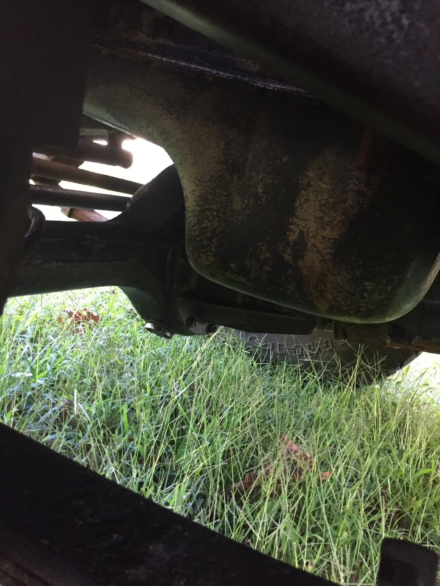

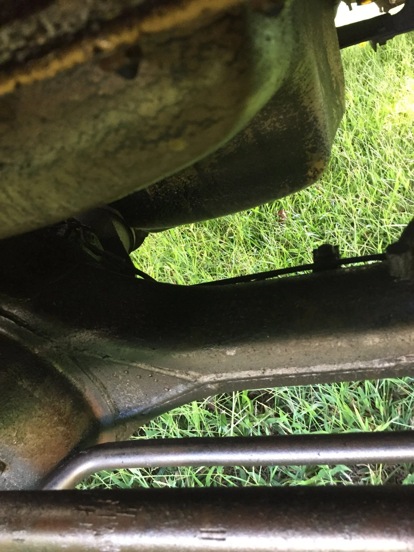

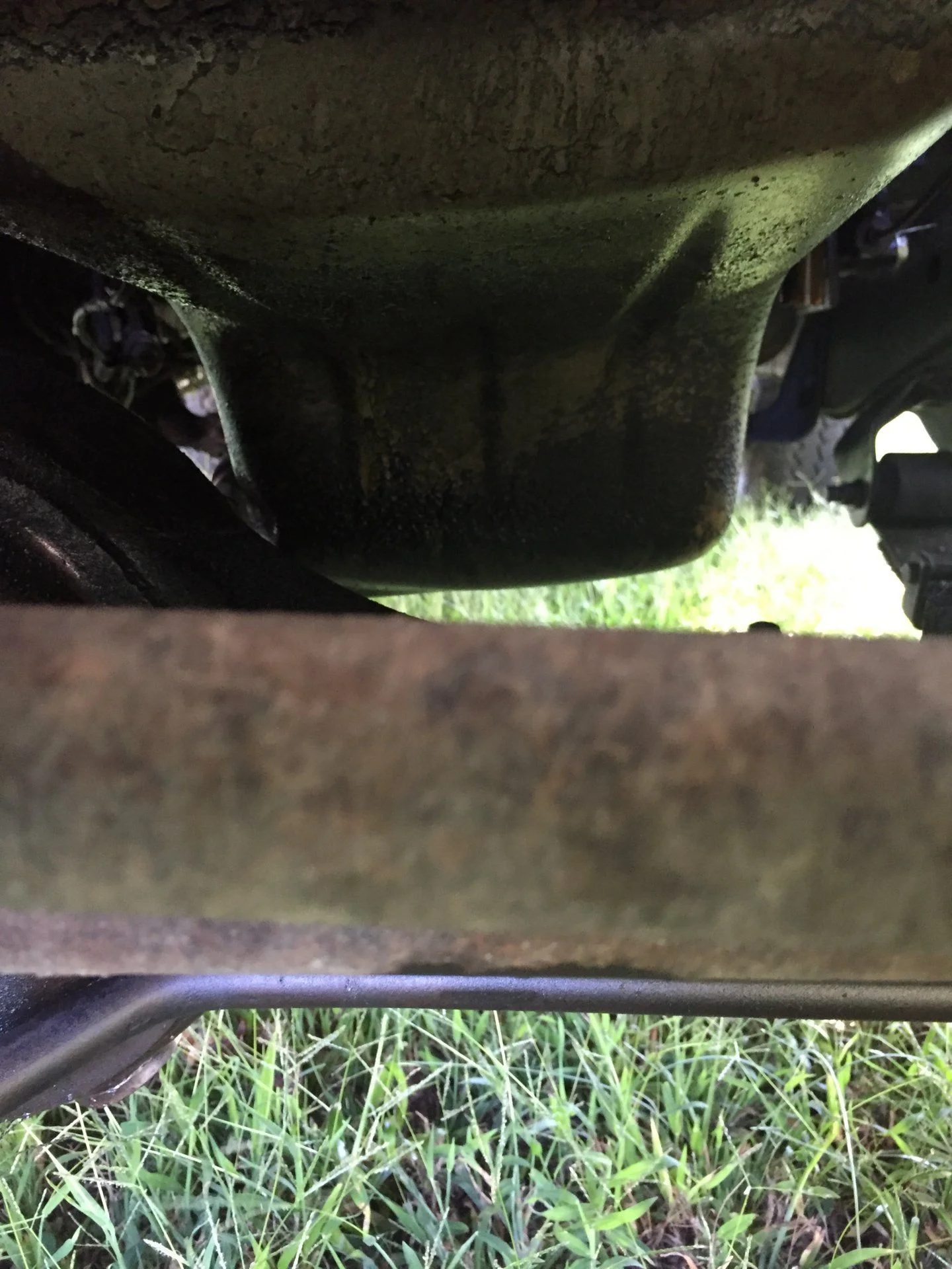

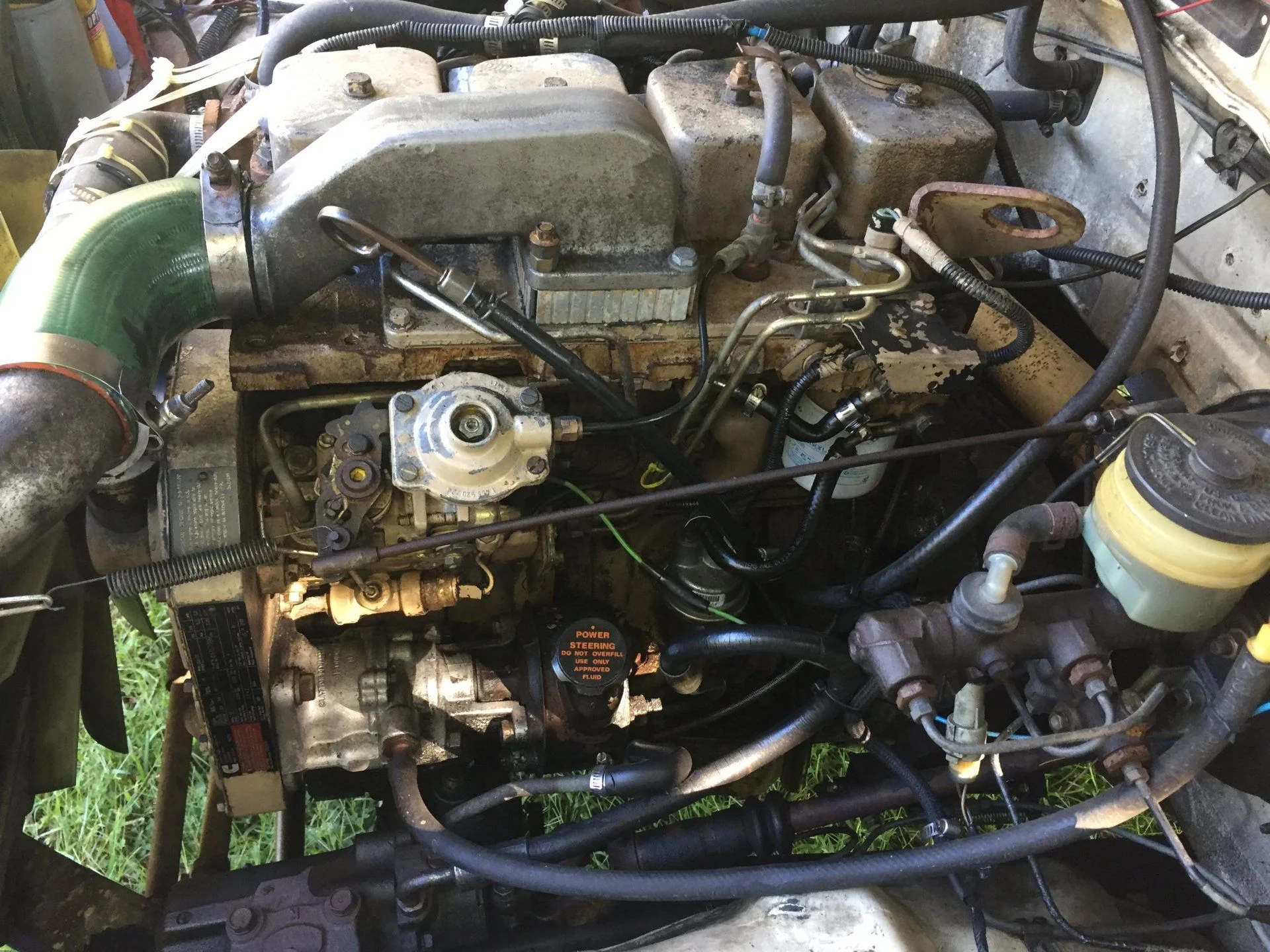

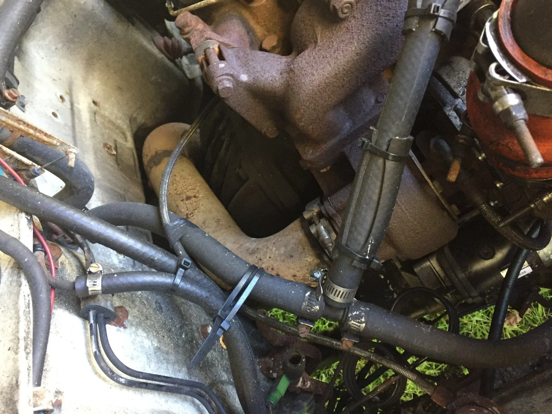

I'm running 4bt without soa, let me know if you need pics of the setup.
Yeah, that would be great! Can you post the pics here? Really interested in the oil pan clearance.
Don't mind an injector line missing lol out of commission until new one gets it.
@MrK - Awesome! Thanks for the pics! So, the reason you're able to run a Cummins without a SOA and just a 2.5" OME lift is because the 4BT is shorter (minus two cylinders)? Essentially the front of the 4BT "ends" before the oil pan begins to interfere with the front axle?
Whereas with a 6BT, because it's longer, you have to go SOA to get the oil-pan to clear the front axle?
Do I have that correct?
I have a few more questions for you @MrK - Who did the 4BT swap for you? Do you ever touch the oil-pan with the front diff when flexing? How commons is the 4BT with the SUA?
I have done plenty swaps before but unfortunately didn't swap this one. No my oil pan doesn't touch the diff when flexed. SUA 4bt swaps are not common because of clearance issues and from all the owners with 4bts I have talked to it seems that they did SOA first and never dealt with SUA clearance.correct me if I'm wrong fellas
