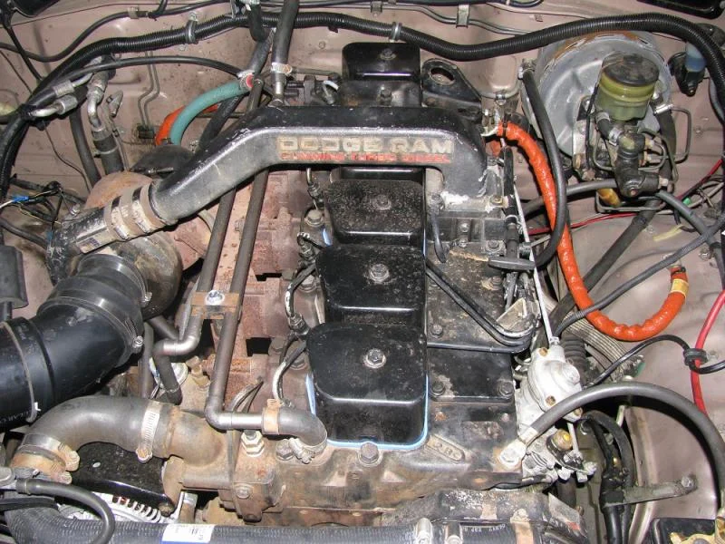

Here's some FJ60 6BT porn for your trouble. Thanks to Mud members Elbert, jakerudy, 1TallTXn, and cumminscruiser for sharing their build threads and knowledge!!!

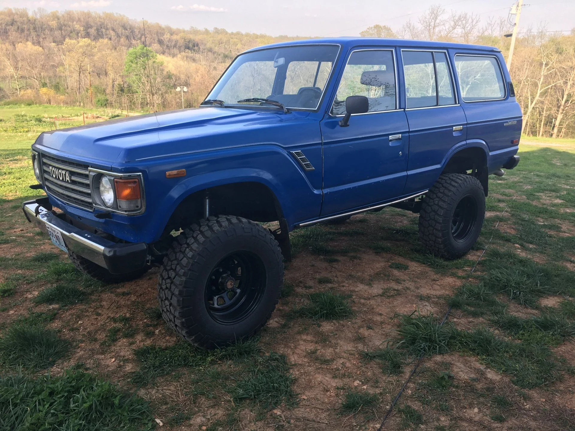

Micah gave me the option of a lift kit or SOA. We ended up deciding SOA was the better option with 2 extra springs up front and 1 added to the back. Another option is to modify the oil pan with a little less lift. At first mine seemed higher than I wanted but I've gotten used to it. The running boards do make climbing in easier, especially for the wife.
Classic Cruisers is great. They were honest with me through the conversion and Micah is a craftsman. Can't recommend them enough. The last time I talked to Micah he said he is backed up with 6BT conversions for awhile since word has gotten out about what he can do. Mine was his first 60, he had done a couple of 80's before. When I picked up my 60 they mentioned plans of putting a 6BT in a 40 and Micah loved my 60 so much he was talking about doing one for himself to replace his 6BT FJ80.
I had a couple of minor bugs to work out after I drove it home but Micah and Brandon made it right. Considering the project I didn't consider it an issue at all.
Be prepared to pop the hood often. Had a kid approach me at Dollar General this morning and he just couldn't get over it. Everyone that has looked at the install has been impressed and the most common comment is that is looks like it came from the factory that way.

Micah originally thought he could pull it off with a 2 - 3" lift. After more measurements he saw it wouldn't work and a 5" lift was going to cost more than SOA with no real gain given the weight of the 6BT.

Would I do it differently? No. It is a beast and goes everywhere I need. I don't go hardcore off road but where I live some of our roads are close to hard core and I farm so it goes through various fields.
I may have gotten obnoxious with the BFG MT tires but I figured once I was in that deep why not? My Dodge was falling apart around the engine and the odometer had stopped working a couple of years ago so the engine had less that 200K on it before the swap but not sure how many miles. Micah replaced the seals & gaskets but that was all it needed.
I took bit of a risk as a guinea pig for Micah's first 60 and don't regret anything. This 60 is awesome. All the power you could ever want and 20 - 22 mpg.

Dodge introduced the the 5.9 liter Cummins in their trucks in 1989. Those trucks had 12 valves. Then, in 1998 they upgraded the 5.9 liter Cummins to 24 valves.
Most road-going cars/trucks use a 12-volt system to operate the starter, lights, and electronic accessories (including most road-going Dodge Cummins trucks). But some foreign, military, and industrial applications utilize a 24-volt system. So when you start talking about swapping in diesel engines, especially from industrial applications, it can get really confusing!!!
To answer your question, jakerudy used a 1991 3/4 ton Dodge 6BT/NV4500 as his donor vehicle. His Cummins swapped FJ60 has a 12-valve, 12-volt 5.9 liter Cummins engine. Hope that helps others!
Yeah, it can get really confusing since the abbreviation for "valves" and "volts" is the same. Plus, there are "12" and "24" systems for both. I know I had trouble when I first started researching diesel swaps.
