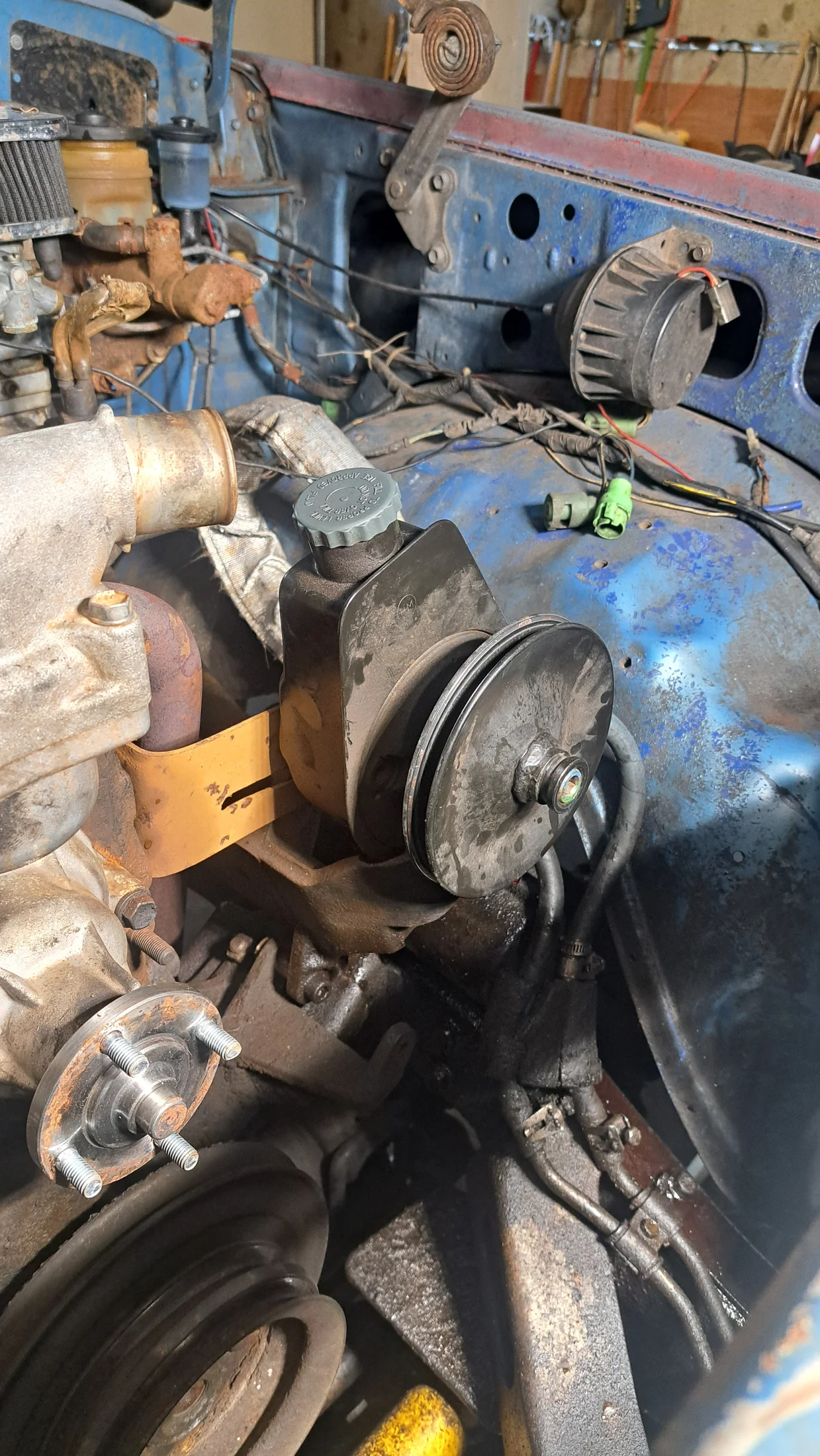

-The alternator and power steering pump have been poorly modified to run in different positions off the fan pulley after a poorly executed smog delete. Also, the P/S pump is a Saginaw thrown in with a bracket machined by hack saw, hand drill, side grinder, hammer and vise.

The plan is to get the rear brakes repaired and to order a used Toyota P/S pump and hardware as well as a smog pump delete pulley. As my driveway is sloped, a hand brake is necessary for positioning to remove the engine. I also ordered a used Toyota distributor and battery tray.

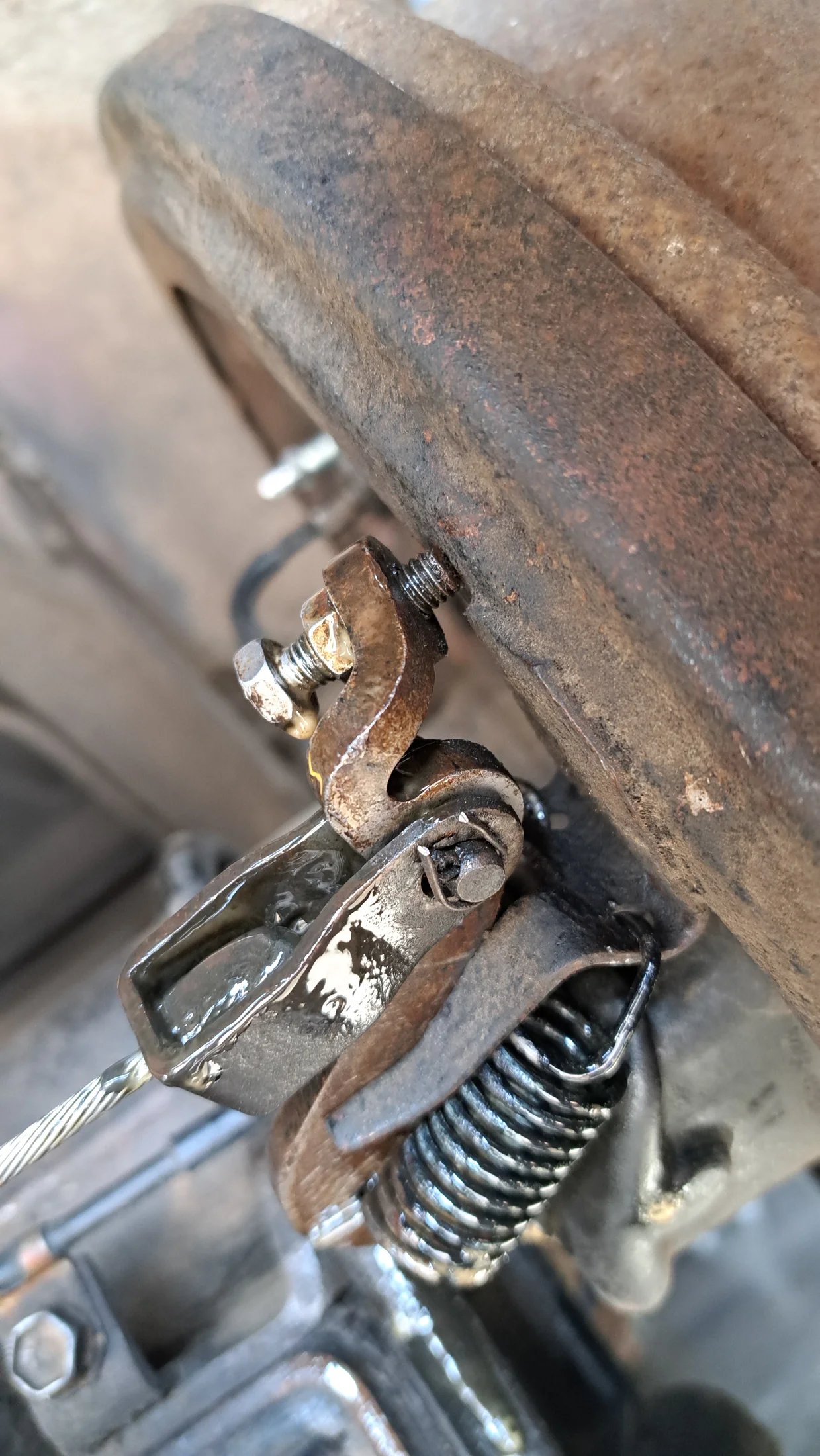

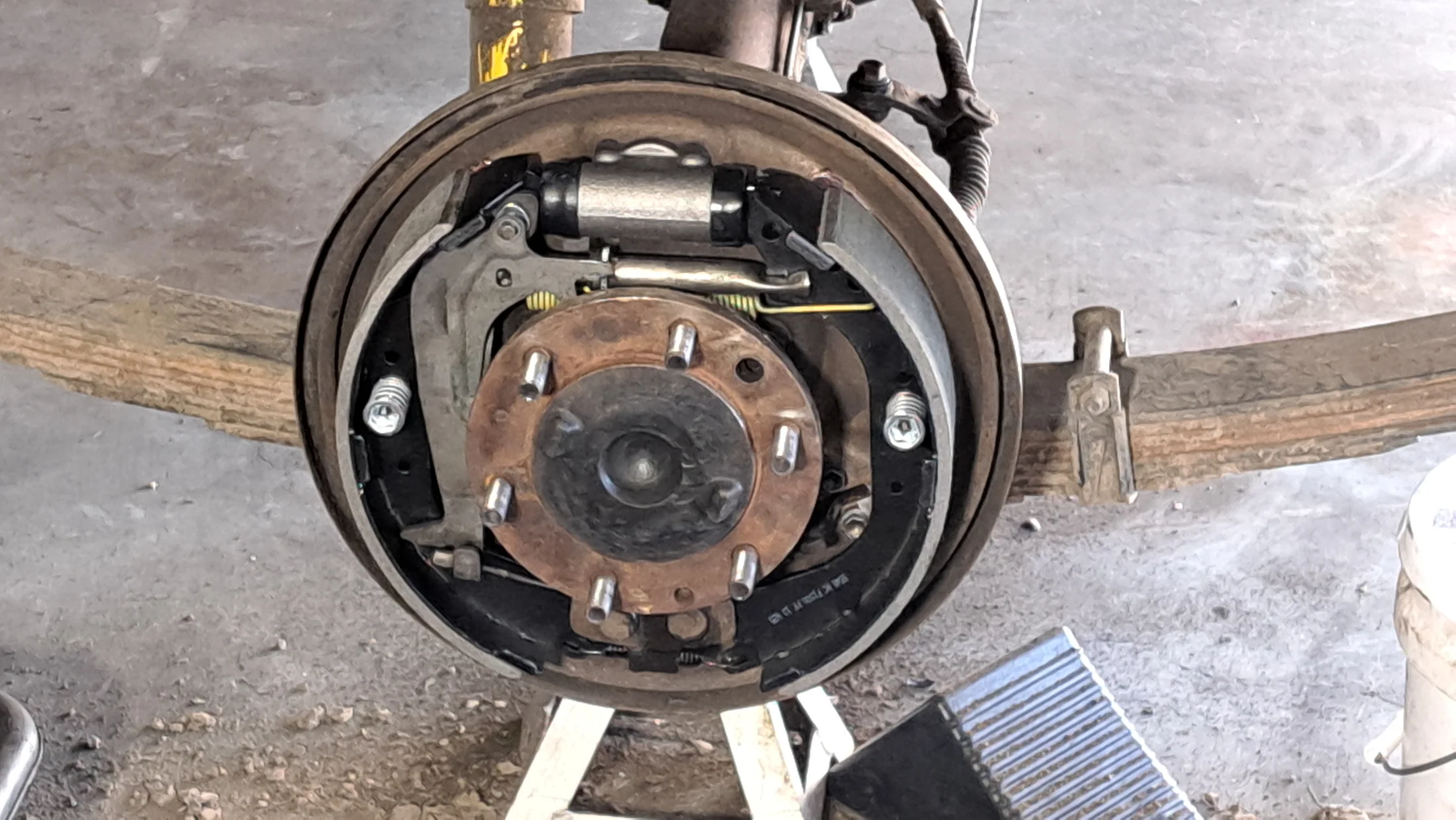

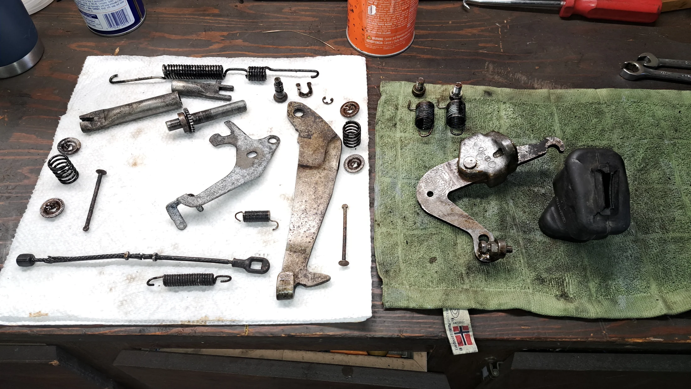

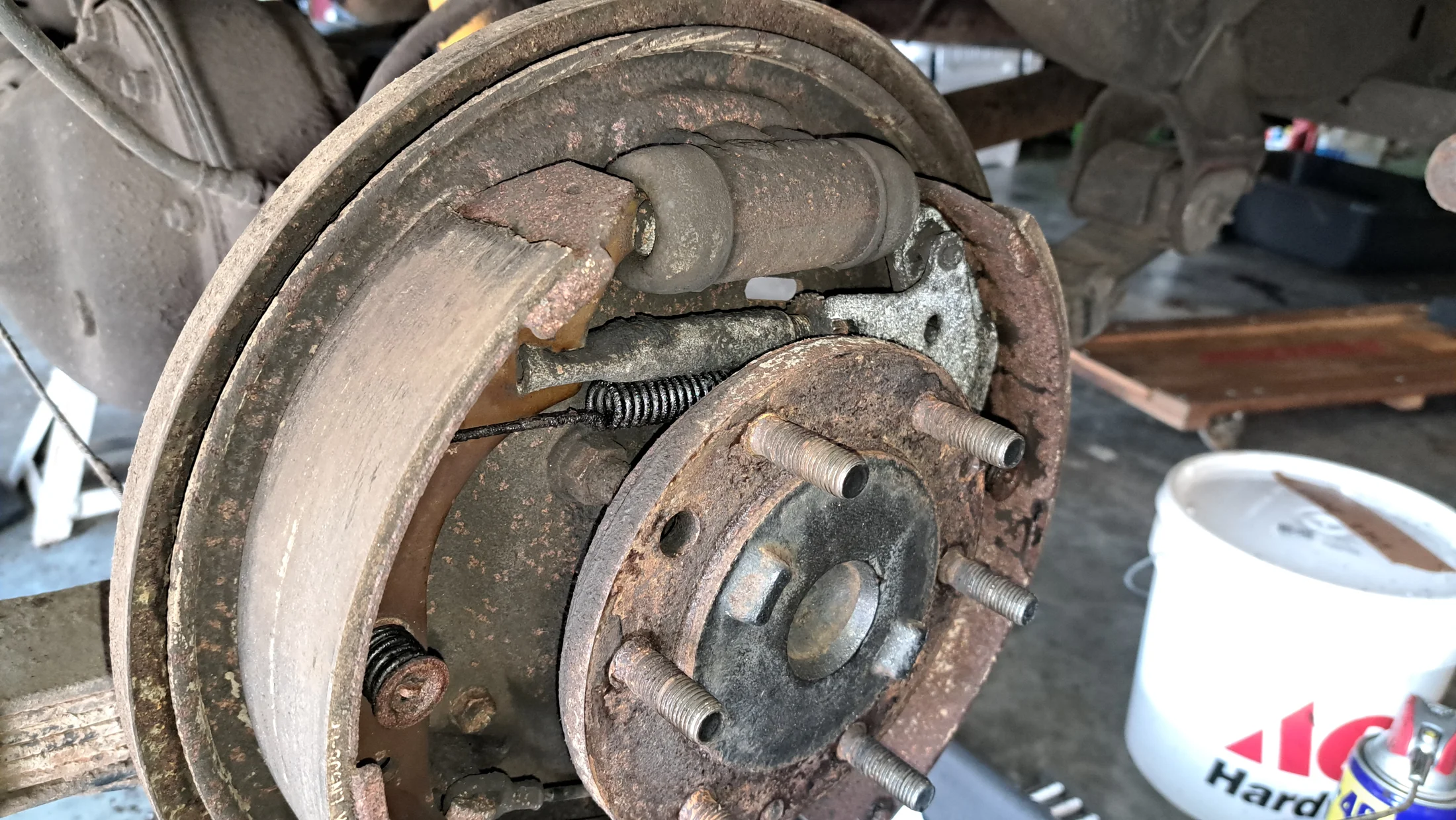

Completed the rear brakes and freed the the bell cranks. I used an ultra-sonic cleaner and strait SuperClean solution on the bell cranks. They were still frozen afterwards so I let them soak for a day in penetrating oil. I then had to tap them with a hammer and delrin drift. Eventually, I freed them up. I applied some chain and bushing lube, then an overcoat of fluid film.

Anti-seize the bell cranks and the self-adjusters for longevity.

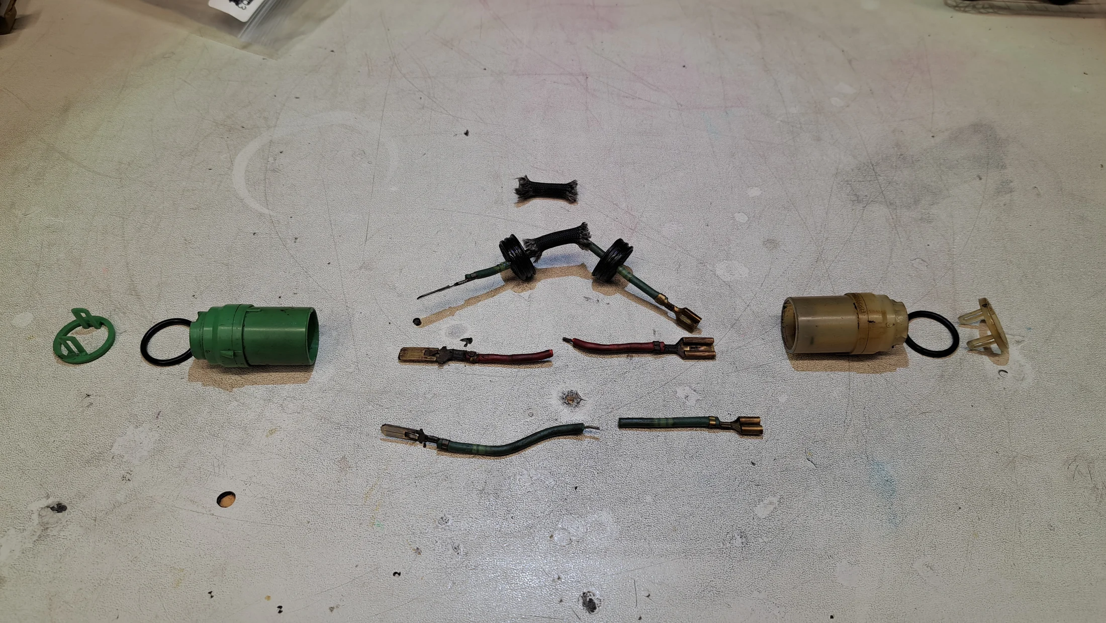

The alternator may or may not be inoperable. I decided to start with the wiring harness.

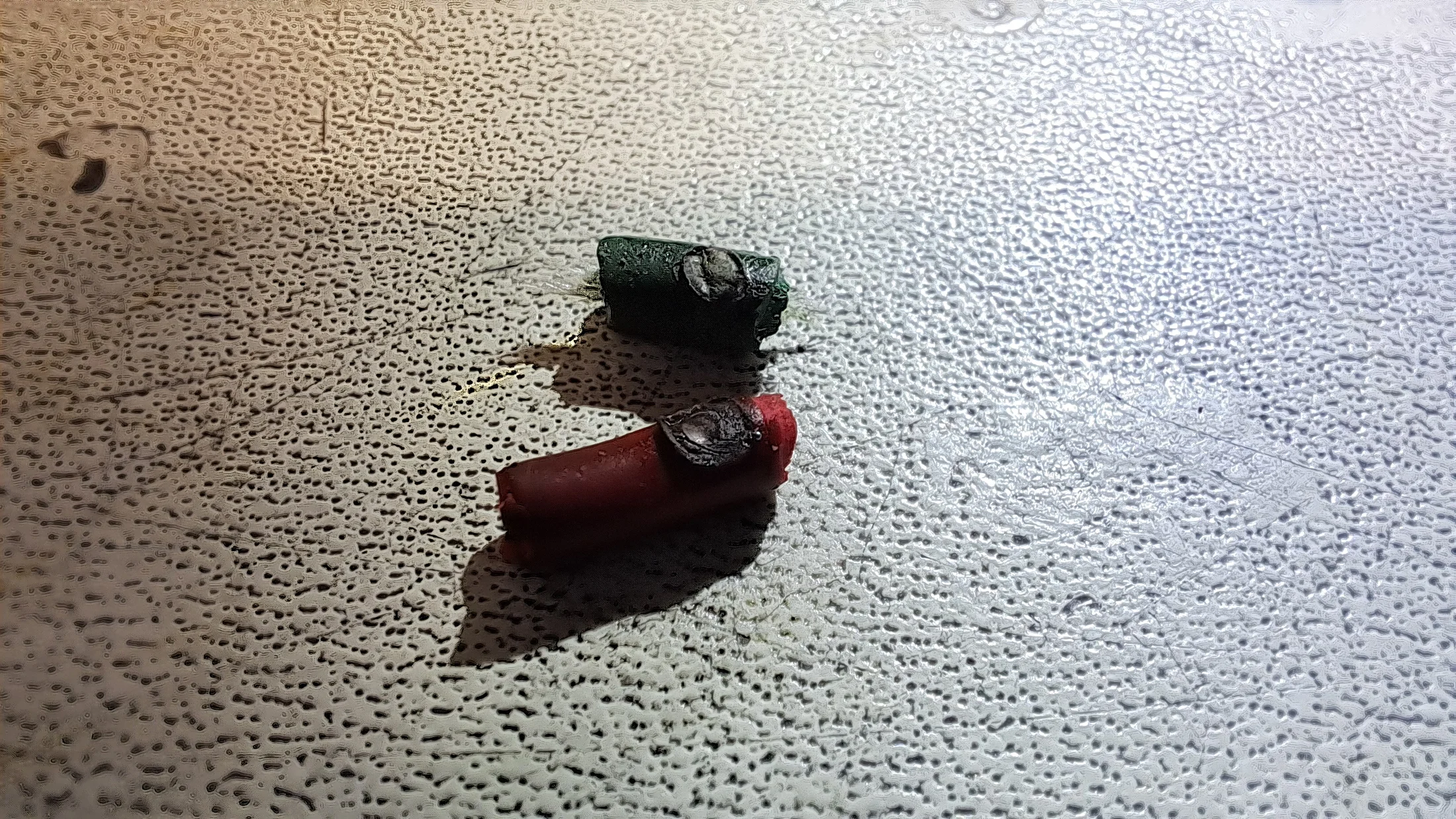

I inspected the wiring harness and zeroed in on the fusible link. The red wire had been replaced with 18AWG automotive wiring and all the pins and crimps were very dirty and somewhat corroded. The green wires appear to be original.
The subbed red wire is not plated and has standard insulation. The insulator emitted lots of smoke at 400C. The original green wires have thick insulation and emit very little smoke and remain relatively intact when exposed to 400C. I’ve ordered pins, sockets, seals, fusible link wire (18 and 20AWG) and PET expandable shielding. I’ll share stock numbers and suppliers when I get my hands on the parts. I want to make sure they’re correct.
