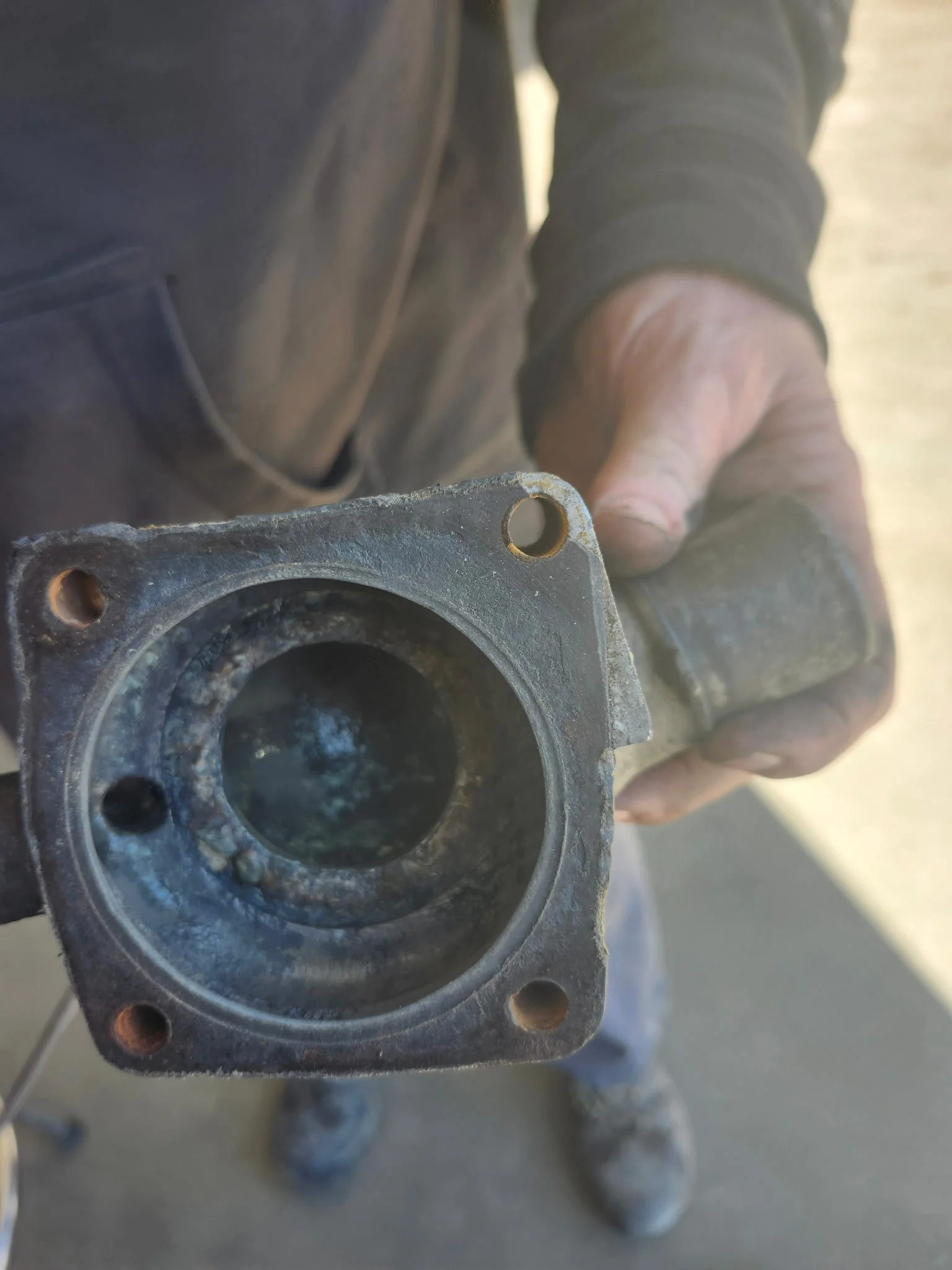

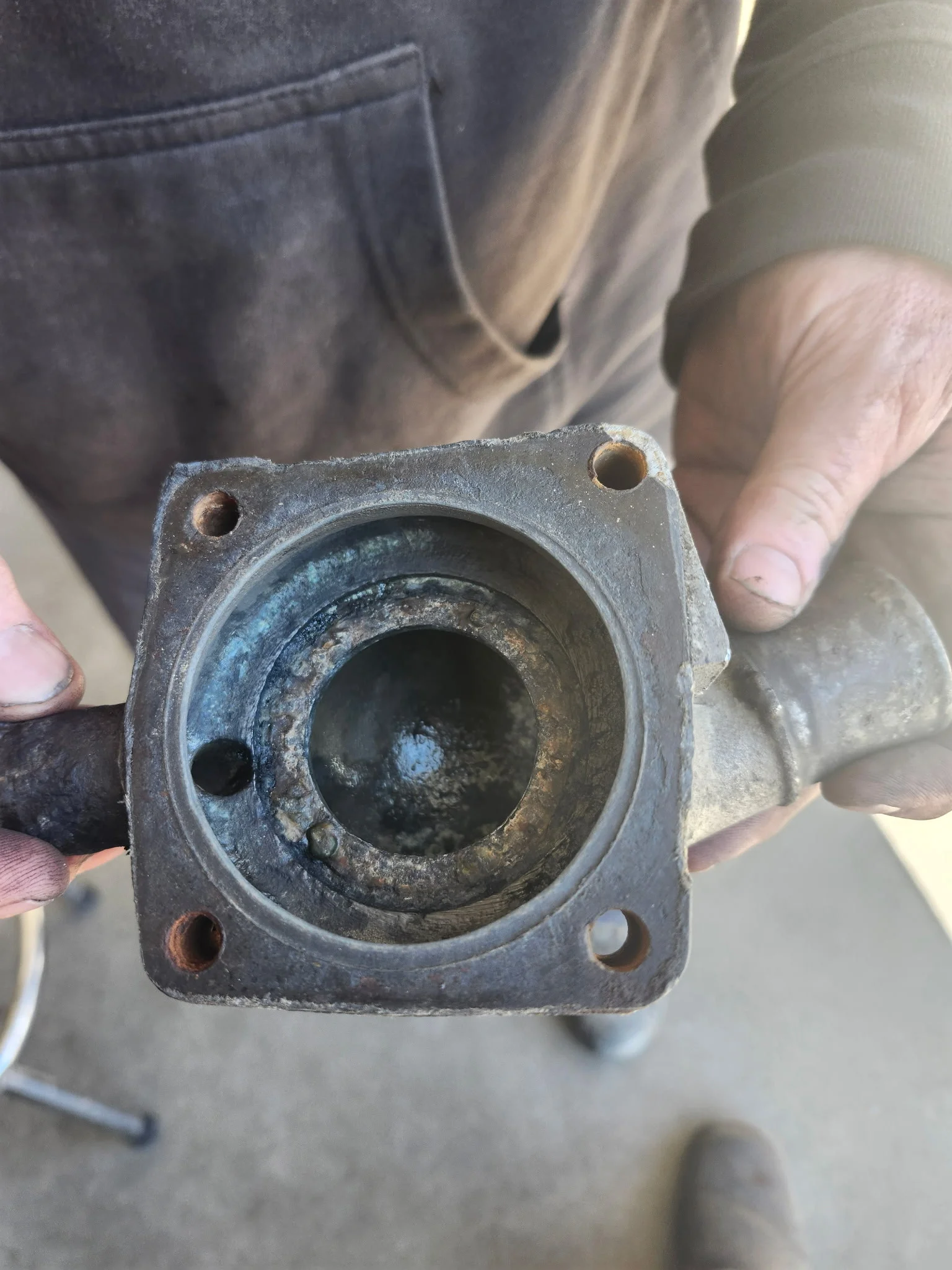

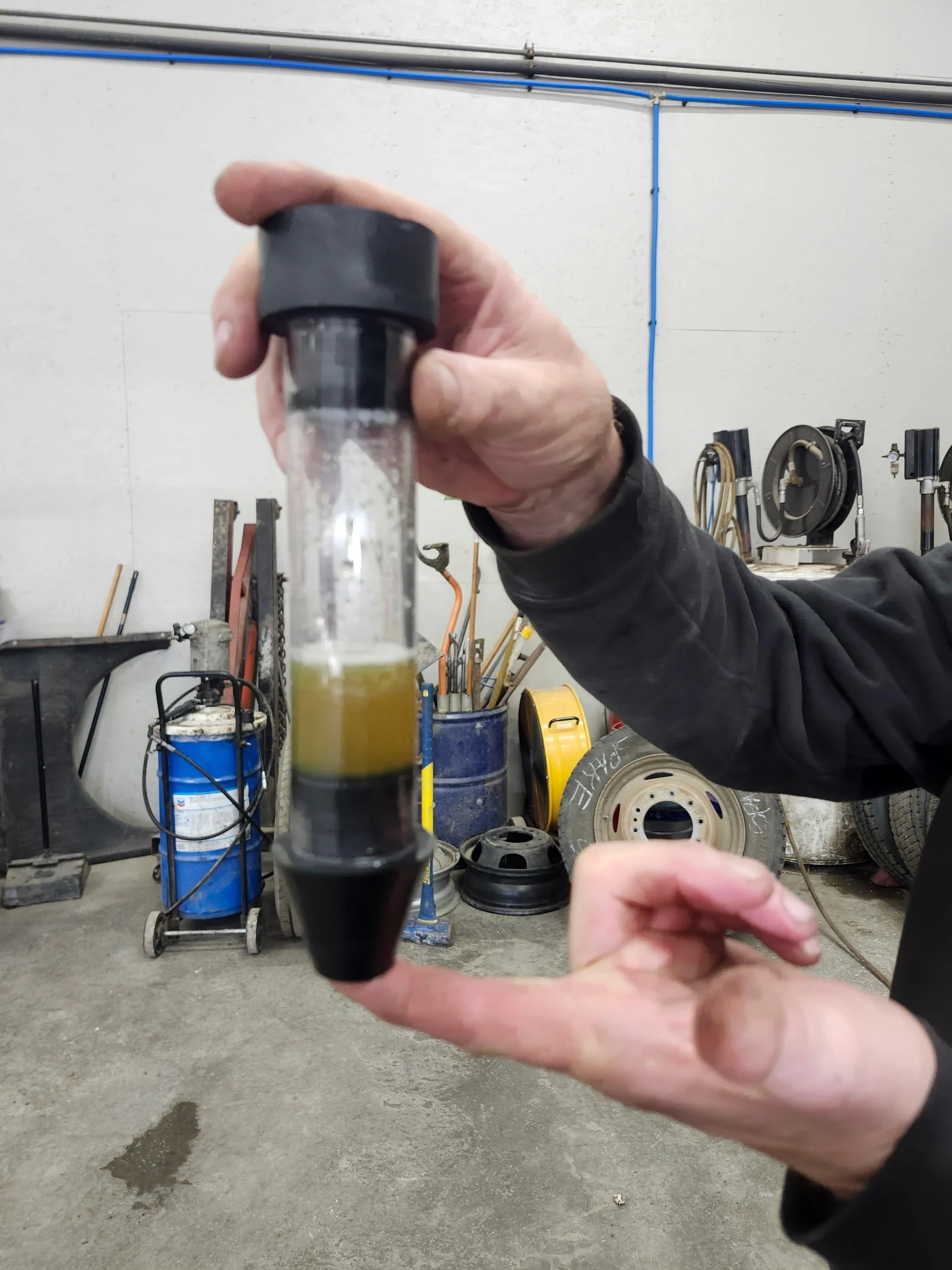

I have a 1987 FJ60 4 Speed Manual. I'm in Colorado. Overheated on Sunday. Thought it was the Thermostat (which it was - stuck) but turns out after they did the Combustion Test it was confirmed the Head Gasket is blown. Jasper apparently doesn't made 1987, 4.2 Engines anymore. The only place that does is only warranties a new engine for 12 months (wild)
Cost of the Engine quoted is $5075, $500 to ship. 19 hours of labor for a total of $10,280.
My question: Should I just replace the Head Gaskets and look around for an engine somewhere else....or sell it?
