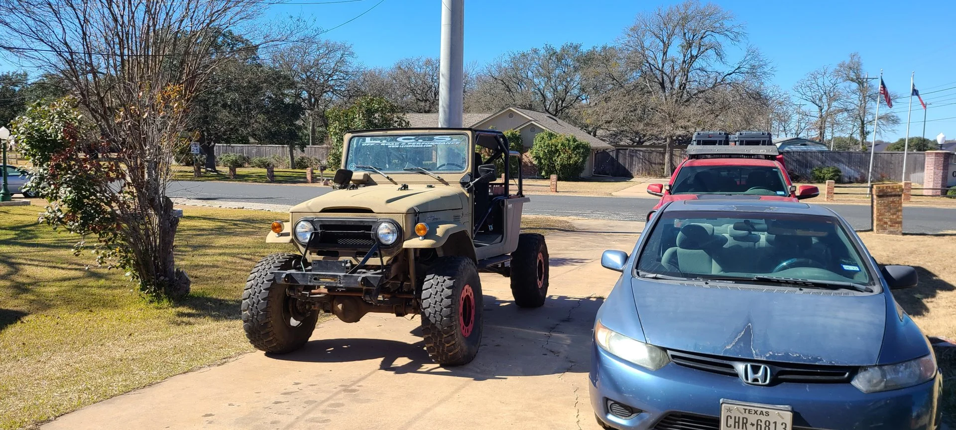

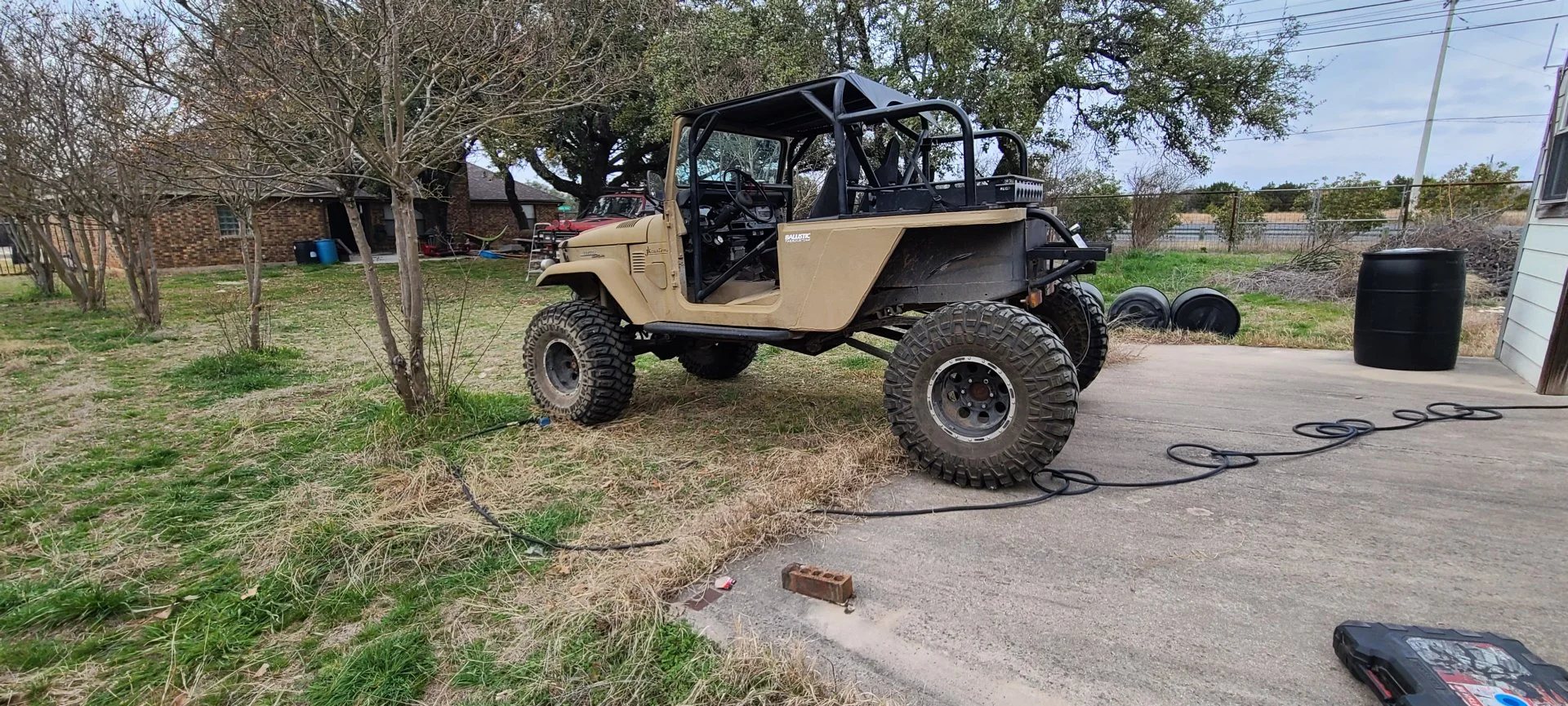

I saw this beauty while getting some mods done on my tacoma. It has 44 inch tires, a GM 350 engine, 60 series axles, an NV4500 and an Orion transfer case.

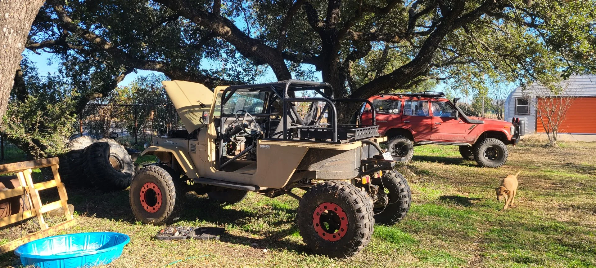

When we off loaded it, we realized that it was way too wide to fit in the backyard.
So we had to change out the 44in tires with 37s off an H1 Hummer
It looks so much weaker now. But I plan on installing 40 inch Yokohamas once they are in stock.

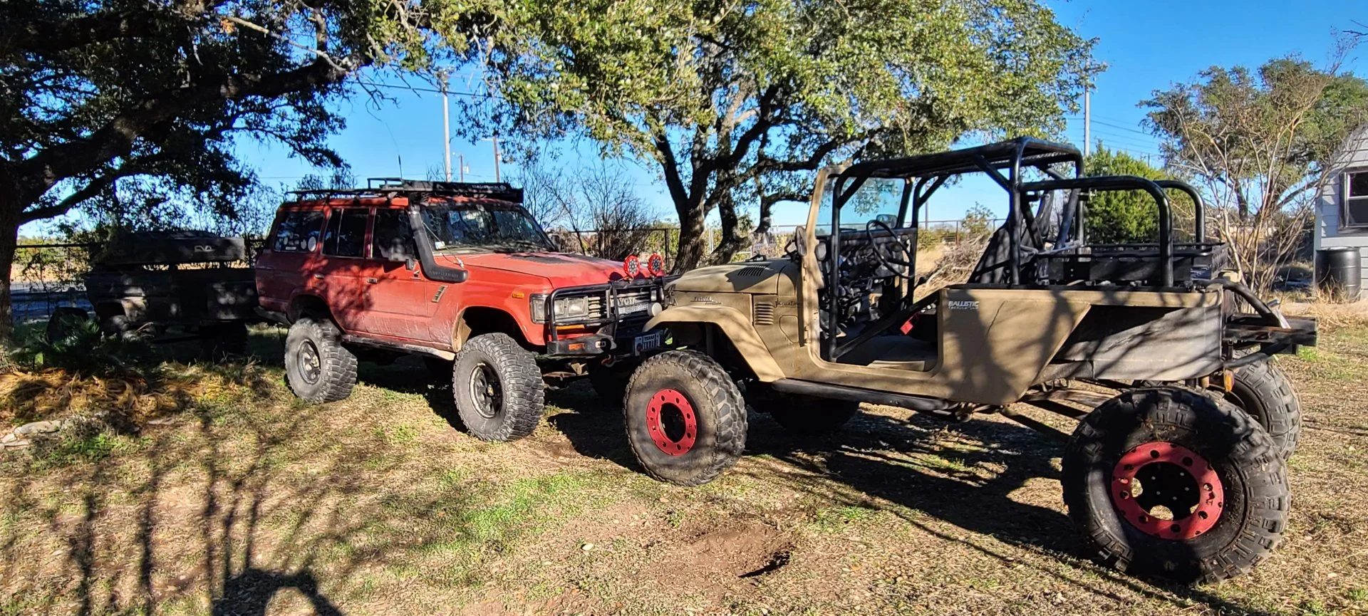

Penelope and Big Red. 4BT compound diesel vs GM 350.

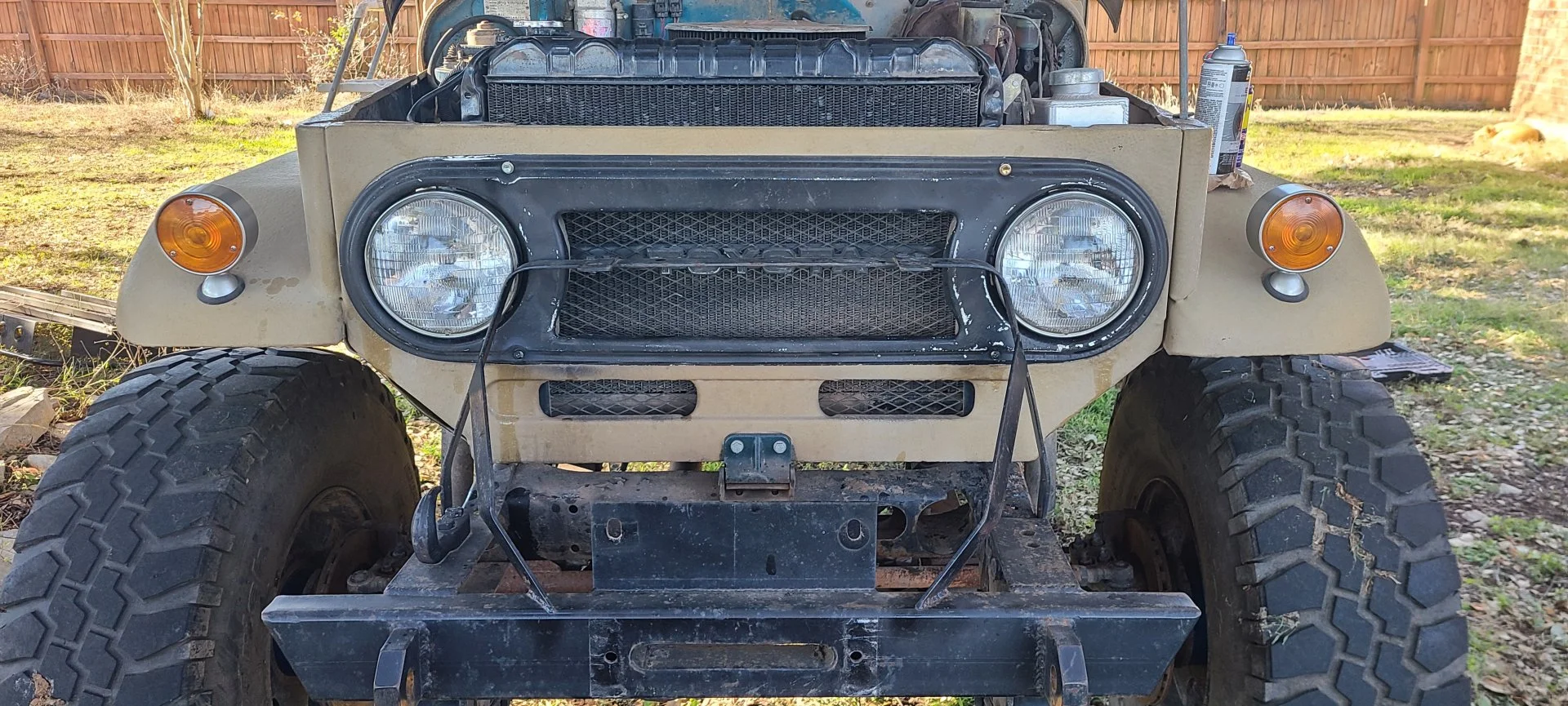

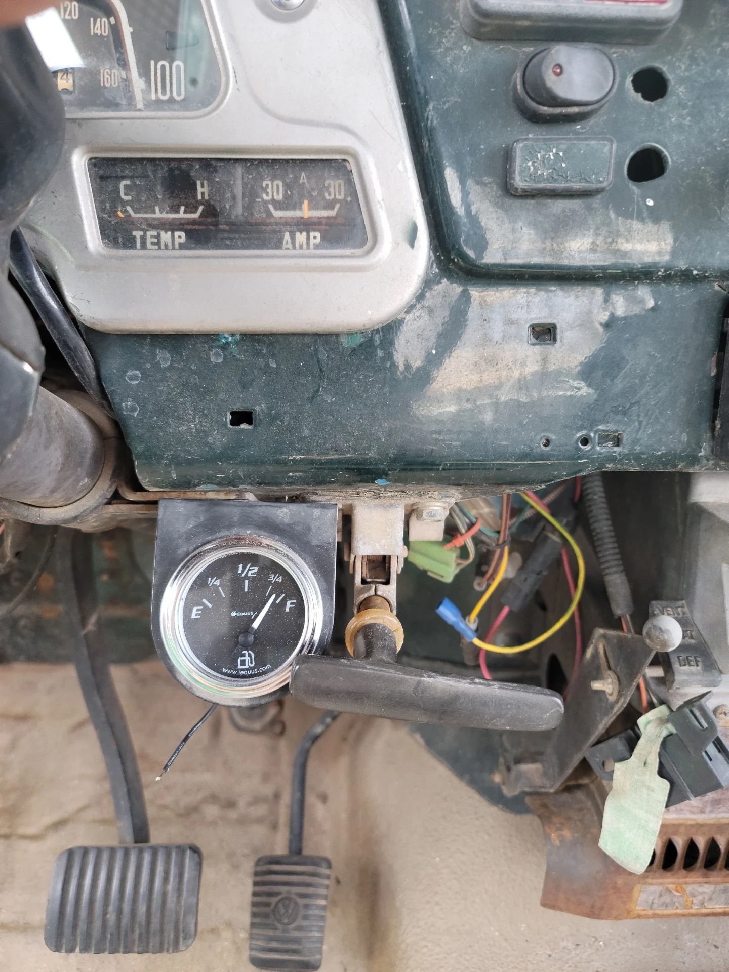

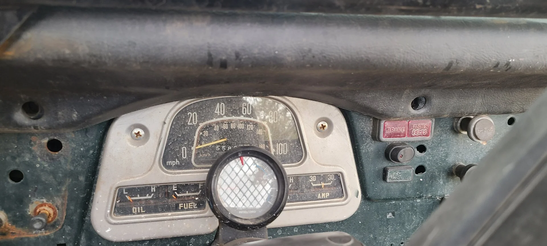

The first order of business was to get the bezel on the correct way.

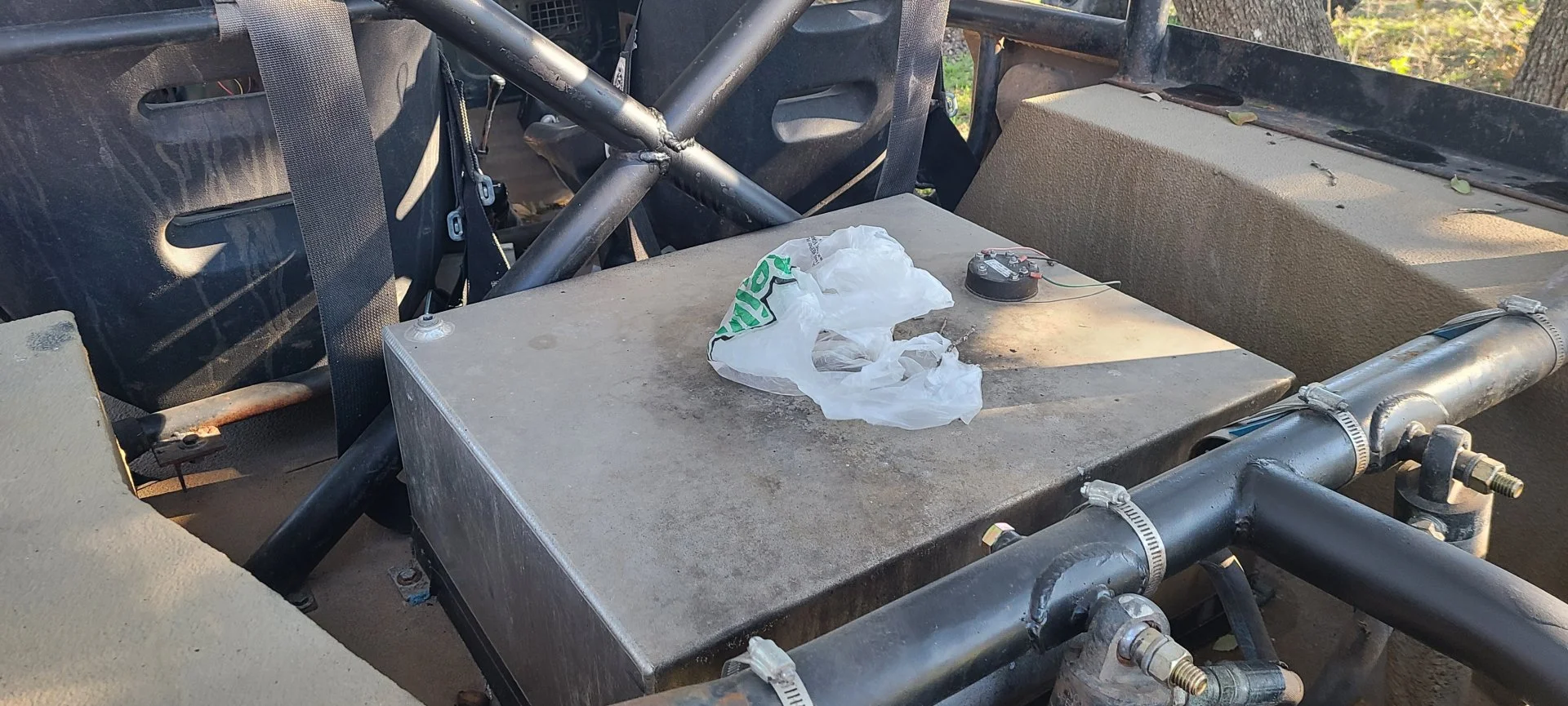

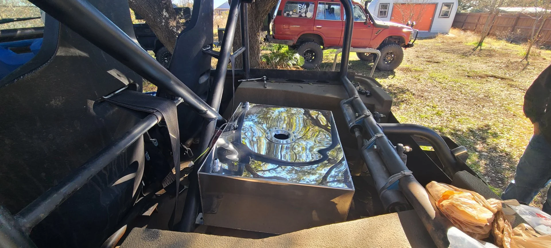

Second order of business was to replace the fuel tank which has some rust in it.
I wanted a all black fuel tank, but they didn't have them in 20 gallons, so I got what was functional, not what looked good.

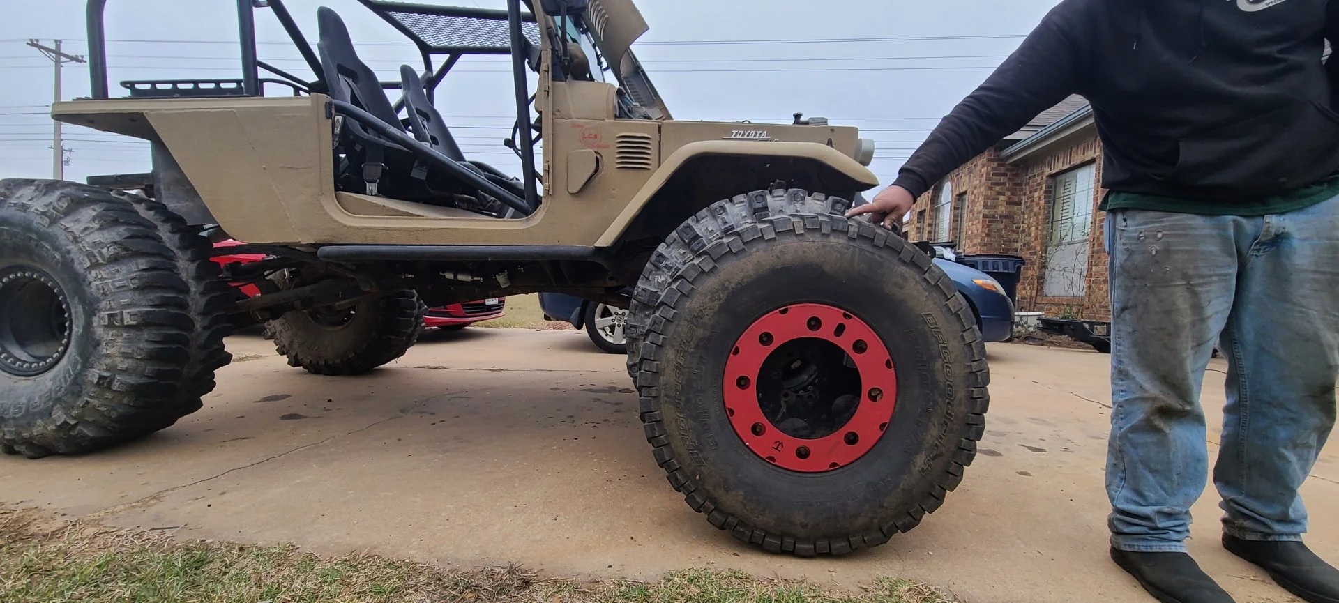

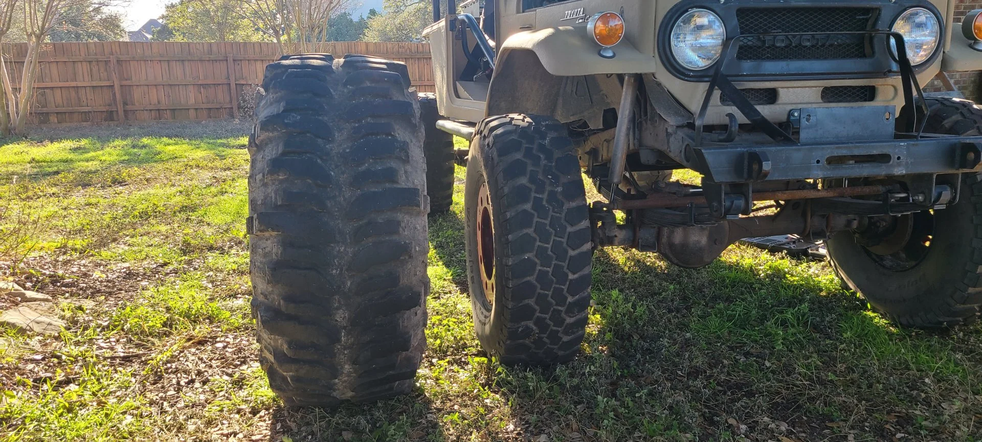

Tire size for comparison. I think 40 inch will be a good compromise.

I thought really hard on it and it comes down to being functional. The issue with those 44 inch tires is they hit the leaf springs when you barely turn. Otherwise I'm all about them

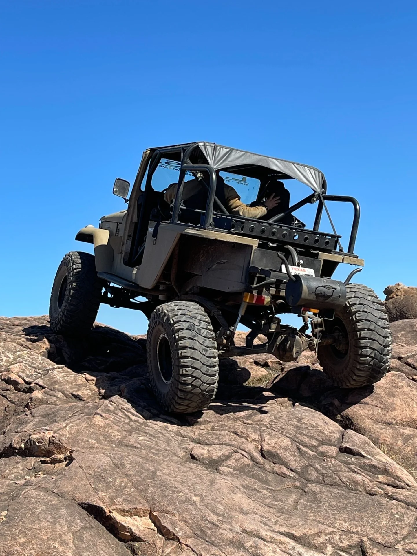

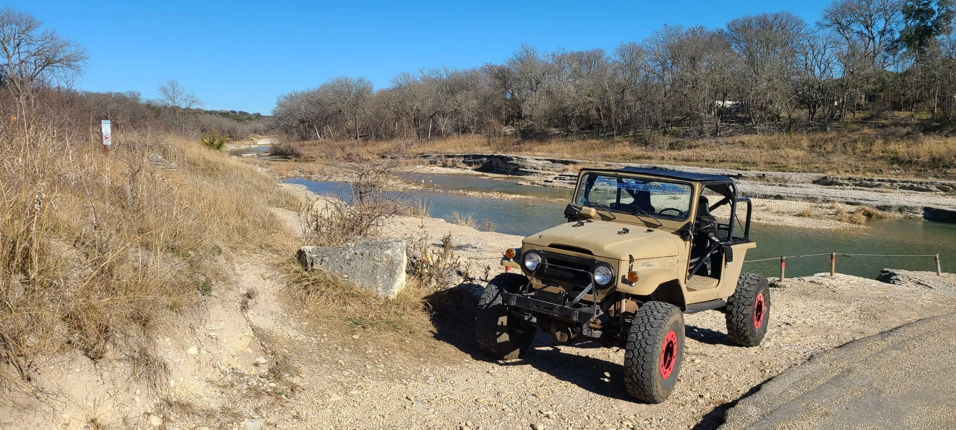

Took it for a spin today. Did great on the highway and on country roads. The engine doesn't overheat and it has plenty of power to push it along, even in 5th gear. The wife even commented that she wants to take Penelope to Colorado instead of our 62 or our tacoma the next time we do Solid Axle Summit.

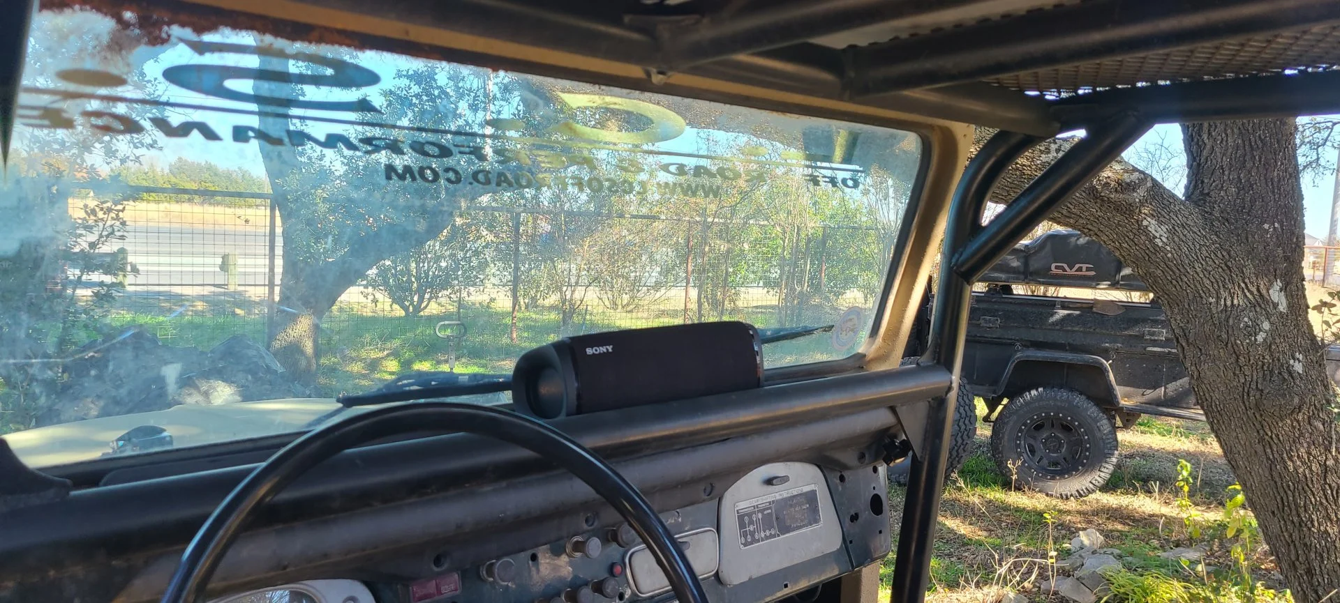

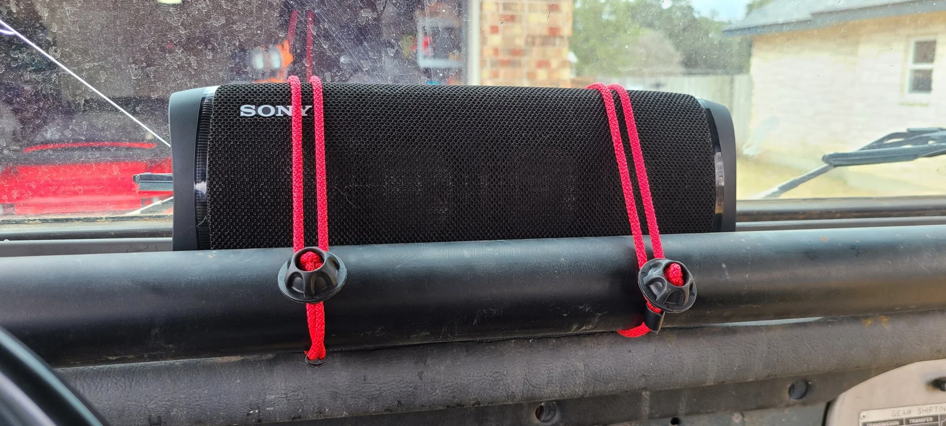

I also found the best cheapest sound system is to just get a bluetooth speaker.

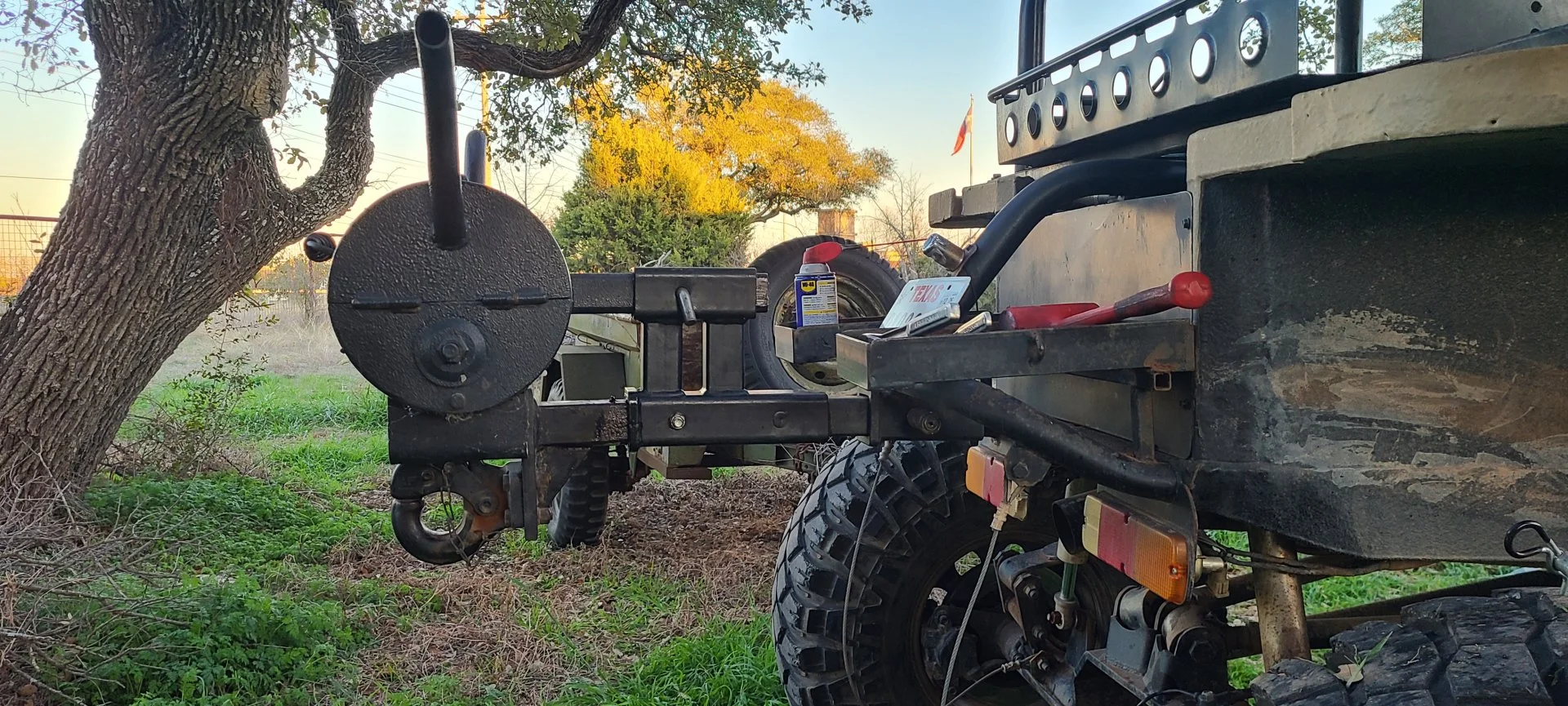

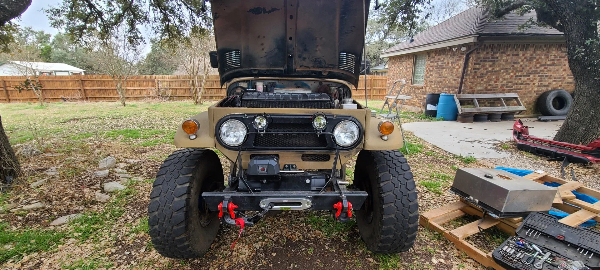

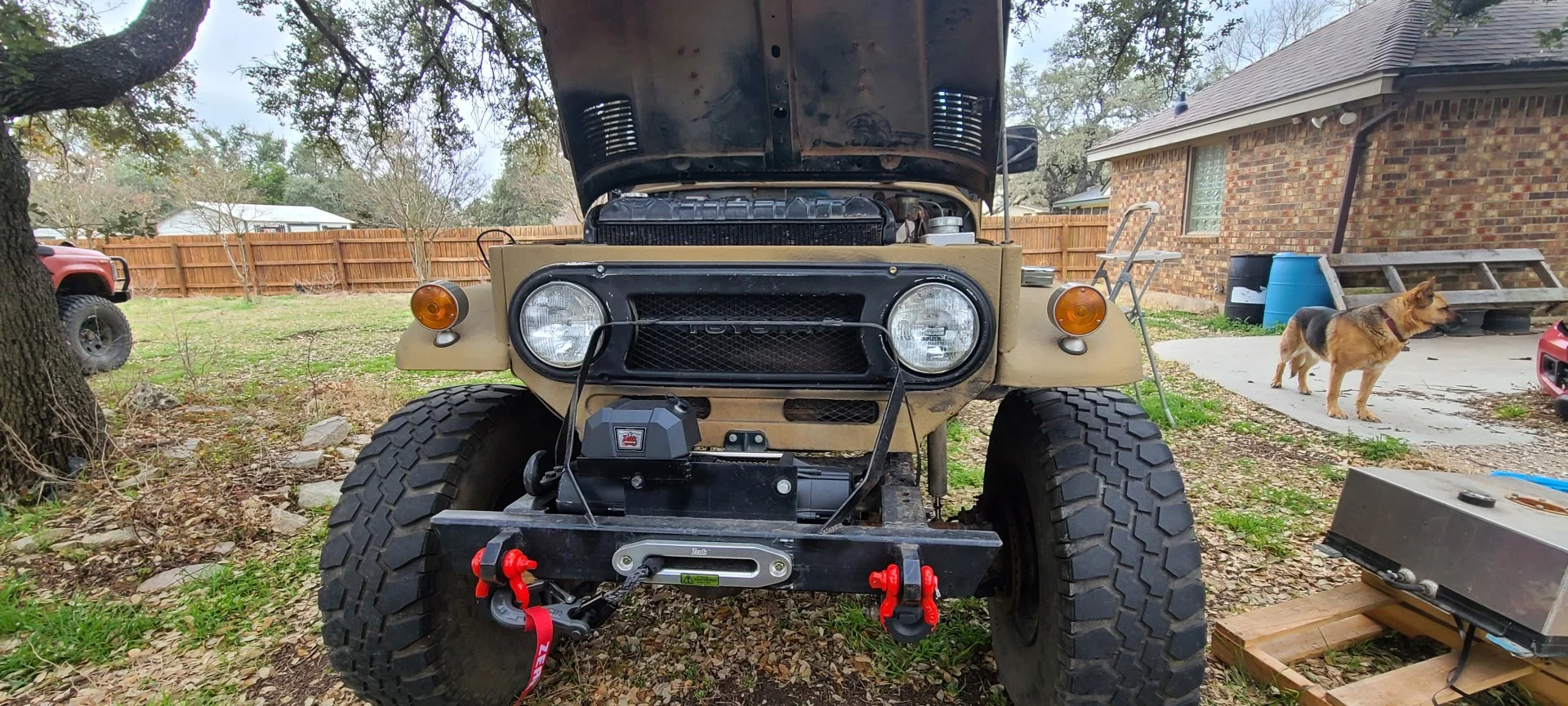

I got the winch installed. Only dropped it on my foot once.

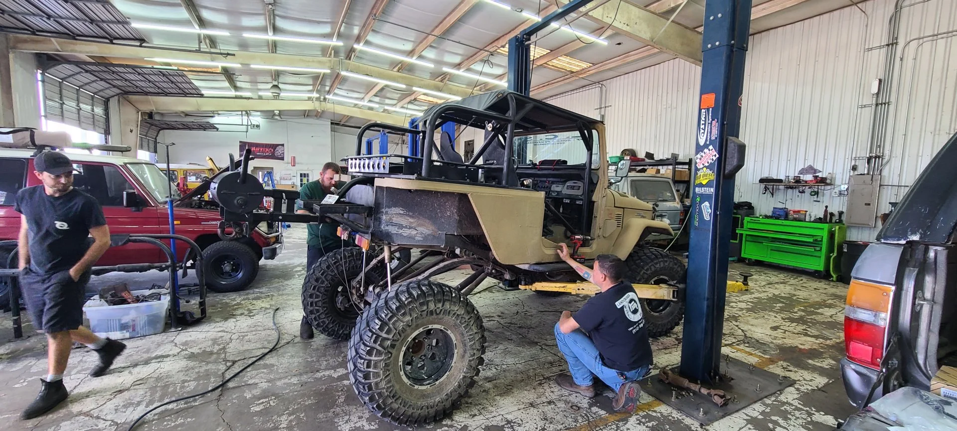

Needed a small plate welded to have the control unit sit, so took it to land cruiser specialist in Austin. They do great work.

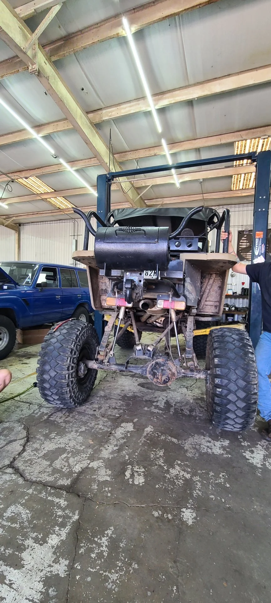

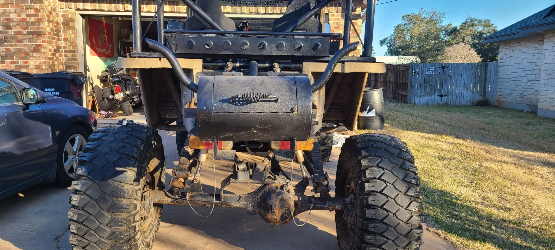

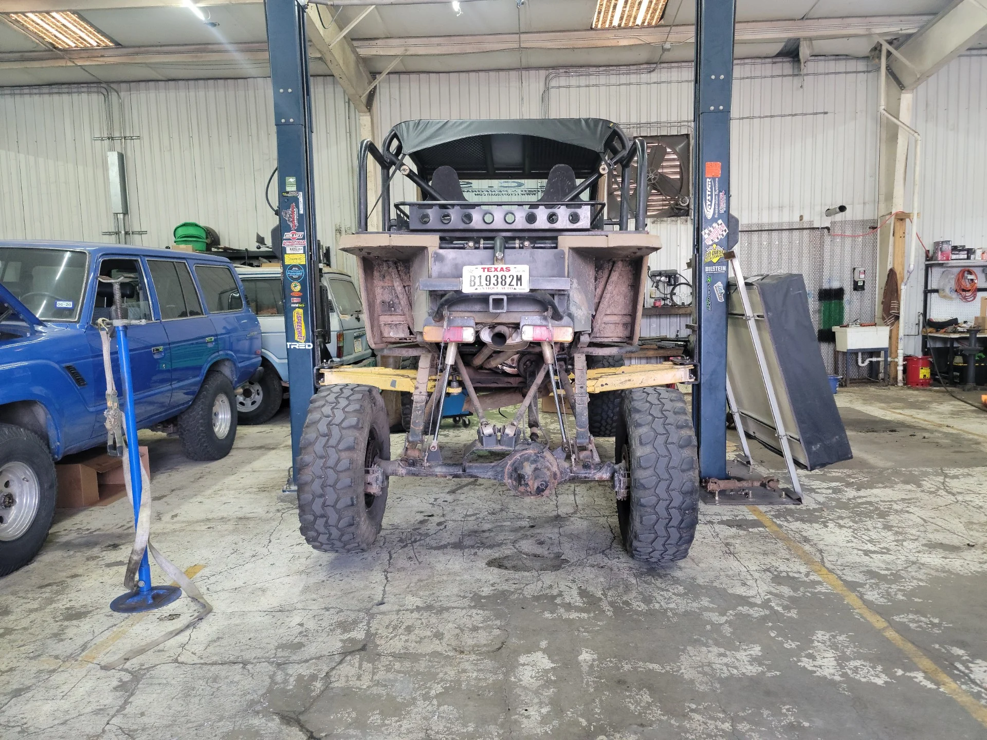

The rear is super flexy, here's a pic of it with and without the rear axle strapped.

This was my cheap solution to a sound system. Works great! Looking forward to round up next week!!!

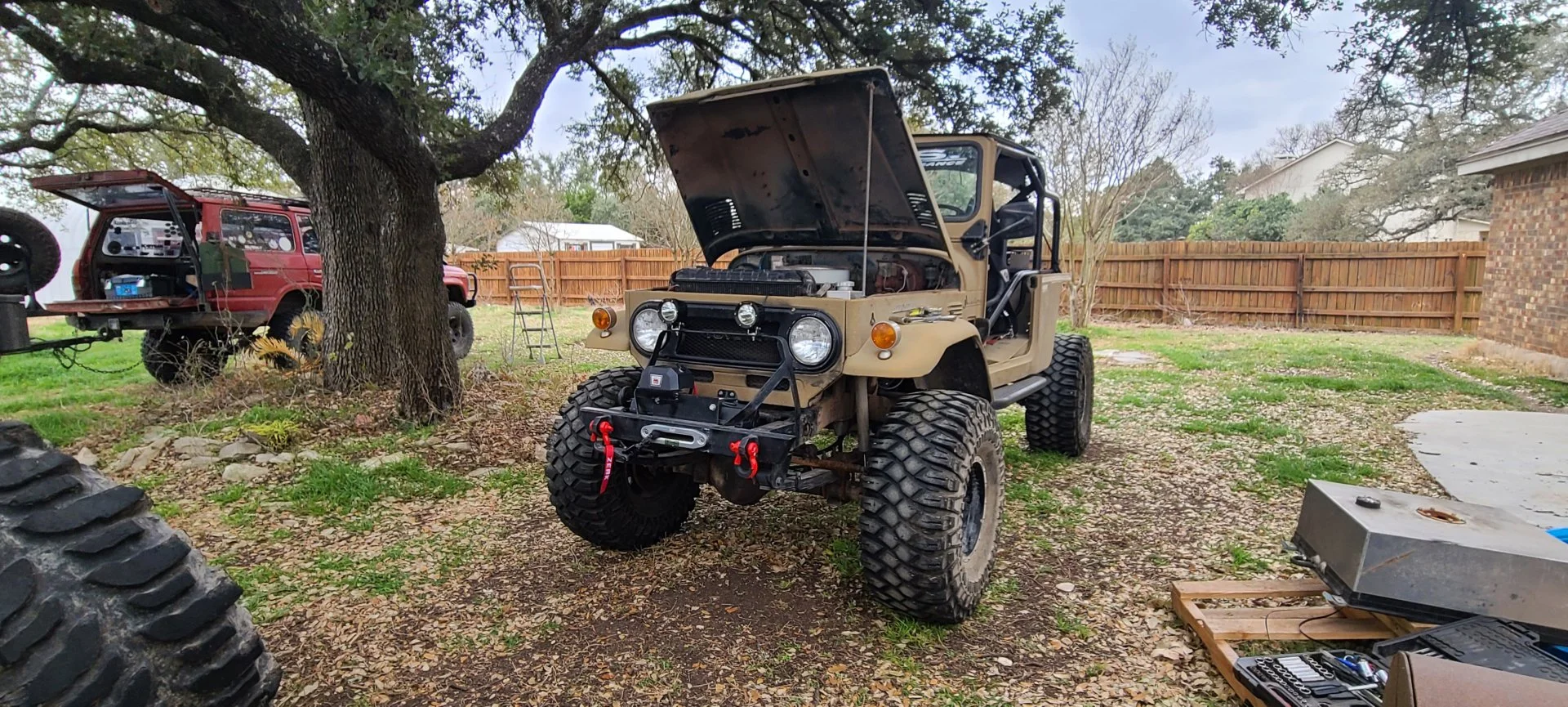

Decided to use different shoes on Penelope. These are lighter than the steel hummer tires and wheels and they are wider. I also started to install off road lights but haven't finished wiring them because it's so cold out. Hopefully I'll get to it tomorrow or sometime this weekend. I'm not yet sure how i feel about the look of the lights, but i guess as long as they are functional.
Wired up the lights. They are super bright, can't complain for the price.

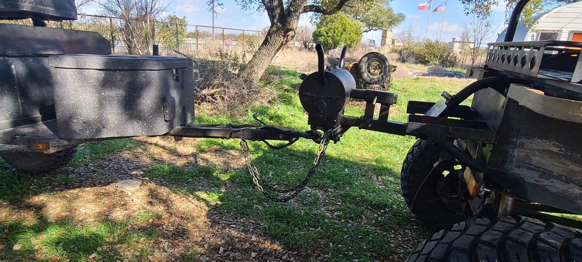

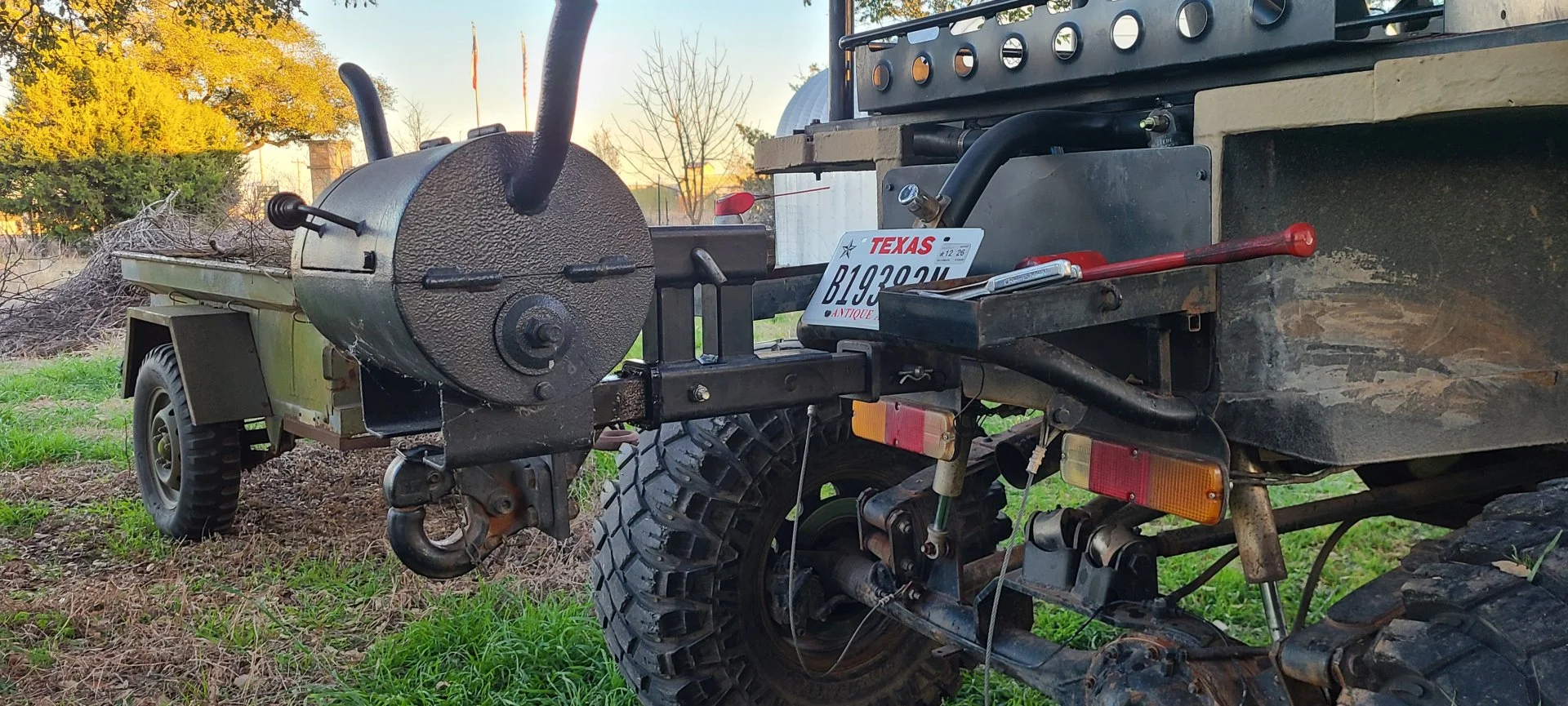

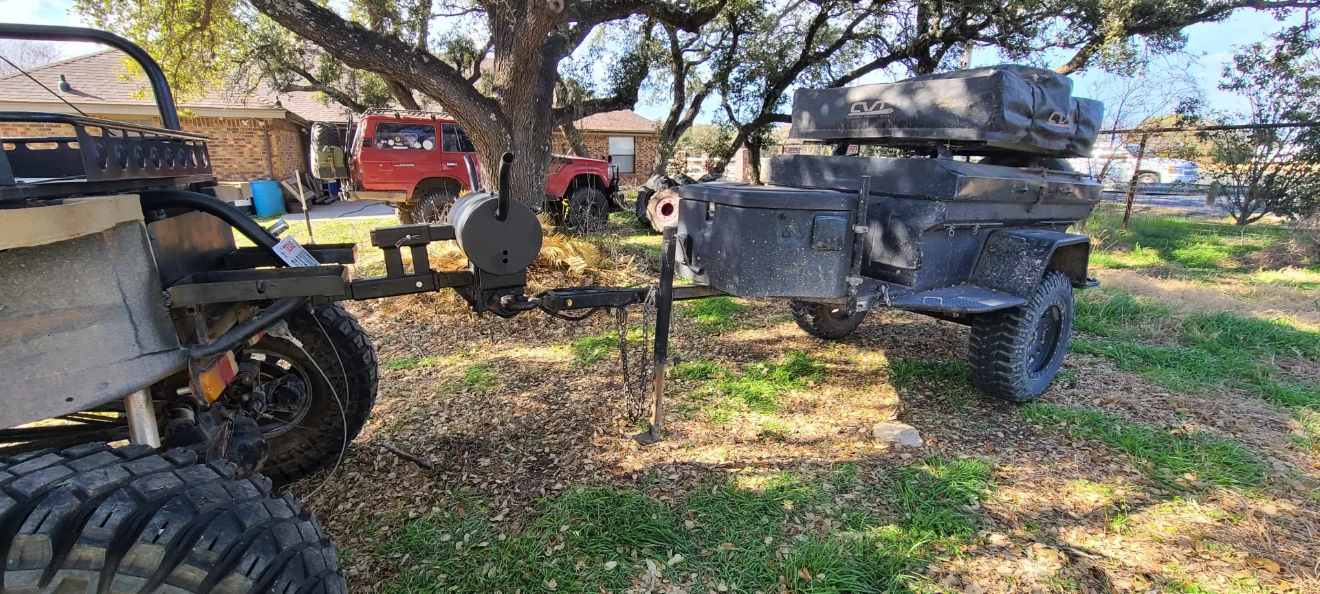

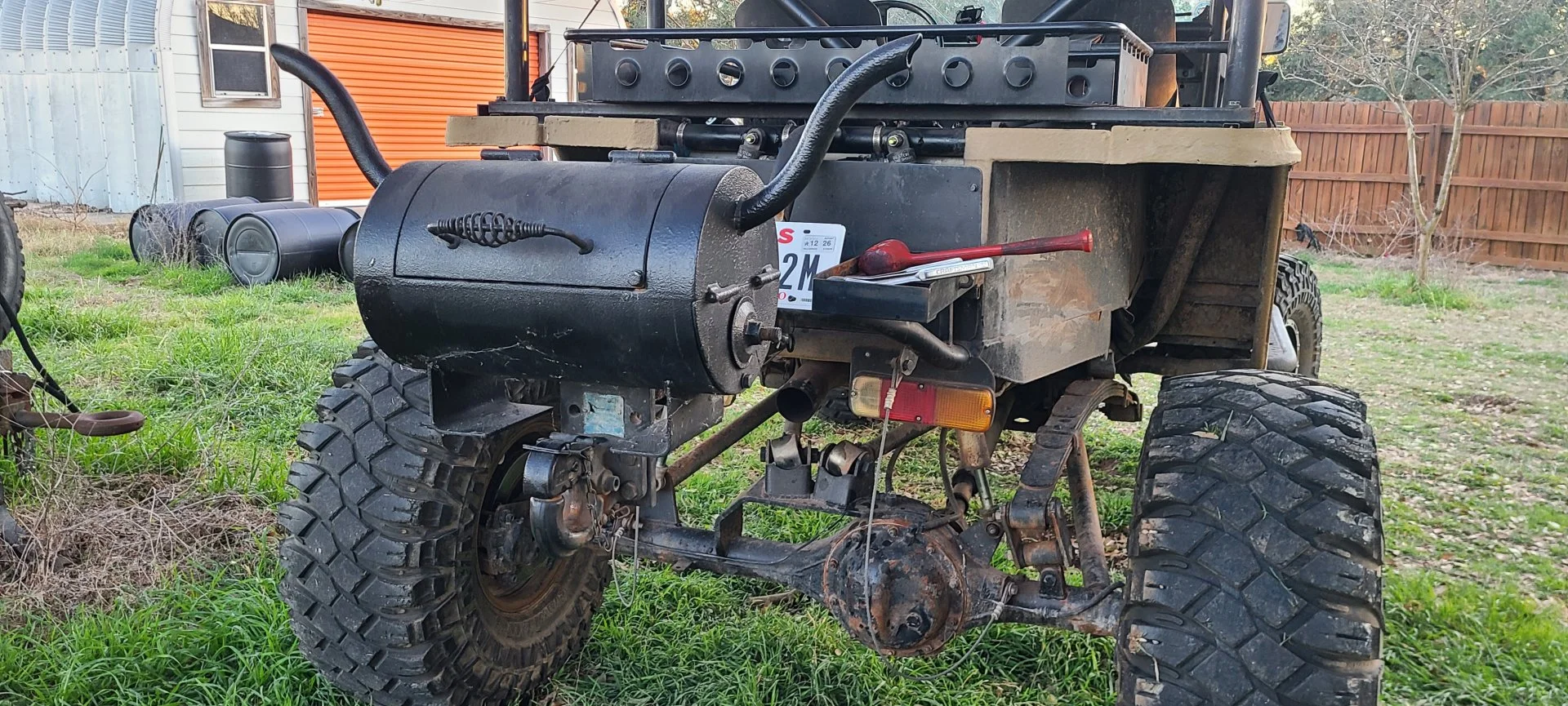

I also installed my tow hitch and the bbq grill. Getting really excited for round up.

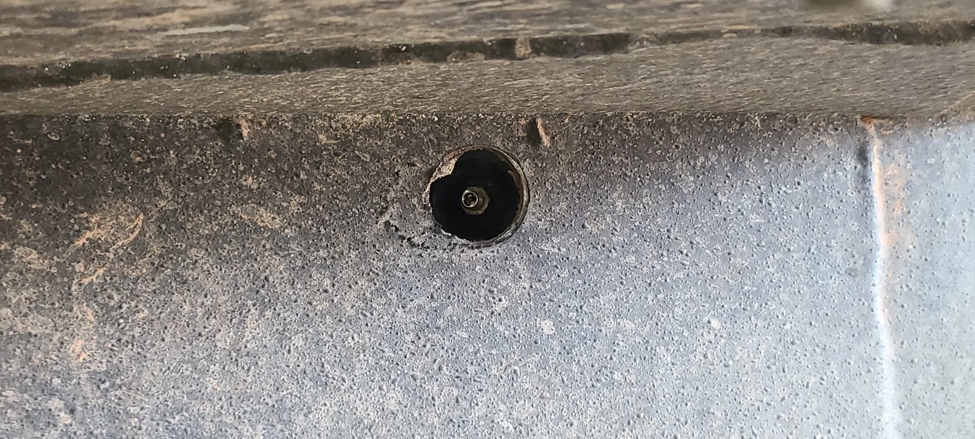

I do have a tiny air leak from one of my tires. Hoping to get it addressed on Monday. I just need these tires to hold up to get me back from round up, then i can look to replace them after i return from deployment.

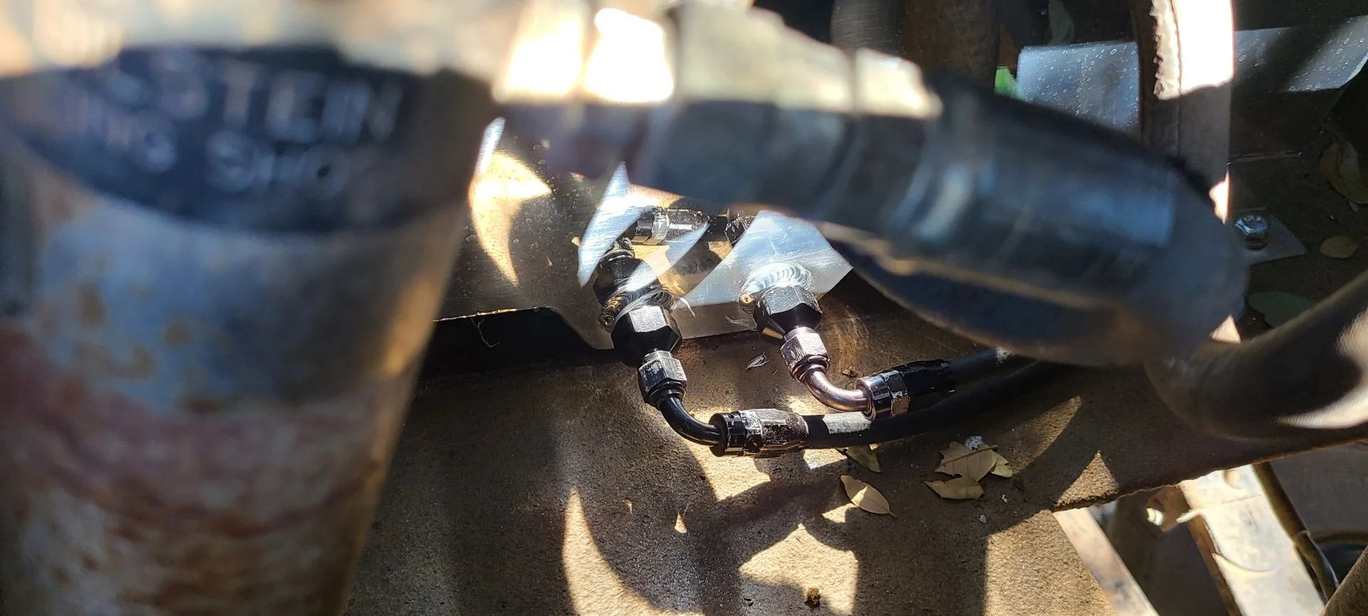

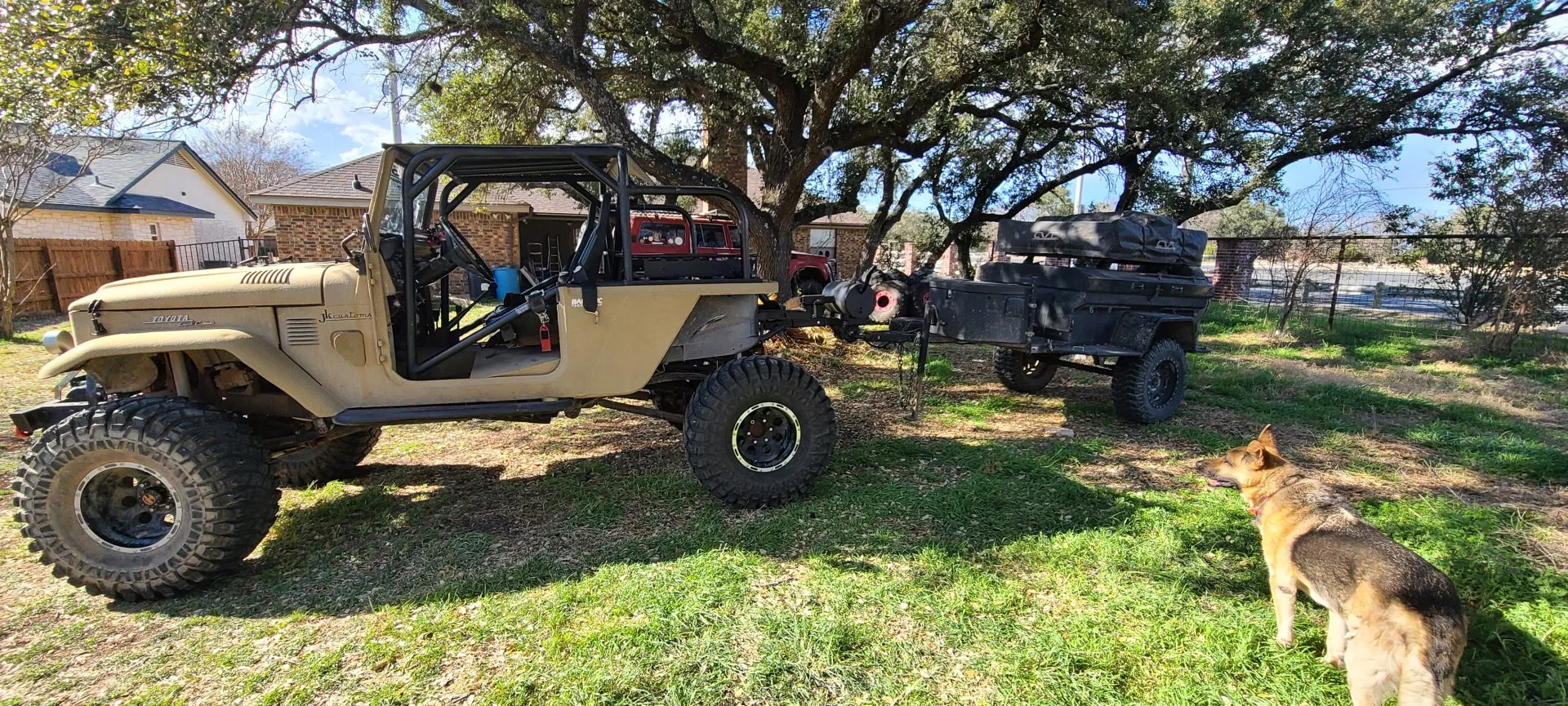

Got some insurance welds on and recharged the shocks. It sits a bit higher now and rides much smoother.

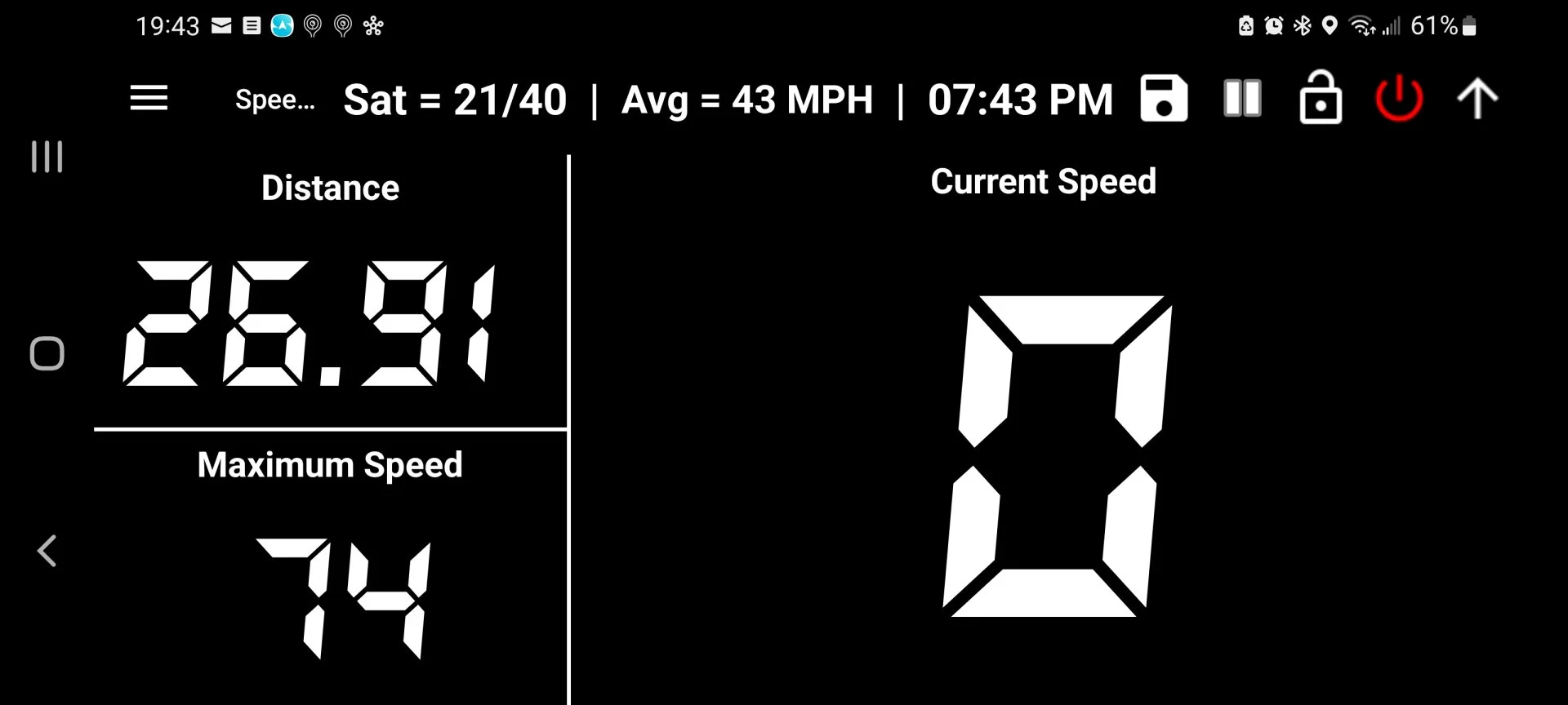

The tire seems to be fixed. Had to clean the bead and put fix a flat. Held 40psi overnight and I drove it doing 75mph. Didn't realize this rig could go that fast.

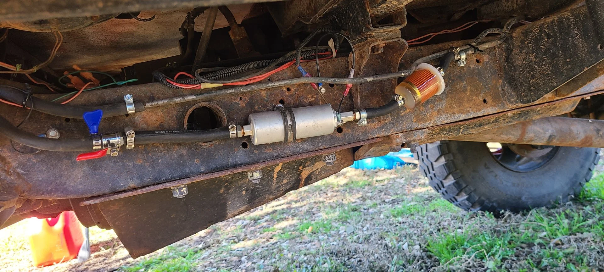

I replaced the fuel pump with a high pressure pump today. The old one got clogged up at Round Up and the parts store only had a low 6psi pump on hand. It was not enough to keep Penelope running right, but was adequate enough to crawl on rocks.

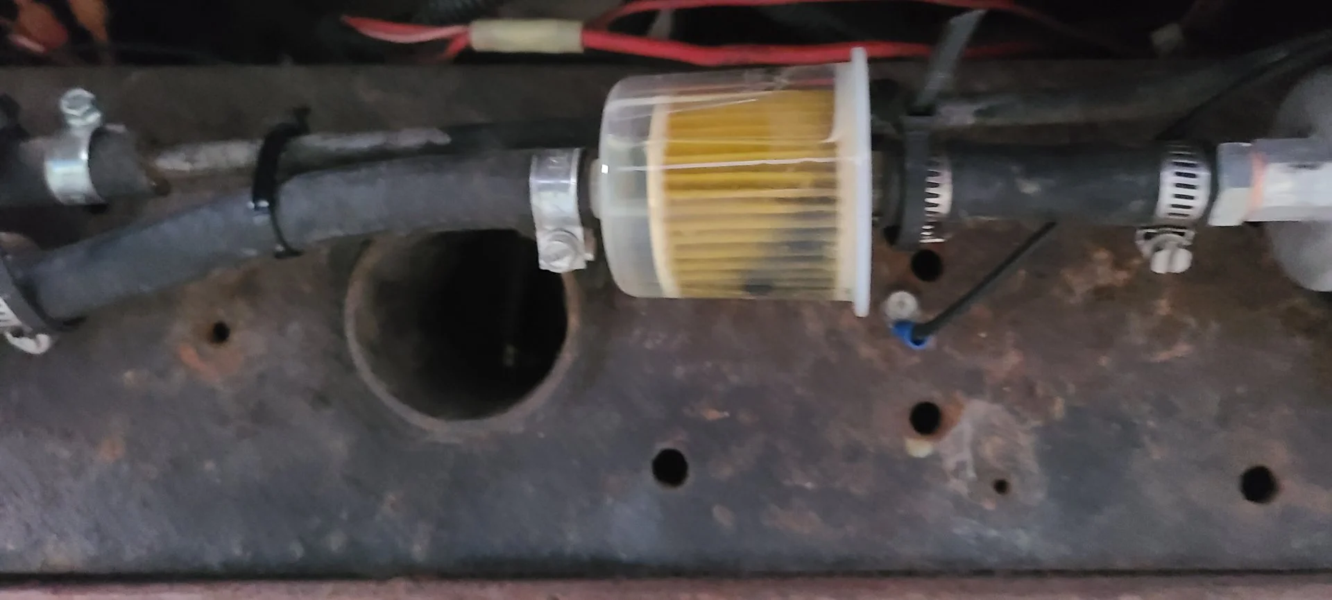

After installing the new correct 60psi pump. The engine came alive like never before. I was able to get it to 74mph in no time and could have gone faster had it not been for traffic. However, there is some black residue in the brand new fuel filter. It's a brand new tank with brand new fuel lines, any idea what could be causing this?

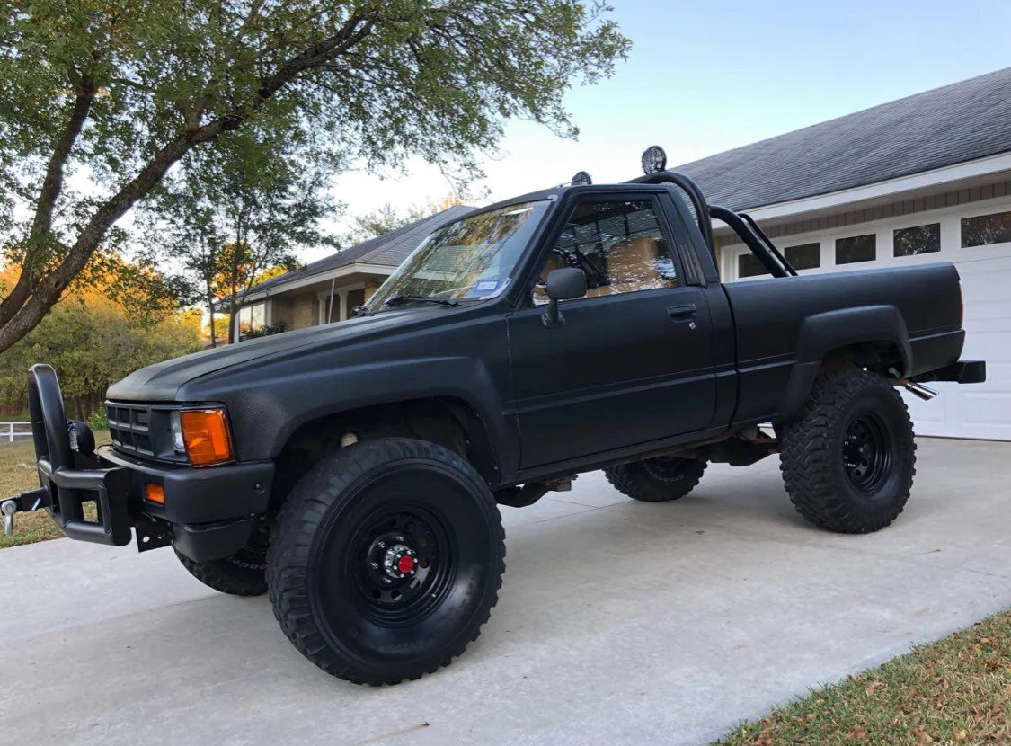

I'm also picking this beauty up Friday. I saw it wheel last year and was impressed. I'm going to build it for my 13 year old and give it to him once he's legally allowed to drive.
It's a 1985 4x4 pickup with a factory solid axle.

Very nice. Don’t let him ever sell it.
