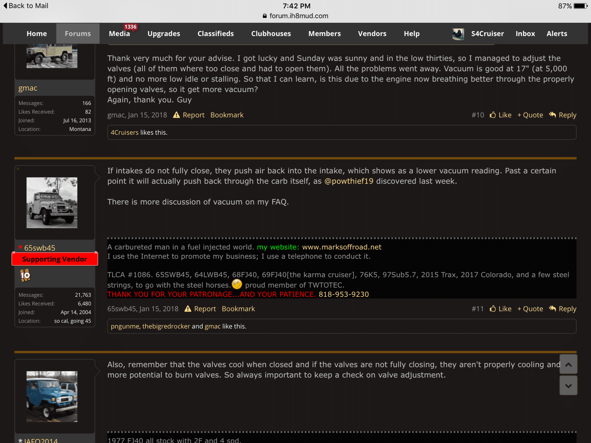

Checked vacuum at idle and it's really low. ~13" but fairly steady. Idle rpm is low at 400. I think my issue may be valves are way out of adjustment. I adjusted them before but maybe I totally fxxxed it up :confused:. I've done some reading and it seems possible that a horribly adjusted intake valve to actually push air into the carb and is maybe why that vacuum cap went missing.
So...going to go back to basics here. Adjust valves, verify timing then recheck vacuum at idle.
at 13 you will never have enough vacuum to open the secondary's. Does it run better if the choke is pulled out a little? If so look for vacuum leaks and adjust valves when the engine is hot. Could also retard timing to 9 degree and see how it does. Sometimes too much advance can cause the same symptoms.
All better! Root issue was being a tooth off on the dizzy. Relatively easy fix.
Readjusted all valves and set static timing based on ear and vacuum with 650 idle. Validated with timing gun and ended up being ~8* a 9*. Vacuum is now steady at 19.5"ish.
