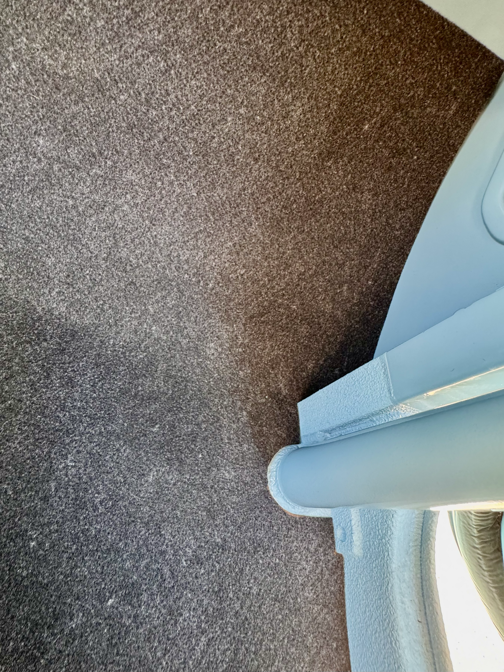

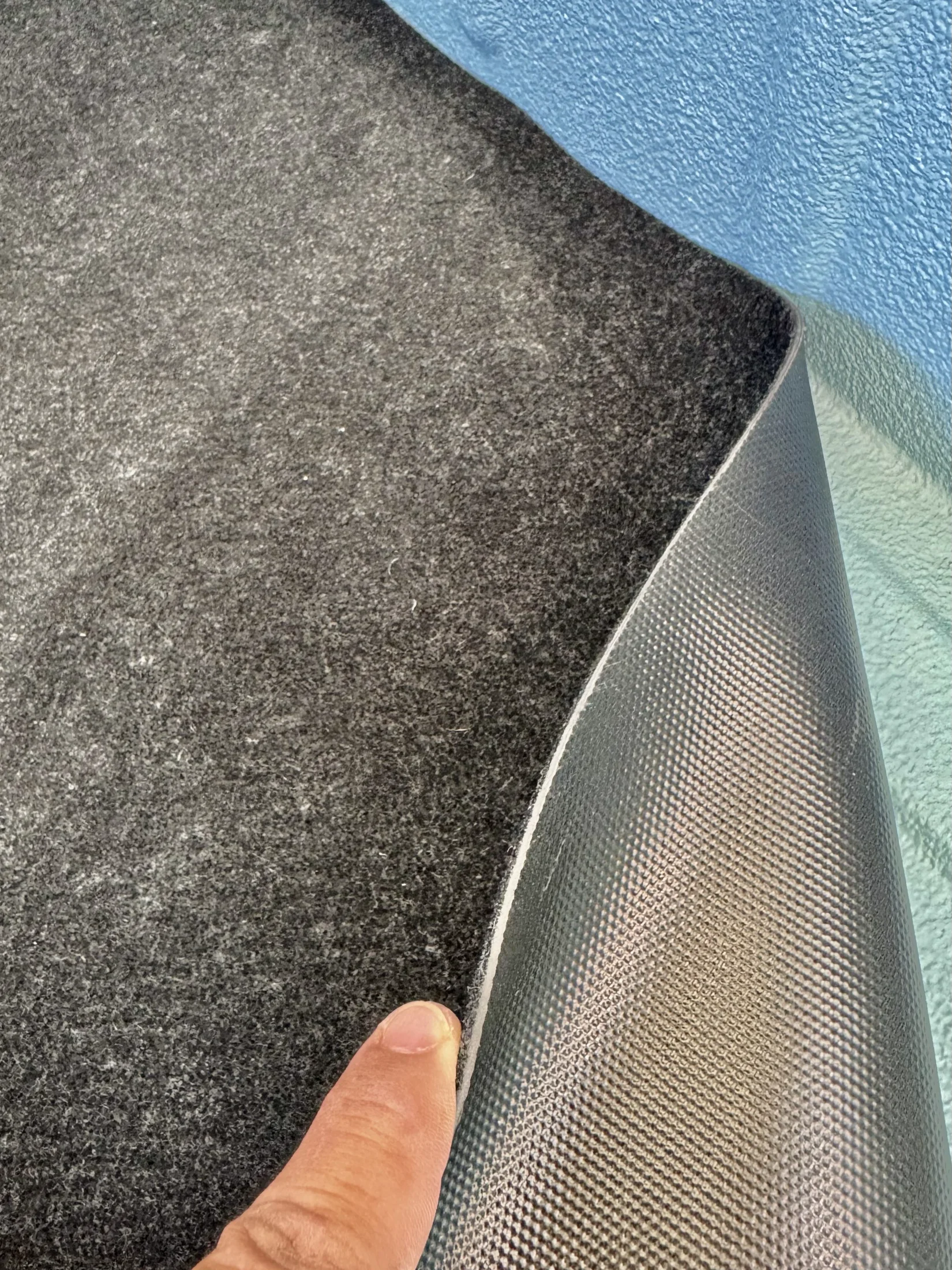

In the past I've done similar things with pickup beg mats and have had good success. Found this at Home Depot for less than $50. It's pretty thin for a bed liner but perfect for my purposes

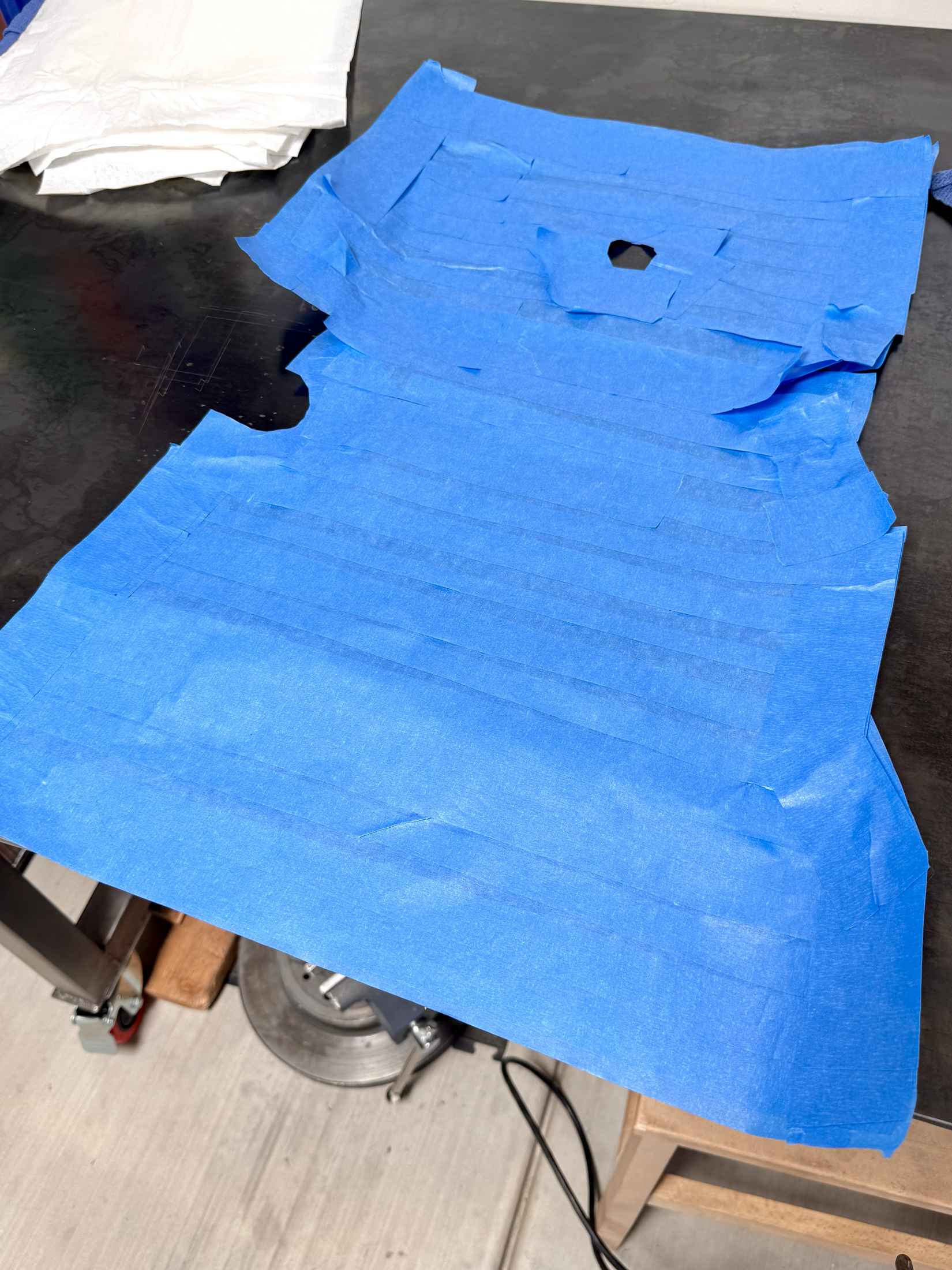

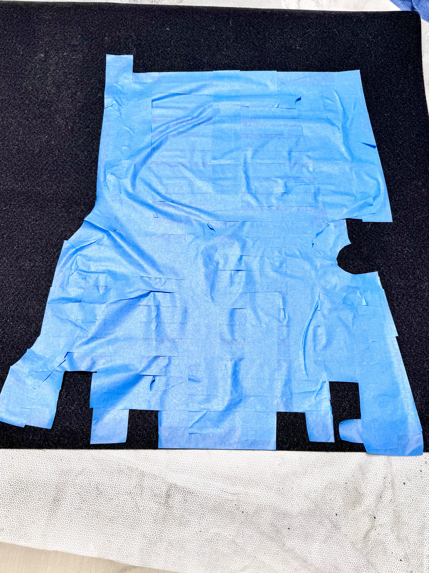

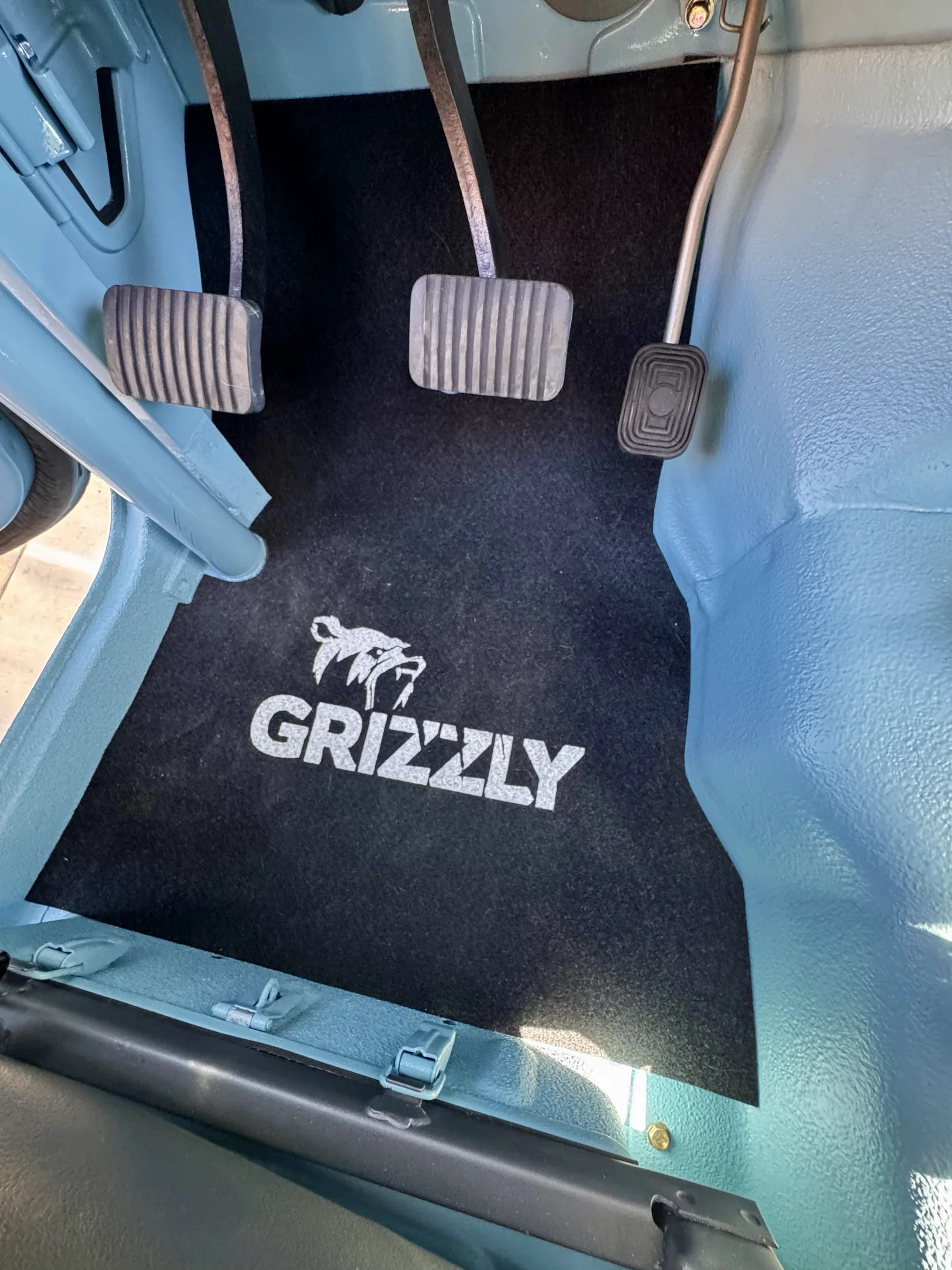

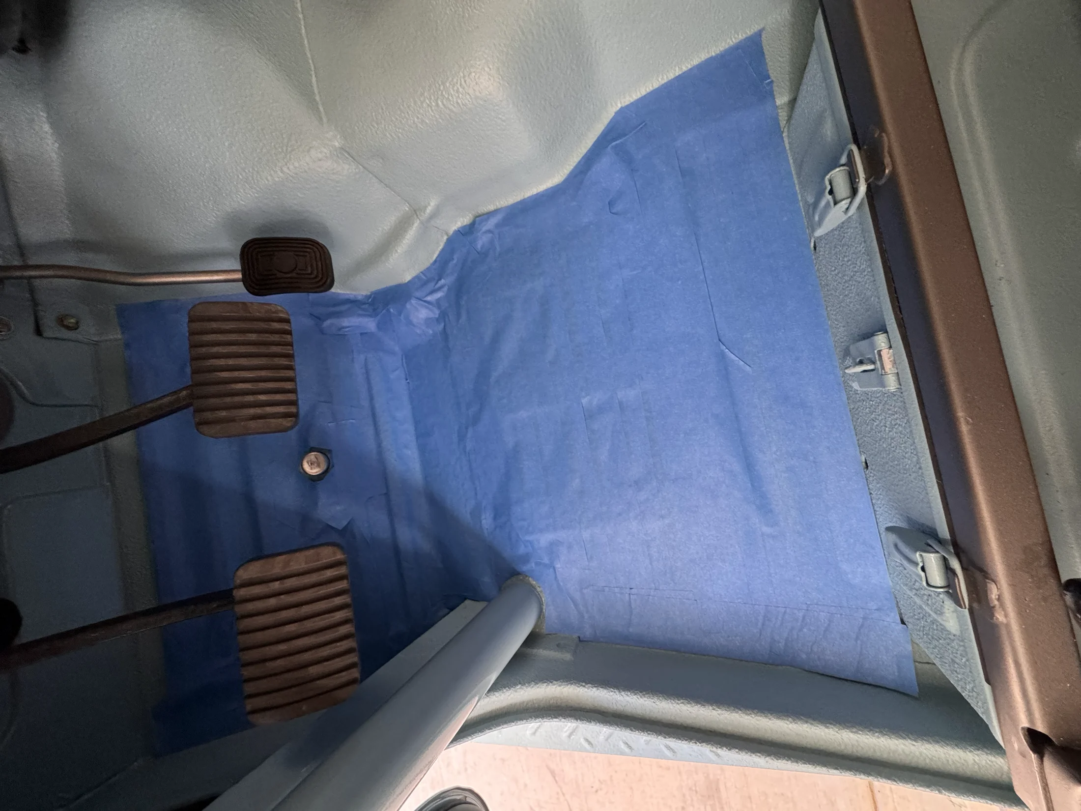

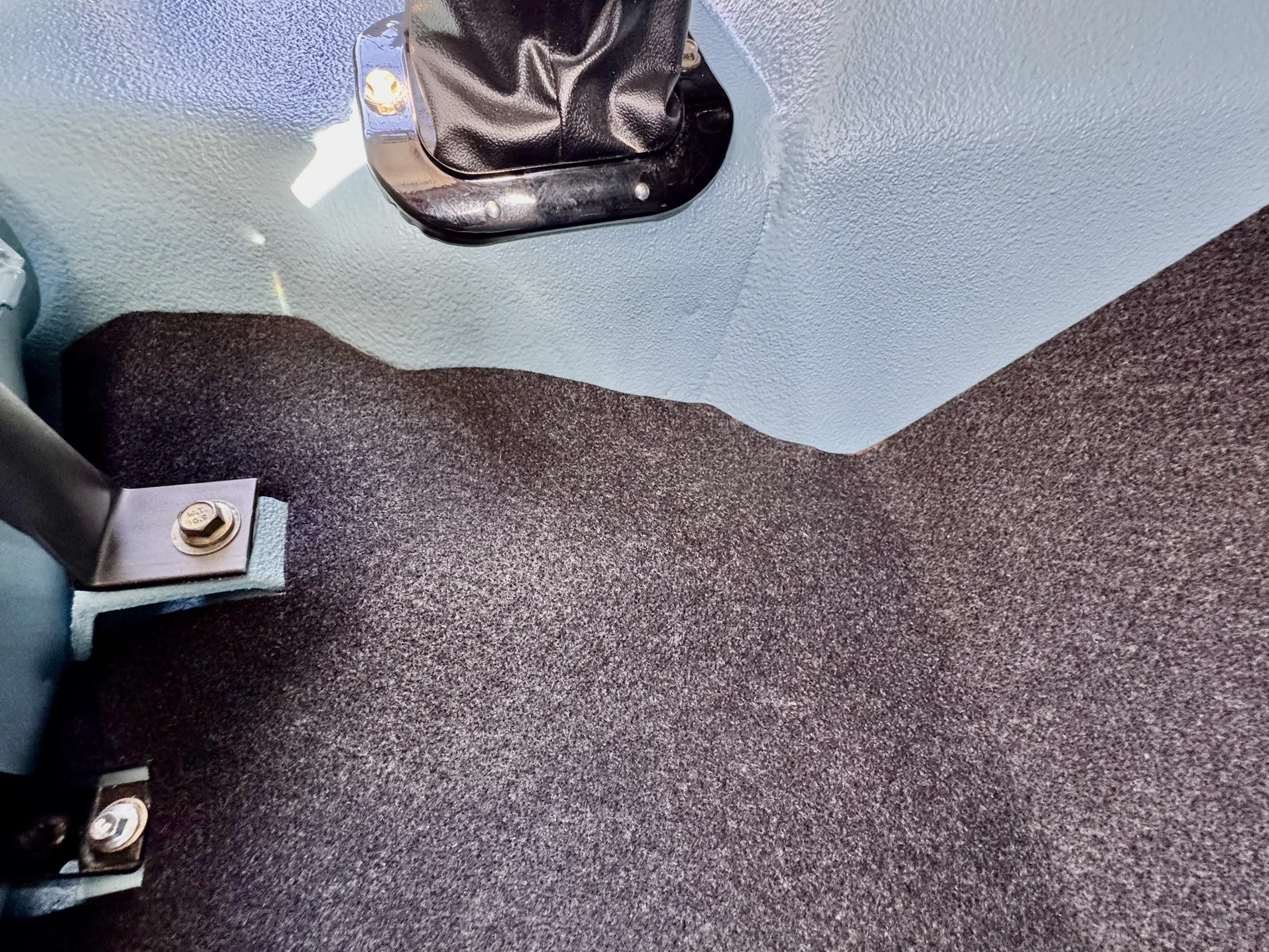

here is how I approached the front drivers foot well. I made a template out of masking tape. Starting from the tool box and layering/ shingling the tape forward so that I could peel it off in one piece. The tape is stiff enough that it gives a fairly good representation of the material and how it will lay

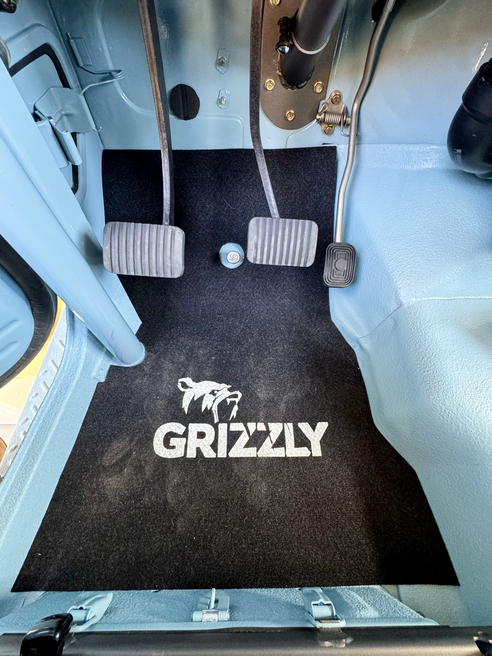

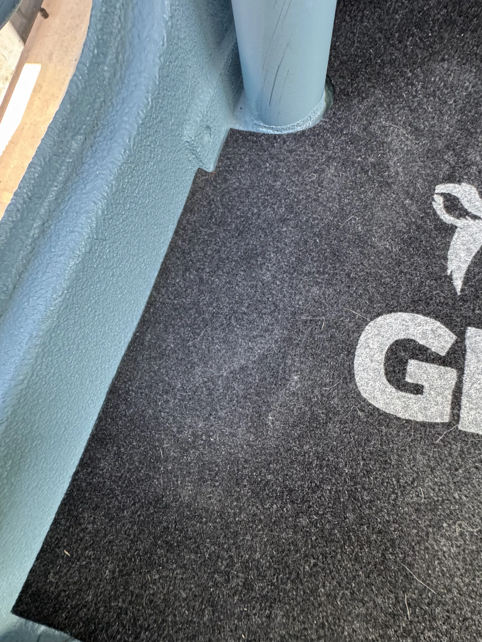

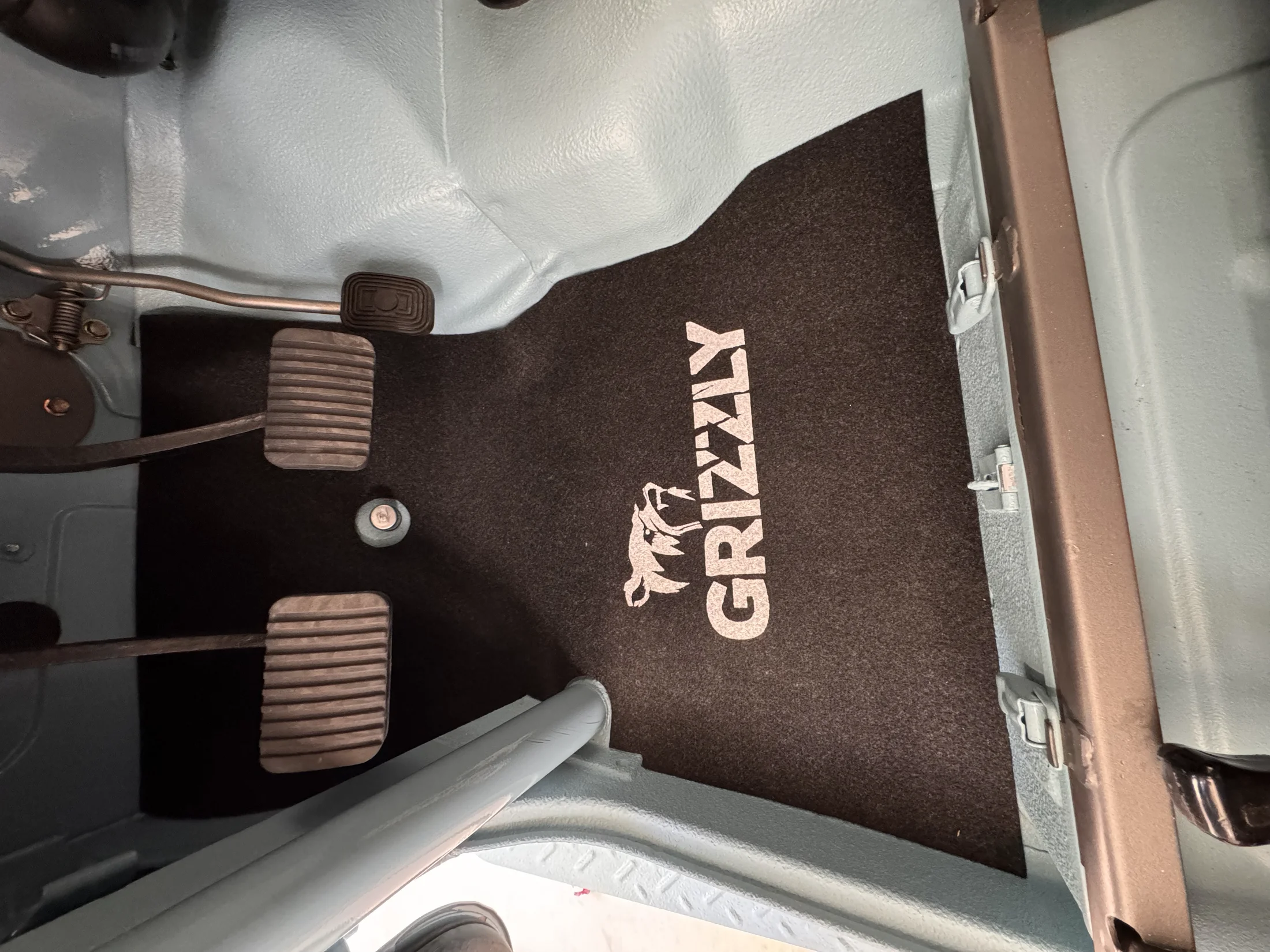

here's how it came out. I have mixed feelings about the grizzly logo - it was going to be somewhere... maybe next time I would have put it in the bed. overall it fits well even with all the different contours and bumps in the floor. I messed up the hight beam switch - made the cut out much too big

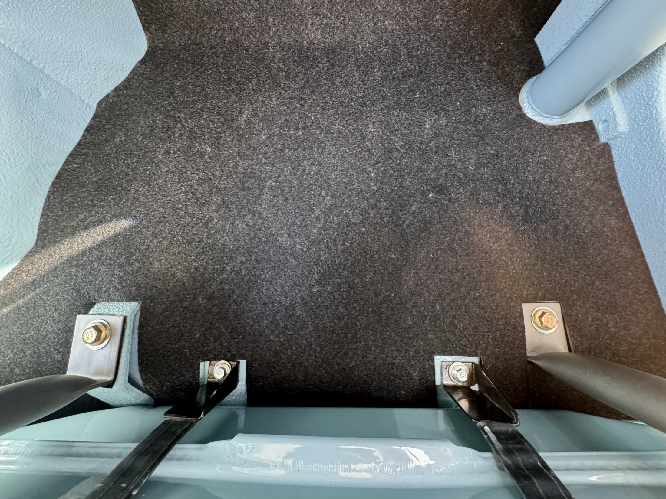

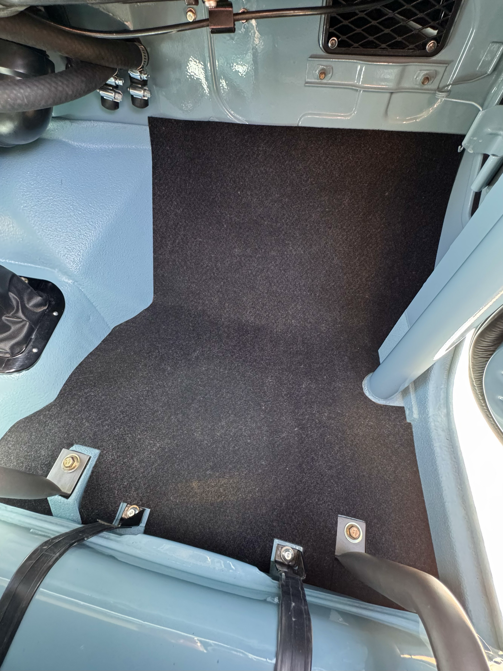

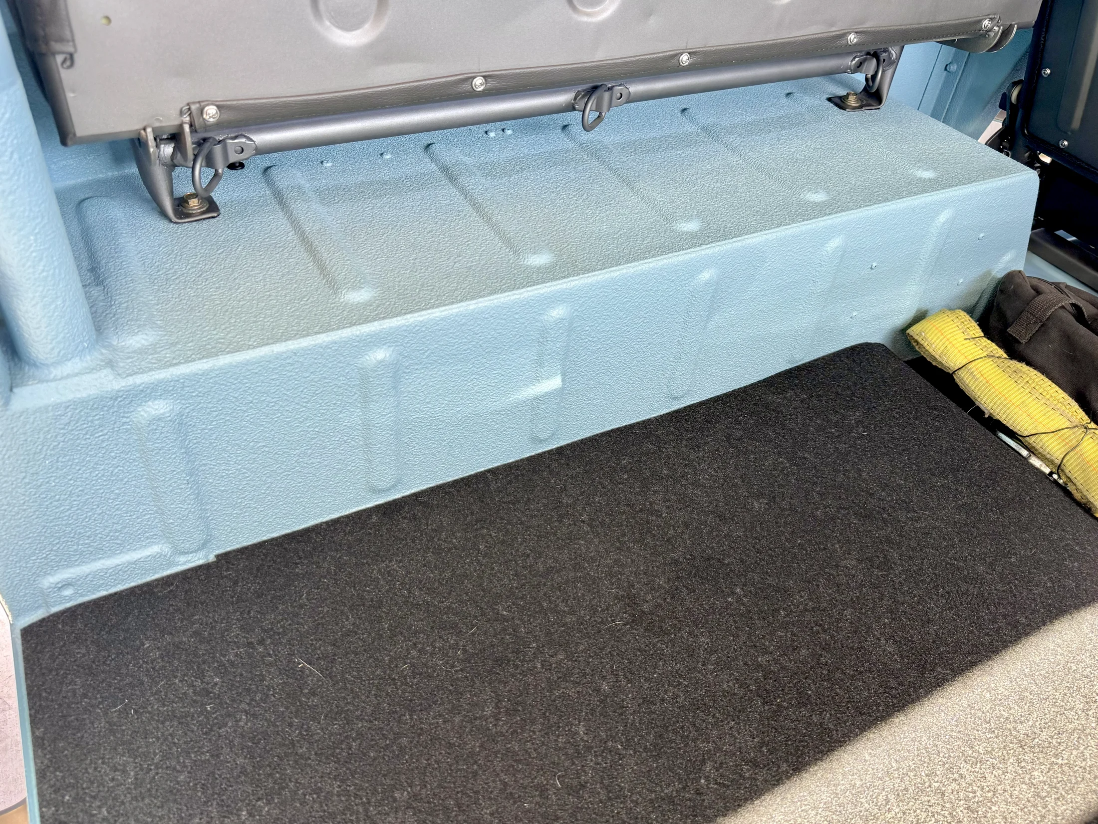

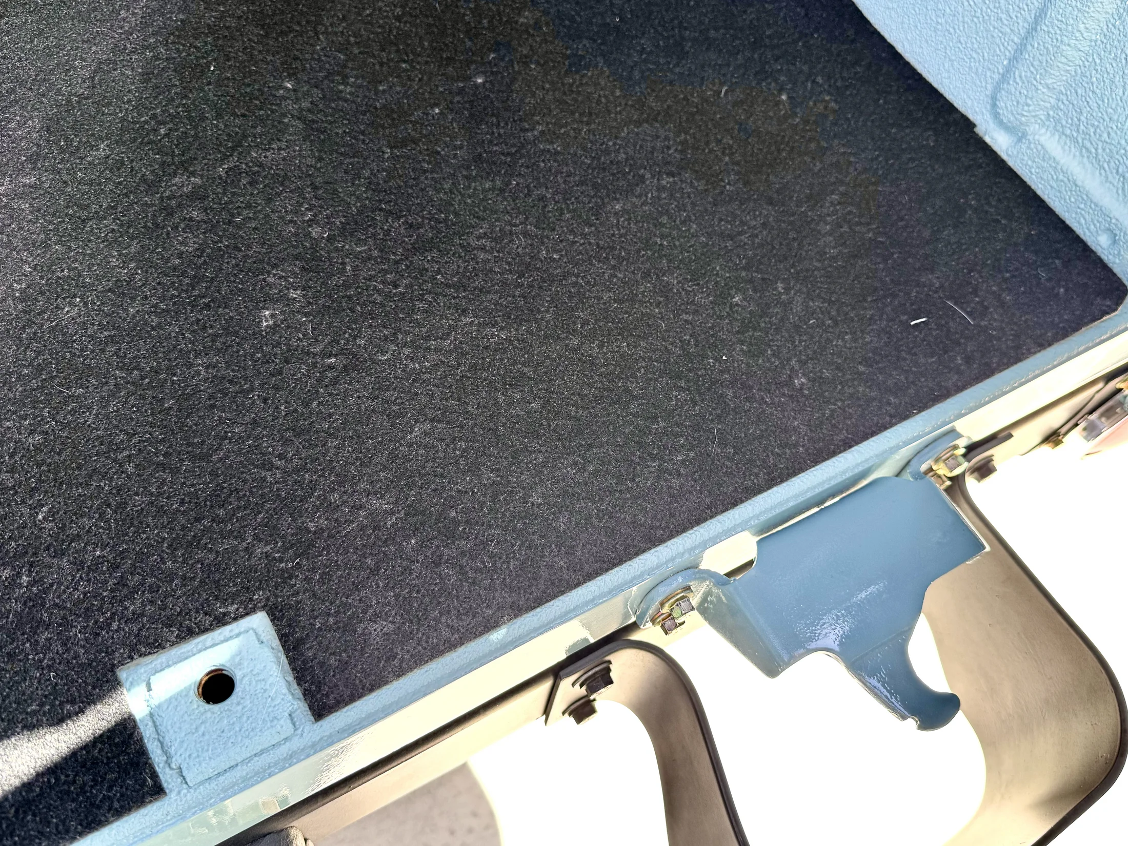

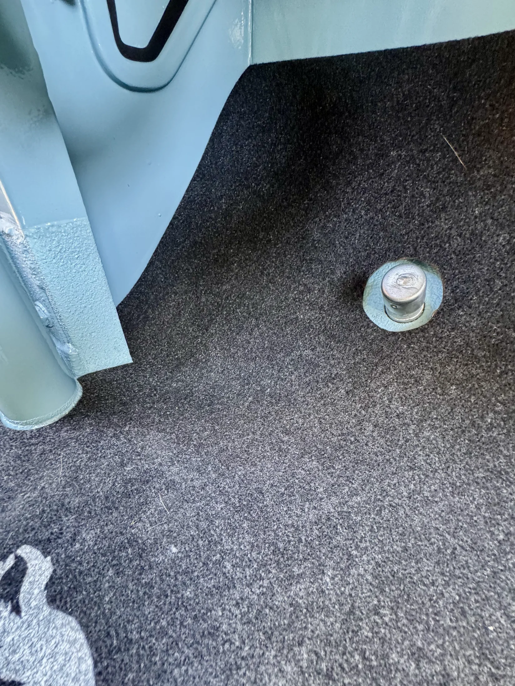

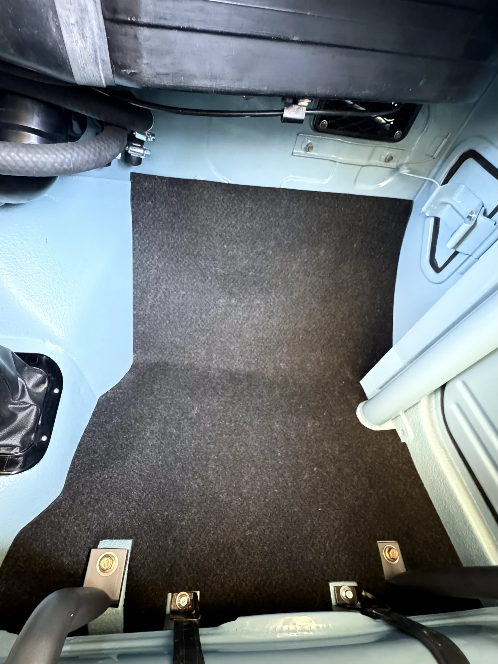

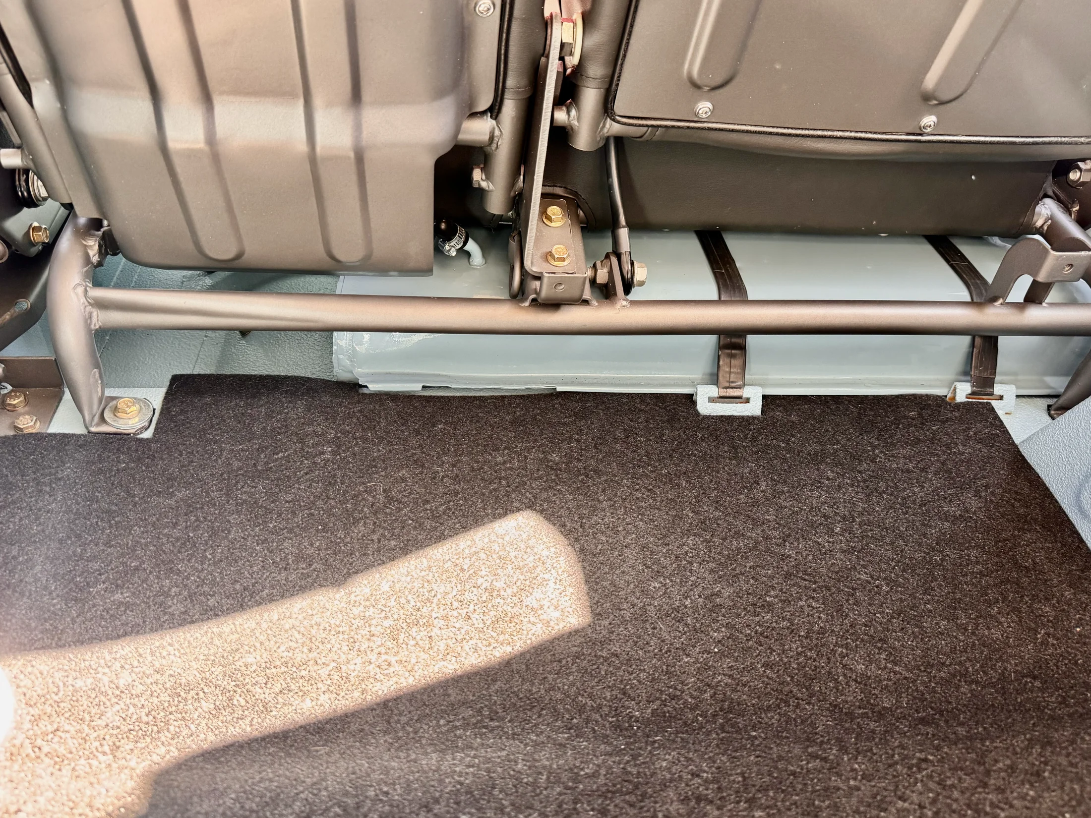

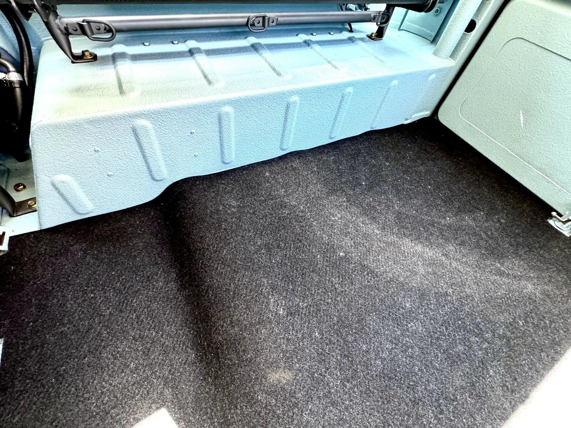

Passenger foot well. I had a tough time deciding where to start and where to terminate the mat. I'm still considering shortening the forward run but need to thing about it/ look at it for a little while. I wasn't sure if I could pull off the area next to the gas tank - figured worst case scenario, I could shorten it but some days you just get lucky and all the cutouts lined up. Again, I was amazed it conformed to all the different shapes in the floor as well as it does
I'd get a small, removable black or gray floor mat, and put it in the driver's footwell to hide the Grizzly logo, and use this as a removable piece that will catch and hold 80% of the dirt from your shoes. 2 mats means even more heat insulation, too.
