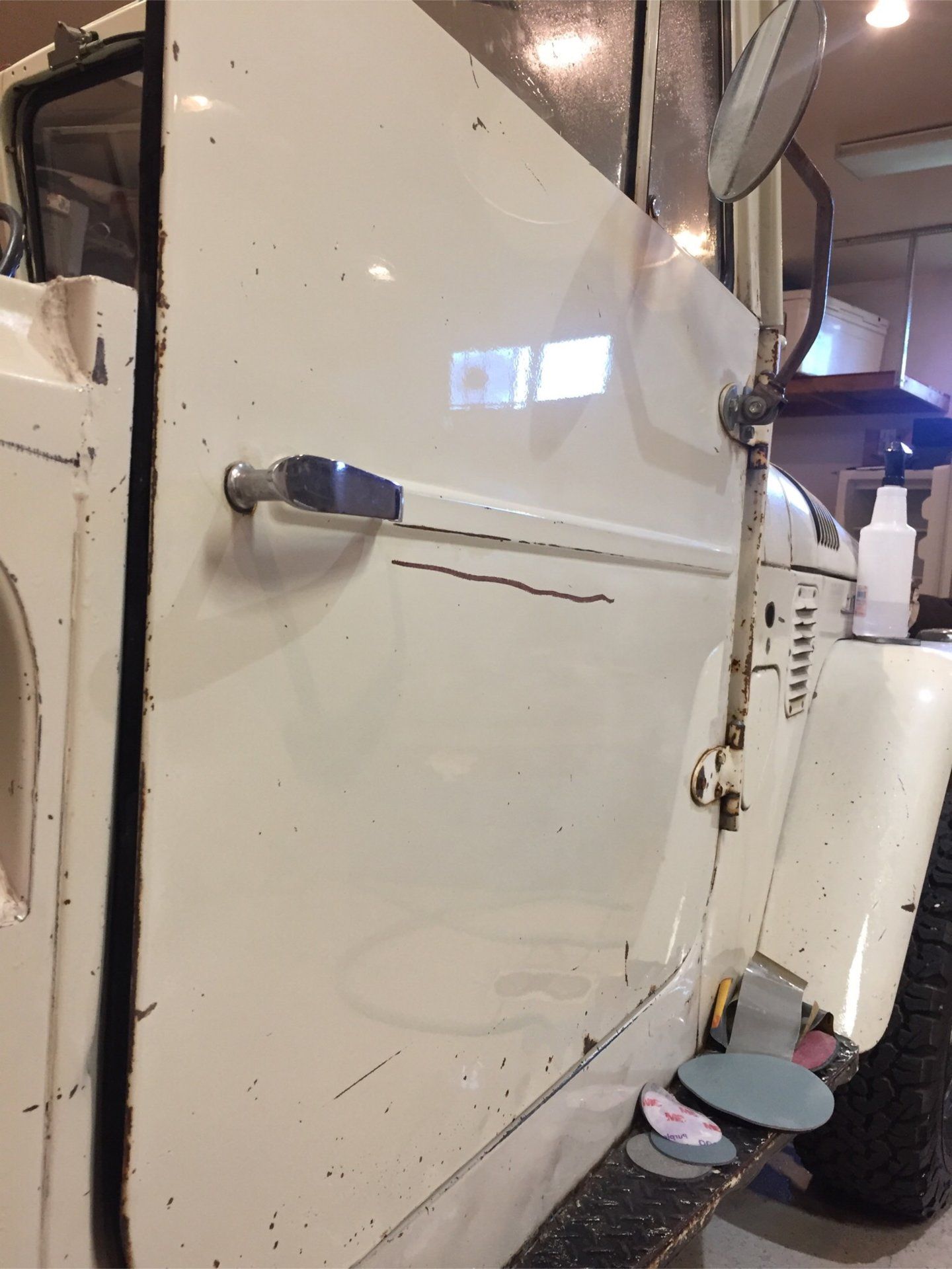

Wetsanded a small section of hood. Should have taken a before photo, paint was dull and chalky. This is bare paint, not waxed yet.

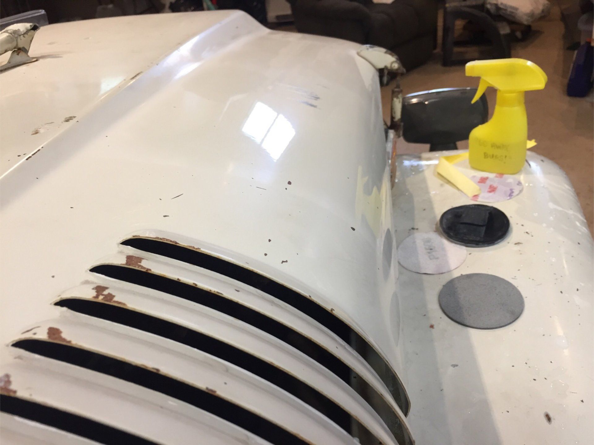

Here is a before of the next section. You can see chalky paint from tape forward to the first section I wetsanded.
Started with Paint Jobber house brand P1500. Ended with 3M Trizact P5000.

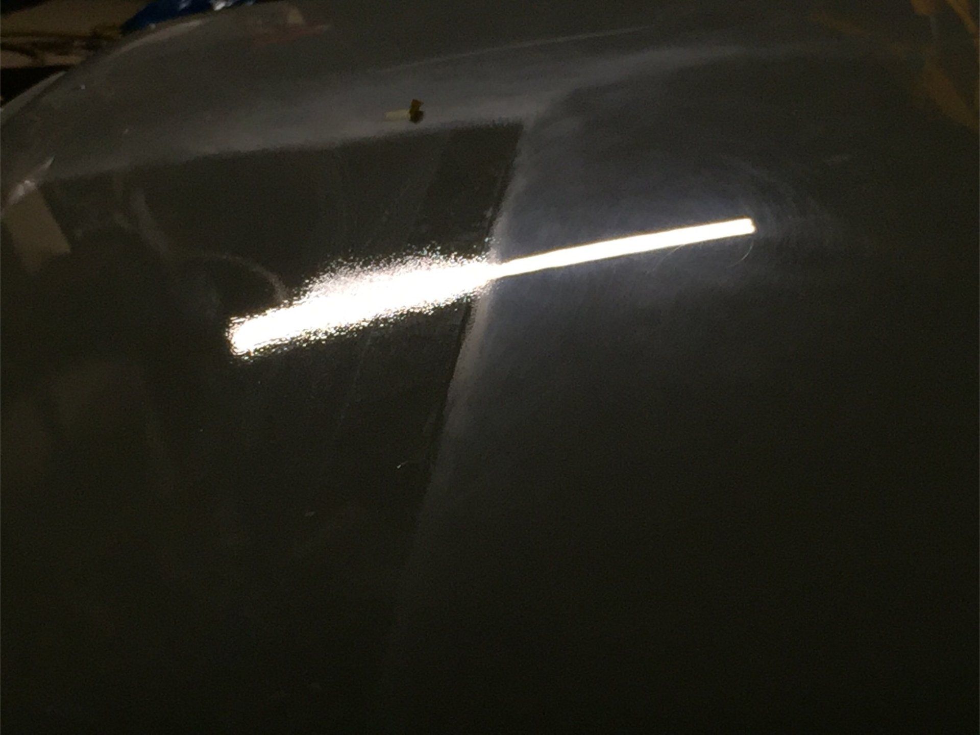

window reflection on part not sanded and the sanded section

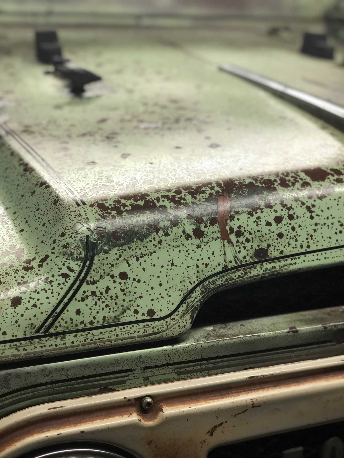

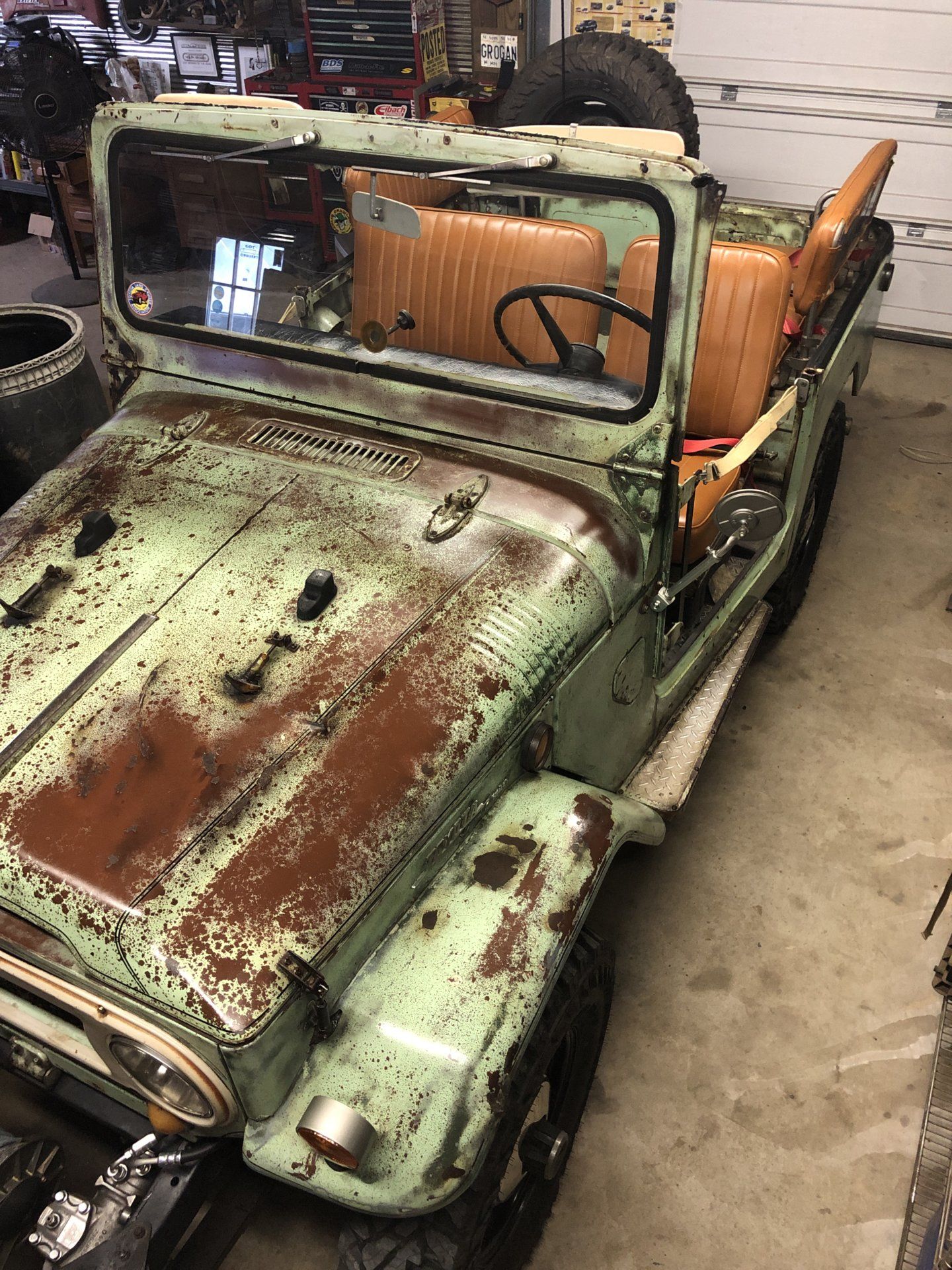

Giving Project Patina a fresh coat this morning. It takes less and less BLO to touch it up these days. The heavy rust areas have soaked in and stopped soaking but this temporary shine on the mottled paint always gives me a little chub.

Yes. Once the Converter is in and set up, CLR it off the paint. It’s important to wash the CLR off too. I use a wet towel then I oil or wax the paint.
Wax is best if the paint is smooth but if it’s real rough, I like oil.
For example, my Pig hood. I keep the remaining OE paint waxed but oil the bare metal.
