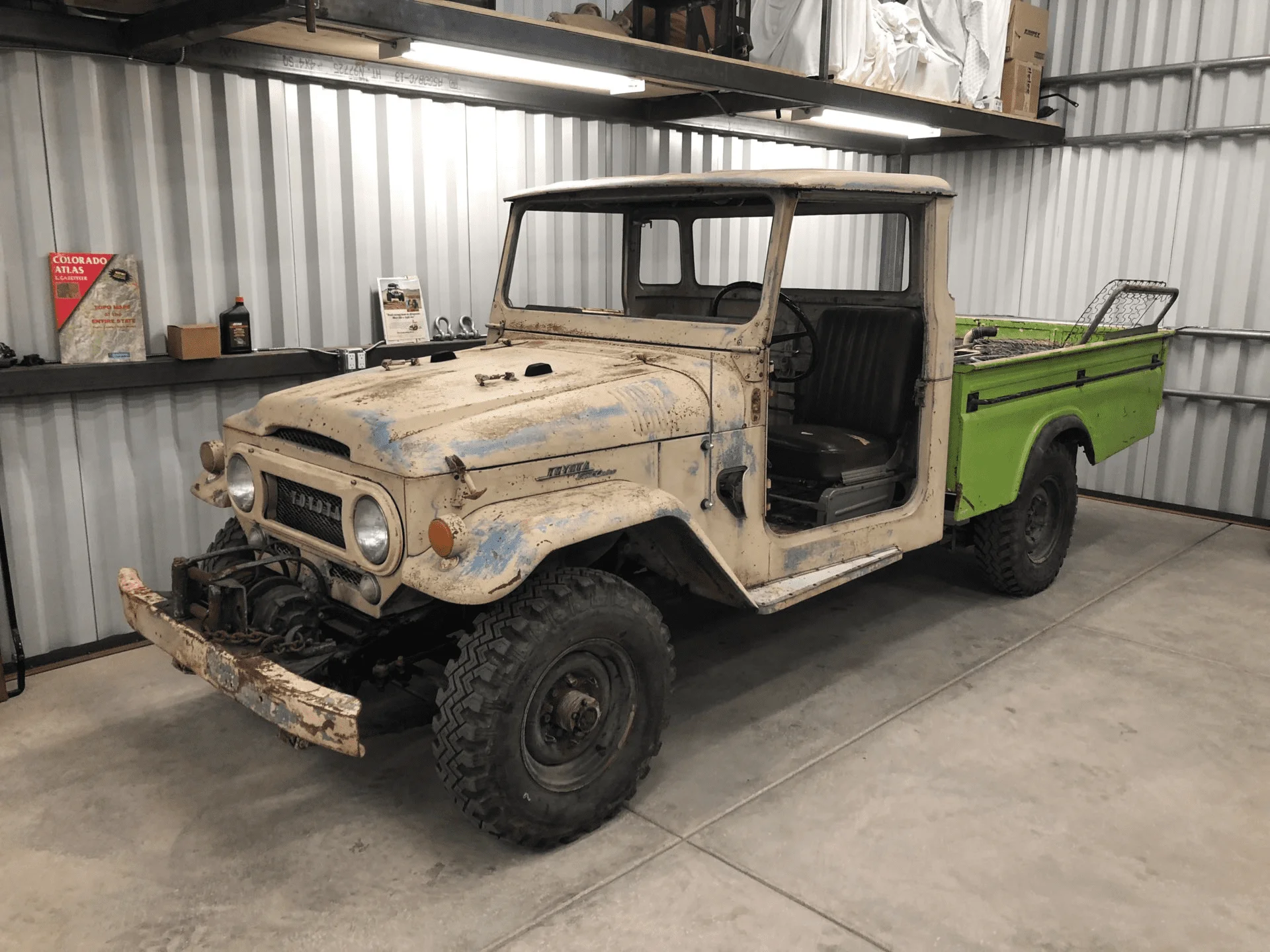

This is my new project. From this thread I now know how to preserve the cab. It, how do I faux paint the bed to match? Undercoat grey, then spray matching blue, then spray matching ‘tan’, and strategically sand down the tan to reveal the blue?

Was the truck blue from the factory? Man. I’ve seen 4-5 people lately be able to remove spray paint to reveal the factory paint.
If thats the Case it will be easier to match the blue
I dunno, that green’s pretty cool and probably easy to match.
The green is cool!? The green is cool!? OMG! OOOMMMGGGG!
Go get that blue under there! Killer color. Like @wngrog said, goof off works well. Try lacquer thinner too, it really won't hurt your original paint under there. On my old 60 I had great success lifting spray paint with urethane bumper stripper in a spray can. It would lift the spray paint and I could wipe it off before hurting the factory paint. It is an expensive route though, the stripper is pricey.

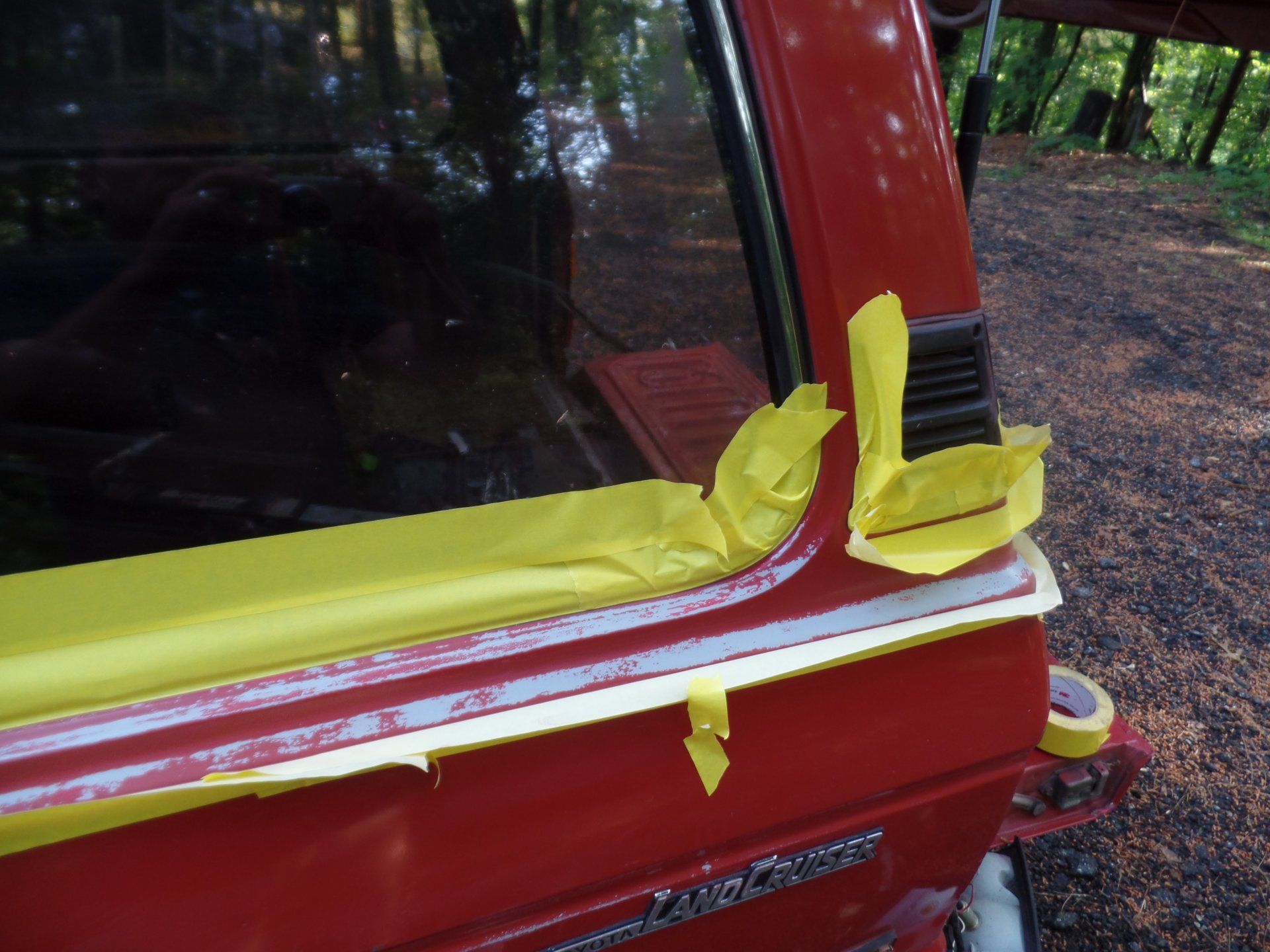

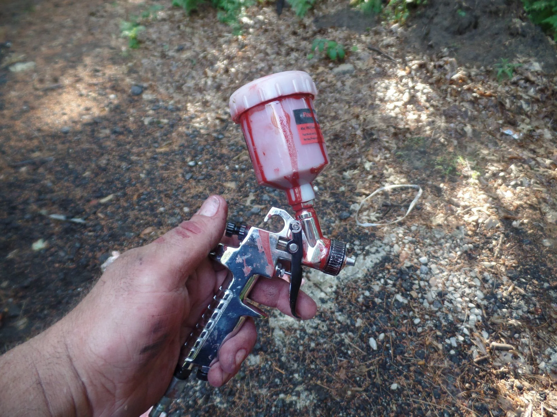

On my old 60, I wanted original paint as much as possible but also make it look nice so I stripped off the ridiculous pile of crappy spray paint and touched up the bare areas (that a previous PO was trying to cover with spray paint) with acrylic enamel that I tinted to match the original red. I used a cheap hvlp detail gun and feathered it in. Later I leaned on it with a wool pad and blended it in a well as I could. It never is perfect this way but pretty darn good.
