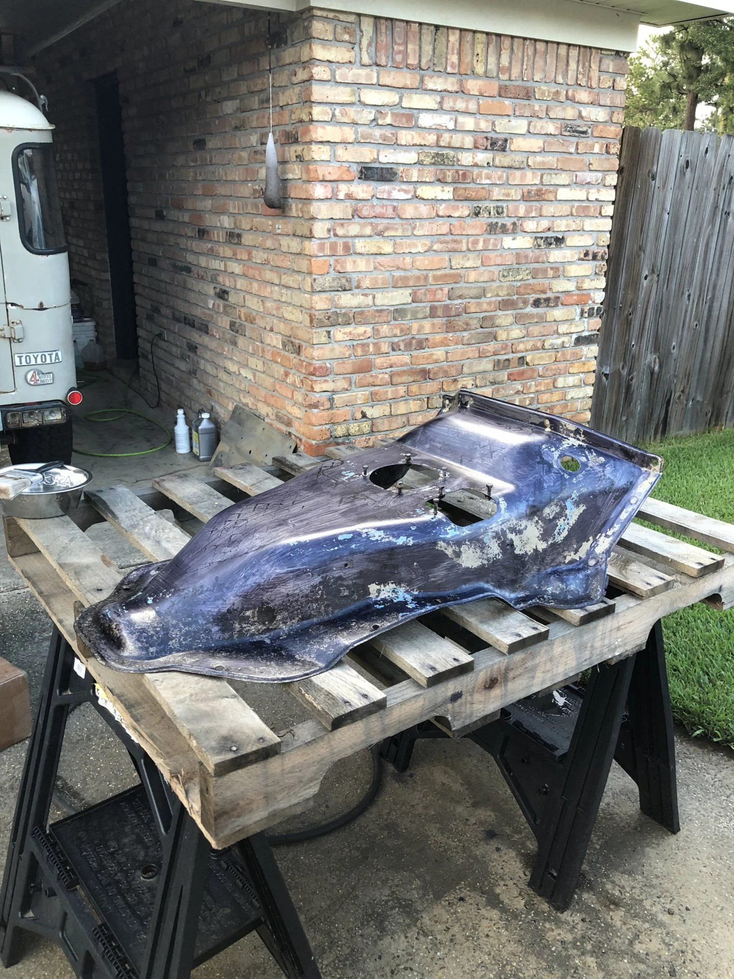

Im working on a 74 now that has great patina but also has some previous repair issues from the previous owner. Everything that appears red is some sort of primer to cover some of the bondo. They went buckwild and got a lot of it in spots that didnt need it. Any advice on removing it but not the factory blue underneath? Id be happy with just getting the red off and letting the metal do its rust thing.
My plan is to use Nolen's CLR method to remove all the oxidation from the paint and hopefully that will remove some of the red. I did a few test spots first and the CLR really brightens it up. Next is to use the rust converter once it comes in on the frame/undercarriage, but i dont plan on using it on the outer body. Its just too far gone to try and convert. Ill probably top it all off with the BLO as recommended in the first post.

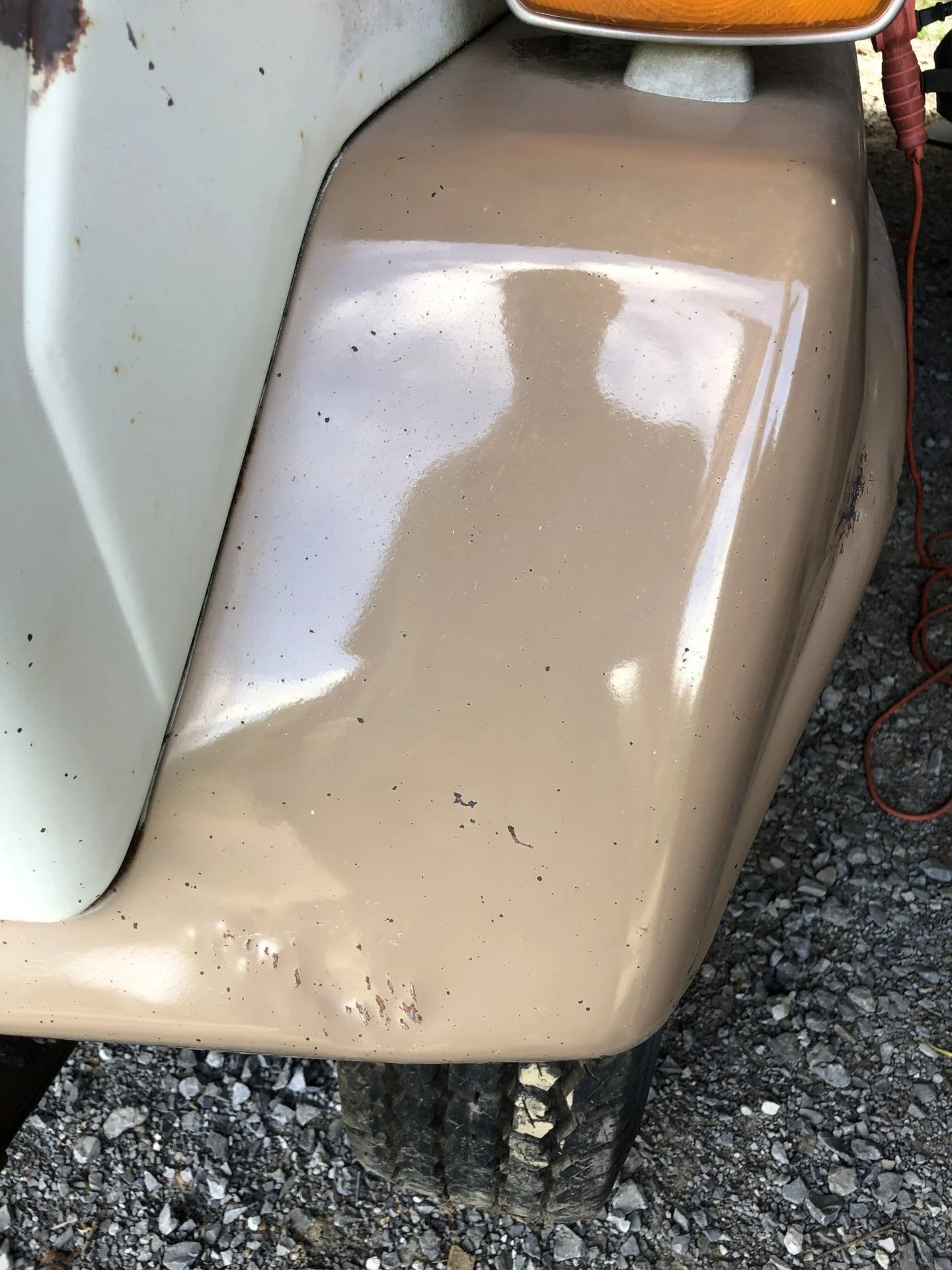

So this is where I started.

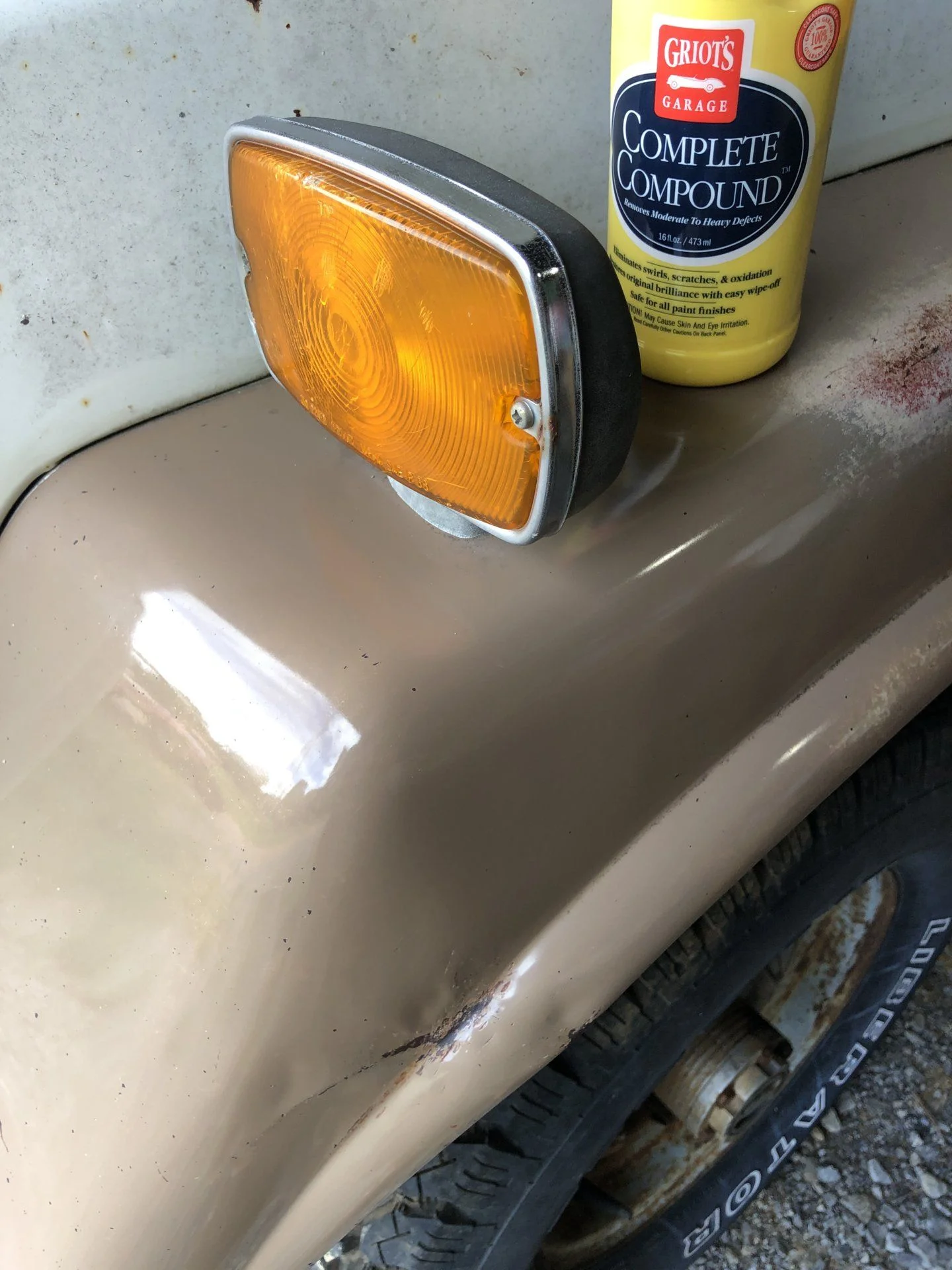

This is after just Griots polish and wax. No CLR needed here as the paint did not have a lot of nasty stuff in it like a horizontal surface will pick up
I did the same on the white section and it cleaned and shined nicely making the white go from a chalky white to the OEM off white it is supposed to look like
You can really tell the difference here in the upper fender white and the hood

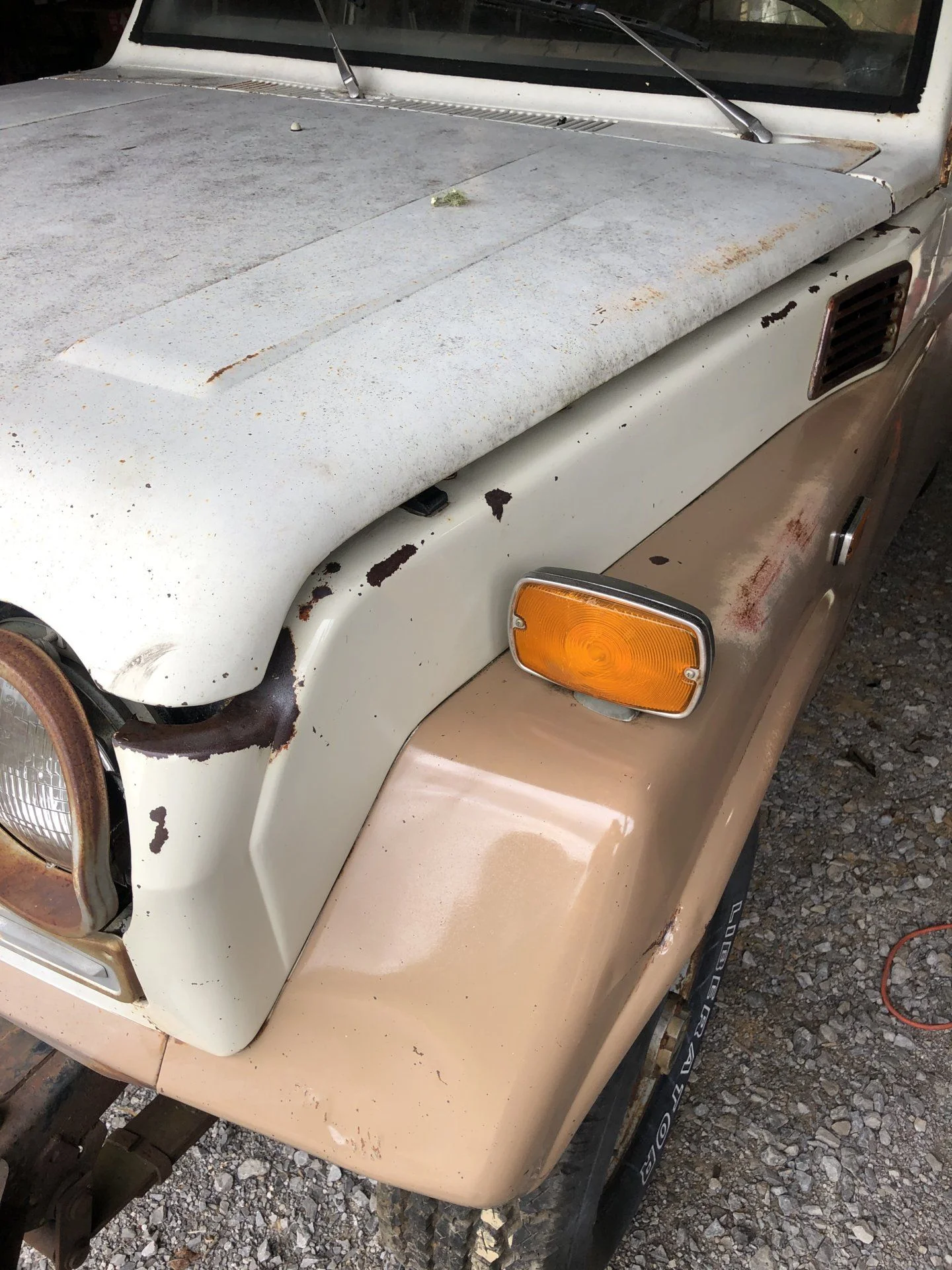

A potential local buyer came by today that is better at paint correction (turd polishing) than anyone I know so I was pretty much done with it until he decides if he wants it.

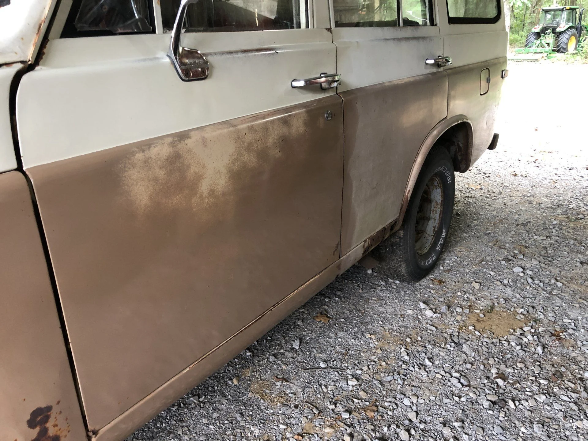

Then @Dustin Messina wanted a demonstration so I knocked out a door and part of the hood just to show the process.
Door was the same process as the fender. Check out this difference

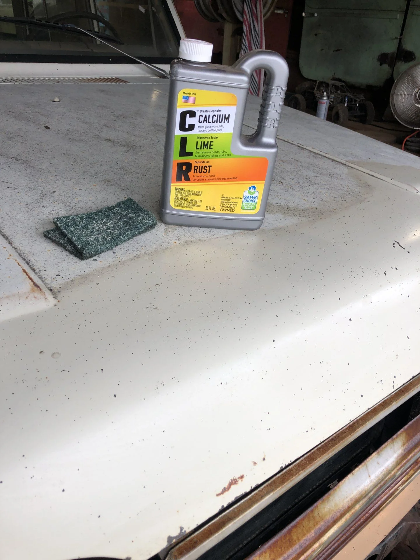

The hood had so much dirt in the paint I took it out first with a light CLR scrub. Light only to clean it but careful not to swirl the paint with the Scotchbrite
Clean but dull

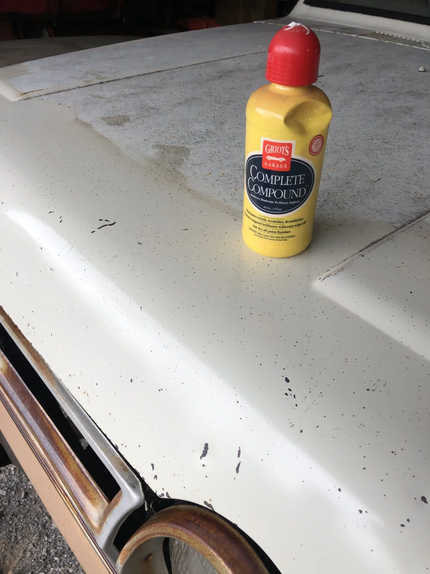

Next I polished that section with the Griots polish and orbital and the Cygnus White popped right out.

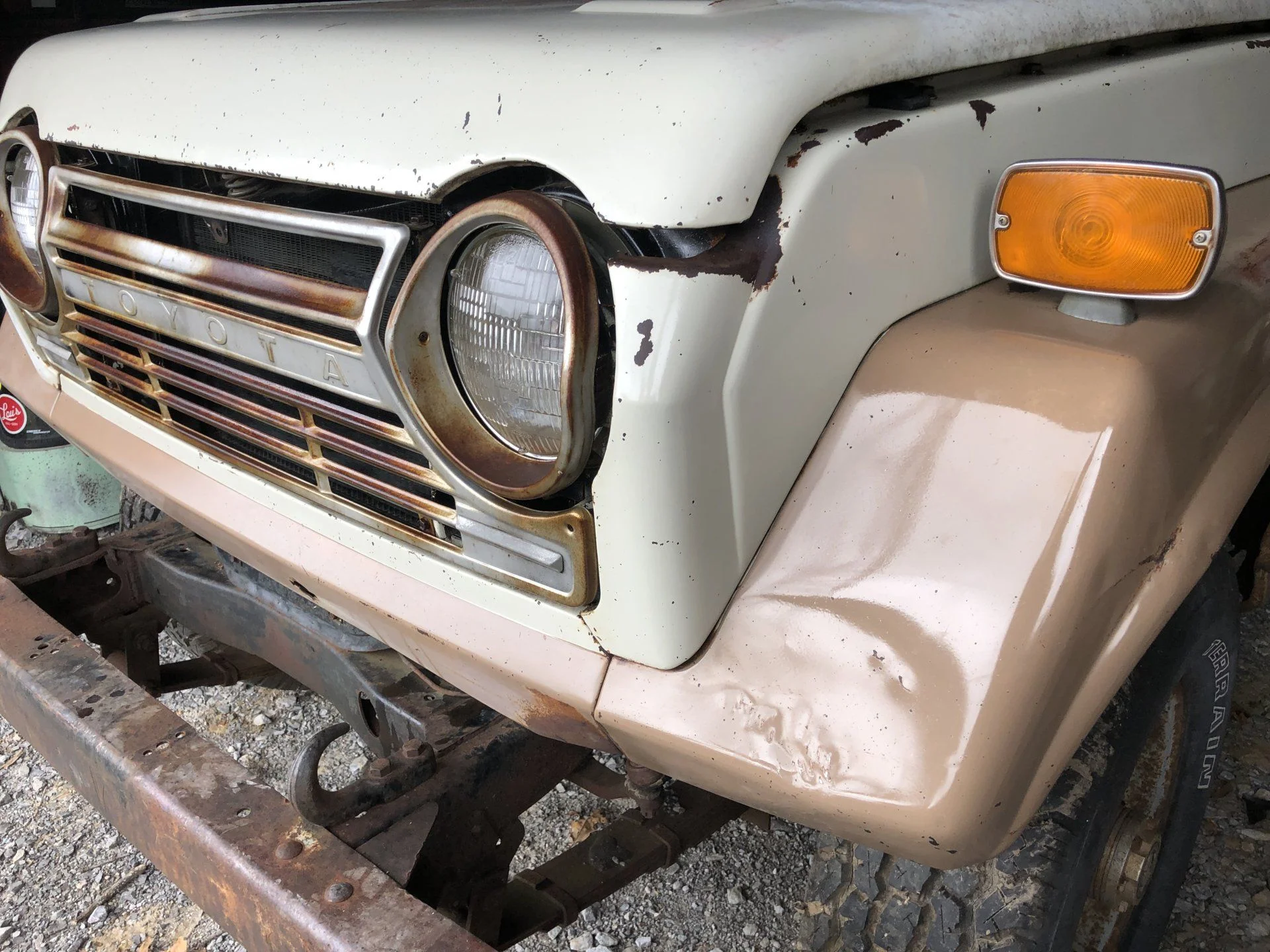

Finally, I oiled up the rusted metal areas and grill with some Fluid Film. I’m not even going to use Boiled Linseed on this truck. I think Fluid Film can replace it completely.

@wngrog do you dilute the CLR before use? How long do you scrub? How long do you leave it on the panel? How do you neutralize it? Wash it with soap and water?
I pour it straight into the Scotchbrite
Does not take much.
Scrubbing depends on level of filth as well as the condition of the paint underneath.
The Scotchbrite will scratch paint if it’s good paint and if you scrub too hard.
Start light. Work up in pressure.
Also, just water to wash off.
