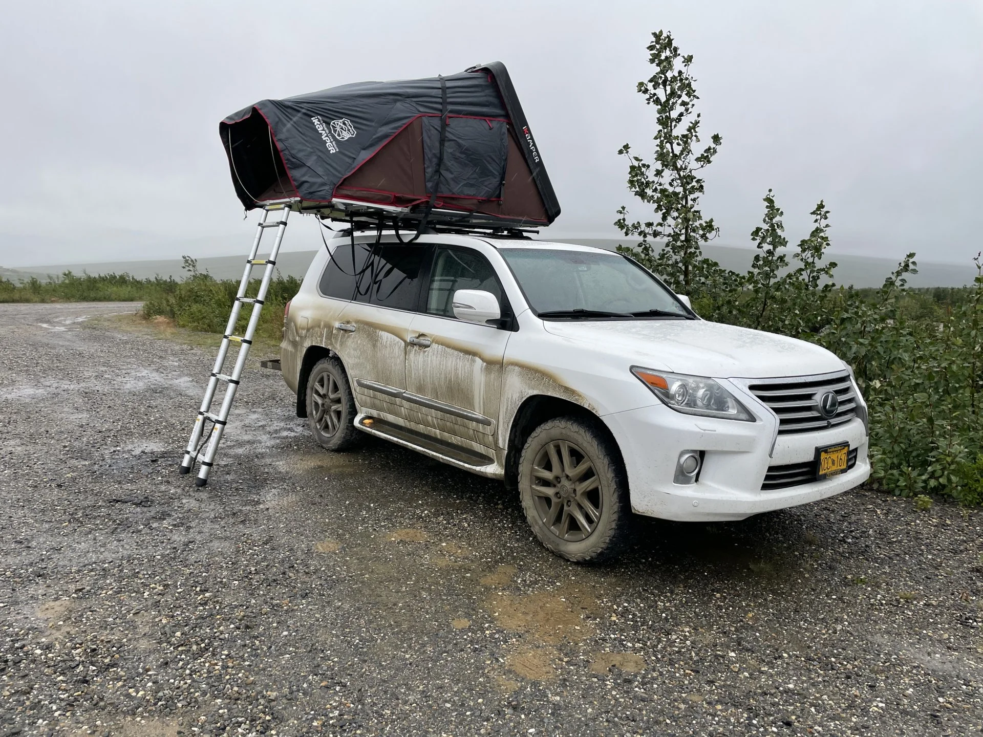

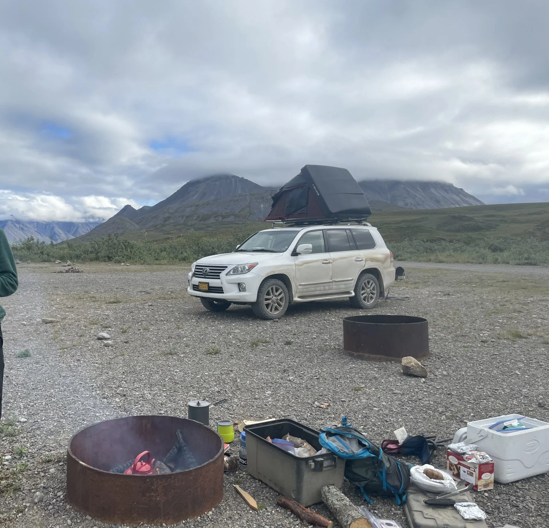

I have an iKamper. Really like it, sturdy, warm, waterproof, and an essential here in AK it is dark inside. I have the skycamp mini on yakama round bars on my 200. Usually I’m of the school bigger is better but with RTT’s I like the smallest I can get away with. The mini is a 2 person tent but me and both my Teens can sleep in it just fine. We use it on our fall hunting trip up the Dalton to the Brooks range here in AK. This year we had 4 days of rain, up to 50 mph winds and temps in the 30’s. The tent did great.

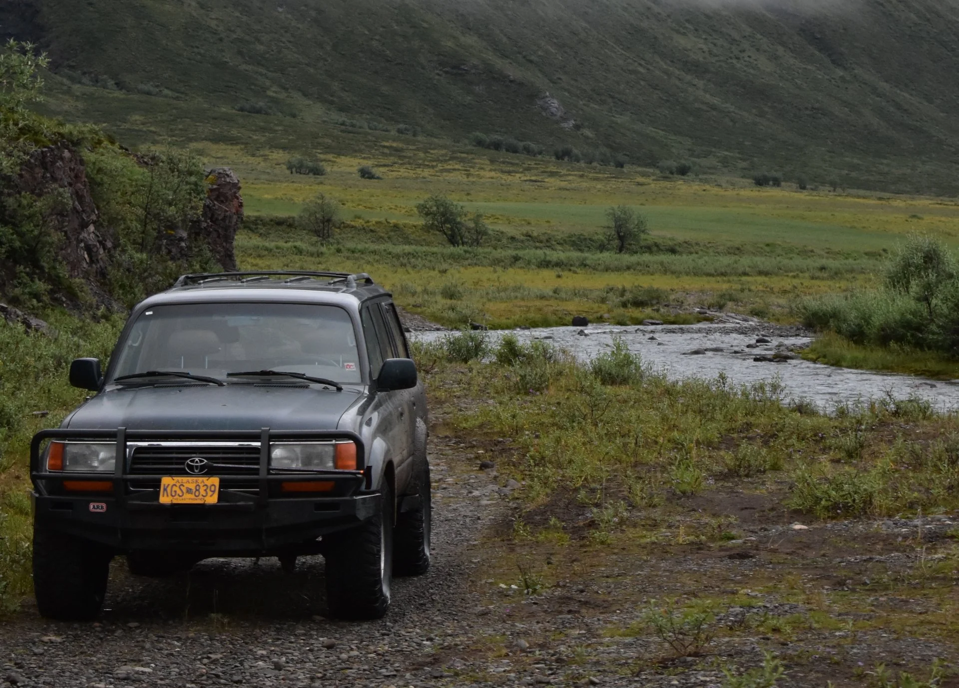

I use my almost just like you describe. Other than lots of pm here is my opinion. 2 questions.
How many of you will be in the truck and do you really plan on an aux tank?
The aux tanks good but hard to find a oem and often expensive. If you are not getting one I would not get a rear bumper. Just keep the tire underneath. I love my Labs rear but it is heavy and is a pain opening the back all the time. If you dont need it scrip it.
If there is only one or two of you skip the rtt and develop a system to sleep in the truck. Take the rear seats out and you have so much room, wind proof, water proof, easy almost no set up time, very stealthy if you sleep on the side of the road. Gear storred inside can be a problem but it can be overcome. You can roof mount gear or if you are in the woods just store most stuff in Tupperware bins and slide it out at camp. Valuable toss them in the front seat. We have been doing it for years. To us it is easier than a rtt. We also had a sleeping platform with storage under it. Eventually we got rid of it and now like just a big open space in the back.
Really focus on the mods that make it nice to be in the truck. Good led lights inside, USB plugs to use, screens on windows and a fan for the night. I still use a simple camp stove and cook really simple.
Truck mods, front bumper to protect for animals strikes, get some good Baja Designs lights and wire them to shut off when you turn off your high beams. Slee makes a harness. That way you can use them on rural roads to spot animals. Stick with 33s and keep it stock hight or very low lift, and spend some money on good shocks. They wil keep it handling good on the road. King, icon, Slee or Radflo. If you are traveling alone like I do then you need some extra. I would add a winch and dual battery. You dont want to be stuck or have a dead batt when out by yourself.
I am sure there is more that could be said. But remember, less is more! Keep it simple and bring less stuff. The less you have with you the better it will work.
Ps I am going to contradict my self a little. I do keep it light and simple using my backpacking gear while sleeping in the truck. But we have found it handy to have a very small backpacking tent along. It downed to be a really fancy one. We got a basic 2 person Big Agnes on sale and it has been great. Occasionally in NF land or state parks it can be hard to find camp sights in the summer.
We can find them early day, set up the tent and head out to fish or hike, kind of claims the spot. Also some days we like to lay in it and nap. Or if it is rainy some times we have stored gear in it to make more room in the truck. It is just a nice versital option.

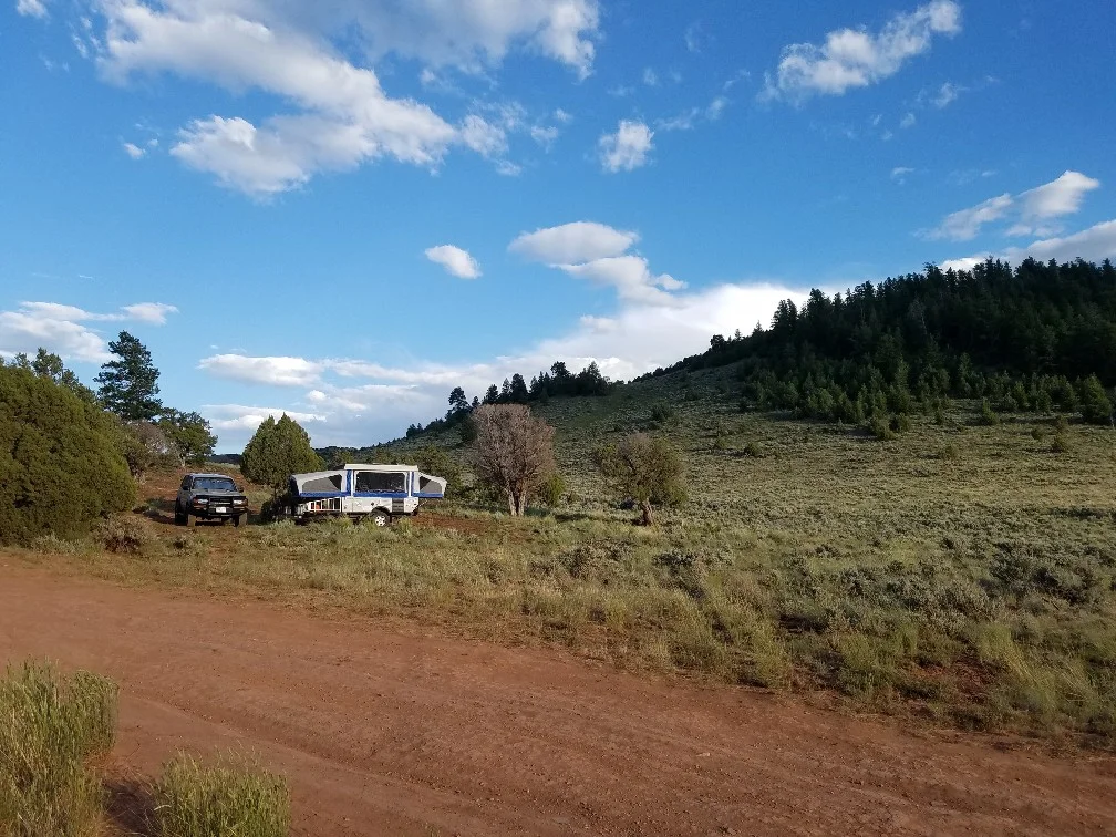

A camper isn't a bad idea but there are downsides to them too. I have a small pop up camper that we use quite a bit. My wife and I did a 4 week trip a few years back where we changed camp almost daily. Setup is pretty fast - take down in the morning is a bit slower when you time from wake up/breakfast to packed and ready to go - about 1 hour. Changing locations each day was a bit of a chore and tiresome. Finding a campsite is also harder with the trailer and so is turning around on dead end roads. Even just parking or driving in a city is more of a challenge. Another thing to consider is that your kitchen tends to be in the trailer so planning for when you are making meals is a consideration as you don't typically pop up the trailer just to have lunch, or you may be away from the trailer for dinner taking photographs or fishing - there are work arounds but it is something to consider. Gas mileage isn't too affected but stopping distance is. If you see some thing you suddenly want to stop for it is a lot harder to do than without the trailer. Also dirt road in a tent trailer are less fun and will limit which roads you chose to take and how long it takes to drive them.
We just did another 4 week road trip - this time with kids and chose to stay in each campsite for several days at minimum and up to 10 days in one spot. On driving days we stayed in hotels and it was a much more relaxed trip that way. The extra space of a tent trailer with a kitchen is nice and being able to use a heater in the cold mornings/nights is nice too. If it was just my wife and I, it would boil down to how often we were changing campsites and what type of roads we are taking. Most dirt roads in the lower 48 are fine but there are some camping places that we enjoy that we can't take the trailer to but the 80 gets there fine without lockers. The tent trailer is more comfy but can be cumbersome, the 80 alone is a little tighter/less comfortable but allows for more flexibility in where to camp, when and how often you stop and which road you chose to take. Just food for thought.
Yeah opening up the pop up does take some time. However now I have a atv winch that opens the roof it does open pretty fast. I would say I can open up the pop up as fast as most people can open a tent. With the solar panel and dual batteries I added it is able to be pretty self sufficient. I've taken it on some very rough roads. I wouldn't do helps revenge with it. I would just park it at a campsite in moab and set it up. Then go do trails with the 80. We get some pretty crazy wind at higher elevations in Colorado and it has been fine. I use the grill a lot. It has a propane grill that clips to the outside with a quick connect plug propane outlet. I guess driving through a city is a little more of a chore with a trailer. I have to park and walk in rather than go through the McDonald's drive through. But as a trade off I get some nice amenities while camping. Sitting on a toilet and taking a shower is awful nice vs digging a hole.
