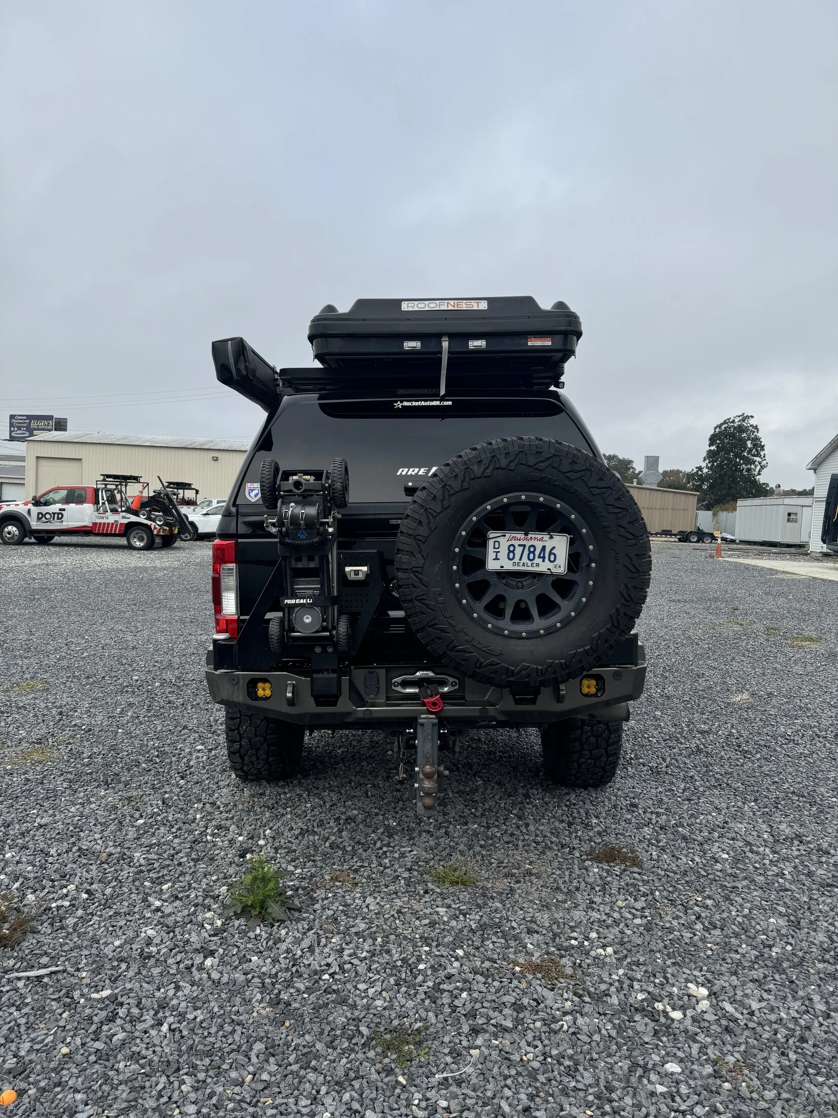

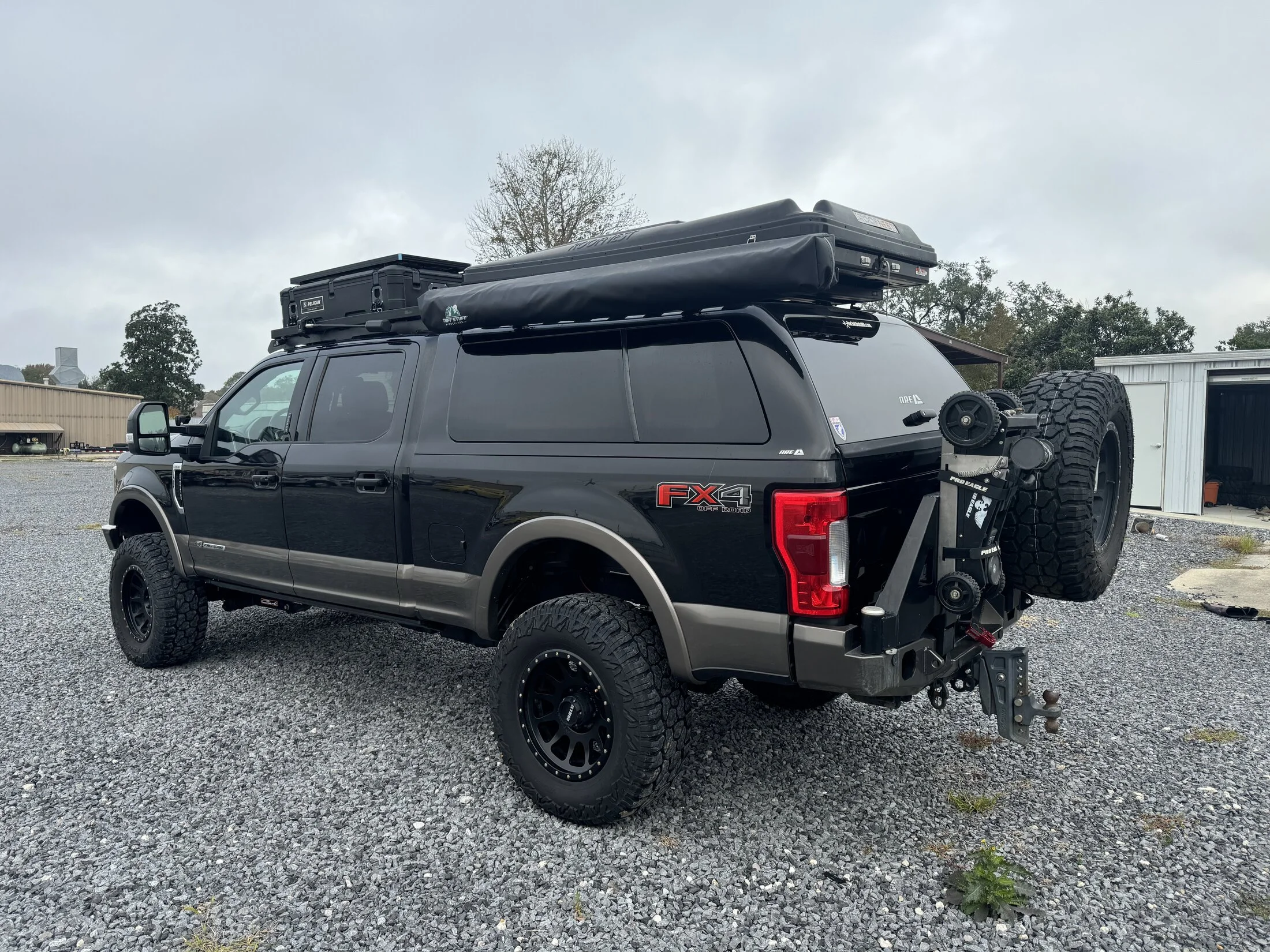

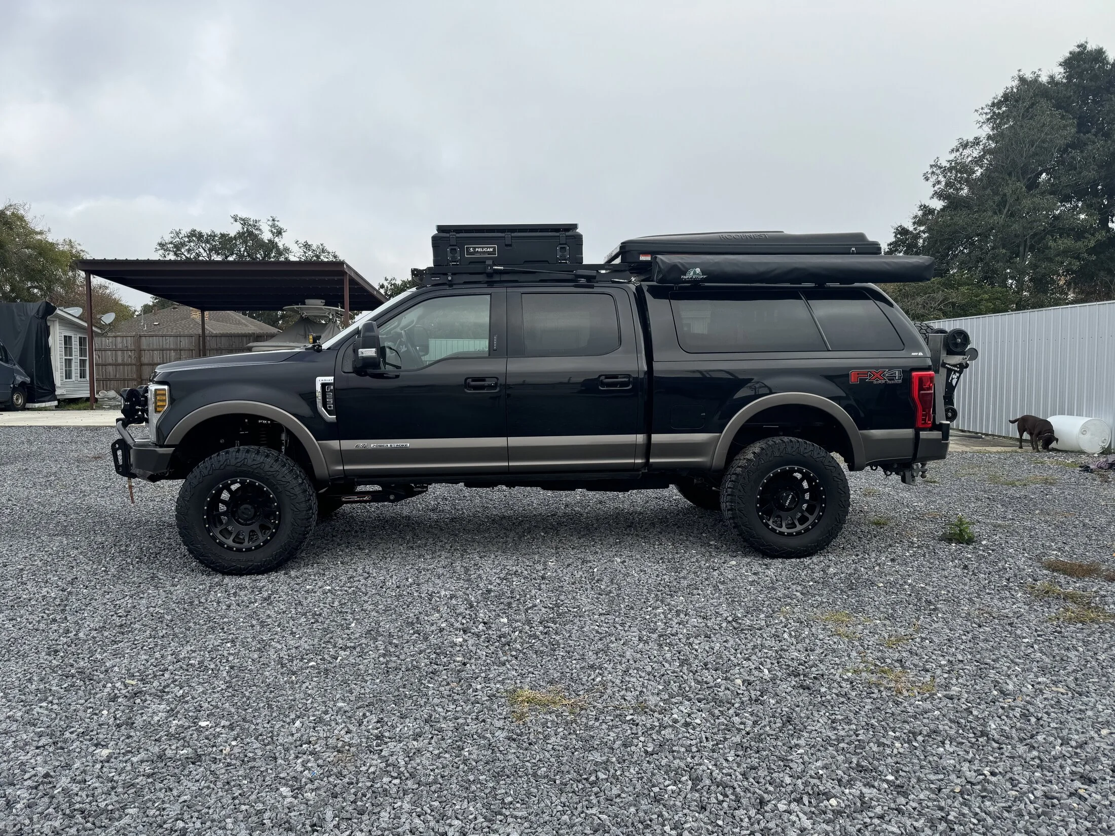

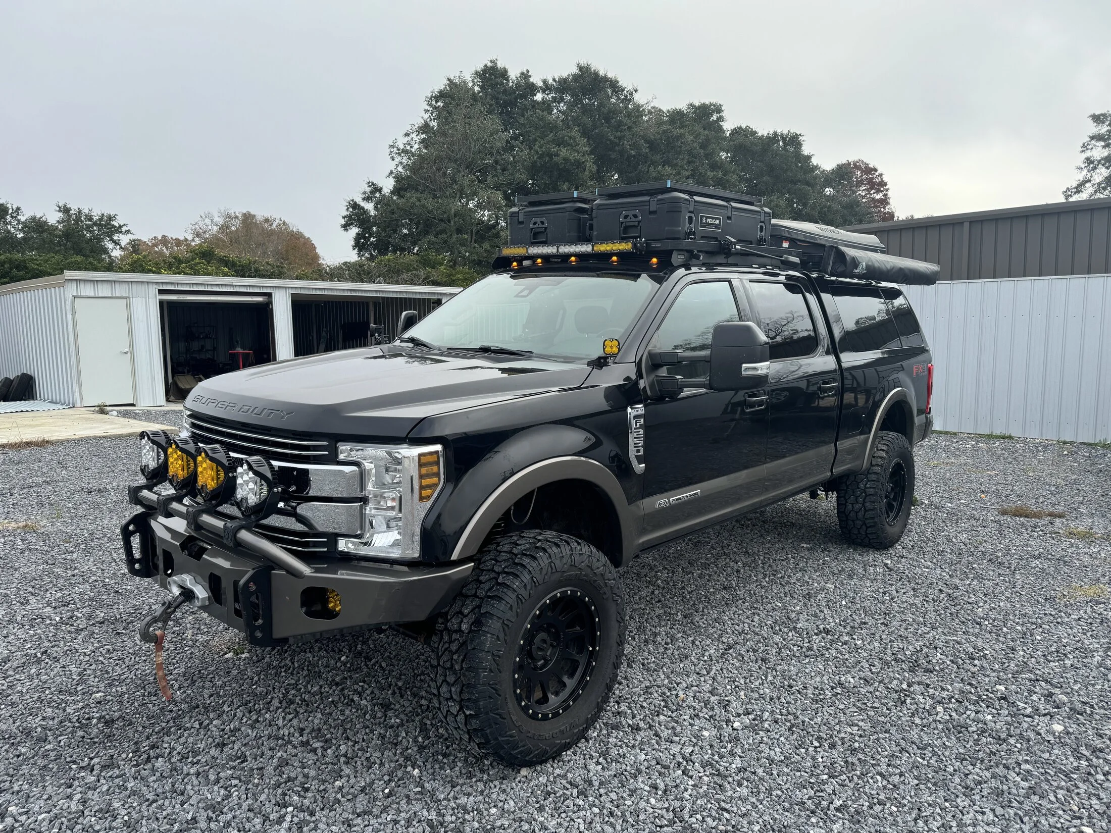

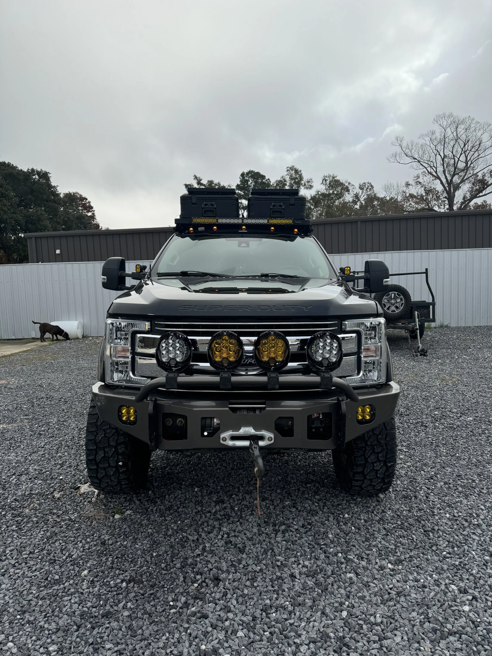

This is my 2019 F250 Lariat 6.7 that I have made into my hunting rig to travel for mainly Duck hunting but also some Deer. I needed a full size truck for towing side by sides or a traveling stocked up hunting trailer plus be able to take my family a few times a year. I installed Ranch Hand bumpers and a small lift initially but quickly found out that was not going to cut it. The build has been 99% complete for about 2 years now and I will list down below the pictures and modifications it has gone through.
Lighting:
Baja Design LP9 x4 (2 Amber 2 Clear) mounted to the front bumper
Baja Designs 40in. OnX6 Arc Dual Control LED Light Bar, Driving/Combo (Amber/Clear) mounted to the roof rack
Baja Designs Squadron Pro Amber LED Lights; Driving/Combo Beam mounted on A pillars
Baja Designs Squadron Sport Amber LED Lights; mounted in rear bumper
Baja Designs XL80 auxiliary LED light in place of fog lamps
Rigid Industries 20541 Black Back-Up Light Kit x8 mounted on the roof rack around the truck

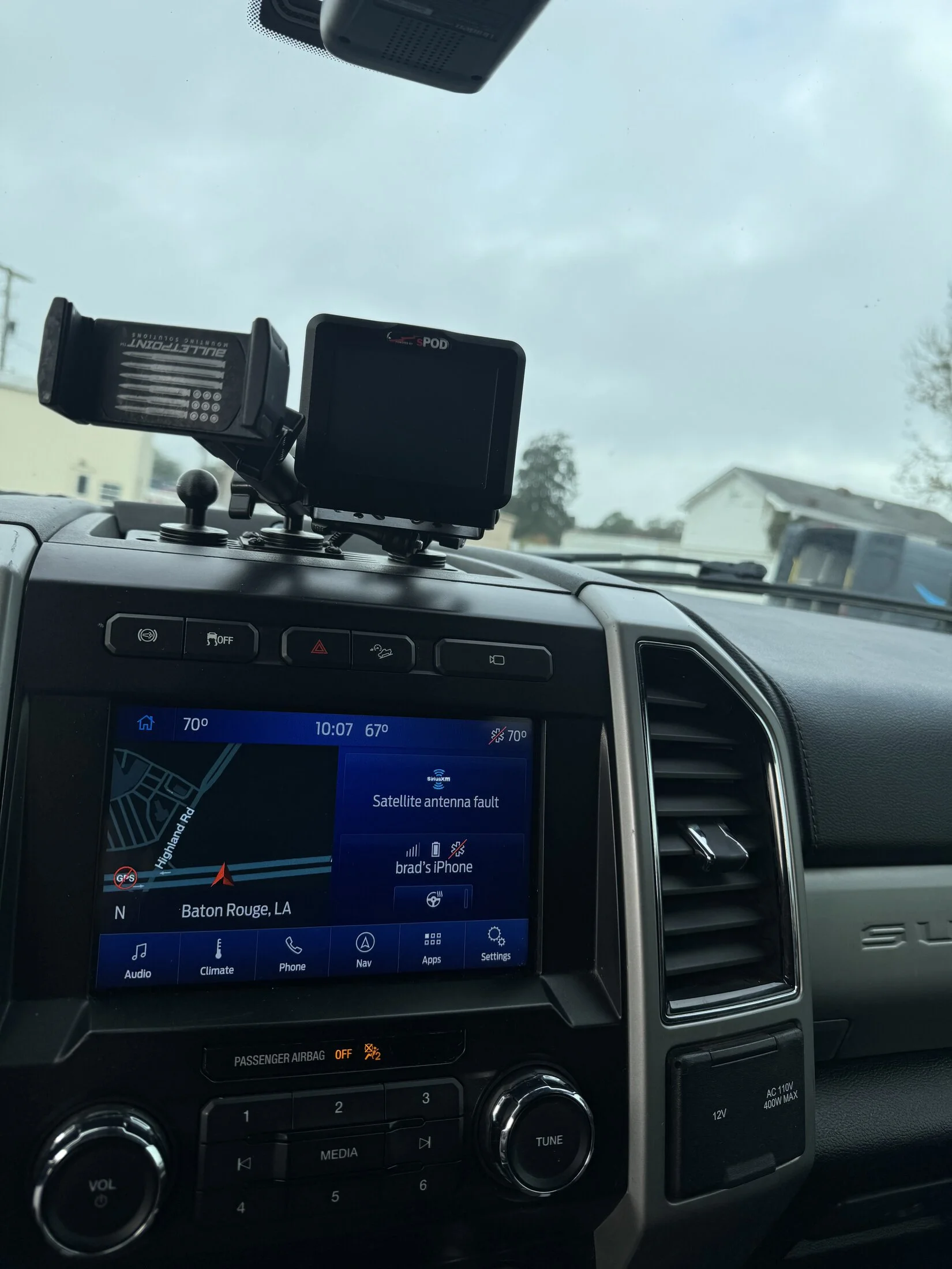

Everything run through an Spod mounted on the center dash
Wheels/Tires/Suspension:
Method Wheels 305 | NV | Matte Black x5
Faulken Wildpeak 38x13.5R20 x5
Carli 2017-22 Ford Super Duty Dominator (4.5"/5.5" Lift) Suspension System
Deaver Leaf Springs custom made to truck weight
Airlift Compressor mounted under rear seat with Bluetooth operation
Bumpers:
Front and rear expedition 1 bumpers powder coated and then painted for color match to trim.
Misc:
Warn M15-S in front bumper
Warn Zeon 10- S in rear bumper
Front runner roof rack on cab and camper
ARE camper shell
Roof Nest Falcon Tent with Front Runner Quick Release mounts
Pelican BX 140R Cargo case and mounting kit x2
Tuff Stuff 270 degree awning with Front Runner Quick Release mounts
WeBoost Drive Reach Overland cell booster on a Front Runner folding mount.

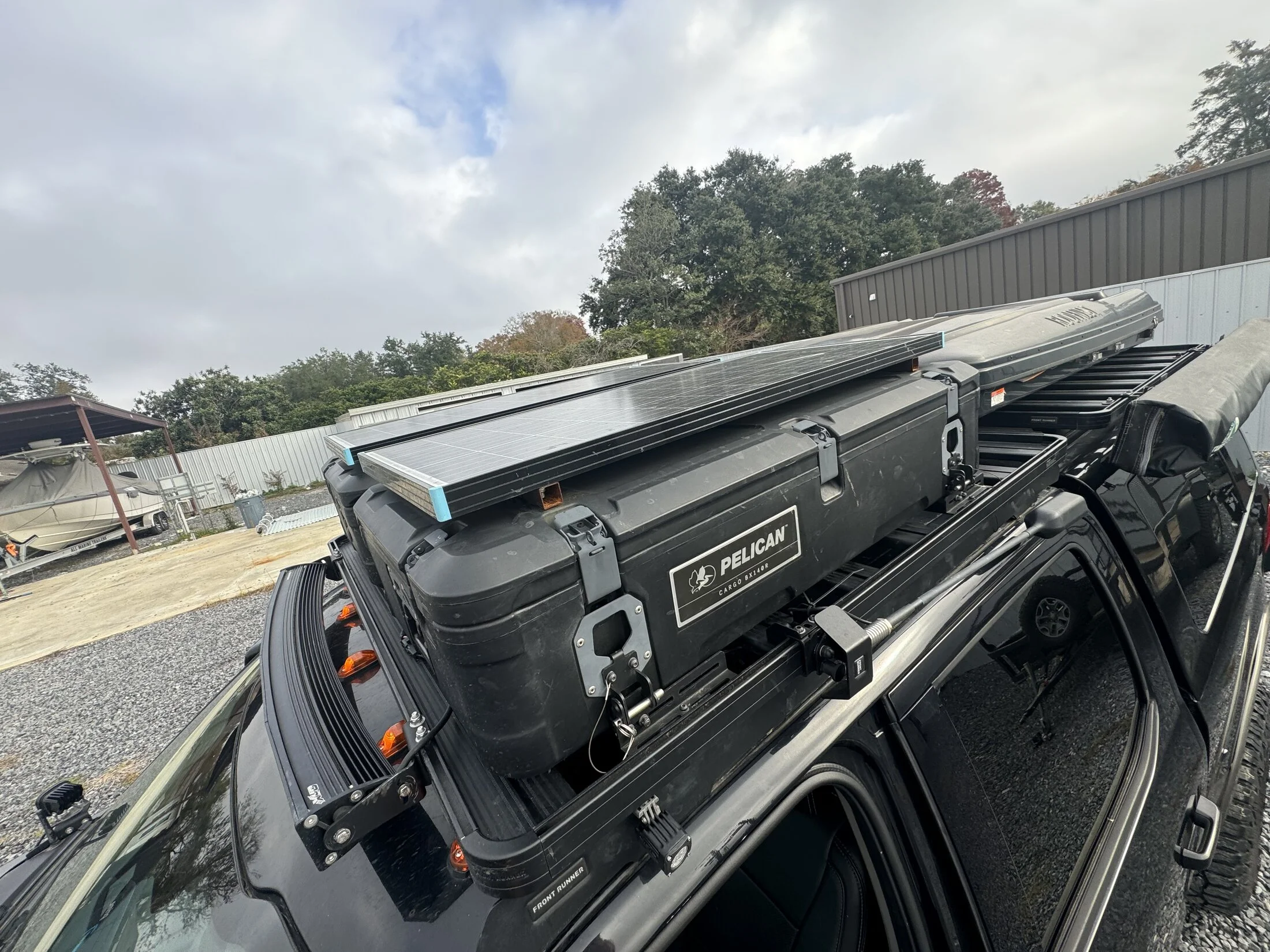

Renogy Solar Panel 100 Watt x2 mounted to Pelican cases on roof
Renogy 12V 50A DC to DC Battery Charger with MPPT powering a
Battle Born 100Ah 12V LiFePO4 Deep Cycle Battery
Decked Drawer system

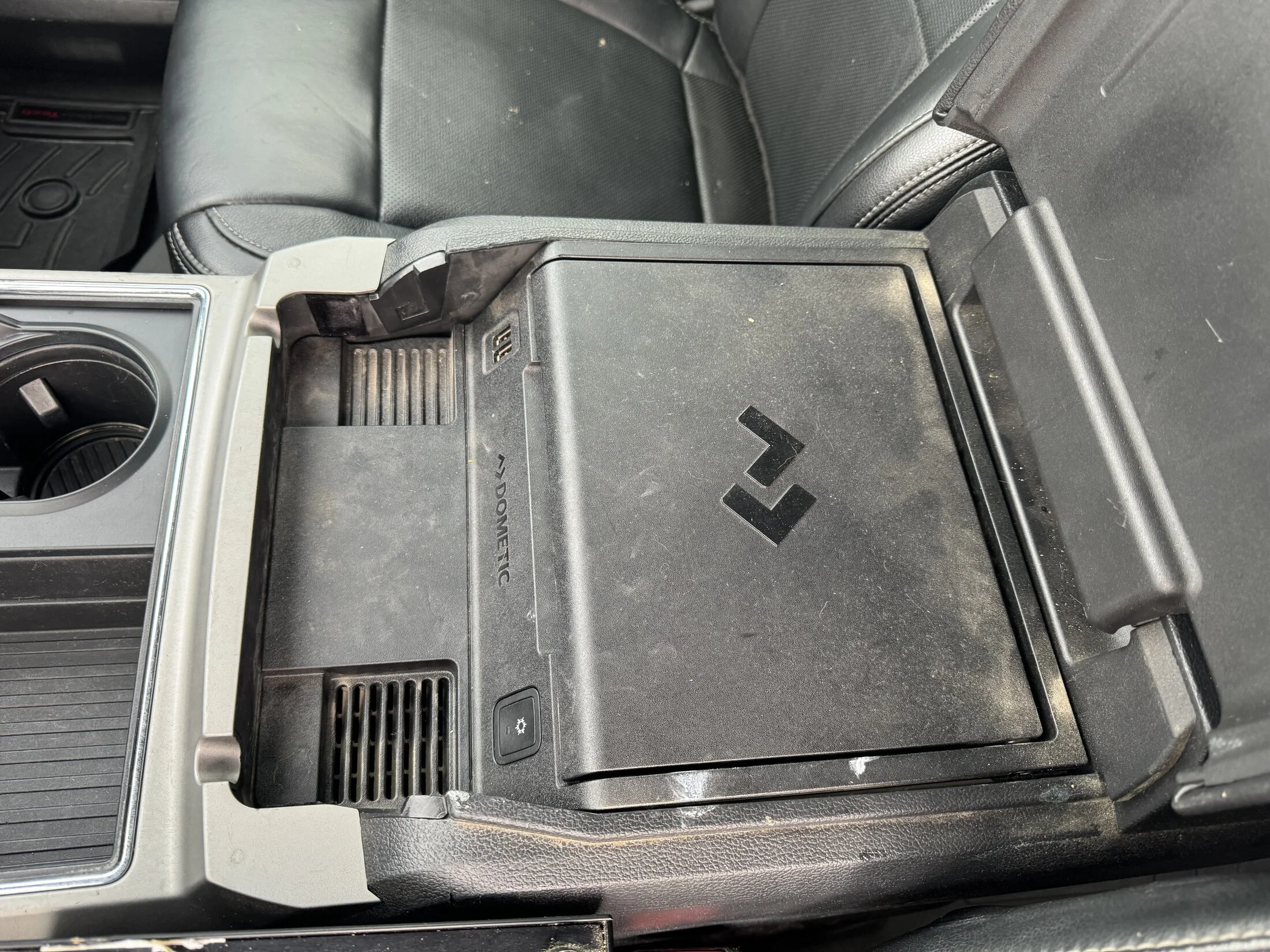

Dometic Fridge in center console
Uniden R3 EXTREME LONG RANGE Laser/Radar Detector
