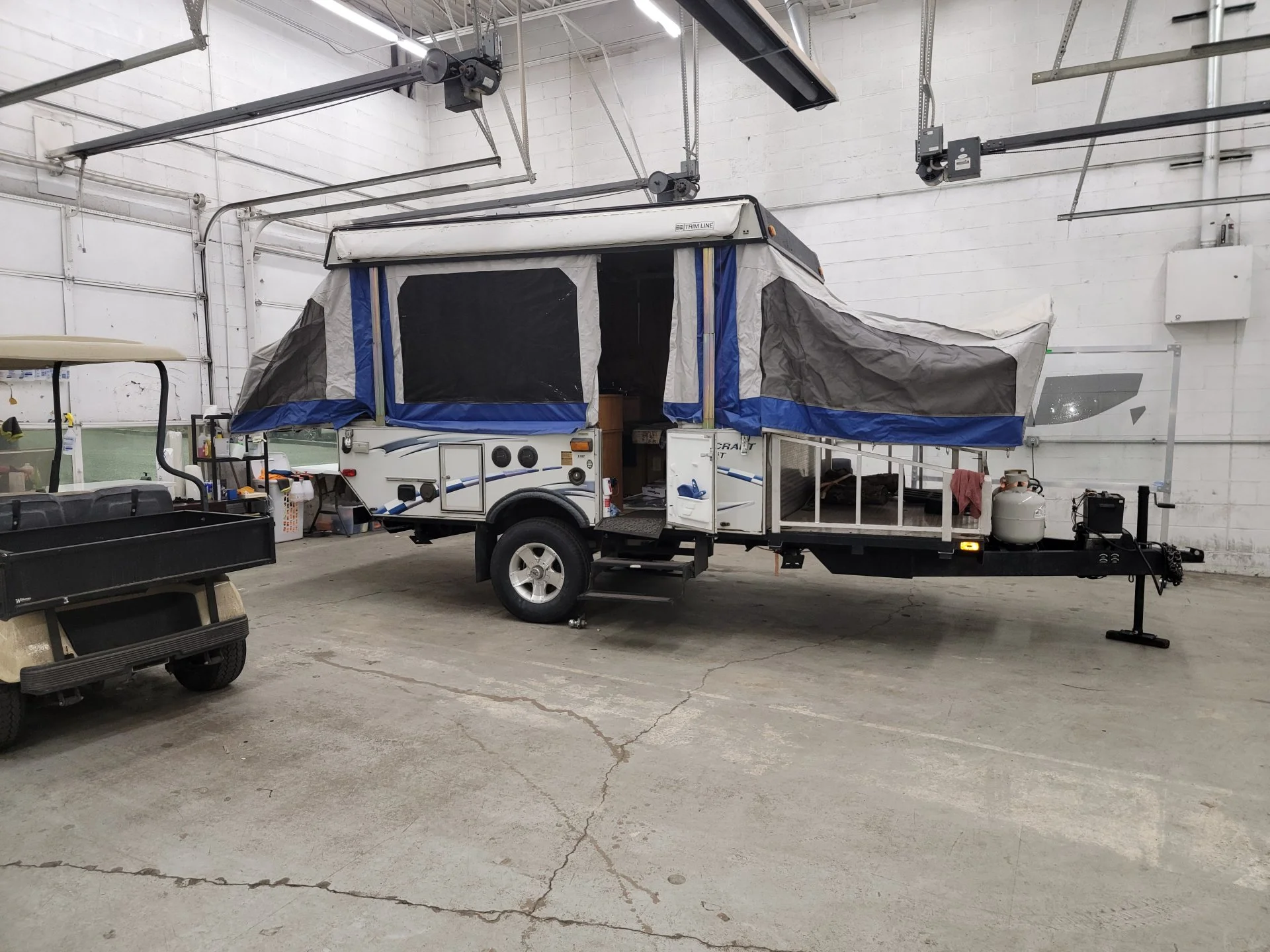

I just tow a offroad pop up camper. I set up camp in the area I want to explore, then use the cruiser to explore. It has a water tank, fridge, toilet, shower, solar, etc. It's a older model so it needed some repairs. But it was cheap and is pretty nice.
How large a trailer do you tow?
Mark...
Here is my trailer mostly opened up. I think the camper part folded up is a bit over 10 feet. They make popups in all kinds of different sizes. Some are really small, some are huge. You can modify them quite a bit. The atv deck on the front limits my offroad ability significantly because of the added length and extra frame thickness to support a atv. I use it for firewood. It was such a good deal it would have been dumb to pass on it. I could lift it a bunch and put 37s on it. Or I could just sell it, make money on it and get one without the atv deck. Currently in the situation Im in it is fine for me. You can also get a standard popup and modify the suspension easily and make it a offroad popup. Since it folds up it doesn't affect fuel mileage as much as a standard camper.

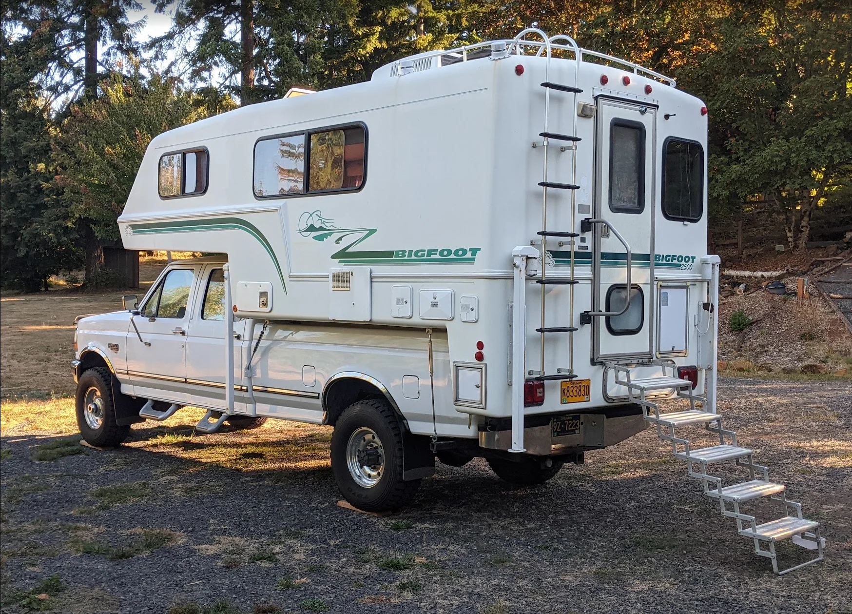

A camper isn't a bad idea but there are downsides to them too. I have a small pop up camper that we use quite a bit. My wife and I did a 4 week trip a few years back where we changed camp almost daily. Setup is pretty fast - take down in the morning is a bit slower when you time from wake up/breakfast to packed and ready to go - about 1 hour. Changing locations each day was a bit of a chore and tiresome. Finding a campsite is also harder with the trailer and so is turning around on dead end roads. Even just parking or driving in a city is more of a challenge. Another thing to consider is that your kitchen tends to be in the trailer so planning for when you are making meals is a consideration as you don't typically pop up the trailer just to have lunch, or you may be away from the trailer for dinner taking photographs or fishing - there are work arounds but it is something to consider. Gas mileage isn't too affected but stopping distance is. If you see some thing you suddenly want to stop for it is a lot harder to do than without the trailer. Also dirt road in a tent trailer are less fun and will limit which roads you chose to take and how long it takes to drive them.
We just did another 4 week road trip - this time with kids and chose to stay in each campsite for several days at minimum and up to 10 days in one spot. On driving days we stayed in hotels and it was a much more relaxed trip that way. The extra space of a tent trailer with a kitchen is nice and being able to use a heater in the cold mornings/nights is nice too. If it was just my wife and I, it would boil down to how often we were changing campsites and what type of roads we are taking. Most dirt roads in the lower 48 are fine but there are some camping places that we enjoy that we can't take the trailer to but the 80 gets there fine without lockers. The tent trailer is more comfy but can be cumbersome, the 80 alone is a little tighter/less comfortable but allows for more flexibility in where to camp, when and how often you stop and which road you chose to take. Just food for thought.
I know its not an 80, I have an 80 and love it.... but I love this thing way more for the kind of travel you are describing. BLM roads, forest service roads, some offroading but nothing crazy, lots of time on paved roads, etc.. If I were strictly offroading and needed the capability I'd take my 80 with the hardshell RTT.
It's an absolute game changer for bad weather and staying comfortable. I also get between 12-16mpg fully loaded, with a range of 350+ miles (7.3L diesel).
Picked it up in April 2021 and have stayed 35 nights in it this summer. We've also covered about 7000miles.
