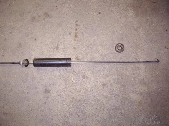

My homemade crap. Worked great. It's all about the hook.

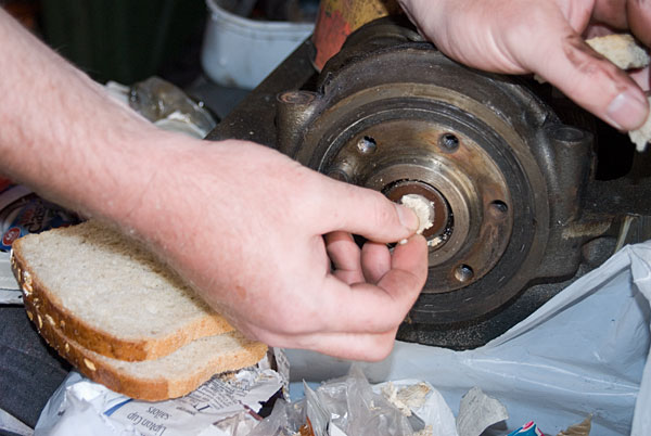

But there is another way.... bread.

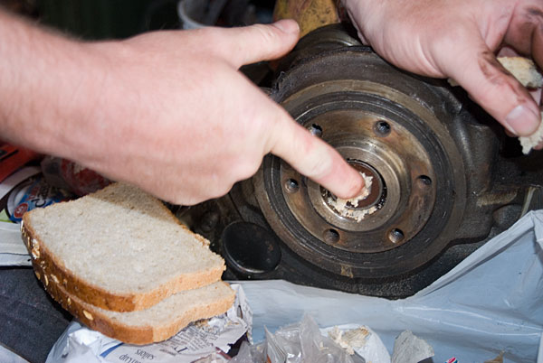

That's right, bread. Basically, it's just like the grease method, but use plain old bread instead. Use squishy white bread, or the insides of hamburger buns. The crusts are too hard to squish through the hole in the pilot bearing. But just push bread in there, then tap it with a bolt (just like the grease method).
On my 2LT-E, I was able to get three buns back there, but the bread did the trick (after the slide hammer type puller failed, the grease failed, and the dedicated pilot bearing removal tool failed). When you're done, the bread is REALLY compacted back there, but on the plus side the inside of the crank is spick and span!

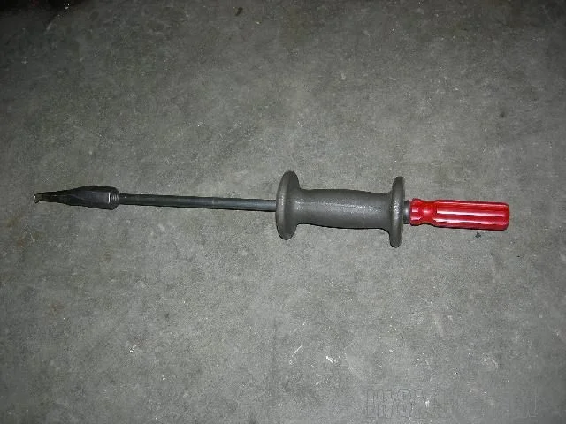

But seriously---used a slide hammer puller on mine but the jaws were too big so I only used one jaw--worked like a champ

Technique:
- push bread through hole until cavity is full.
- insert punch (cylinder head bolt is a perfect size) and hit with rubber mallet.
- repeat until cavity is full.
- hit punch one or two times swiftly.

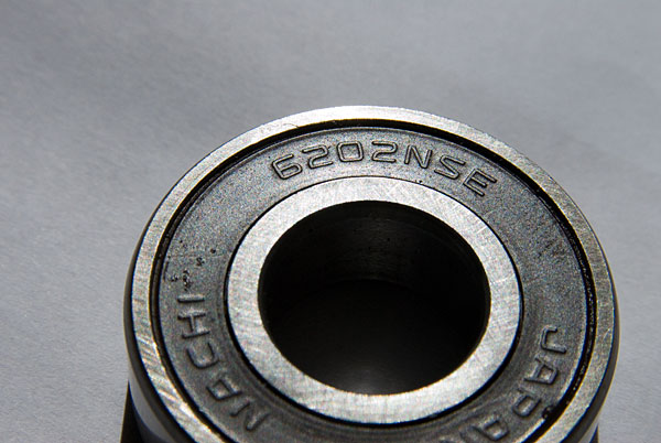

1) I see the 6202 NSE bearing above. What year was that for and will it fit an '80 FJ40? A 6202-2-NSE has 2 seals, maybe I'll try that one. I got mine from JTO I think.
2) the release bearing looked a little different from original, but both the original, and now the new one were whining, even though the new one was perfect until it got wet. I haven't figured out how water got in there, I guess I'll find that when I get under it, but when I put it all back together everything was as it should be, should have been quite water resistant. Maybe the timing cover came loose or something.
3) Anyway, I need a number for a GOOD release bearing that is totally sealed, and a GOOD pilot bearing that is totally sealed. Any ideas? Thanks.
KOYO RCT52S
OEM Toyota bearing from the dealer, part number 97120-06202, is a NACHI 6202ZE.
