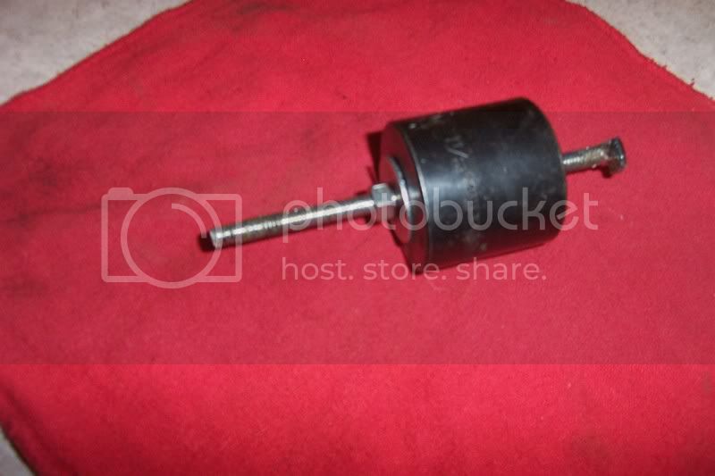

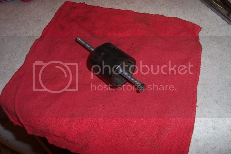

I spent about 30 min this morning trying to get that blasted pilot bearing out. a quick search on mud saved me a ton of frustration...... .73 cents later and I had my Mud-Pilot bearing puller...
Mud search = FREE
Long bolt washer and nut.... .73
5 min removal of pesky pilot bearing....PRICELESS!
Thanks guys. Here is a pick of my puller

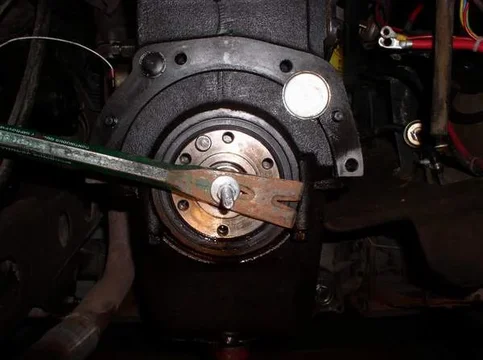

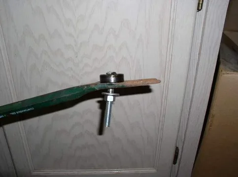

"Leveraging" off the .39 cent carriage bolt idea....
Instead of a socket, use the hole in a crowbar / prybar. It rests perfectly on the raised flywheel alignment ring on the crank.
Tighten, Leverage it out. Took 5 minutes to make the bolt, and 15 sec to pull the bearing.
Yesterday - it wouldn't budge.
PS. Shoot some PB Blaster in there first. That probably helped too.
Rocky
