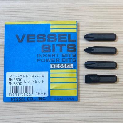

Something to keep in mind with the impact drivers is the bits that typically come with impact drivers are what I'll call "standard Phillips bits". Toyota uses JIS fasteners, and it would be better to use a JIS bit. (JIS = Japanese Industrial Standard)
For your purposes you want as much contact between the bit and the fastener as possible. There is a difference....
I’ve often wondered whether you could find JIS bits for a hand impact. The bits that come with them take enough abuse they need to be replaced. Mine is 45 years old and the bits have seen better days.
The #3 Phillips seems to be a pretty good match, even though the #2 is only so-so. I went through a string of Craftsman #3s back in the day when I was actively dismantling. They had SUCH a good bite that I would sometimes have to put the screws back in to get the bit off!
