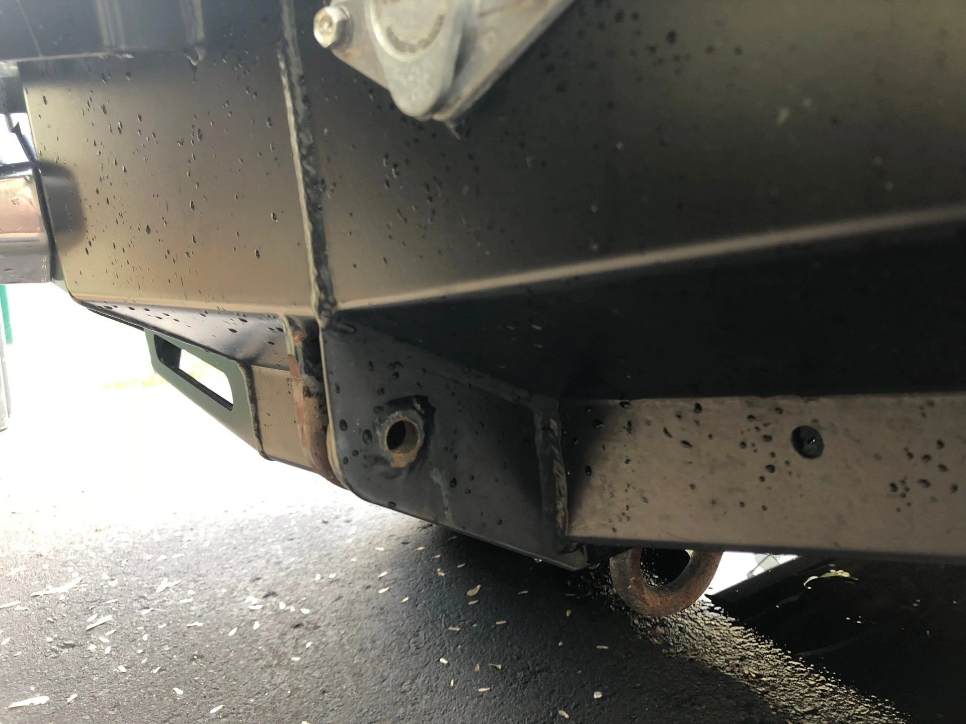

A buddy and myself did similar on ours. In my arb, we re-enforced the stock tabs with 1/2” plate, tied back to the frame horns on the outside plate. Buddy bought 3/4” x 10” (maybe 8”…) tabs and cut into the flat face of the bumper on the inside of stock tab plate, tied to the top of the frame horn. Then we use the big Jeep type tow arm ends and big hitch pins. I have thousands of miles of towing it this way with no stress indications on the modifications. I’m looking for photos to show at least mine.
Only photo I can find on my phone … will take some tomorrow

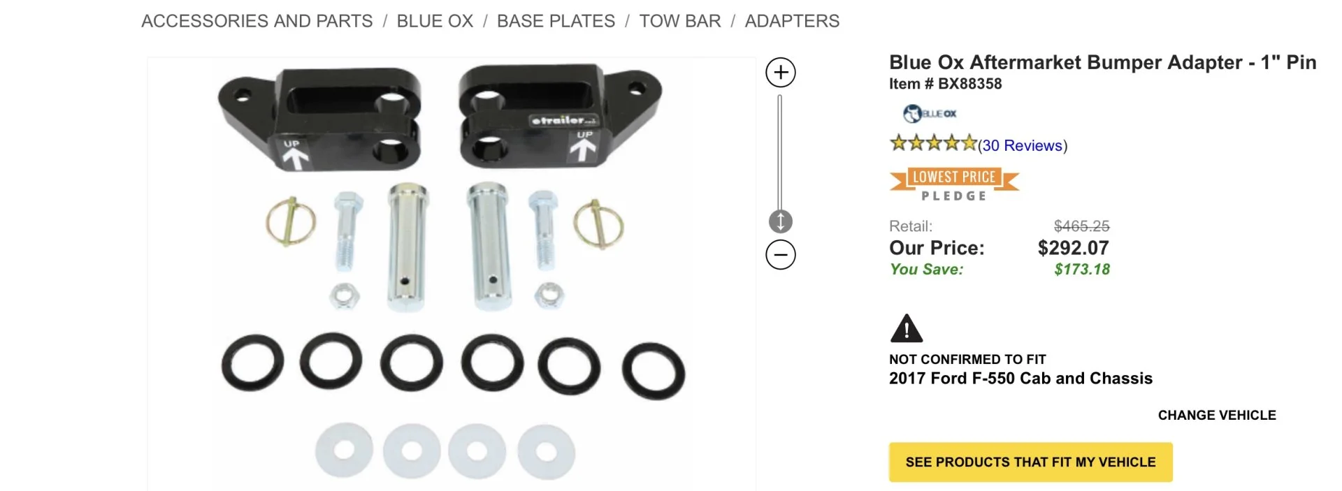

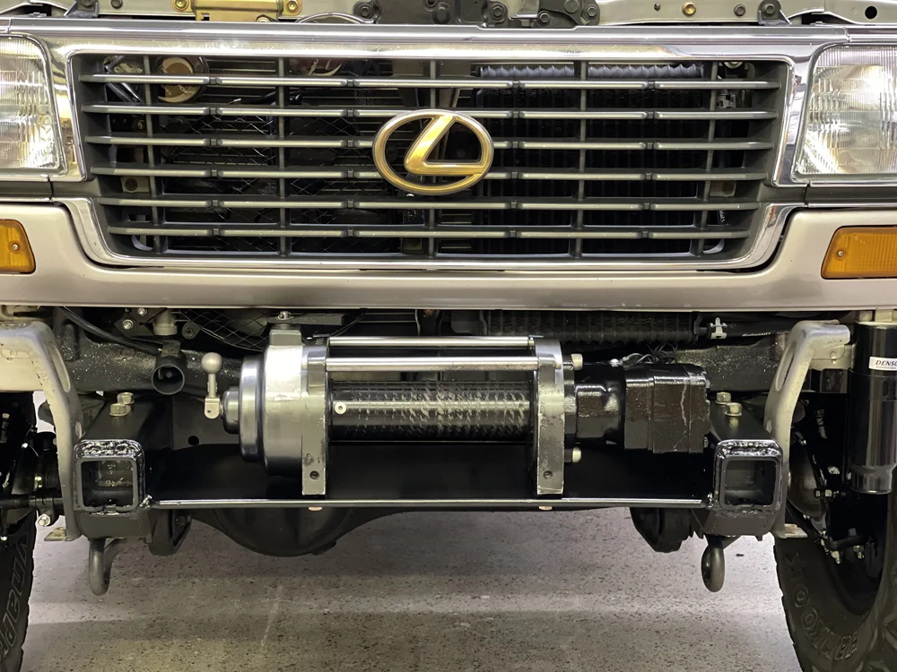

Picked up an ARB bumper and immediately dropped it off at my local welding shop. Planning to do some reinforcing and widening of the recovery points to work with my Blue Ox 1” bumper adapter. Feels crazy to take a shiny new bumper and immediately take a grinder and welder to it, but it seemed like the best overall value for the situation.
Other than that, we’ll be running a Blue Ox Aventa 10k tow bar, Blue Ox Patriot brake system and I’m planning to wire in a 2nd set of lights since there appears to be room in the housings.

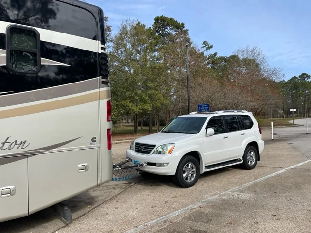

We went from the LX450 to the GX470. Looks tiny being the motor house. Pulls much easier than the LX. We should have went Patriot with the GX but was swayed into the RVi3. Had i known that adaptor was available for the Blue OX i would have gone that route with the LX. We used the Blue OX base plate for the GX.

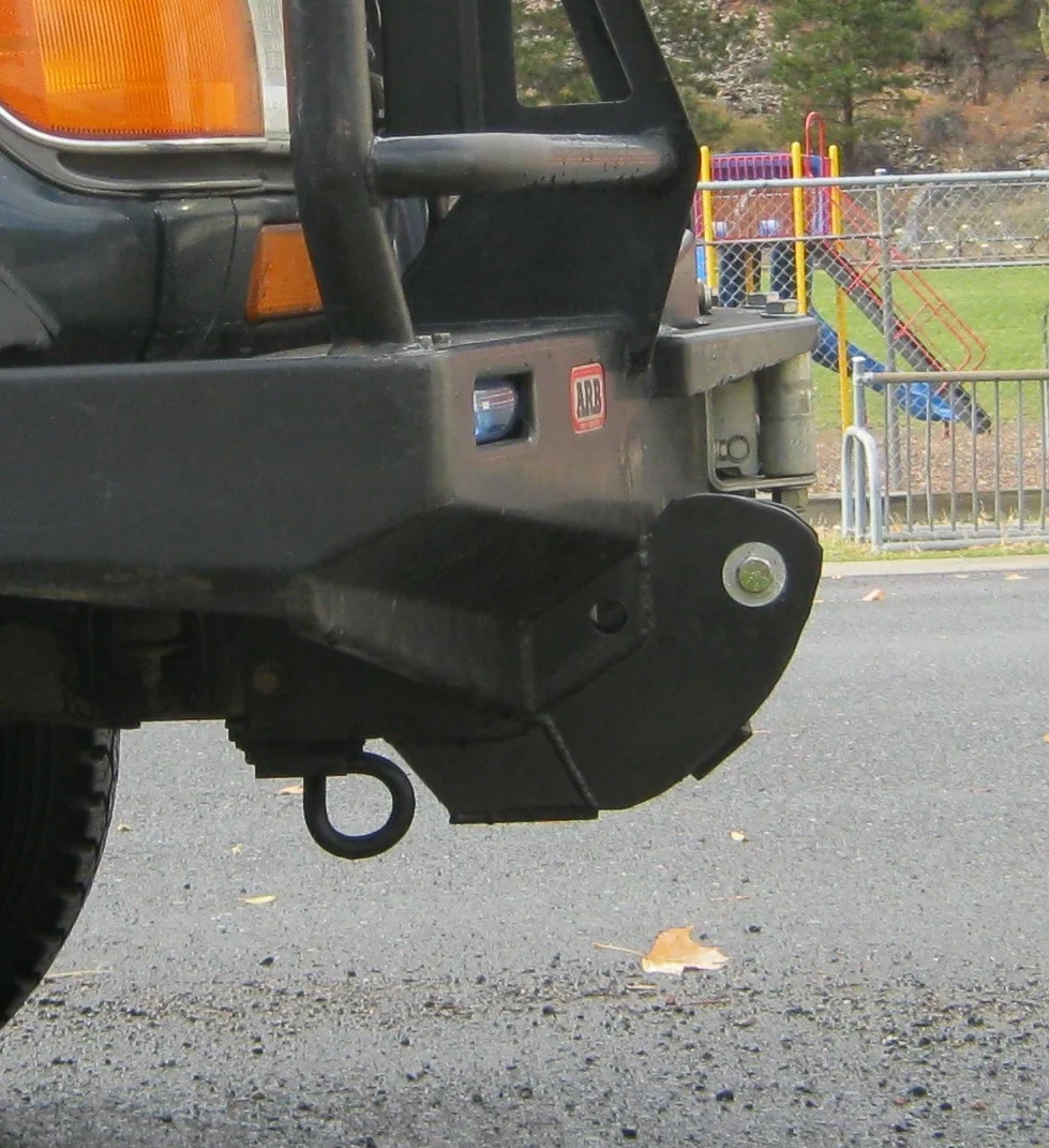

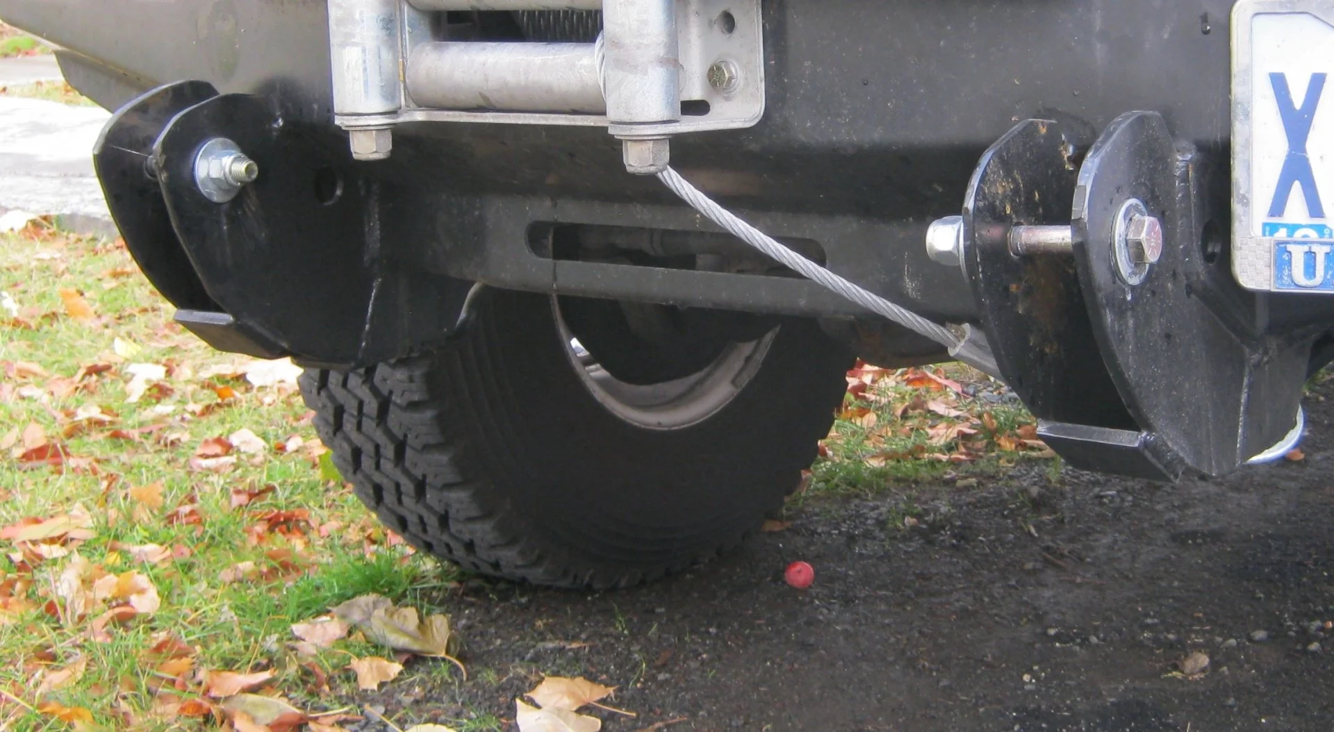

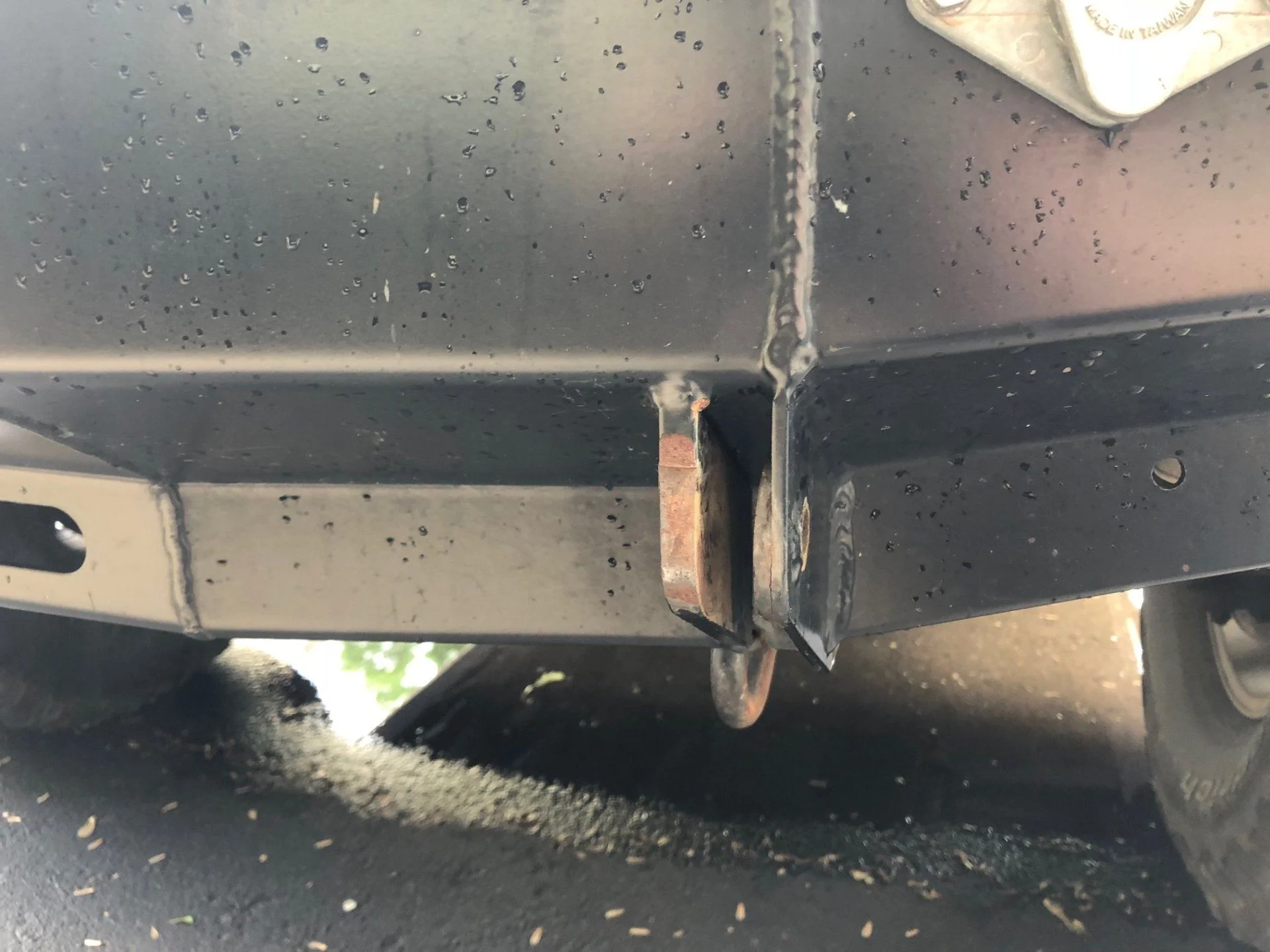

Here are a couple shots of the modified ARB. And one gratuitous glam shot. I had the bumper sand blasted and re powder coated last year. the pull points need some touch up. That said ive put 8K miles on with that new powder coat, so its held well i think,
Great setup. I'm looking to do a similar modification to my bumper for my 100 series. Did you have any stress cracks on the new plate that was added, or was it okay? Did you do any reinforcement to tie it to the frame? It looks like this is the simplest way to add flat towing points to the bumper.
No stress cracks. When we left the LX in Dallas we were at or near 20K miles dragging it around the country. We did not reinforce, the frame, im not an engineer, but i had an engineer weld in the tabs. The plate for the GX has safety cables that tie it in to the frame. I may consider adding those to the LX when we pull it again next year. When we get back to Texas we will have it back there again.
