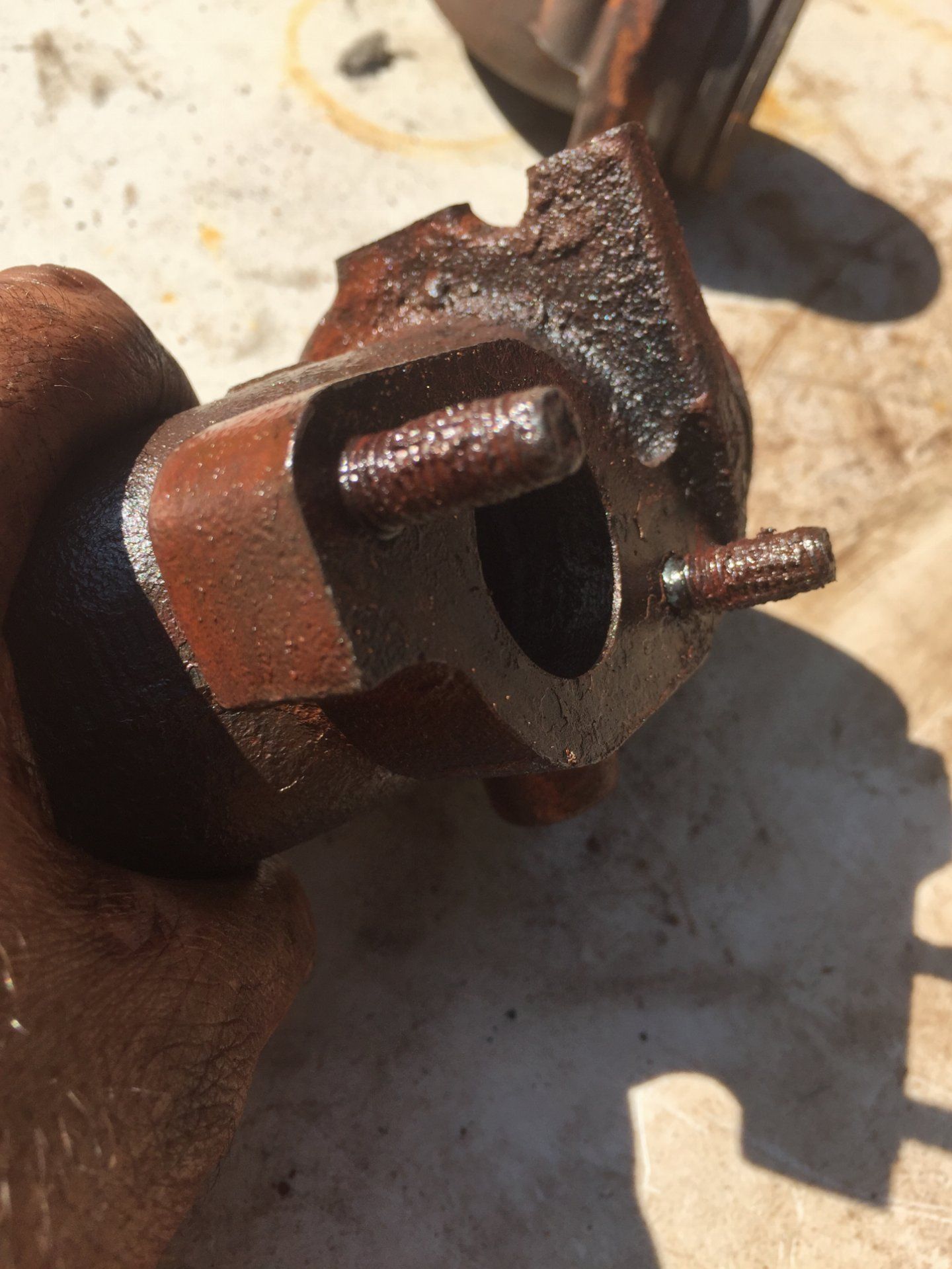

3. Get it to the machine shop to resurface. Also, these two studs where the EGR J pipe went won't come out. I'm going to see if the machinist can get them out for me.
4. Then ASSEMBLY TIME!
Regarding the studs on the egr. Mine stayed in. Gasket has holes for them wether you do the block off plate or not, you don't 'need' to get them out.
Thanks but unfortunately I think I've stripped them now with my vice grips. Ugh! Oh well. New they will be.
Next time, I believe w/ a stud you would want to double nut them.

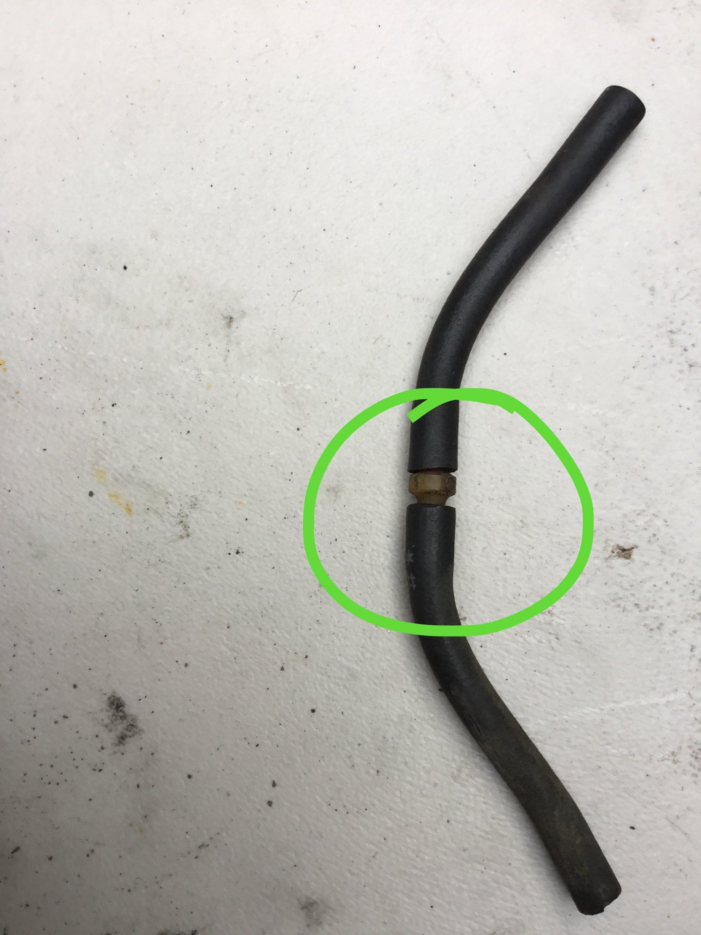

In this picture you'll see one of the vacuum lines that went into the carb. There is this little valve in the vacuum line. I don't think I need to keep that after my desmog but can you guys confirm that? Thanks!
Hey... did you throw out this valve yet? I might want to take it off your hands :)
I still have it if you need it. But I thought you were desmoged too? Just PM me your address and I'll send it your way!
Man that manifold looks awesome. Great work!
About that little plastic valve, I could use it if you're getting rid of it. I am desmogged, but I really just deleted everything emissions related. I left most performance related vacuum lines in tact. Most people just rip everything out, but there are a few babies I didn't want to throw out with the bath water.
That particular valve is for the choke opener. It's like a little vacuum bleeder valve that lets just a bit of air bleed out of the CO system. I'd like to add mine back into the mix, but I lost or accidentally gave away that little valve somewhere along the road.
