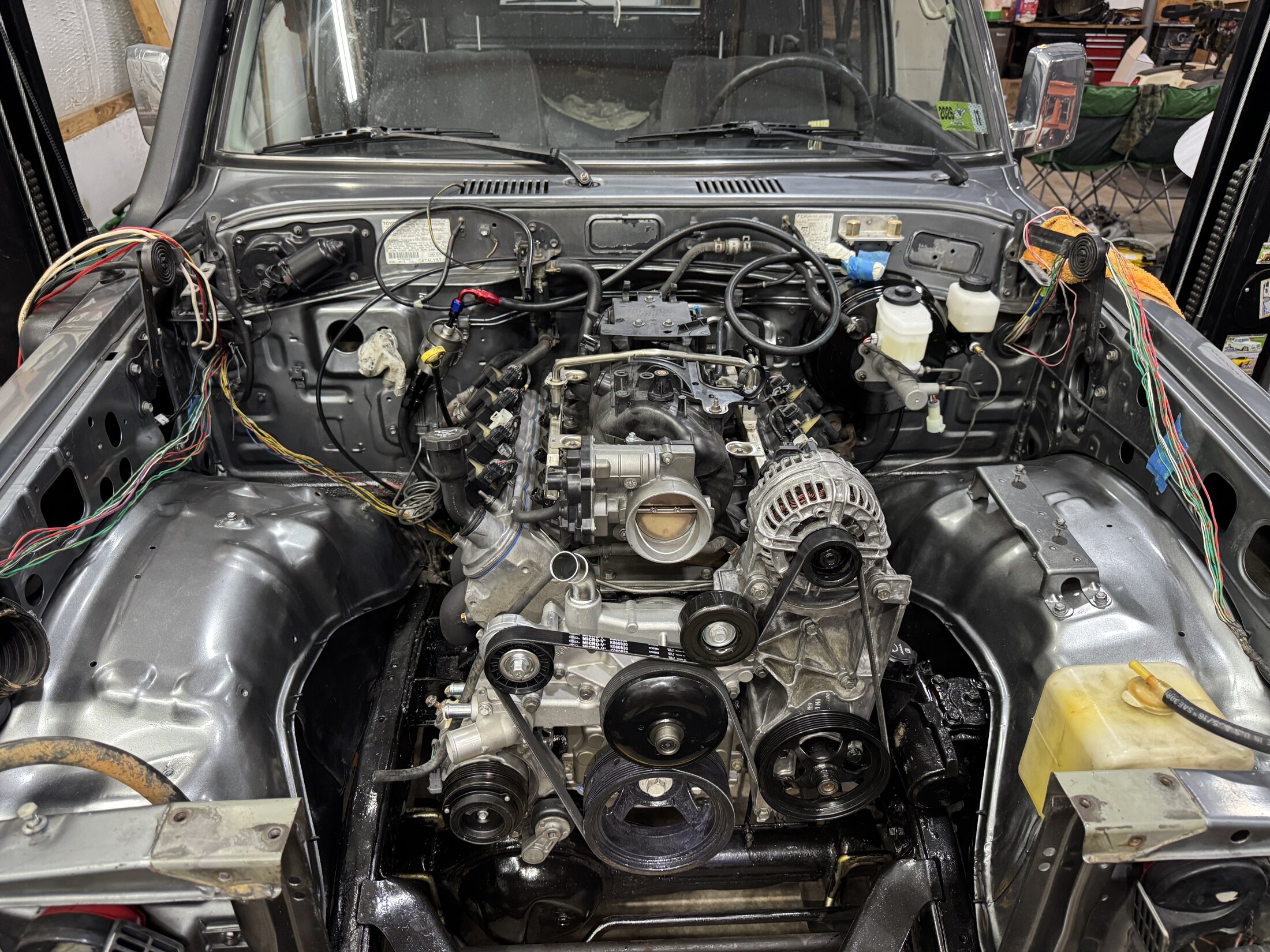

I am working on the LS swap and have run into a little fitmant snag.... I tacked in the CruiserMatt's Motor mounts and slid the engine in place, securing the bellhousing bolts. I put the hood back on for a check and it clears with out the engine cover on the intake, but if I put the engine cover on it hits the insulation on the hood. I am debating lowering the mounts 3/4-1" from where they are.....The mounts are flush with the top of the frame rails but I am wondering with my H55F positioning and them being forward, if they are higher than they would be for a automatic swap. I am hoping to keep the insulation under the hood and use the engine cover to hide the wires... so removing both would solve the issue with not much clearance but is less prefered.
Measurements:
The water pump pulley is 7" from the back of the radiator and it is centered 7.5" up from the bottom of the radiator (16" radiator, so just below center)

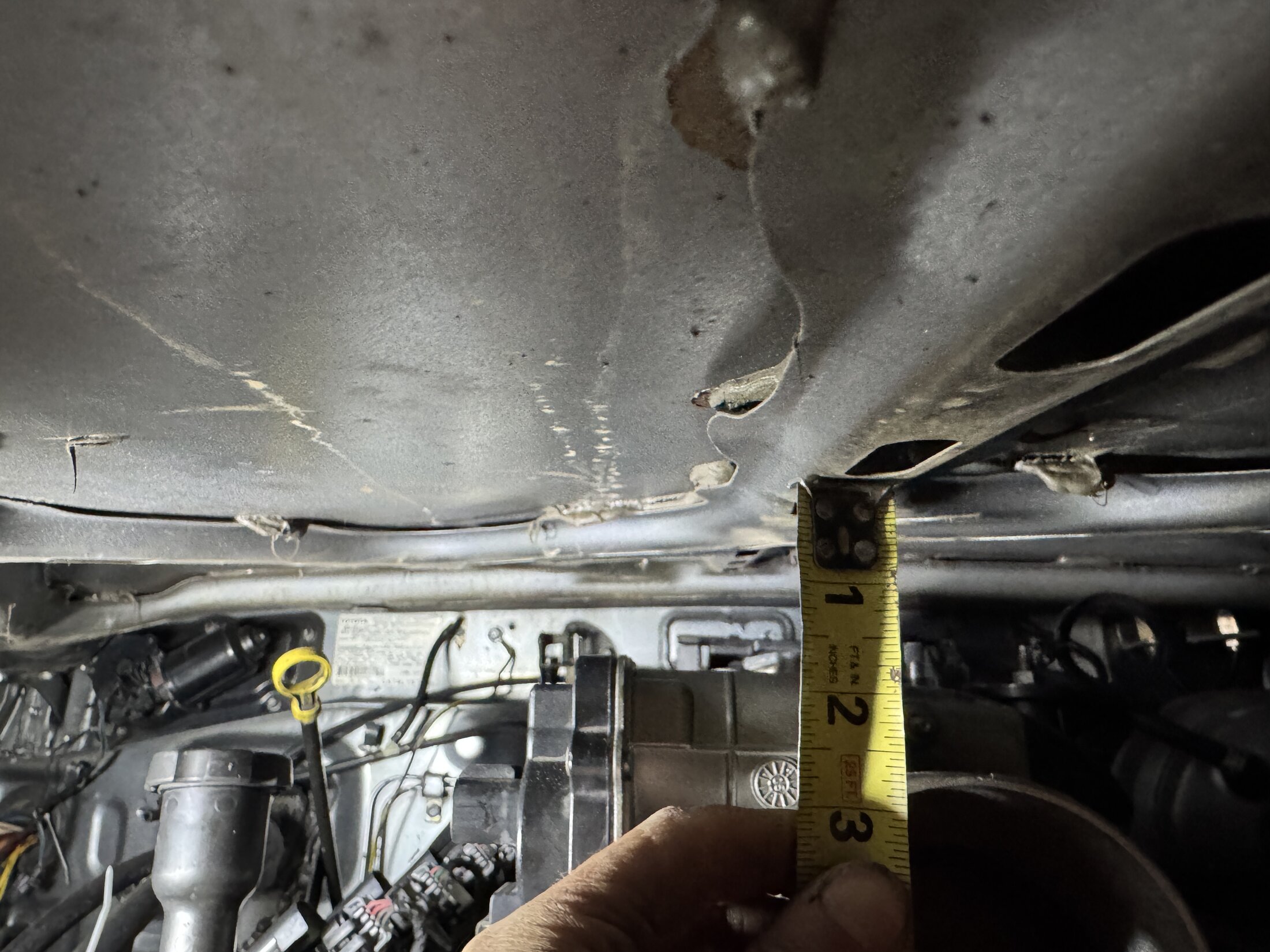

My bellhousing is 3/4" from the tunnel, so not too much clearance on top.
PS Pump clears the PS box and has room to drop the engine.
Heater hose valves are really close to the valve cover and going down would help.

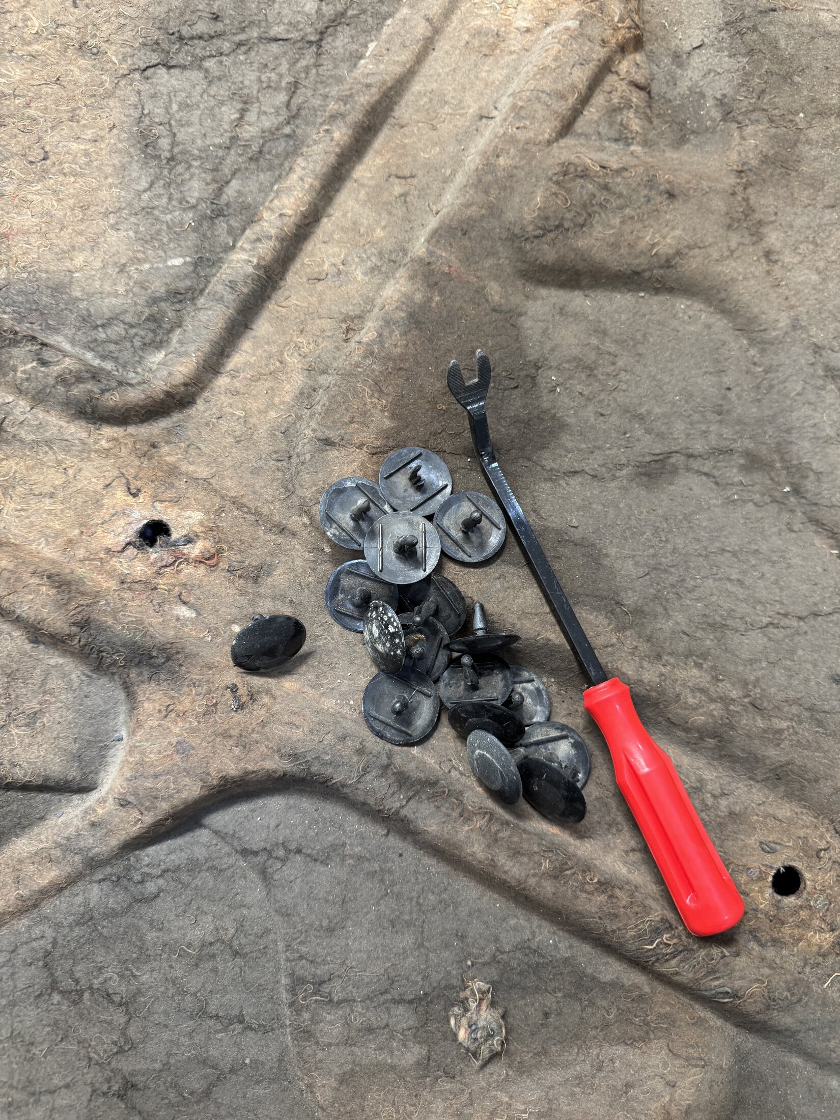

Here is the dirt left from the under hood insulation, it keeps the hood up about 3/4" or so on one side.
The hood rises from the fenders so you gain a few inches but it is still close without the cover on, heres how high it is from the fenders.
Here is how high the water pump sets from the bottom of the radiator, its a 16" radiator and it is all most centered at 7.5" so lowering it will make that worse, but not a show stopper as far as the shroud and fan.
Haven't gone too deep into the heaters and running the lines to the water pump, but they are close to the valve cover at this height and would benefit from lowering the engine...
Seeking thoughts input and critiques!!!!
I haven't looked over all the build threads and advice yet, so I am going to do that now, just hoping someone is still sipping coffee and combing over the forums and has a quick answer. In good news the Tacoma is back up and running with a new OEM head gasket and I replaced the fuel PX regulator and rear head cover that I cracked a few years ago.
I think @dbbowen kept his cover, worst case you could swap to a car intake.

The intake cover on a Gen 3 and a H55f should just barely kiss the hood liner if you have my mounts at the correct height.
From your pics it looks like it is dead on to me.
The engine sits a little further forwards then it would with a 4l60e in a FJ62
