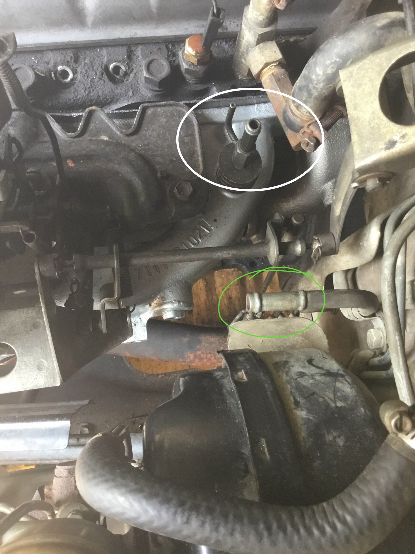

Any one know where this cap goes when I desmog? It came with the JimC desmog kit and I haven't found a home for it yet.

I figured out where that cap goes from the JimC kit. You put in on the end of the line where the EGR was. It caps that off and seals off the PCV plate that goes on the intake.
My good friend Ben has generously made me a plate that the PCV line can connect right too so this will be coming off tomorrow.

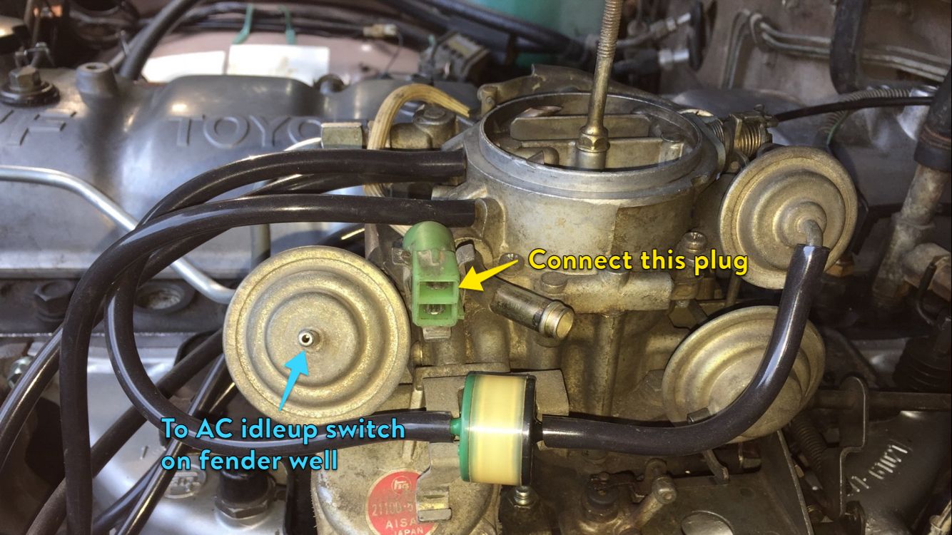

On that holding idle problem.... I think I still have a vacuum leak.

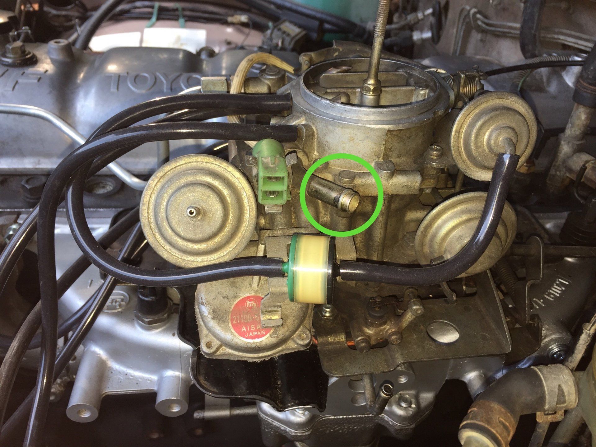

I forgot to do something with this opening on the carb which I have to guess is causing a problem. Any ideas on where it connects to? I am guessing this hard line on the firewall in the pic but I have no idea where that hard line goes to.

That's where it goes but that shouldn't have anything to do with the idle
Here's a few more pics that are up to date. The previous pictures weren't the latest.
Morning update.... that connector on the carb was the key! I found the other end which I noticed goes to the idle solenoid. Which makes total sense on why it would not idle! Now... it's idles perfectly.
