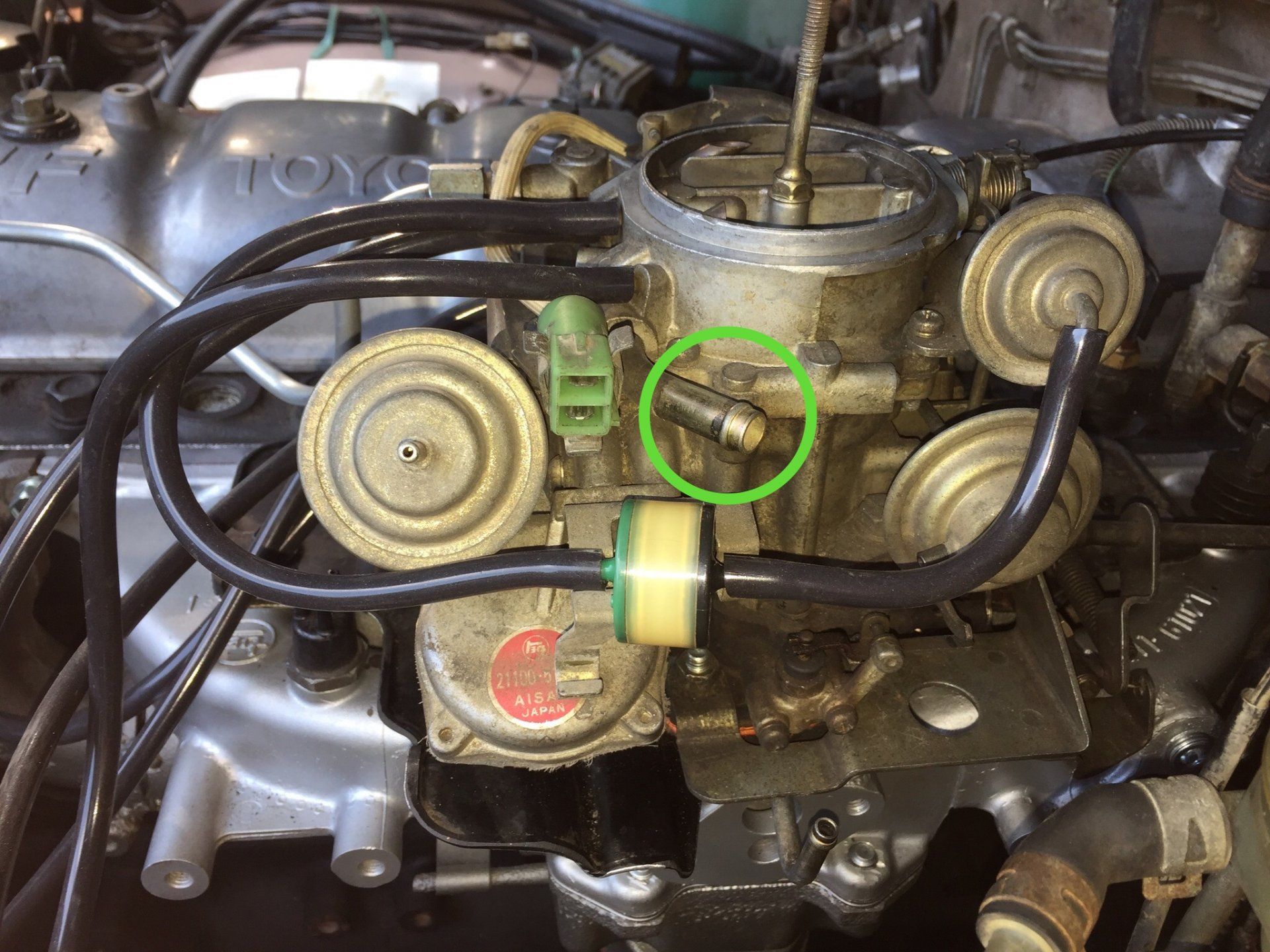

The carb bowl vapor vent (circled in green below) needs to either be connected properly to the Outer Vent Control Valve (working correctly on the charcoal canister) or that pipe needs to be plugged.
Starting the engine can be more difficult when that pipe is left open to atmosphere and it needs to be blocked off (either by the OVC valve as designed or with a plug. If it's plugged, make sure that the distributor venting VCV on the passenger side air cleaner is working, otherwise there's a risk of blowing up the distributor cap. (carb vapors will fill air cleaner housing & end up in distributor).

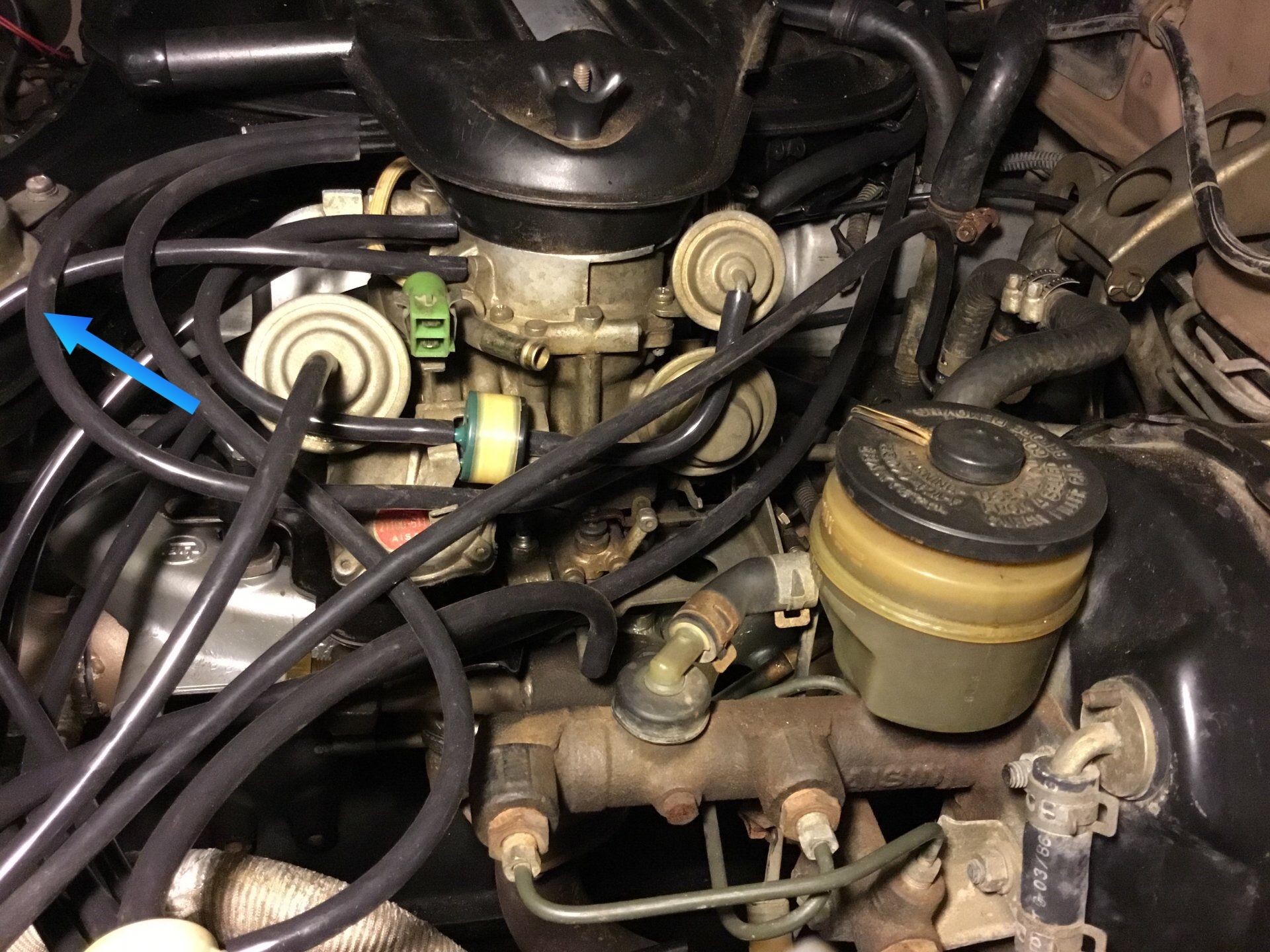

The Choke Opener vacuum tubing doesn't look like its plumbed correctly. It needs a vacuum source. The 3 pipes jutting out of the air cleaner housing above the carb aren't vacuum sources, just sources of clean air. See the Choke Opener section in the emissions FSM.
Also the EVAP VCV doesn't look like its plumbed correctly either. But it's hard to tell by the picture. Port S on the VCV needs to ultimately get it's vacuum source from the advancer port in the carb. See EVAP in emissions FSM.
I got that done.... this picture was a little older and not the final product.
On the carb bowl vapor vent.... I got that done... this picture is a little older and not the final product.
On the choke opener... this is throwing me.... I followed the How to Desmog guide and you can see in the picture attached that it looks like it should go to the air filter. But reading the FSM as you suggested it's clear that's not right. Also, I noticed on @mwebfj60 drawing here that it goes to the BVSV.
SO.... what's a guy to do? Am I misreading that how to guide or could it be dated and wrong?
On the EVAP VCV.... I have to get out in the daylight tomorrow to take a close look at how I routed these lines. Thanks for catching this!
The how to desmog guide removes one of the bvsv. In that case, most people just cap the choke opener or in the guide to air cleaner. I've seen some carbs come back from 'carb' guy's with the choke opener removed for a desmog rebuild. I'm not sure where this thought process originated, before my time. I preferred to keep both BVSVs and retain a properly functioning choke opener. It's not a necessary component with a manual choke but I do like having the throttle control without engaging the choke.
Got it... makes total sense now. It sounds like the way that you routed things that you kept your choke opener functioning and mine is just sitting and doing nothing. Which I think is ok since I have the manual choke. I guess I could just cap off that line instead of running it to the air cleaner which would eliminate one of the lines in my engine bay.
@OSS Thanks again for your help on this desmog. I went back out to the truck and checked that VCV s port routing. It does go to the BVSV which is what the guide says to do. Seems to be running good and no vacuum leaks so I am not sure what's the best course of action here. Any thoughts on this document and the accuracy of it?
Good. Section 4.4 in that guide is correct. It's was difficult to see in your pic which port on the EVAP VCV lead up to the air cleaner. Always good to double check! Good show!
Perfect! Thanks brother.
