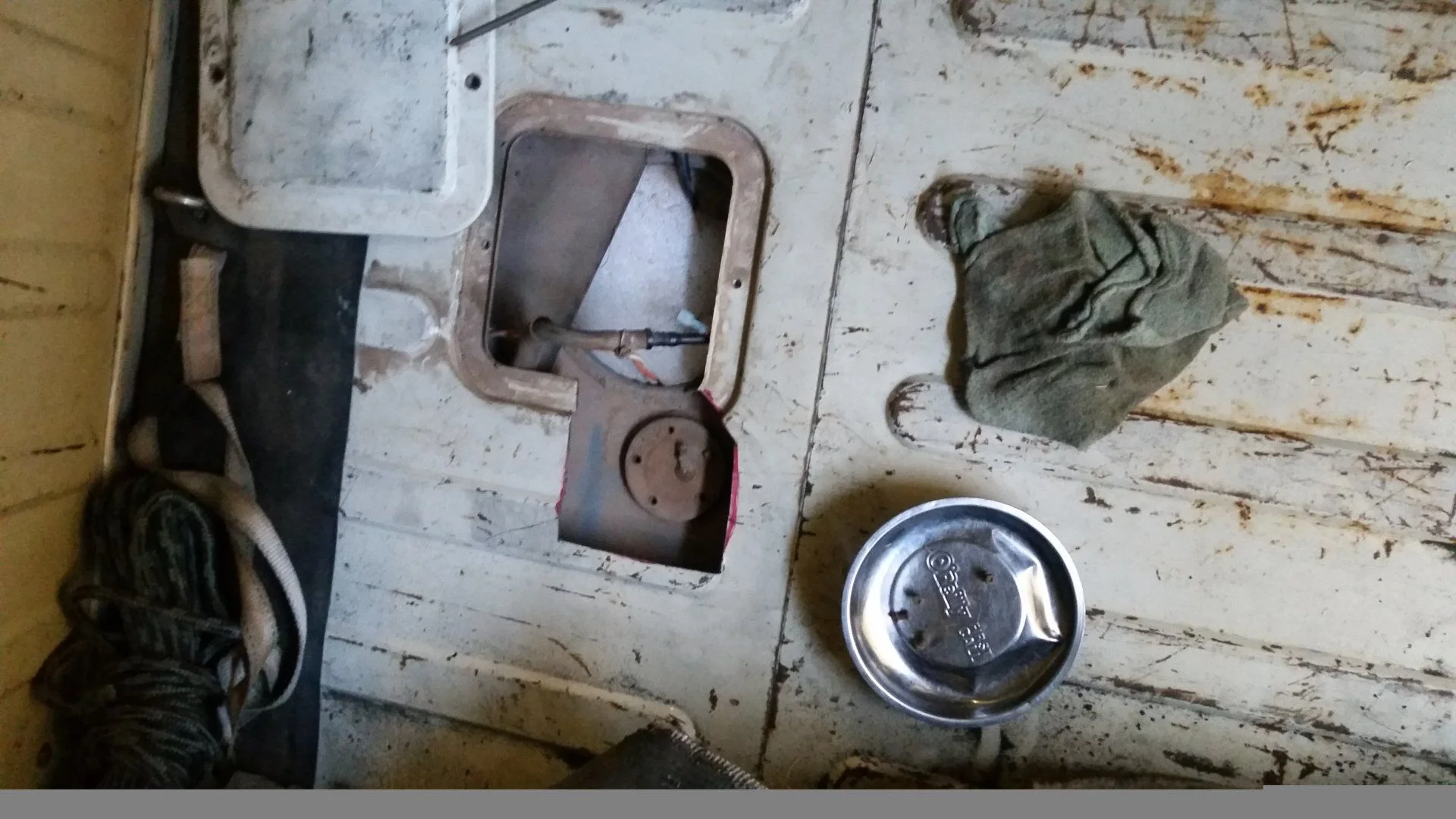

I mounted mine just in the stock sender hole . and just recently enlarged it to access the sender that i moved over . pump is stock lx470
