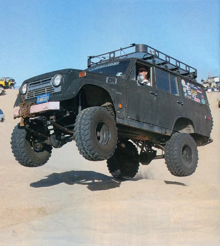

Yes, you can lift it "normally". years ago I had my leaf springs re-arched, put on some of Mark A.'s shackles and after some sawzall work I could fit 35s on it.
Then I did the SOA, which did involve the front disc brakes conversion, new axle shafts and power steering and stuff. I've had this Pig 38 years or so and have had every size tire from stock to now 37s. Mine is a bit rough with a few dents and rock rash, no carpets and some half working things. Mildly lifted Pigs on 33s or 35s look really good in my opinion.
