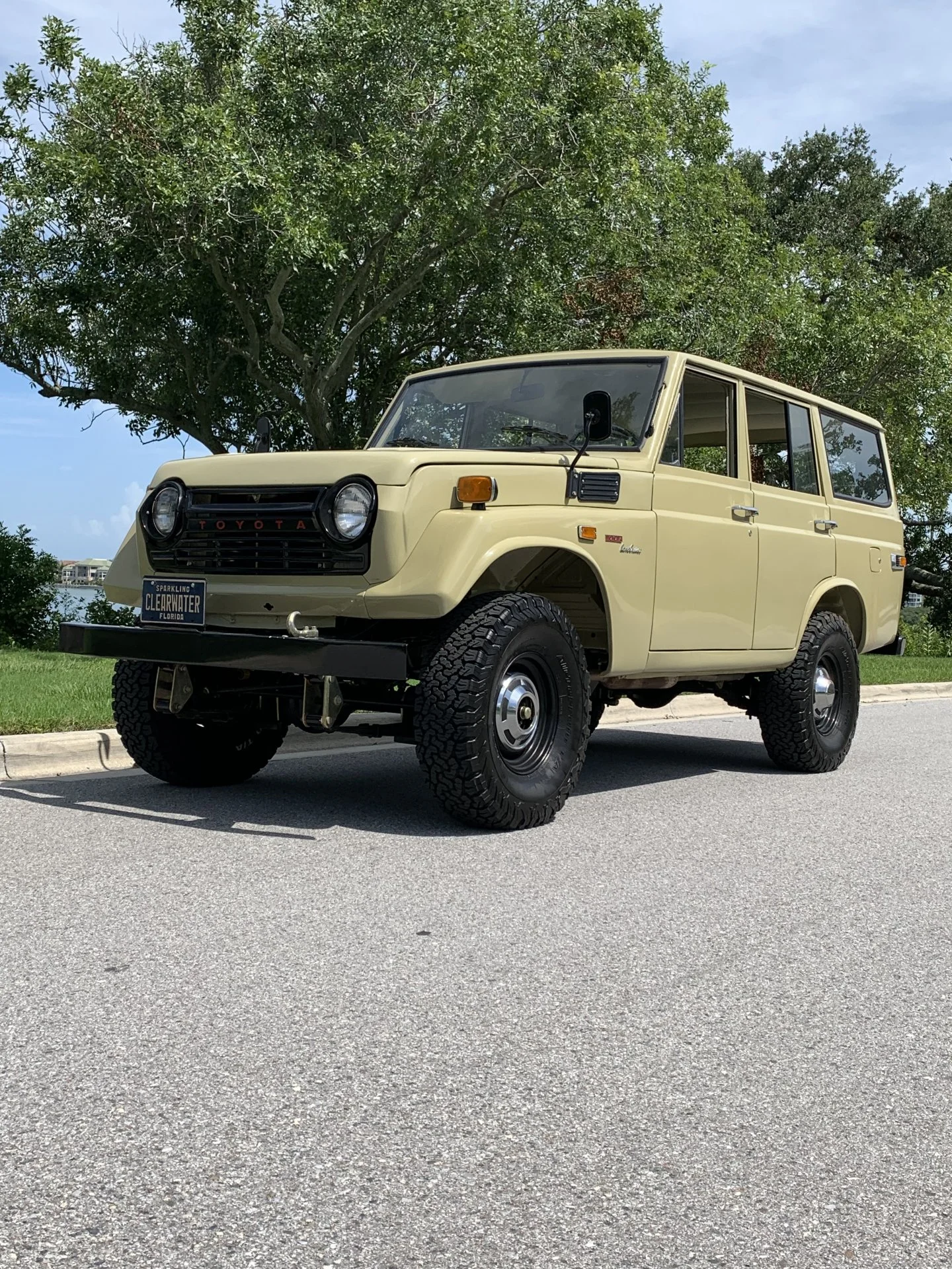

This truck has turned into a slight project / constant challenge to make it operate as it should. I purchased it because of a need to have a mode of transportation in NC. Figured I’d grab something I’ve wanted since my college years and this truck was sorta what fit the bill. I wanted a unrestored preserved truck as orignal paint does make me happy verse someone else’s short cuts and lack of proper steps. I sacrificed and got this one because it was basically completely taken apart and zinc plating done on every single item that they could think of. It just meant to me that it didn’t need to be fiddled with for the most part. Or so I thought.

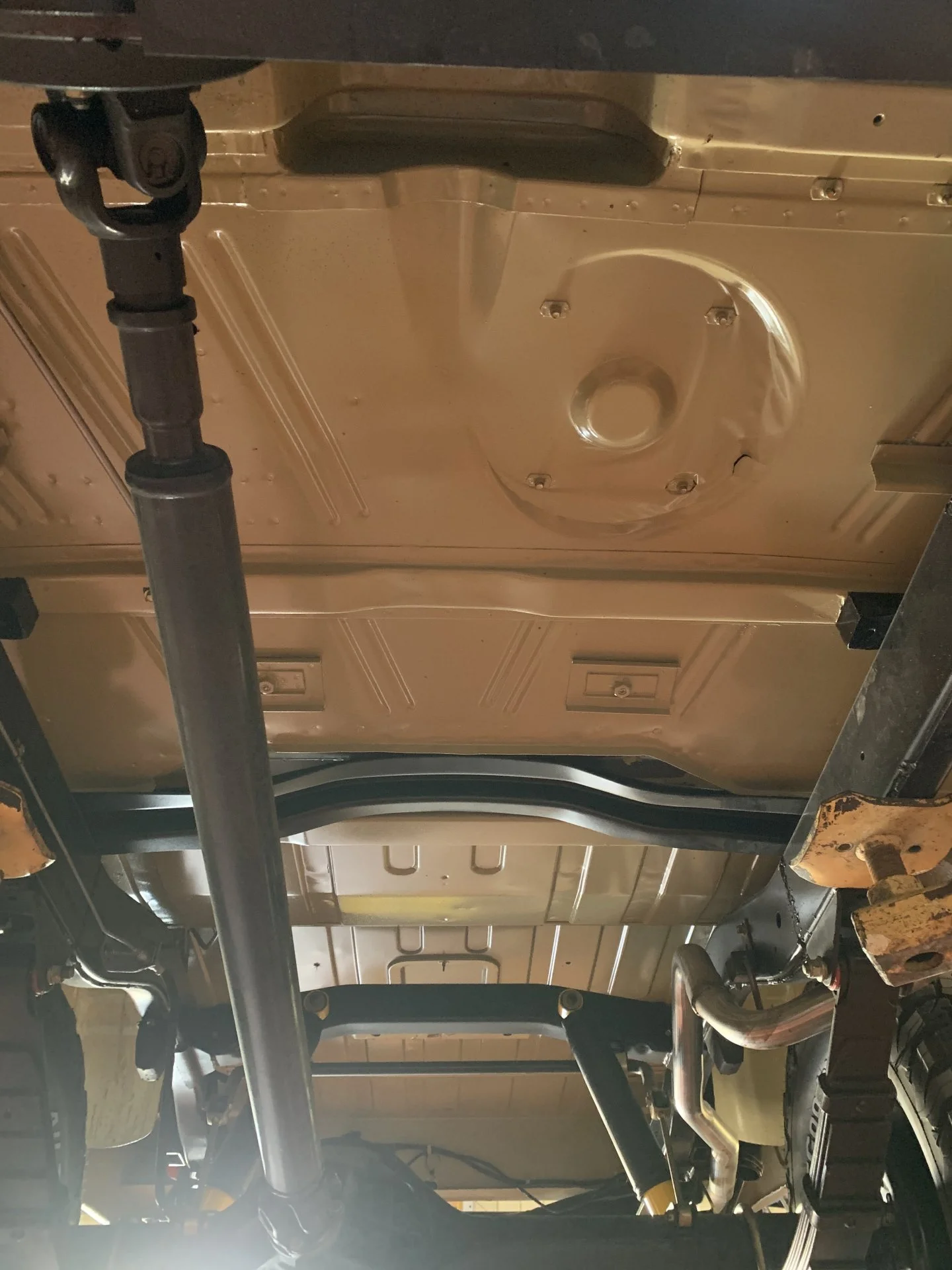

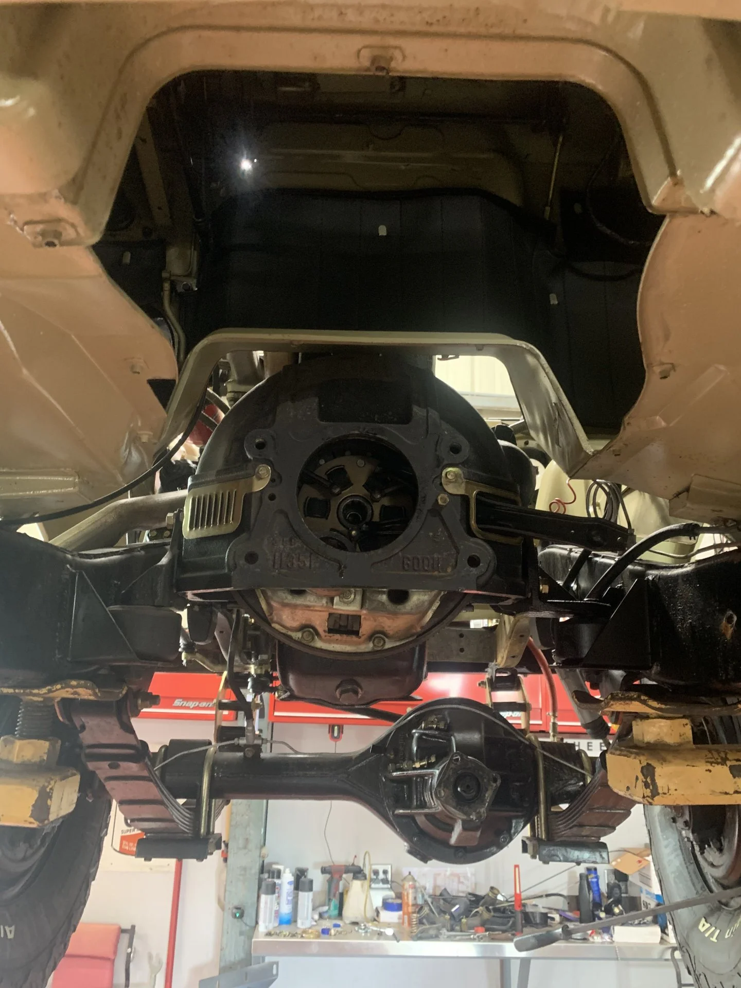

Did you find that section of peeling paint on the underside in the area of where the rear heater mounts?

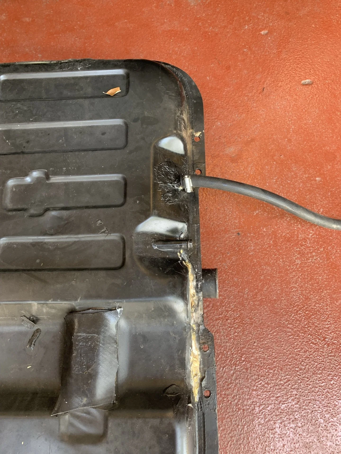

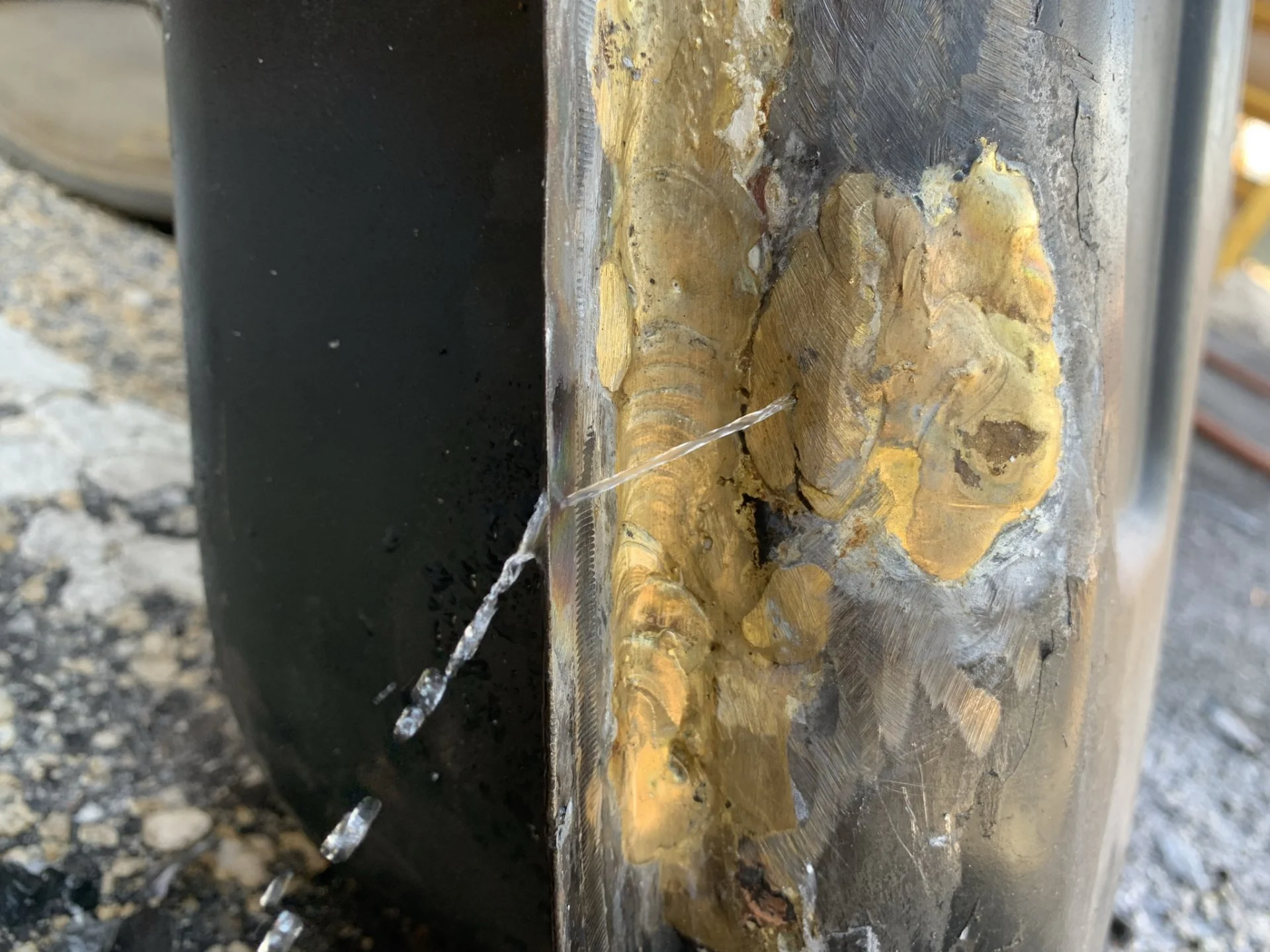

Then there were no gauges. Gas gauge was inop as was the temp. Now we are getting sketchier. Still a gamble I was willing to take. I paid for the truck and left and pulled into a gas station across street and started to top off the tank. Now a old Cuban man came out and was yelling at me because I was leaking fuel all over the ground as I filled up. I laid under the truck and realized it was not something I was fixing on the fly and shook the dice one more time said screw I’ll drive this lit fuse home I just need to close my eyes and hope for the best. Off I went into traffic with a good steady drip / stream coming from an odd location on the top of the tank above the seam. Now it’s sputtering on hard acceleration. It wasn’t doing this on the test drive. Points closed? Burnt points? Clogged fuel filter? Who knows …. Let’s keep going. Now I’m at a auto parts store procuring a fuel can and back to another gas station and a quick top off and fill of my spare and onto the interstate I go.

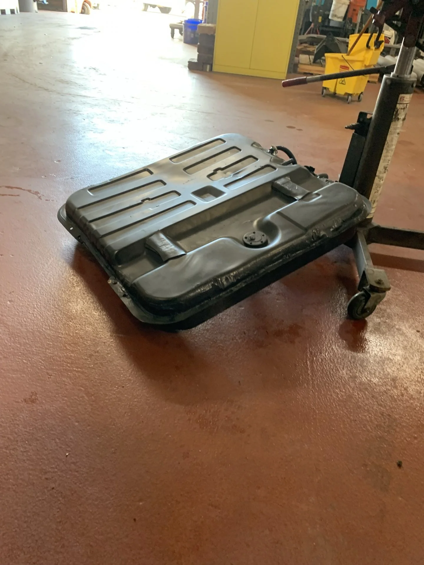

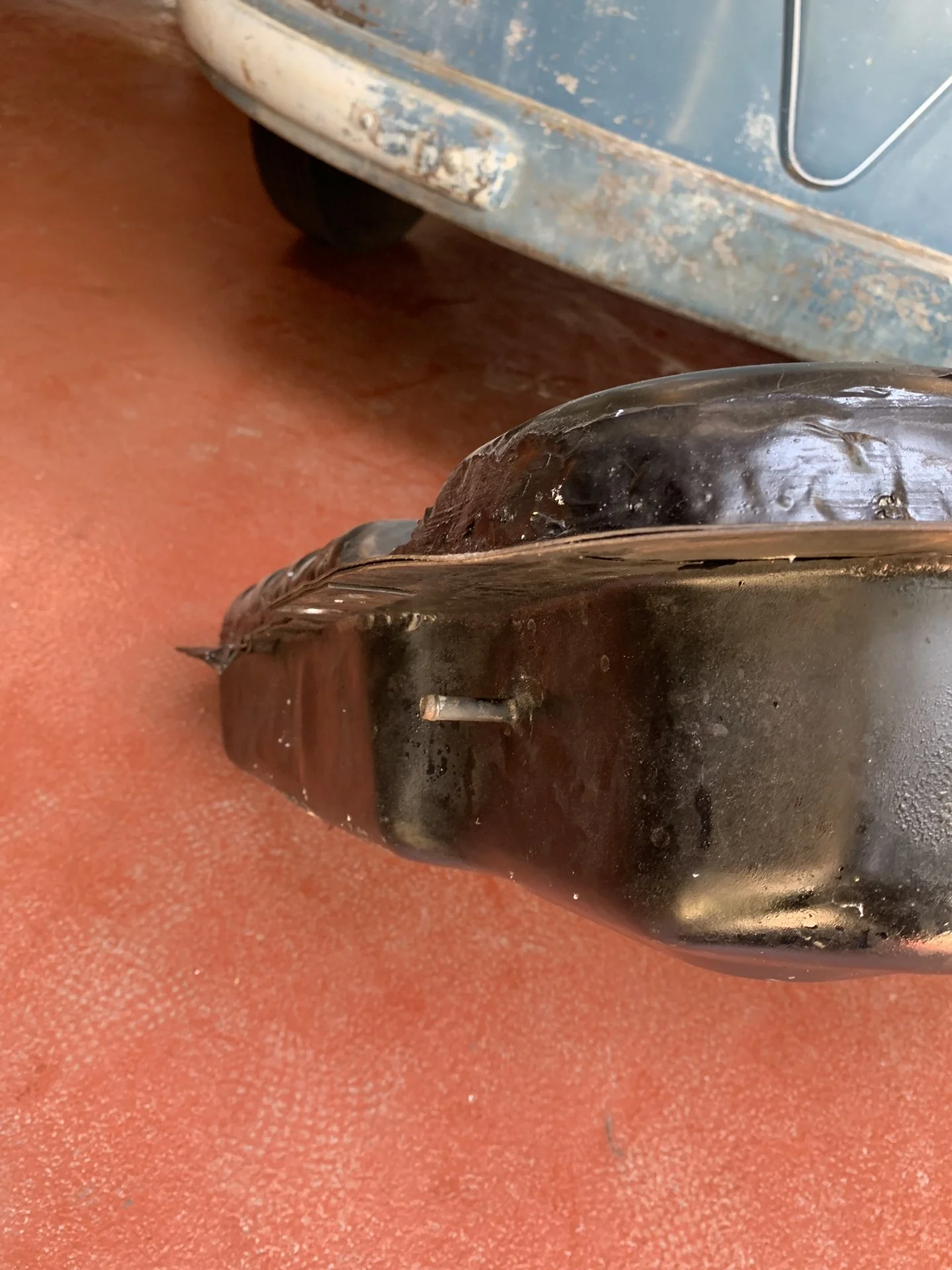

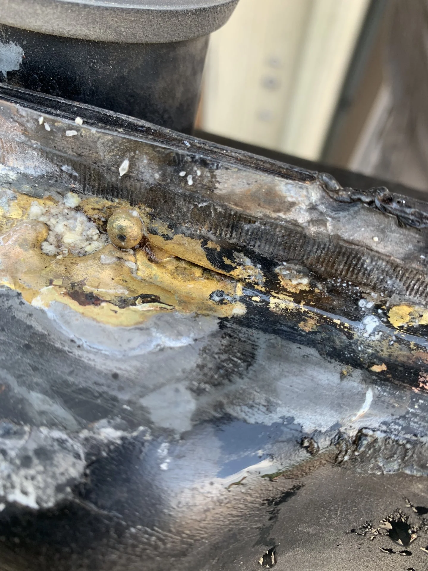

Still sorting out a tank and have one paid for and waiting to see if it ships in the next day but while I wait I derusted the tank and dried it out and lined it and spray bombed the areas I tried to patch with more silicone bronze. The entire top of the tank was cut off above the seem and accessed for some odd reason? Then put back together and installed. Leaking in about 12 spots all around the welds. I have it installed so I can press forward and get running and swap out later with another better starting point. Later on that.

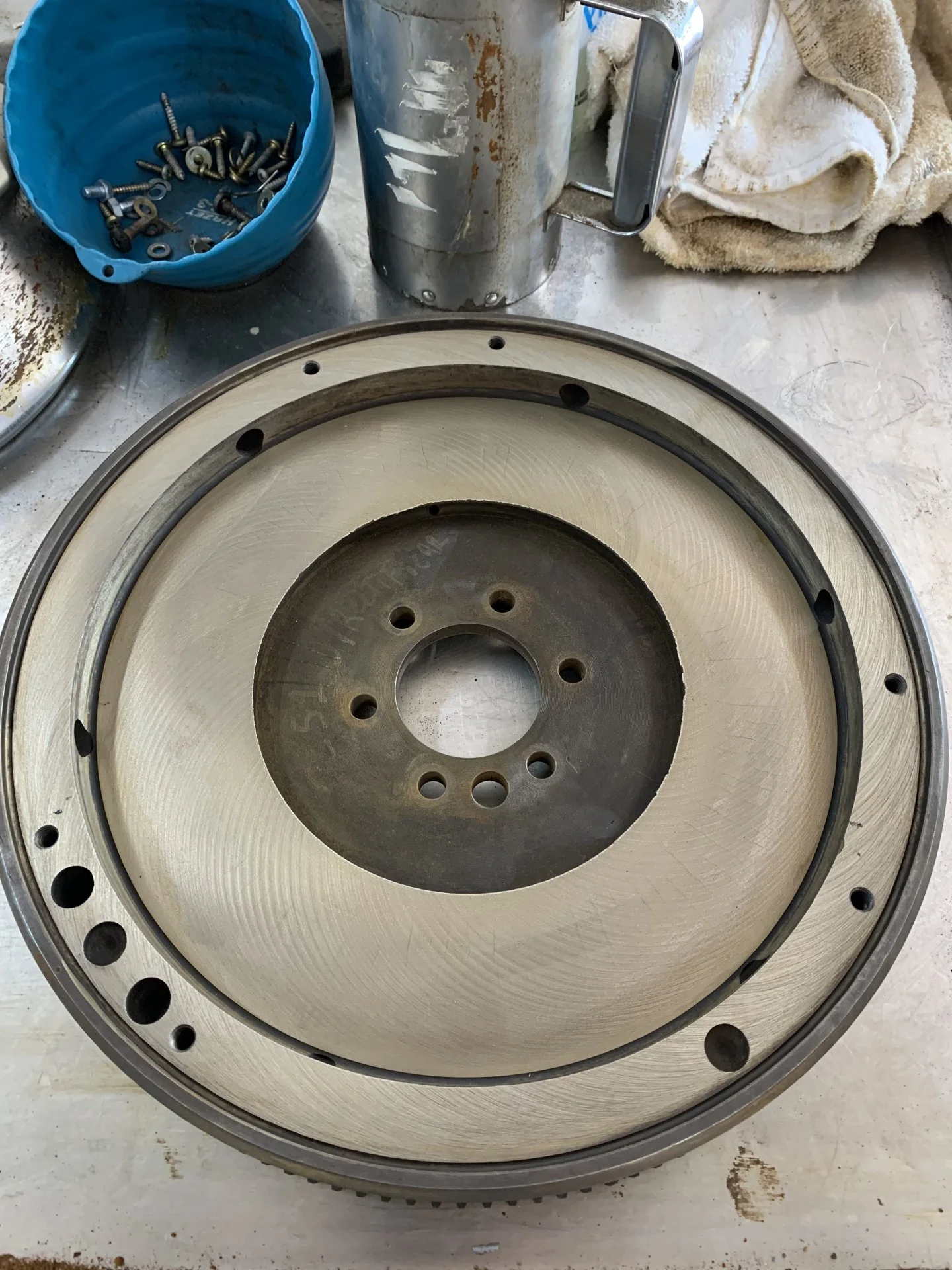

The clutch chattered pretty badly and I wondered if it were just a bad clutch disc… out came the trans and transfer case. As I pulled it and started taking the pressure plate washer that had been ground on one side were shimming the pressure plate off the flywheel? Maybe they machined the stepped flywheel incorrectly? Not sure. The flywheel has been resurfaced and parts arrive later today. Back together with that once the brown truck shows…
Tge three fingers on the pressure plate… anyone care to chime in and explain the adjustment and why one is completely different than the other two?

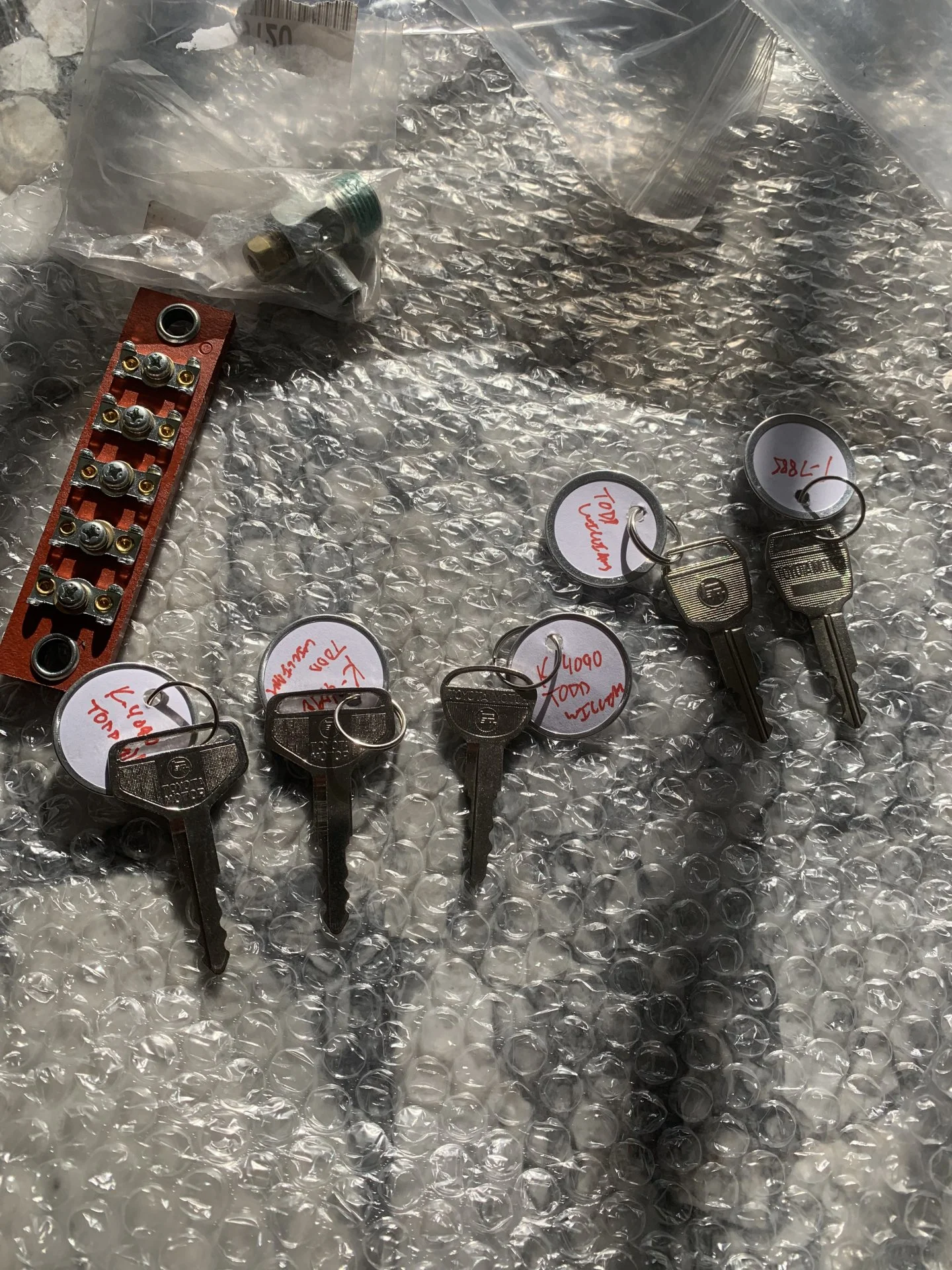

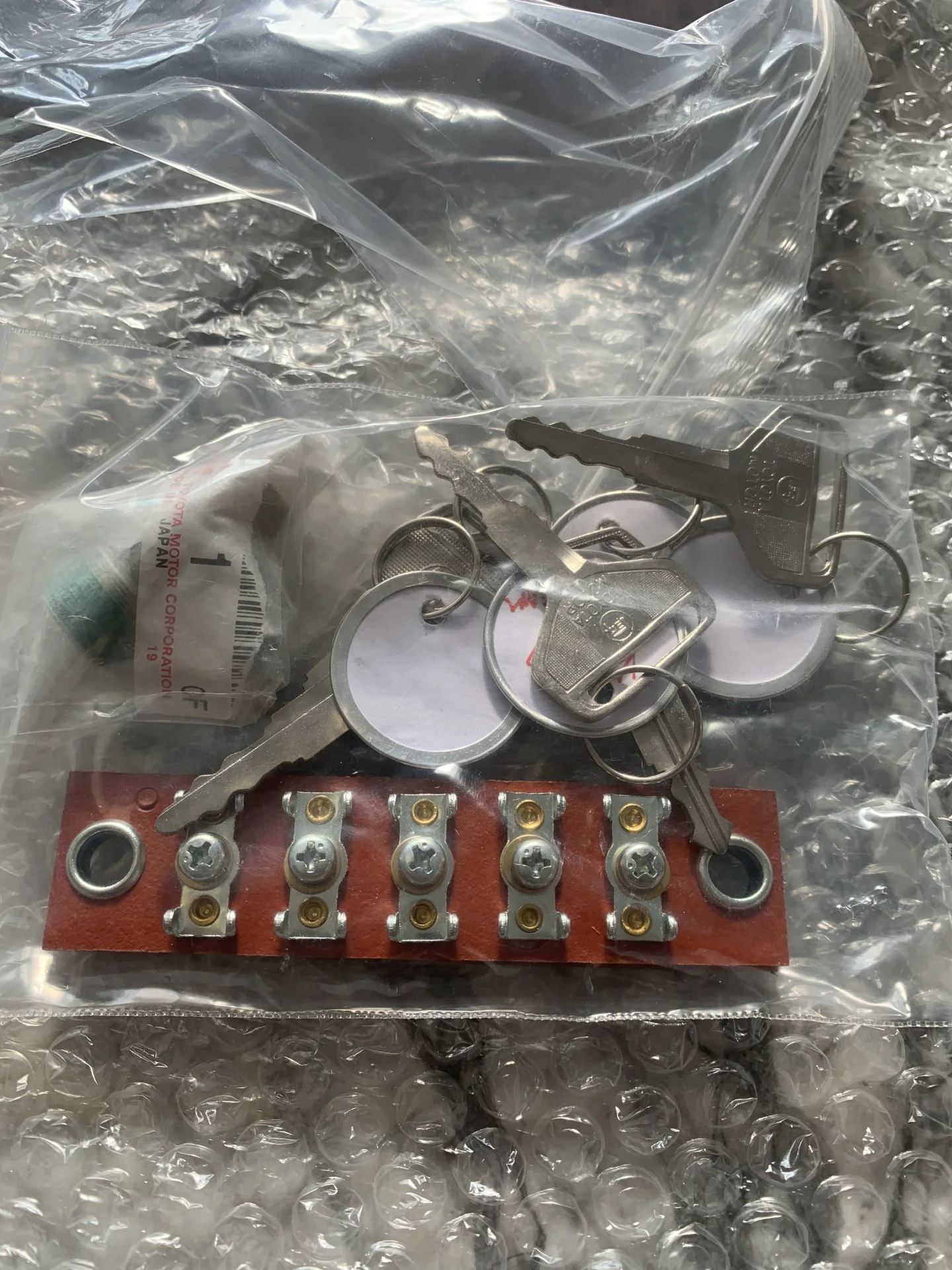

The keys weren’t in super brand new shape but both were original to the truck. They both had their codes stamped on them. After talking with a locksmith friend of mine and him telling me the blanks were tough to find I decided to search. It’s actually how I found this site. Toyota Matt came into the fold…
Matt has the original shorty keys for the door, tailgate and gas filler for these trucks. It’s literally unobtanium if you have looked for them you will know. He also had some other items I was interested in so I splurged a little with him. Good guy! Def is passionate about all things Toyota and will go the extra mile. Thanks, @ToyotaMatt

I believe that was the reason for the diaphragm clutch with all the fingers, easier on your leg muscles. I don't know why those three fingers are adjusted different either. I don't remember seeing adjusters on them, been many moons ago.
So the 3 finger clutches are the earlier 3 spd clutches. When they went to the 4 spd transmissions (H42), they changed over to the diaphragm style (or somewhere thereabouts).
I myself have zero experience with 3 finger clutches on LC’s, but my later style has always be
I myself have zero experience with 3 finger clutches on LC’s, but my later style has always been smooth.
I just need to dig into a manual. I realize there is a difference between the F and 2F I’m just wondering what the adjustment feet on the end of each of the three fingers provide.
