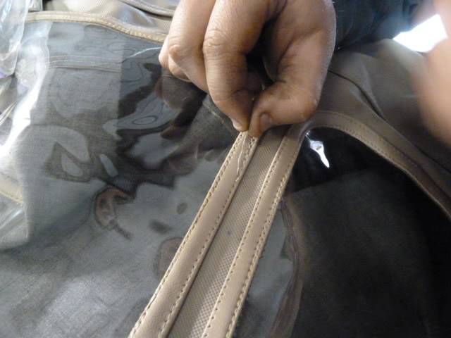

I was in a group buy for the Pakistani Soft Tops way back in September of 2006. Well...I've FINALLY gotten around to installing it and the zippers are shot. The top was garage kept in its original plastic bag, inside a storage crate and out of the elements.

Yep, just buy some good YKK zippers (#10) 36" long (like these - YKK #10 Molded Extra-Heavy Separating ~ 36") and take them to your favorite upholsterer. I bought the above zippers and it cost me about $85 to have them all installed last fall. Call around, because I was quoted as high as $500 to have the zippers replaced. And, as you've figured out, the stock zippers on the Paki top are pieces of $hit.

Do yourself a favor and have new zippers installed before you install the soft top. They WILL break. All 6 of mine (they had WAZIR stamped on them not USA) blew out within a couple of weeks of installing the soft top. First the zipper splits and then you break the pull tab trying to fix it. :mad: I have not had any problems with the YKK zippers I put in.
