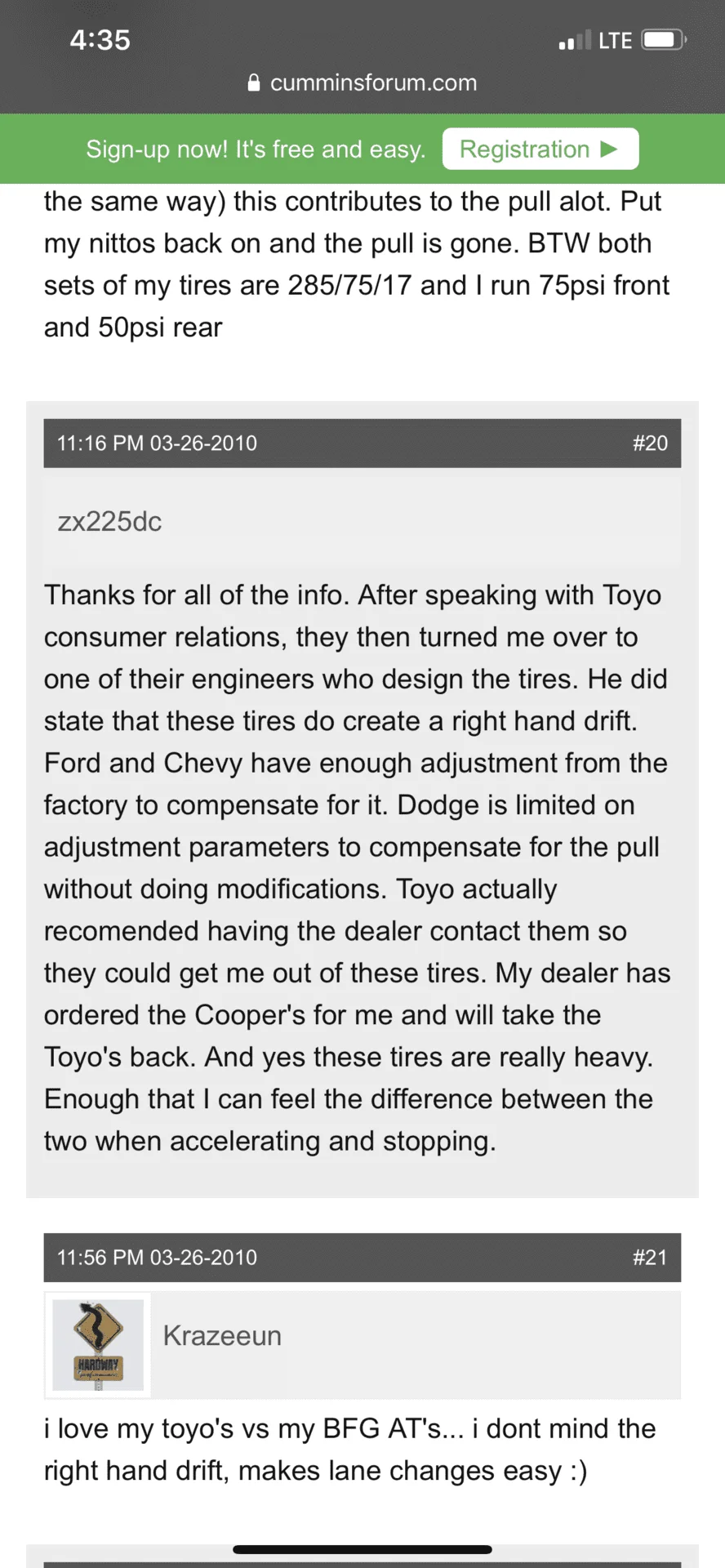

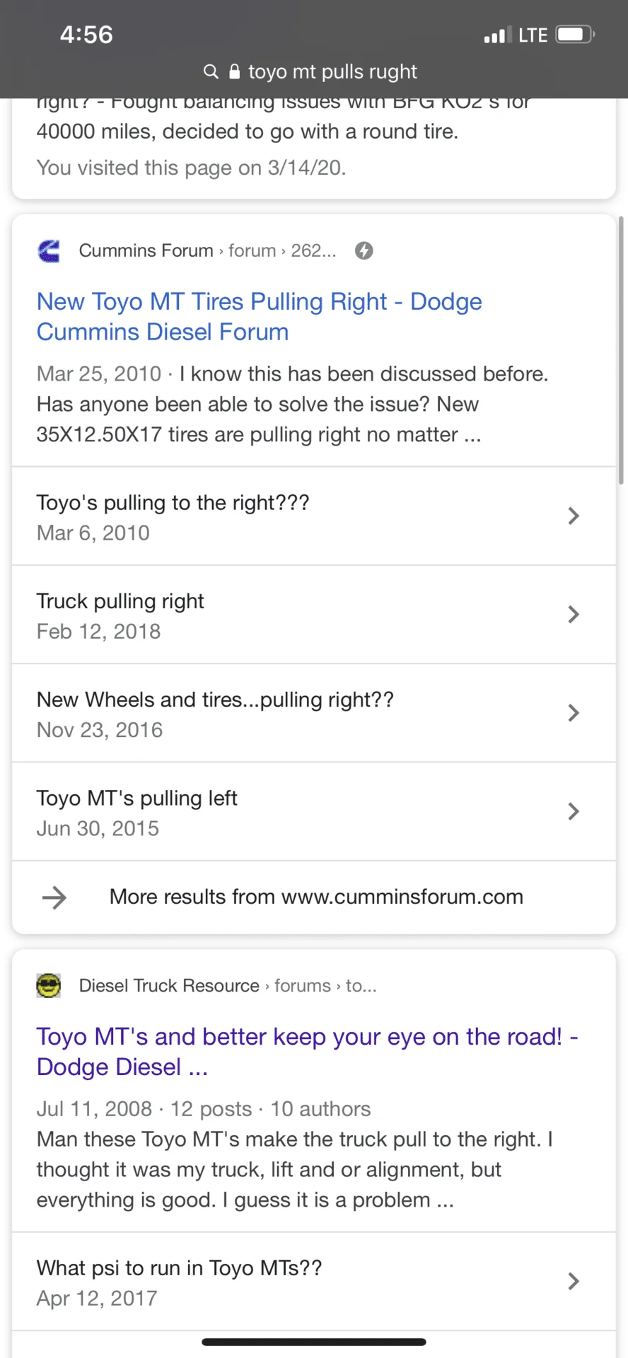

The pull has stopped. I’m going to return that tire to 4WP. I did an 80 mile drive on Saturday and now it doesn’t brake pull either. I’m not well versed in tire theory; but I never thought the left tire would cause a right pull. I guess I learned something new.
