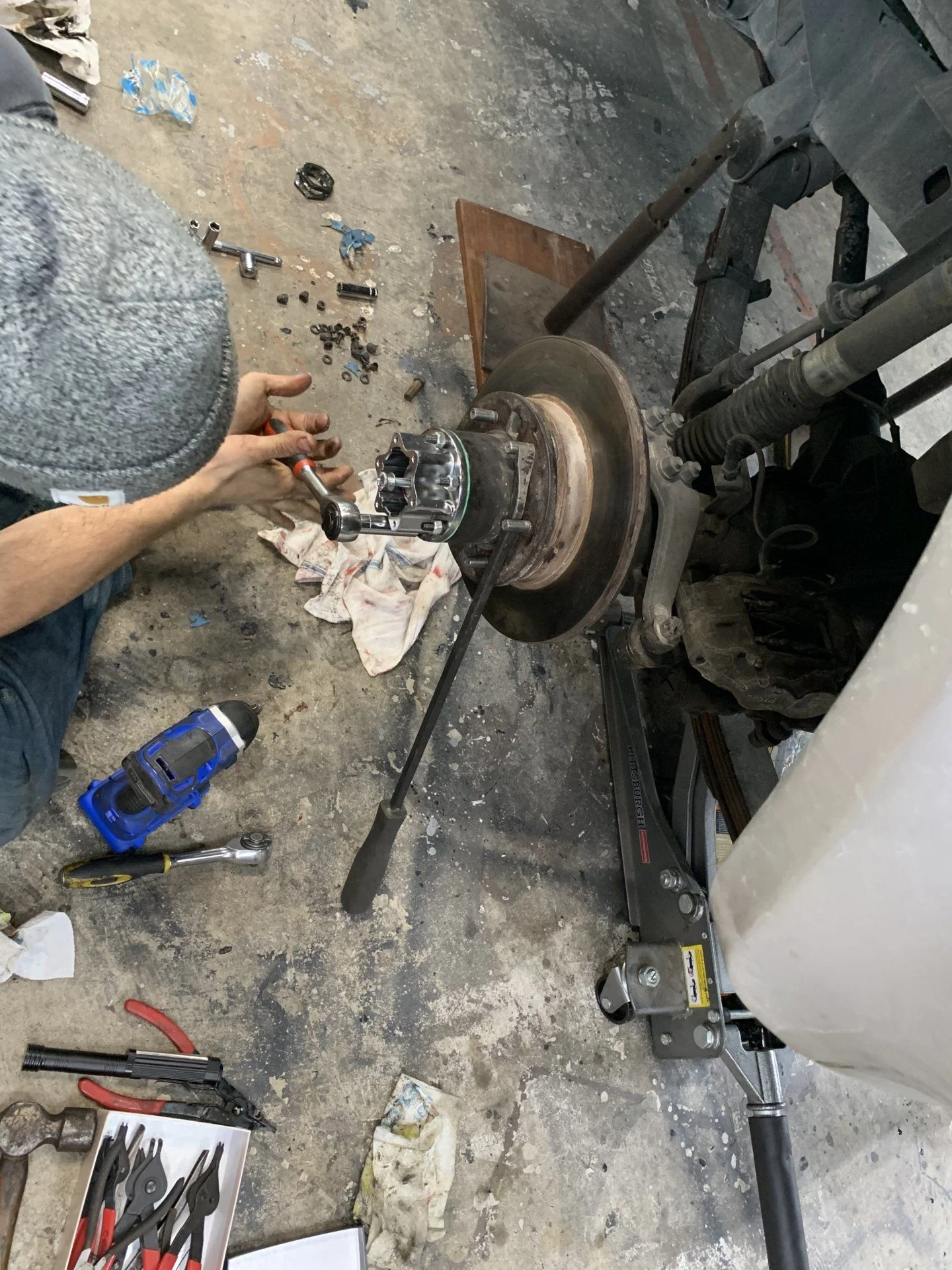

Caught up on maintenence!
Koyo wheel bearings and seals
Timken wheel bearing grease
Front range off road ARP hub studs
New cone washers
OME Square front u bolts for the new 4* shims.

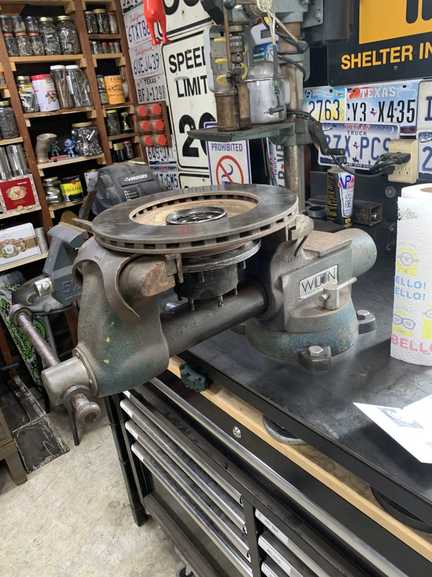

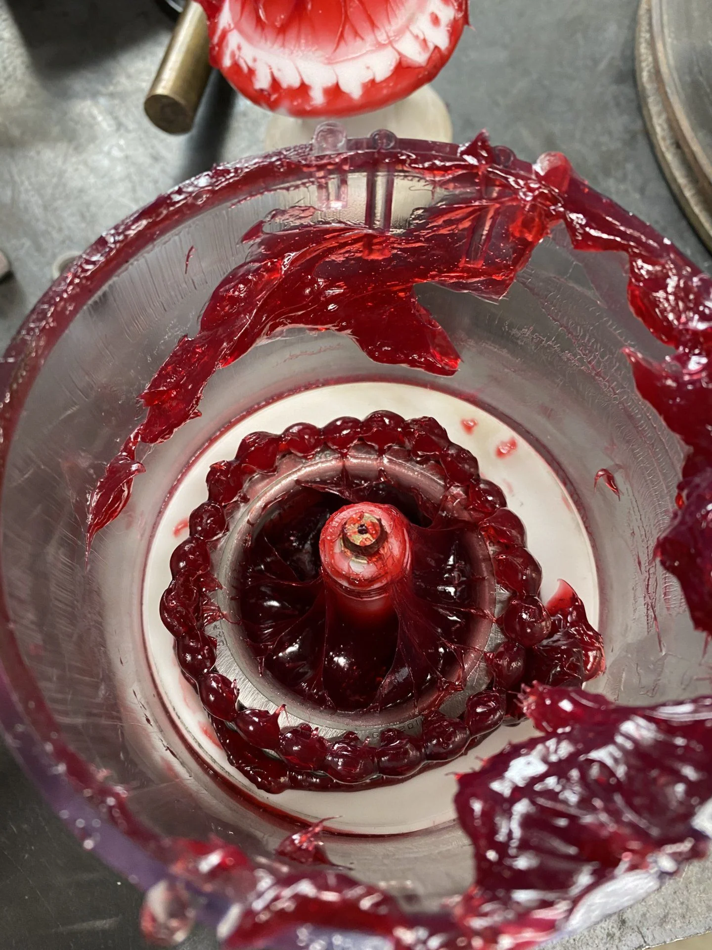

I cooked these last bearings. Lots of scoring on the race and not enough grease. They were wobbling under hard breaking from not being torqued right and had play up and down when you pushed on the wheel. I used a Lisle bearing packer this time and it was amazing. So much easier.

All is good now and I threw in a new aftermarket window regulator on the drivers side.
I can now work on other things. Like lockers.
