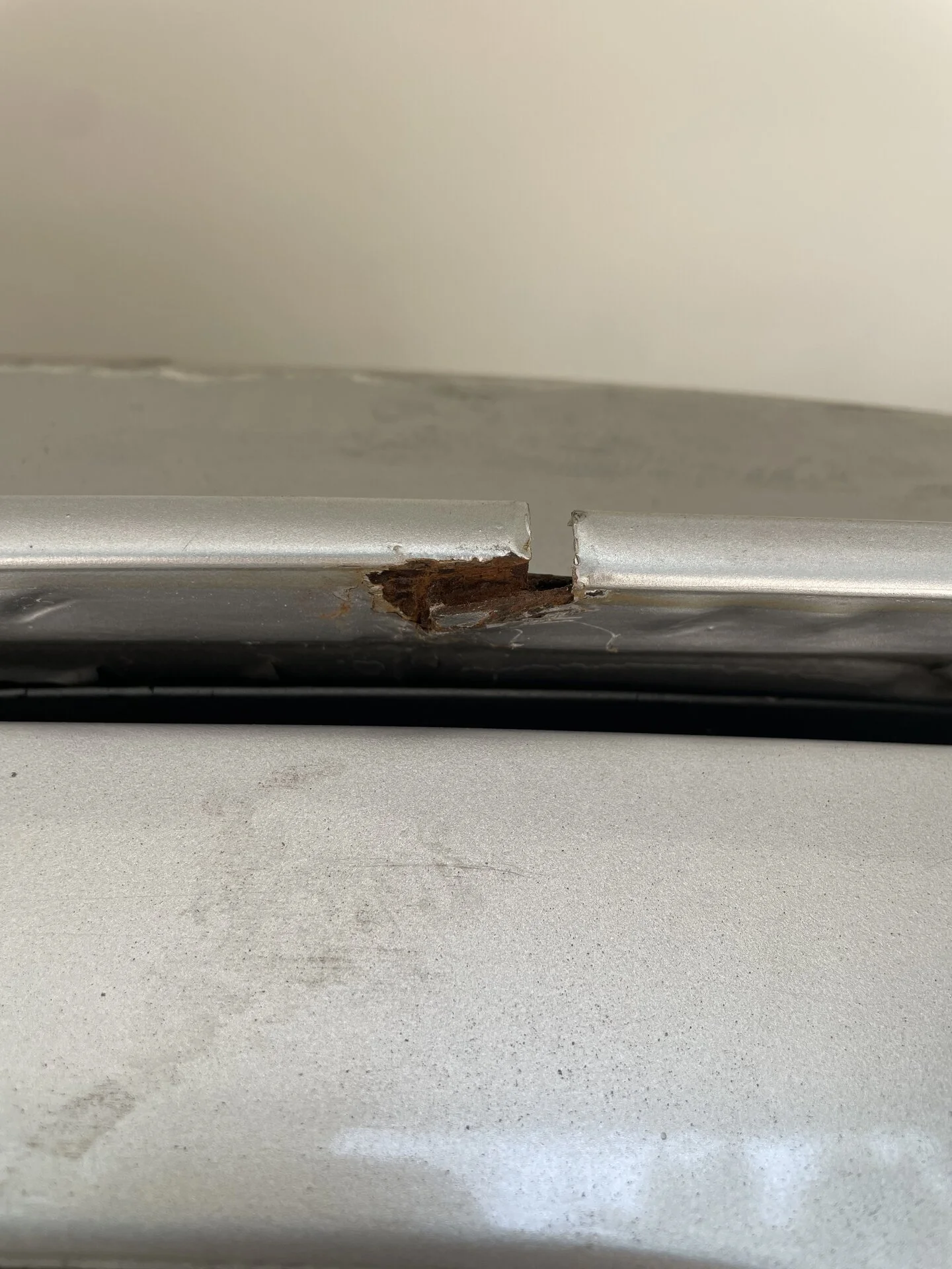

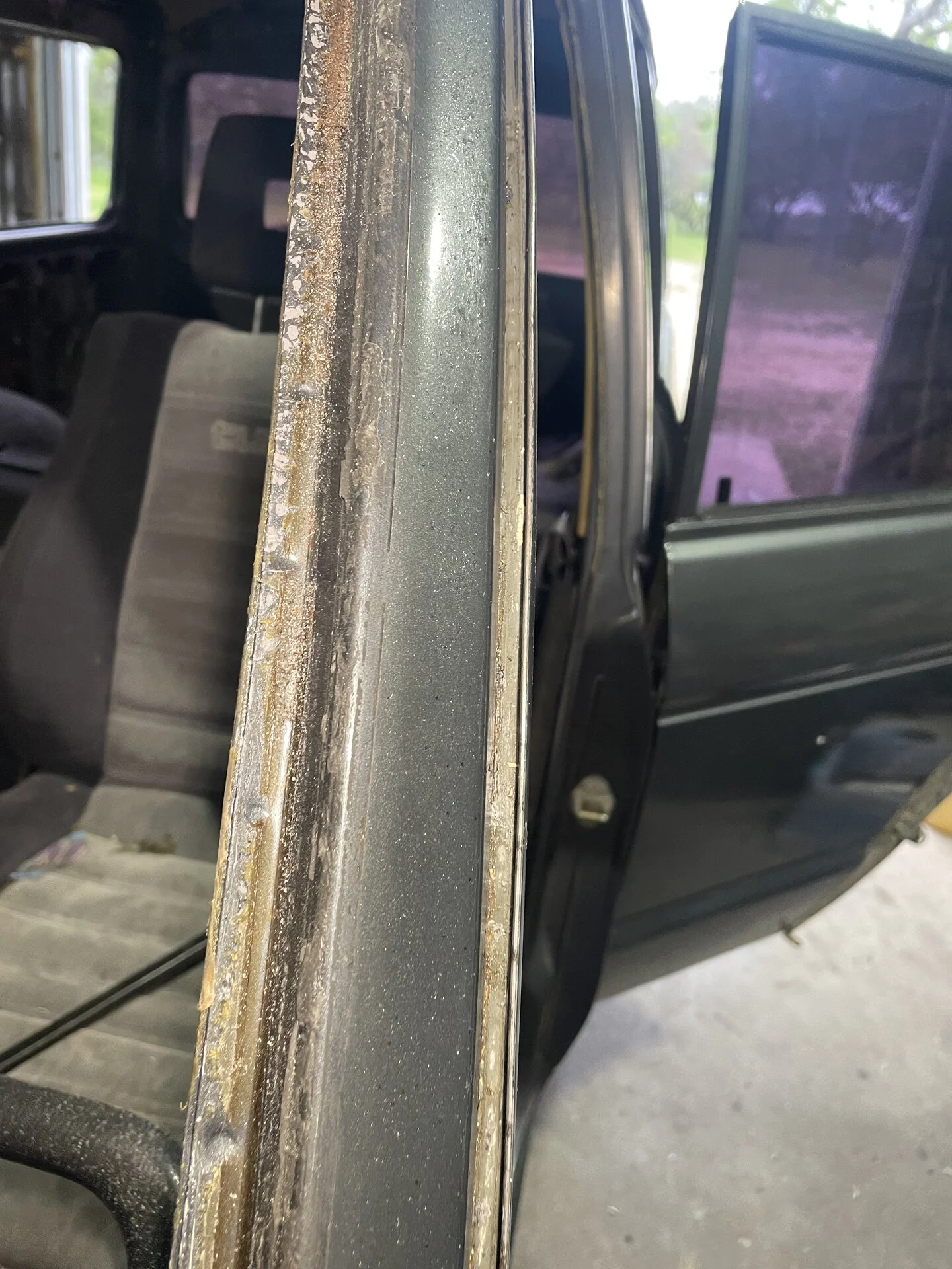

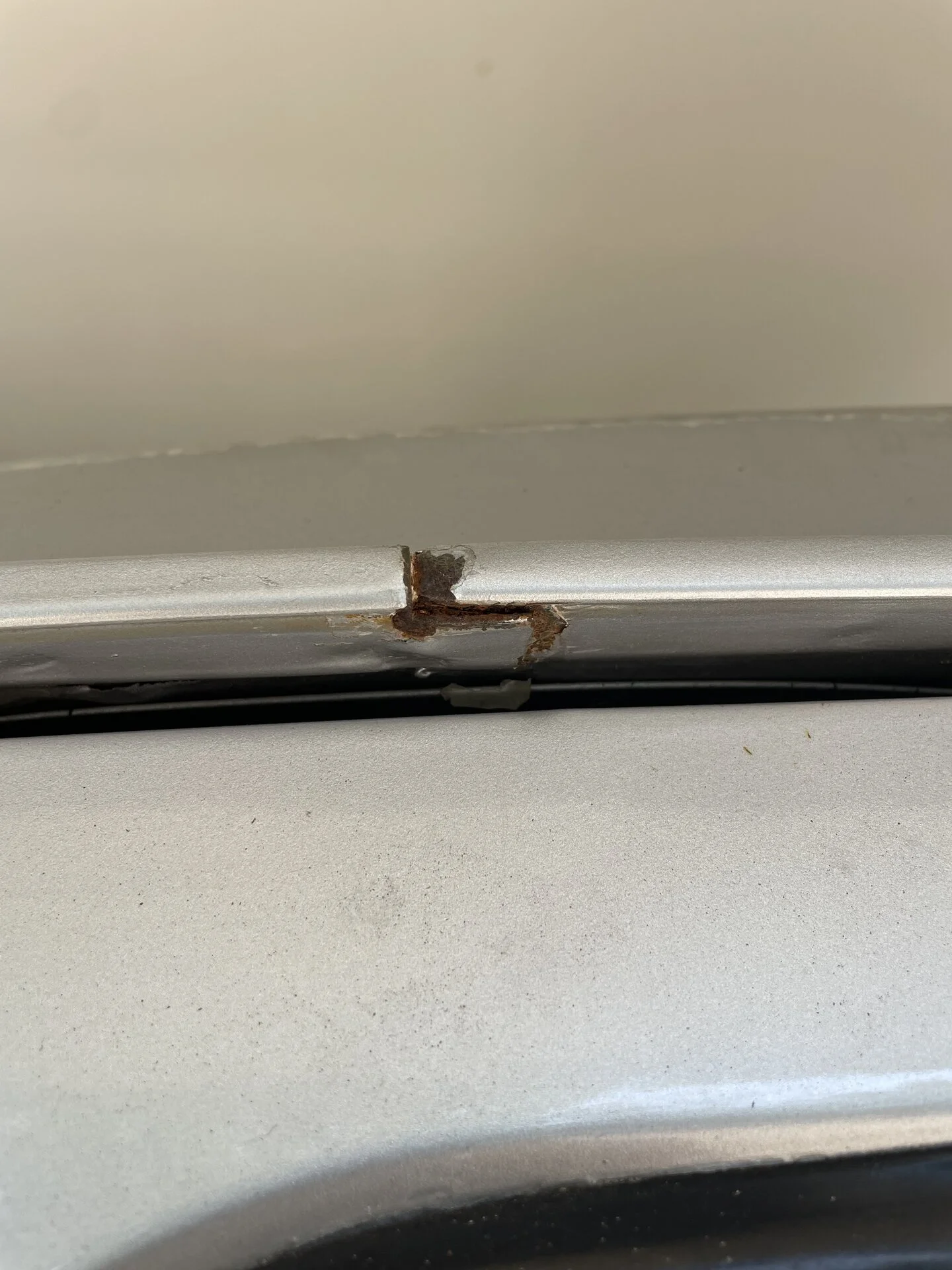

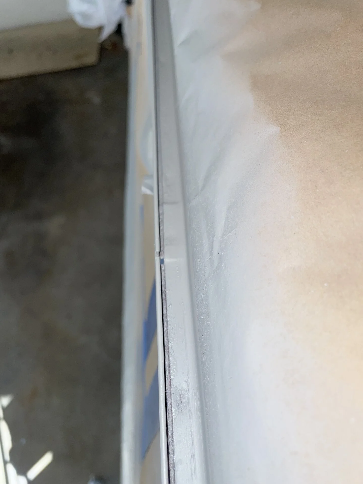

Started by treating the rust. Current plan is to just keep the rust at bay for a couple of years and then get it to a professional for complete strip and repaint. Spots of rust in the gutters at the joints, driver’s side A pillar, and both front doors at the bottom seams. Fortunately, it’s pretty mild.

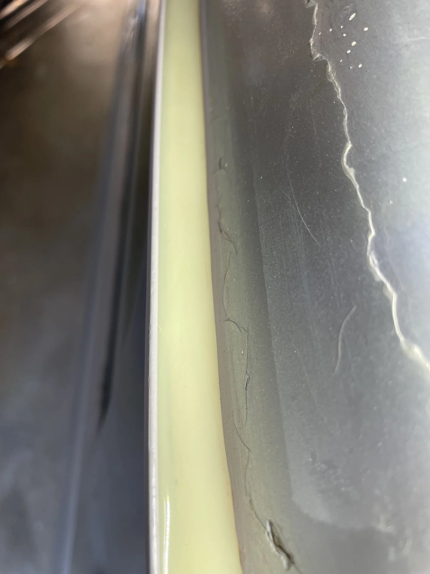

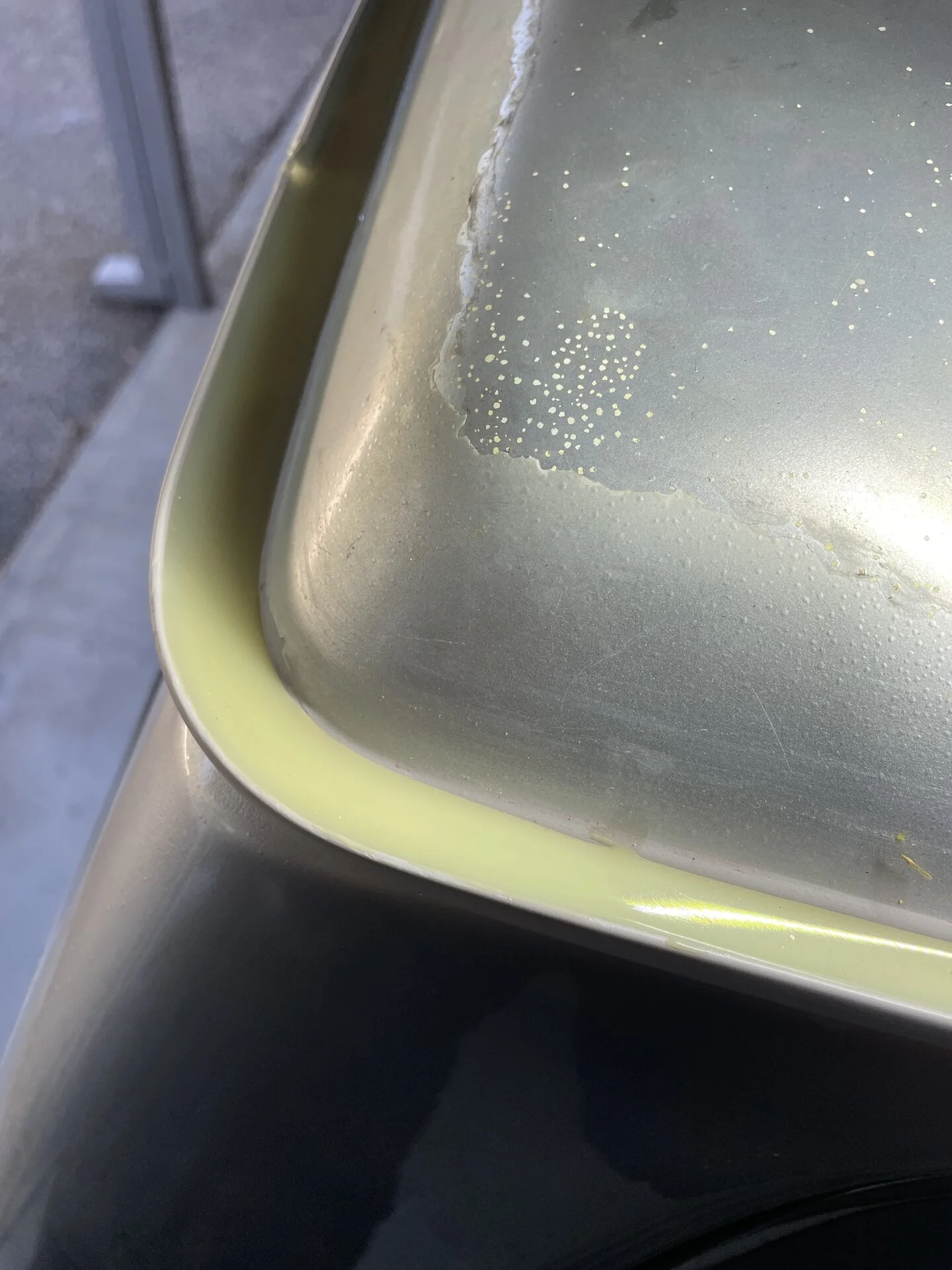

Started with the gutters and working my way down from there. Spent a couple of weeks removing all of the old seam sealer, then ground out the rust, soaked the rails with ospho, then primed, applied the 3M self leveling seam sealer, then primed, painted and clear coated. Pleased with how it turned out for my first attempt at autobody work. The seam sealer set up way faster than I expected which made the very narrow gutters on the A pillars challenging.
In hindsight, I wish I would have hired a pro for this job. It took a huge amount time in prep work.

Yeah, money saved, just not sure it was worth it!
Thank you to everyone who has contributed to the body of literature on this process; this is my contribution as a complete amatuer who has never done any auto body work. Proceed with caution…
First, let me reiterate that if you have the money and you have access to a high quality auto body professional, whatever you pay that person will be money well spent! This is not an easy job and an experienced professional will be able to knock it out is a fraction of the time with much better results.
Here is the procedure I followed based on crowd sourcing advice from Mud and YouTube:
  1. Remove old seam sealer
  2. Grind out any rust
  3. Blow out all debris
  4. Tape off/mask around the gutter
  5. Sand blast gutters
  6. Remove tape and masking
  7. Blow out all debris
  8. Treat gutters and rust spots with Ospho
  9. Remove ospho residue
  10. Clean with wax and grease remover
  11. Tape off and mask
  12. Prime with 2K epoxy primer (at least 2 coats)
  13. Remove tape and masking
  14. Buff gutters with gray Scotch-brite pad
  15. Blow out with compressed air
  16. Wipe down w/ wax & grease remover
  17. Re-tape and mask for seam sealer
  18. Apply seam sealer
  19. Buff gutters with gray Scotch-brite pad
  20. Prime with 2K epoxy primer (2 coats)
  21. Buff gutters with gray Scotch-brite pad
  22. Paint with factory color paint (2 coats)
  23. Paint with 2K clear coat (2 coats)
  24. Remove tape and masking and enjoy

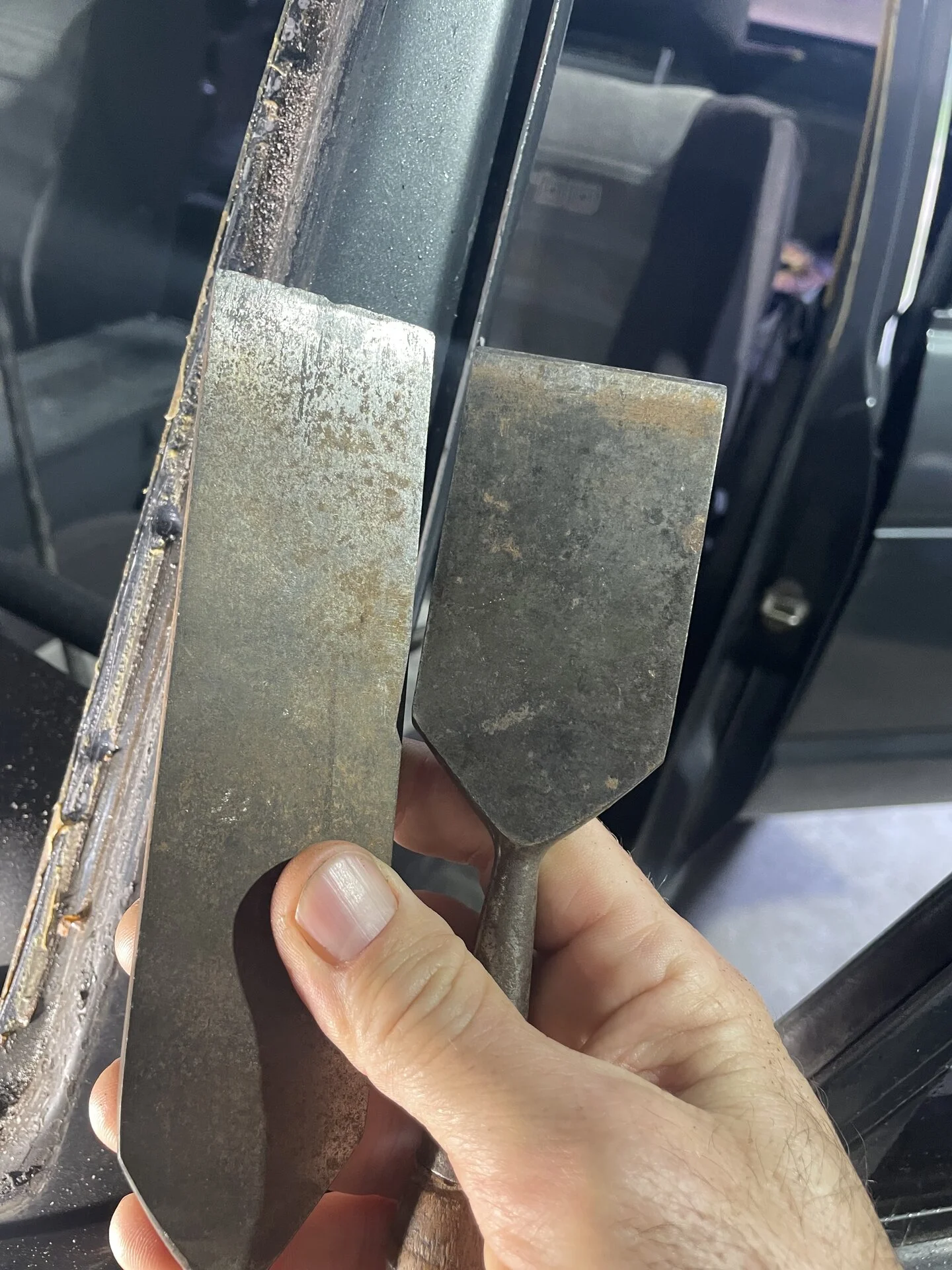

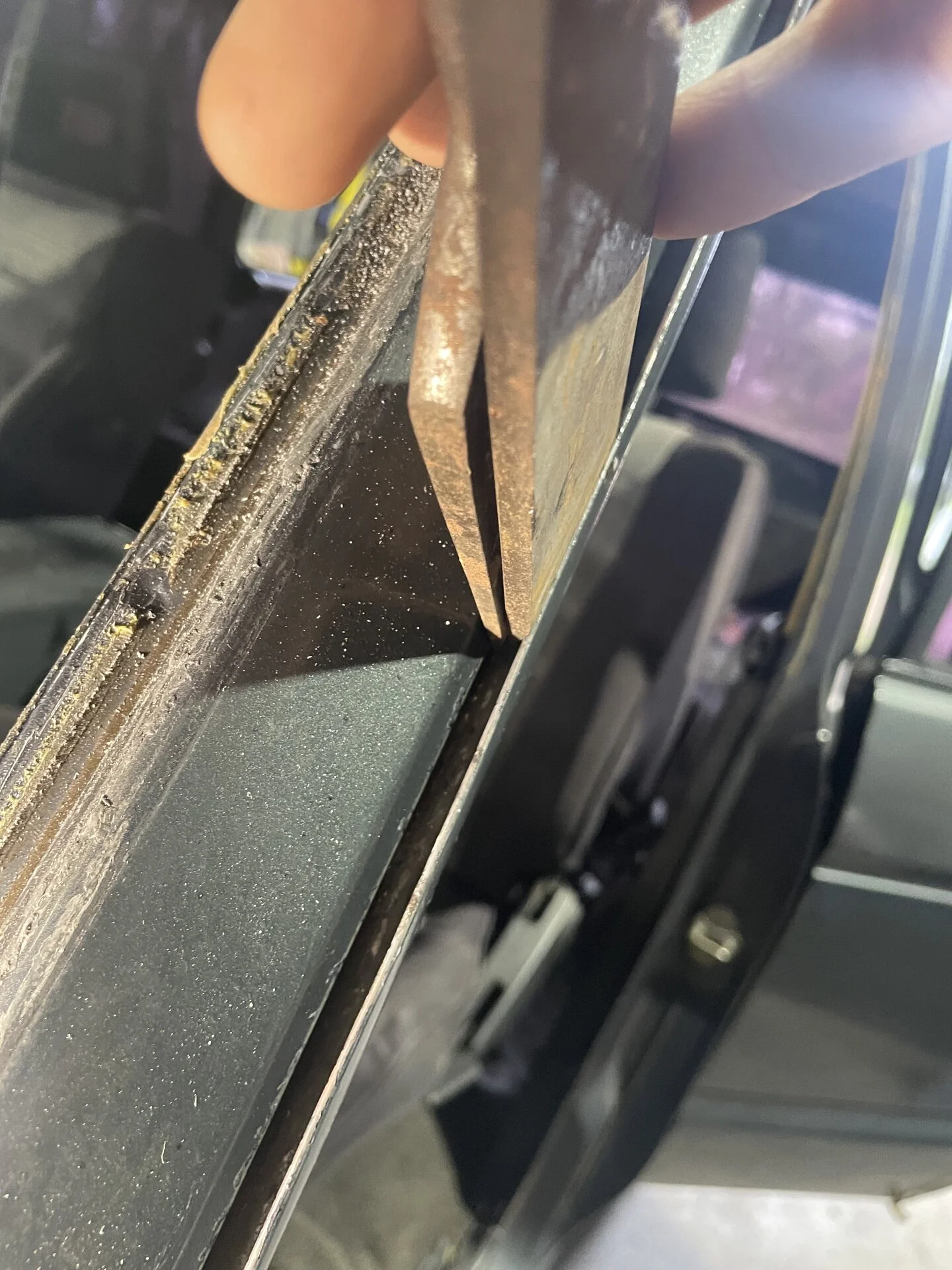

Without a doubt, the most difficult and time consuming part of this job is removing the old seam sealer. About 95% of my sealer was in good condition but there were areas that were failing in the A pillars and the gutter joints on the sides and rear. So it all had to come out.
The two best tools I found for digging out the old sealer was slightly dulled (so no metal gouging) wood chisel that was a little narrower than the width of the gutter area and an automotive pick.
Doing this exact job this weekend on a friend’s HJ61 @landsnoozer
One thing I learned several gutter jobs ago was to open up the gutter channel on the a-pillars. I use a few old wood chisels and slowly work my way up and down the channel. That way I have good access for cleaning, treating and applying seam sealer.
This would have helped me a lot. Mine are so narrow I had to use a syringe to get the seam sealer in there.

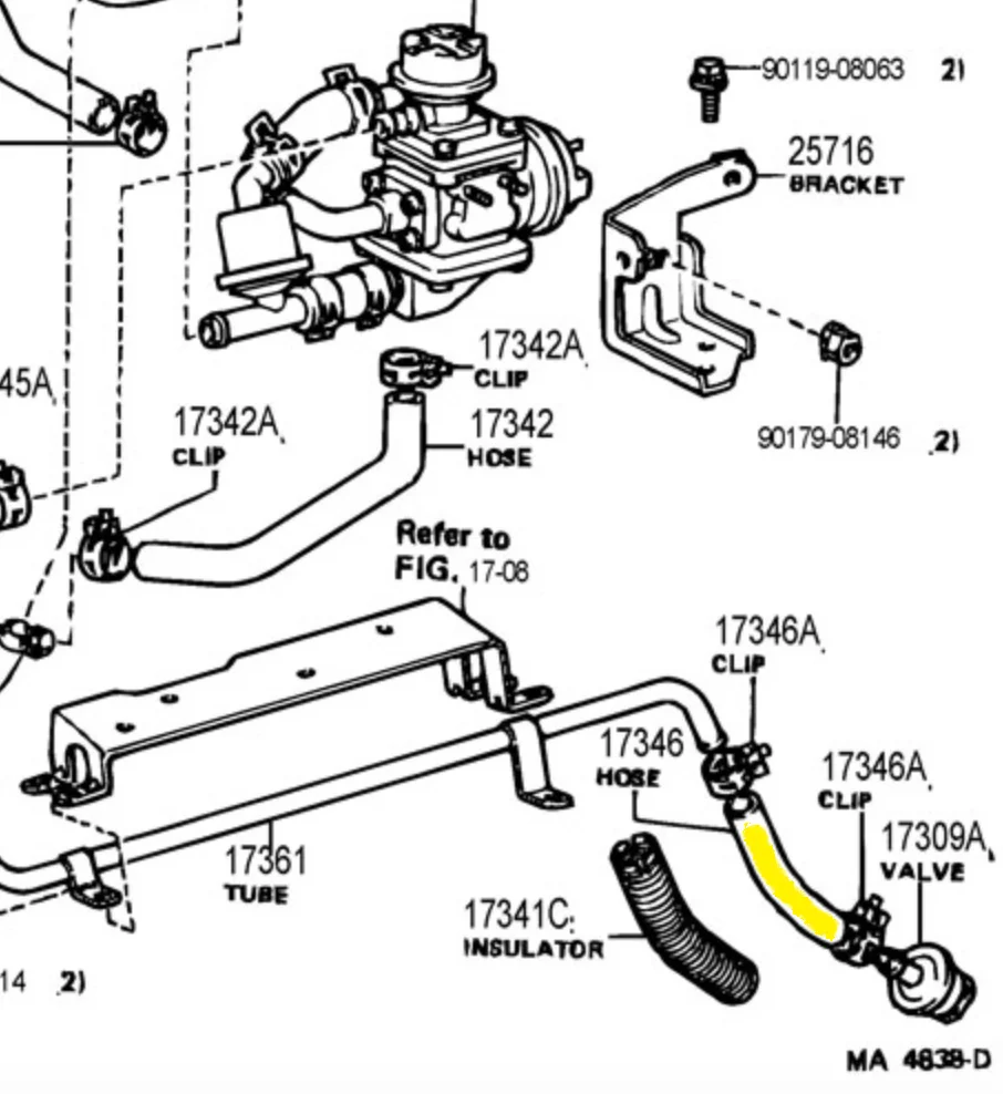

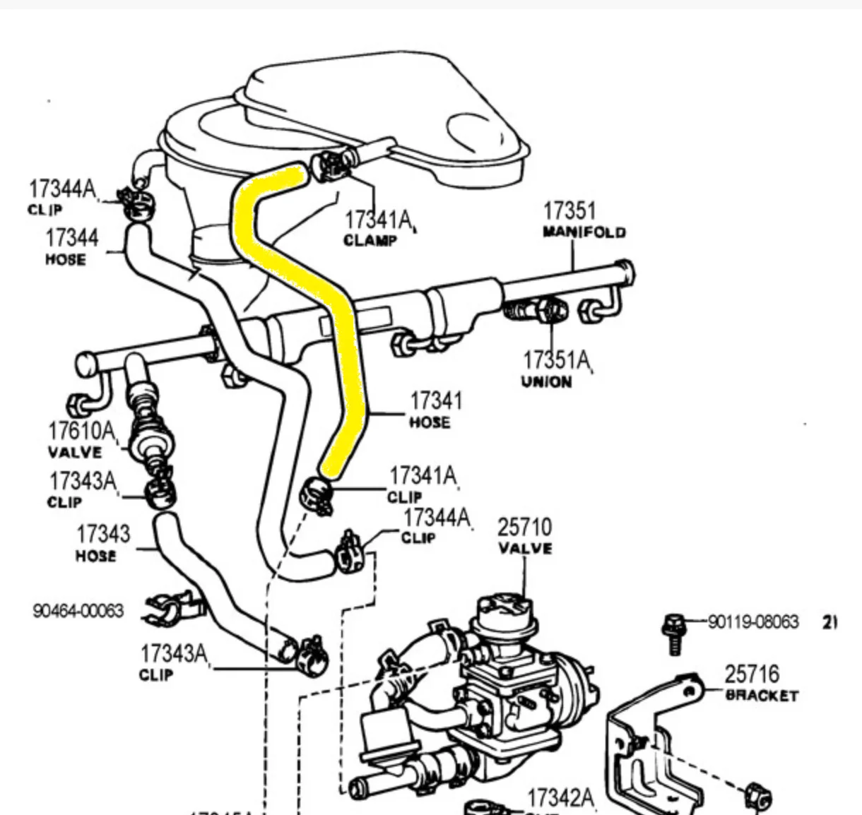

Does anyone have these two smog related hoses laying around in a discard pile from your desmog? I also need the insulator sleeve for 17346.

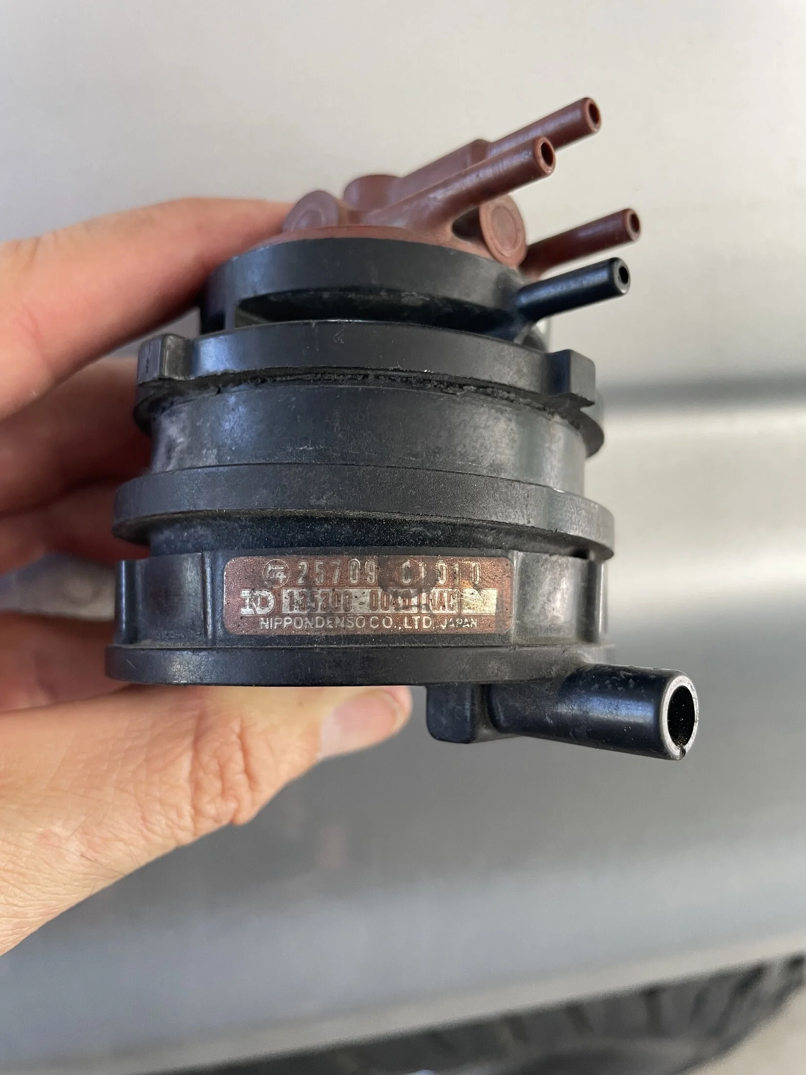

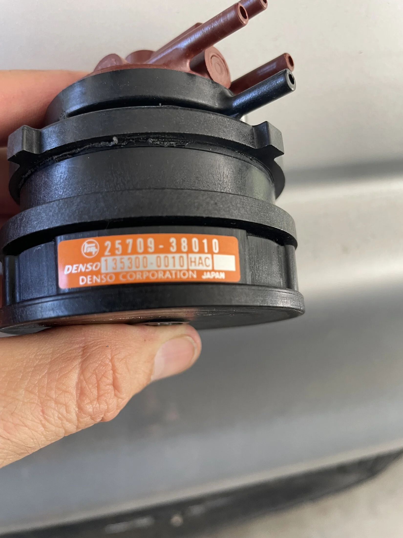

I had some engine problems in the way to Big Bend a few months ago and I’ve been working through a few potential causes of the problem. When we were about 8 miles outside of Marathon (elevation 4100ft) we started experiencing what felt like fuel starvation. We had been driving for over 8 hours at this point. It happened intermittently and despite stuttering off and on for the last eight miles, we made it to the hotel. Gave everything a look over that night but could not see any obvious issues. Woke up and drive to Marfa with no issues. A few days later, we drove from Marfa to Big Bend with no issues, but as we were leaving the park, climbing up the steep grades was very difficult. From then on the issue never stopped. Drove it 10 hours home dealing with it the whole way. The next time I drove it and every time since then I have been unable to replicate the problem, but I have not driven more than an hour at a time.
So far I’m chipping away at some easy troubleshooting:
- replaced the gas cap
- replaced the fuel filter
Now I’m replacing the altitude compensation valve. I ordered what I had hoped was the right part but on arrival I noticed a significant difference: the bottom tube connection is non-existent on the new part. In my 60, the bottom hose connects to the ACV but is not connected on the other side. Anyone know if the new ACV will work?

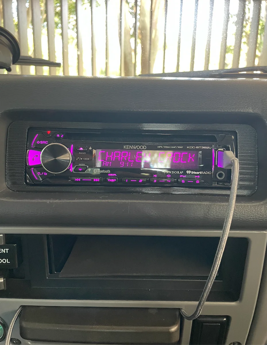

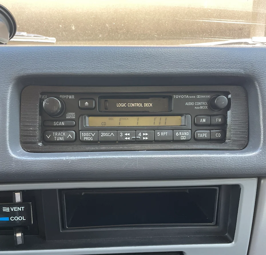

Decided to get rid of the horrible Kenwood radio that was in the 60 when I got it; just couldn't deal with the disco lights anymore and the bluetooth didn't work. Studied every possible option out there with a goal of making it look as "period correct" as possible. Strangely, because Toyota seems to be way behind the times in car audio design, the factory head unit in a 1985 FJ60 looks like it belongs in a car 20 years older! So, I decided to go with a 90s era factory Toyota head unit (part #86120-08010). The advantage to this unit is that it has a port for a CD player than can be used to integrate bluetooth. I used the GTA car kit for a bluetooth module; plugs straight into the CD port.
BEFORE:
AFTER:
