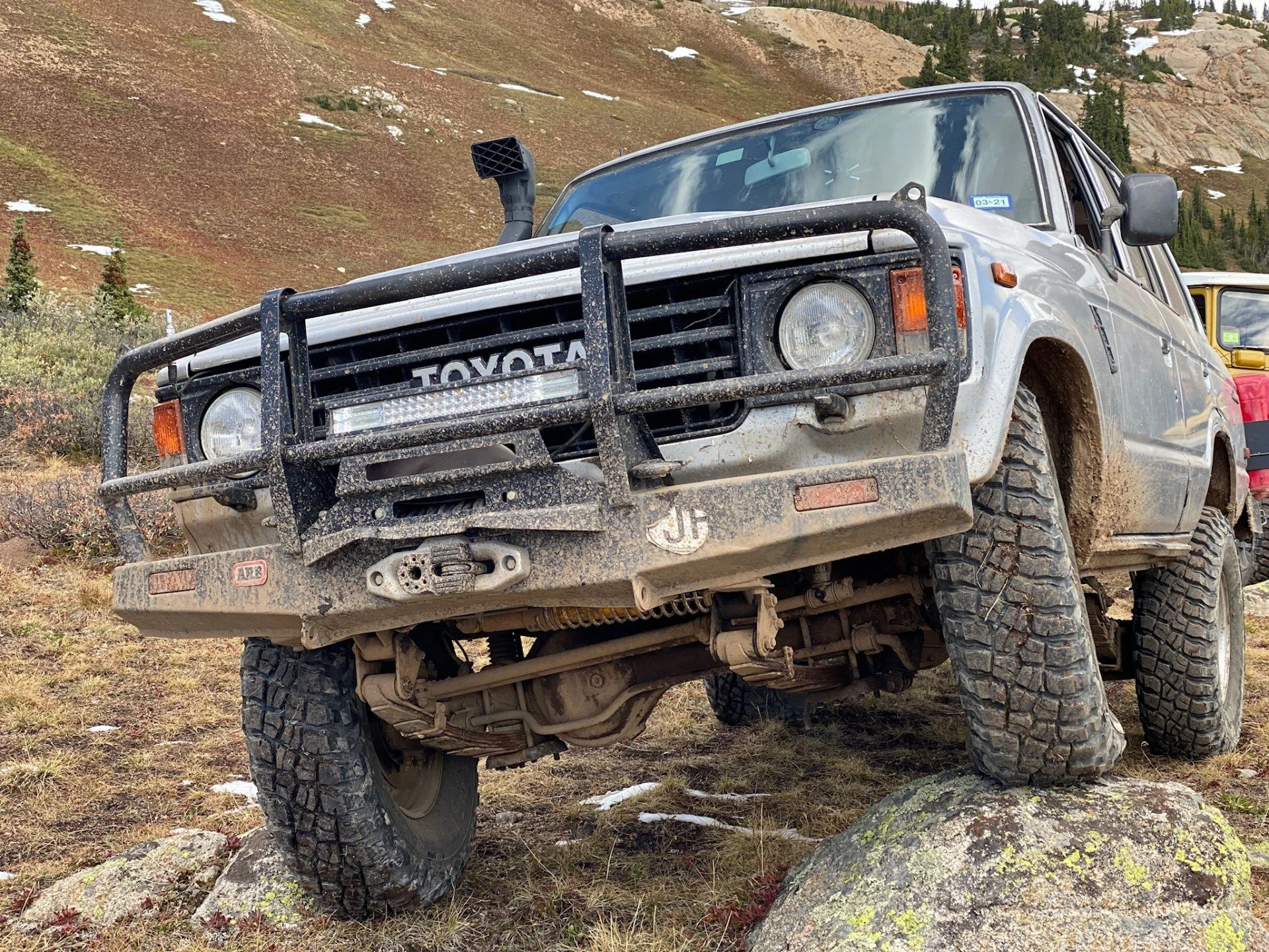

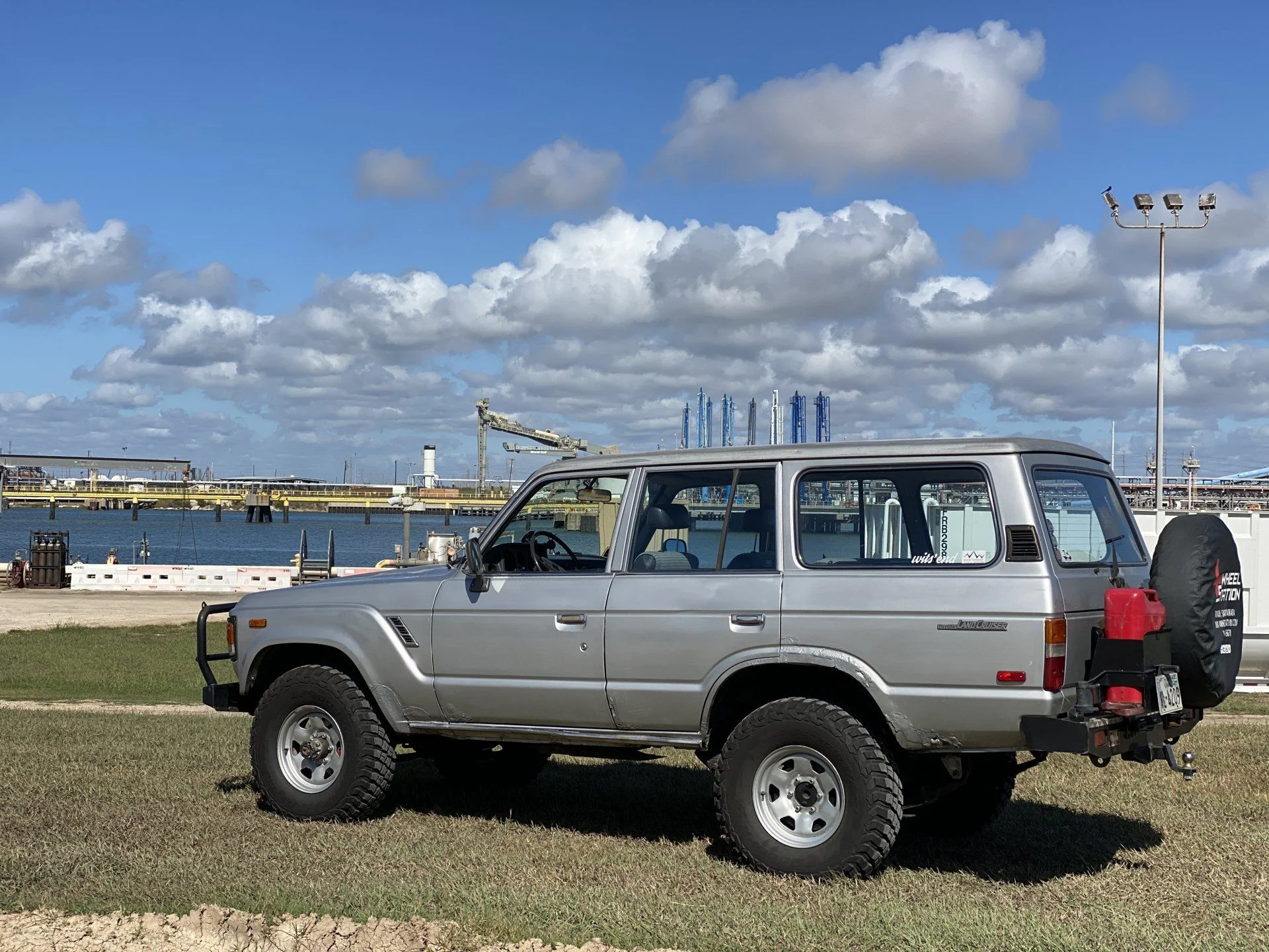

Taken by @reddog90
My favorite picture of the truck so far.
The love affair with this rust box is real.
Snake blinders begging for mercy.
Great shot.
I’d be fibbing if I didn’t admit that there may be a zip tie or two holding them on.

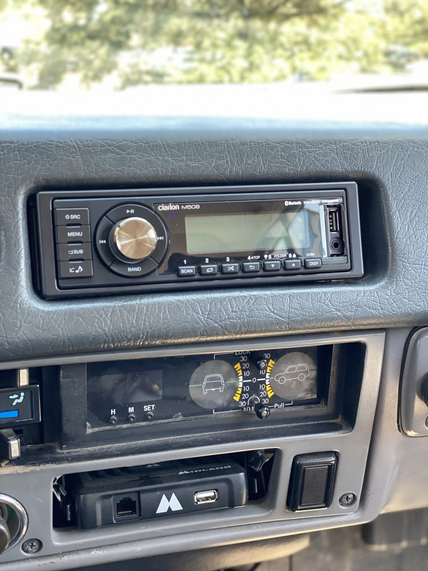

Not much to report. New head unit by clarion, m508. Great because it’s visible in daylight.
Added the midland gmrs in the ashtray spot. I’m really happy with that over CB.
Maybe a dumb question, but with the gmrs I assume the other parties involved would be required to have the same radio?
Just the same style, not the same model. We used 4 gmrs radios on this last Colorado trip and they worked amazing. We had miles of distance on the highway.

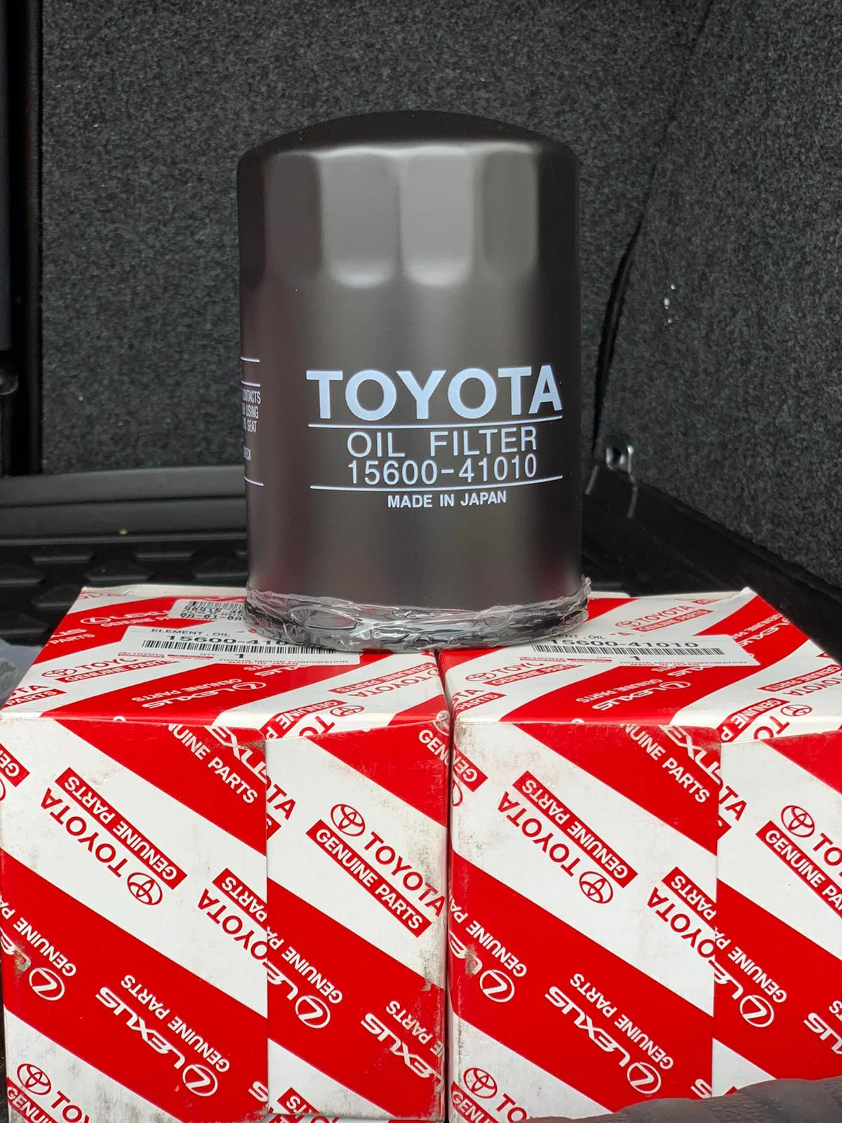

I need to do some maintenance:
Oem accessory drive belts
Oem fuel filter
M1 15w50 Oil change and 15600-41010 filter

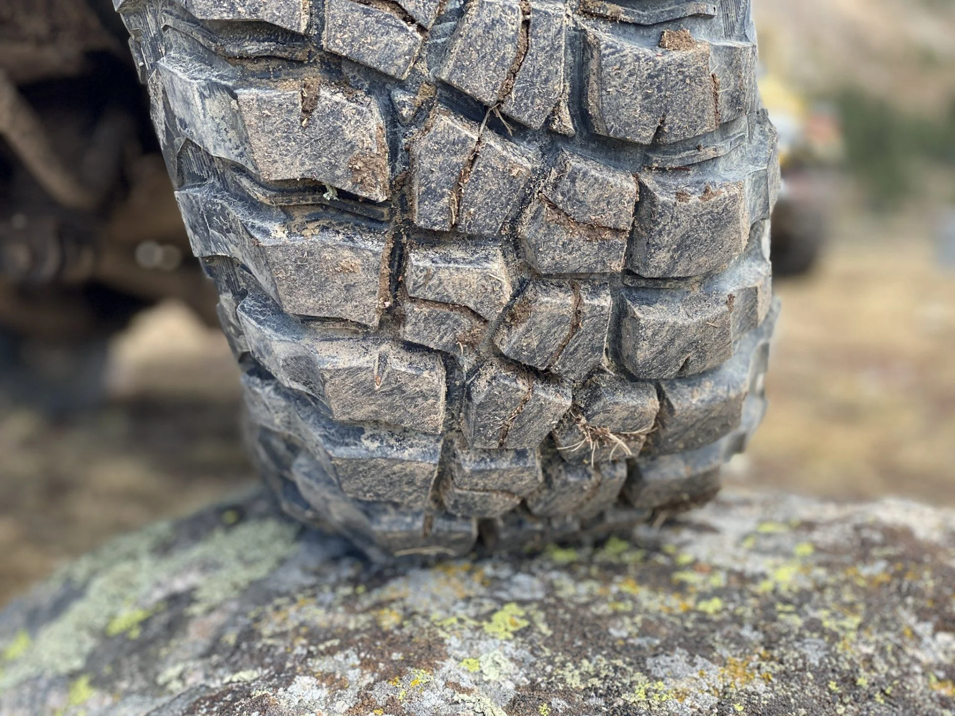

thanks! I love em. I’m really digging the narrow look and the e rated tires with 40 psi drive great! I knocked out 600 miles of round trips the other day and they were great on the highway. I’m already due for a rotation from early September install.

So your sig line says, '255/85R 15' But should be 16, yes? So essentially a 33" x 10" tire?
It’s a 16. I’ve been living a lie!
It measures to 32.8” x 9.8ish”
