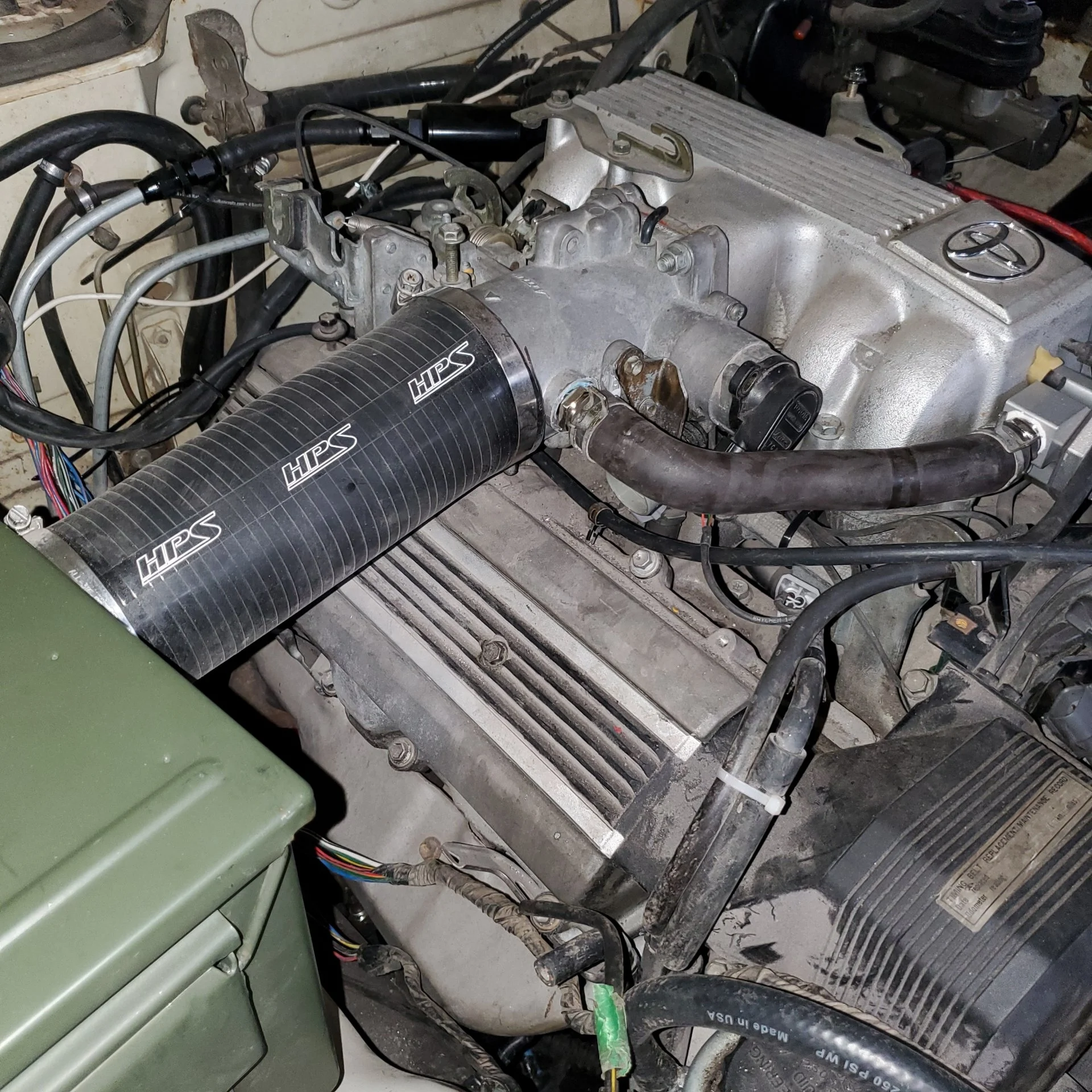

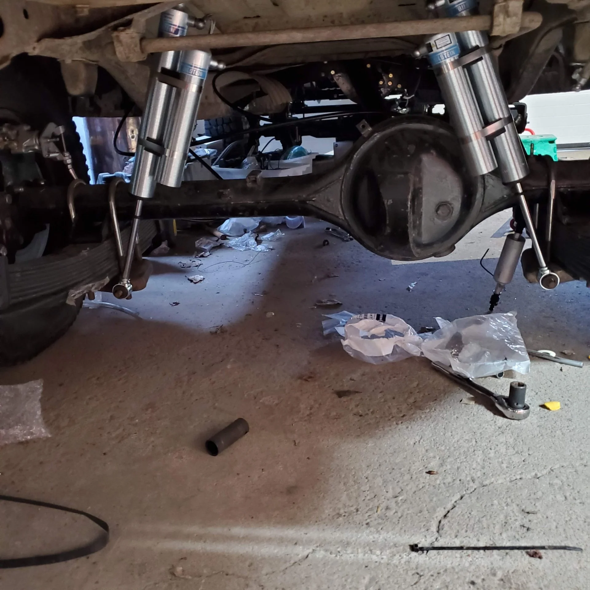

For fun, here is a pic of the shocks that finally arrived, also got brake lines in, the fuel delivery finally sorted (except I still need to do pedal to throttle body - anyone have pics of a cabled system?), rebuilt the intake to accept a new temp sensor and idle control and a host of small annoying little things. Nice thing about the aftermarket ecu is that I don't need a MAF as the ones on the 1UZ are fairly restrictive - it relies on a wide spectrum CAM sensor mid-way through the exhaust.

I did have a rant earlier about Bilstein having utterly useless technical support on these:bang:, but bought them anyway based on the advice of the 4wheel parts guy (who i know knows his sh#t), so with that disclaimer, they are 5165 series, BIL 25-187724 front and BIL 25-187717.
