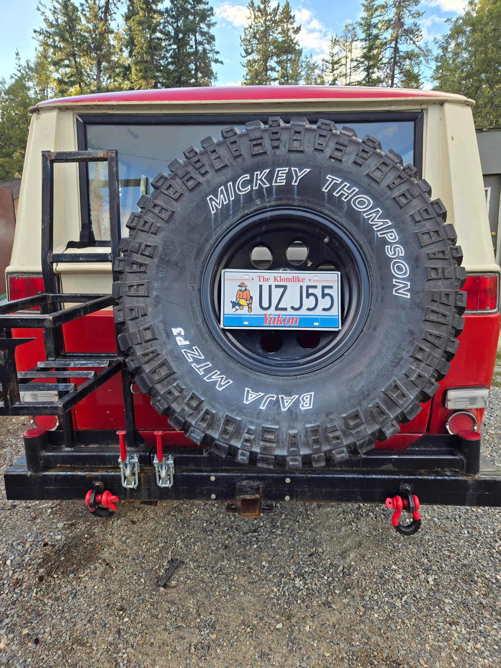

What a boring picture right? But wait, there is significance here. That is my pig, in a downtown parking lot. Pushed by my soon to be daughter-in-law borrowing my truck for a 10 day trip I finally did the last few things to put her on the road and drove her to work today... six plus years after starting on the project.
I am still not happy with the brakes - considering all disc and the 80 series booster, they should be better notwithstanding the 35s - I am going to try a wilwood brake proportioning valve next - and I have a bunch of wiring to tidy up and, and , and - but it is now drivable. After a bit more snow comes off the mountains I will give her an off road shakedown, but for now: Pig, in a parking lot :)
