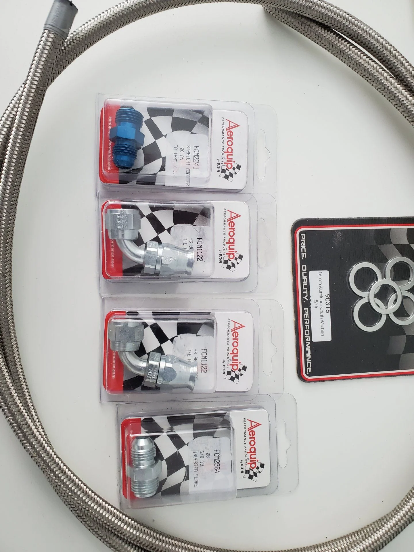

That's the approach I took. Rather than trying to figure out what end (Metric,SAE, etc...) goes on the custom hose, I found it easier to buy fittings to convert at the pump or gearbox to -AN fittings. Then it's always easy in the future to just work with -AN hoses.
Yup, got the parts last week (grabbed the AL fitting because they didn't have steel, but a steel one is in the mail - psi it's rated high enough for the 1250psi rack and pinion pump mounted on the engine and scout box, but I don't want to chance it and barf fluid in a remote area)

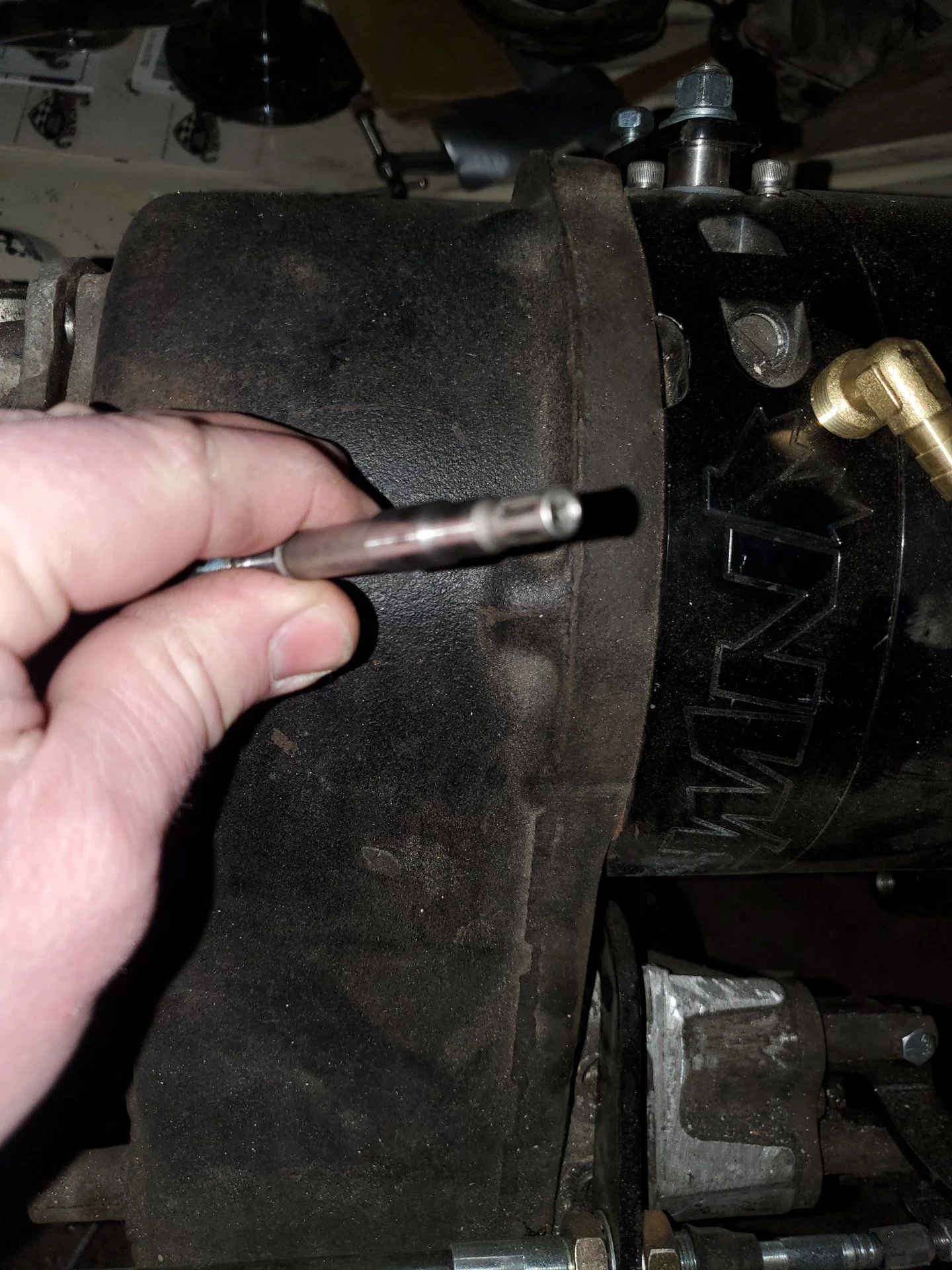

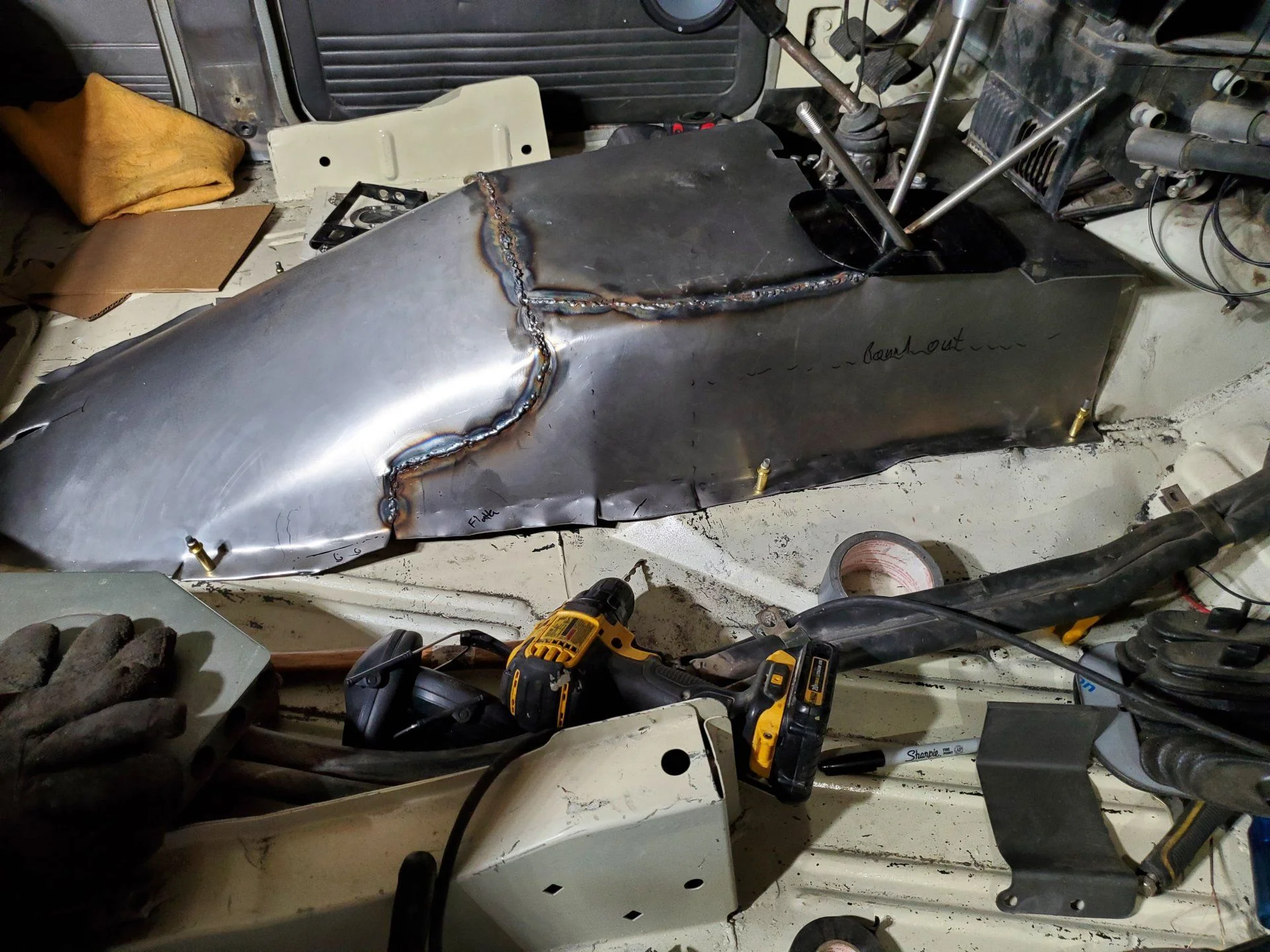

So I am at the point of completing the transmission tunnel and I have to marry a jeep part and the pig - I know sacrilege, so from here on we will just call it the t case.
The t-case has a speedo output gear with 4 dimples and is about 4mm ID, the pigs cable is 4.7mm and has a single notch. I am debating reaming the t-case gear so it is even all the way around and then carefully grinding back the pigs cable to fit - possibly filing a notch in the t-case gear to take the cable notch so it doesn't slip. I am hopeful there is enough material on the cable to accommodate. Both the cable and the gear are available if I royally screw it up. The threads on the housing actually match perfectly which is why I am thinking I should try this.
I'd rather not go electric because I like the idea of keep the original gauge working. So before I dive in, any other creative thoughts?
