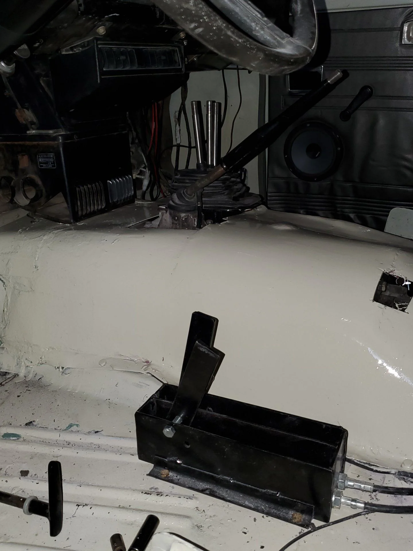

Cables for lockers, twin sticks and doubler routed and connected - if in trouble, pull everything
- used Polaris cables for the lockers, not super beefy, but only thing I could find that was long enough
60 series emergency brake pull installed and MC4 brakes now fully functional
XL transmission tunnel in (hours and hours on this), just clears the bench seat and front fan, while being tall enough for the dana300, rear fan relocating to passenger side.

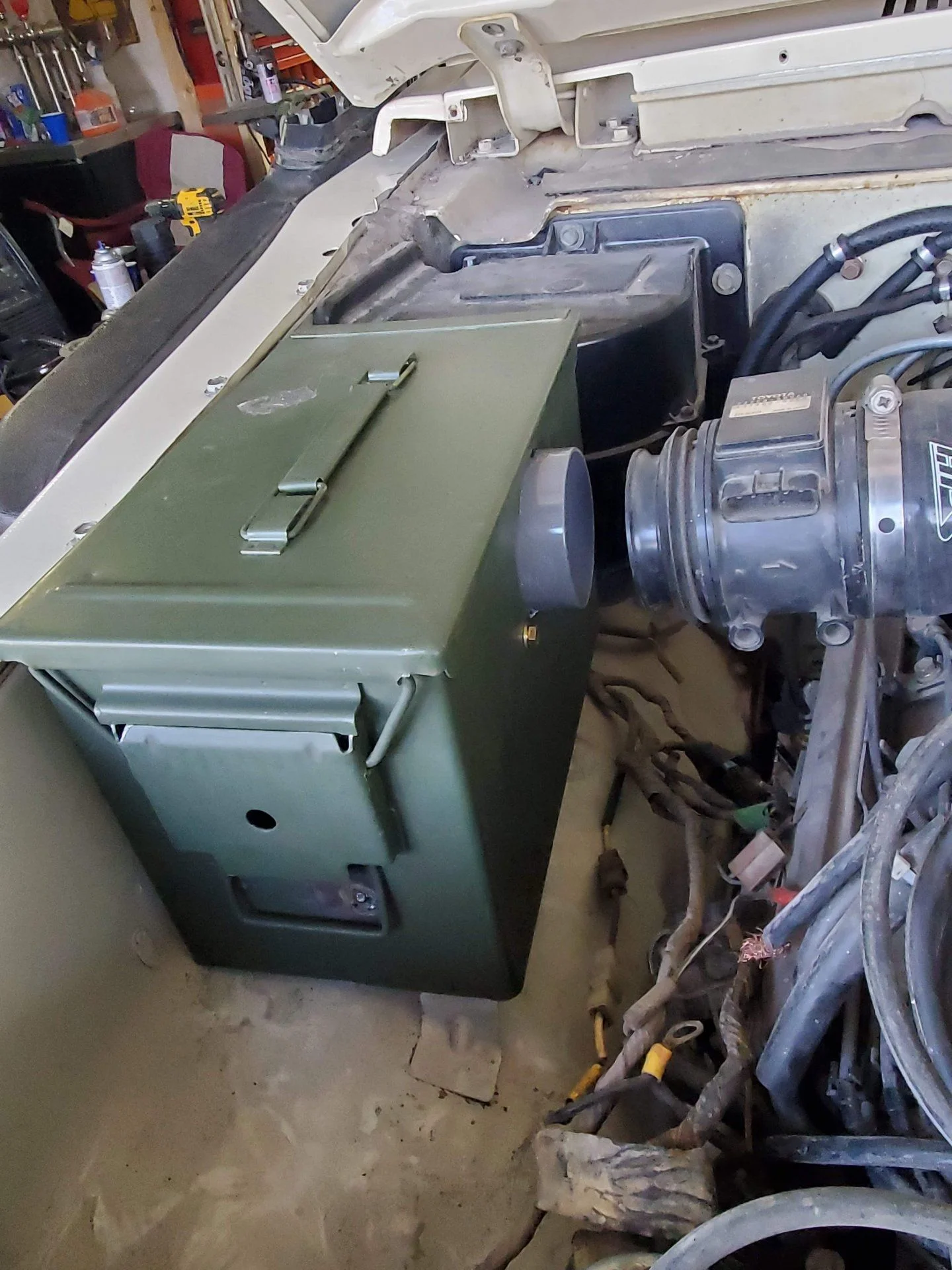

Air - tried to make this van air box work, but I think while I can jam it in there and plumb it, I will be better to get a big flat filter and build a custom box

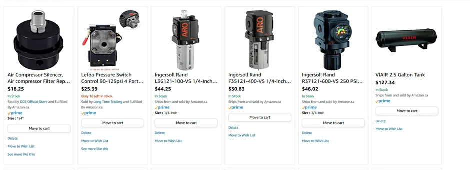

What OBA setup are you thinking of going with? How about ...
Everything I have read everywhere on OBA suggests installing a York compressor, mainly because they are tough, have internal oiling and have great CFM. I am not doing that.. I have no need for AC and have no cabin plumbing for it anyway, but have the AC compressor sitting there - so I am going to use that.
The problem with stock AC units is that they use gas that has a lubricant in it within a closed system, if you are pumping air out, you loose and lubricant and if you just pre-oil, you oil the insides of your tires. So you need both a pre-oiler, a filter and a pressure switch. For added fun, I am also going to follow what a guy on pirate did and connect the oil dump from the filter to the fill on the oiler - flip valve, refill as needed.
Something like this shopping list (the VIAIR Tank should fit between the rail and the rocker on the PS side - prices CAD):
Plus a couple of fittings from AP Air Inc (451-1112, 451-1113) to route the Compressor output up instead of right into the power steering.
By the way, my $200 Smittybilt 12v compressor has been just great to date easily do 2-3 sets of 35s without overheating, but its not as cool as OBA :)

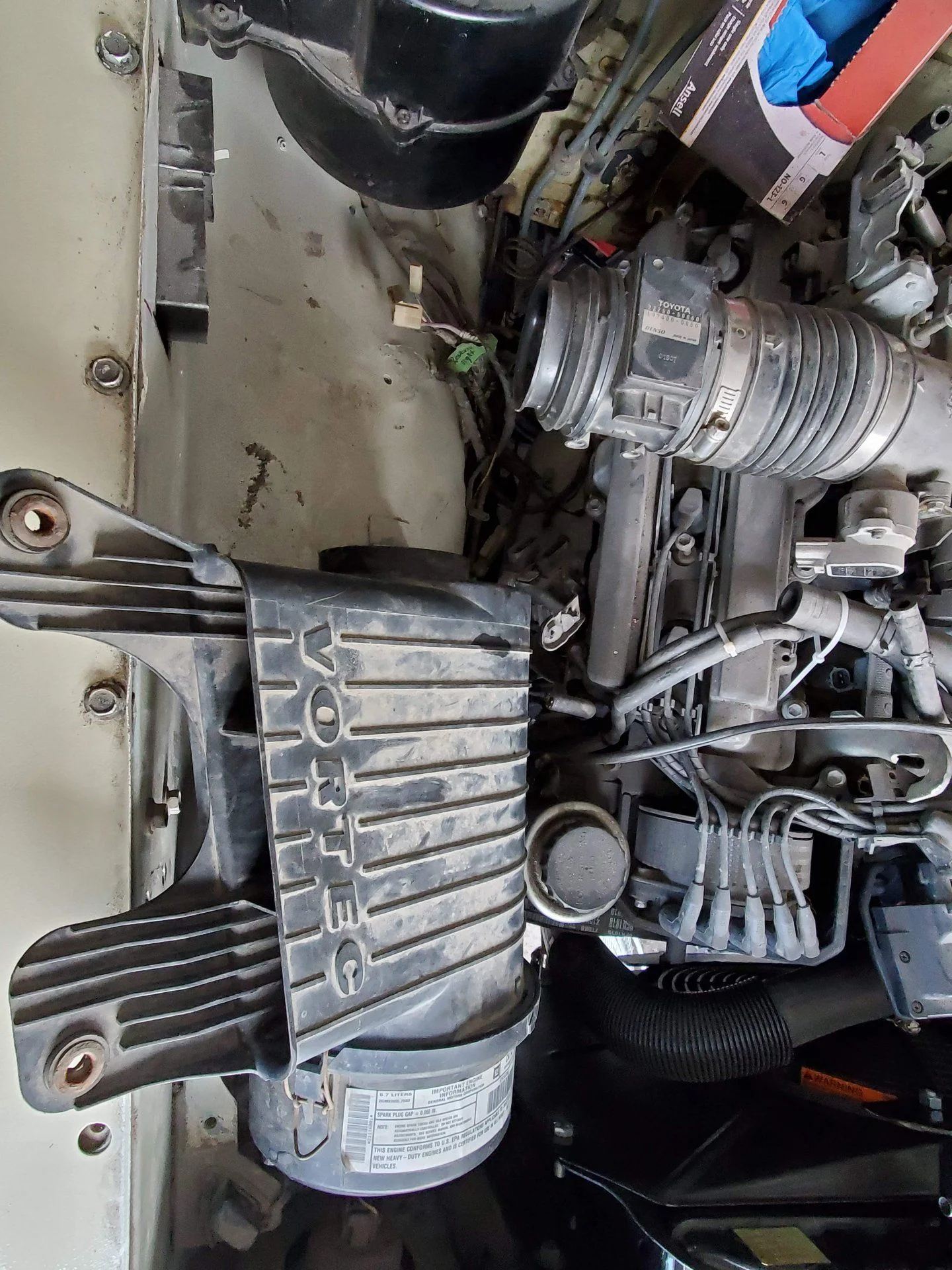

Solution for the air filter (just need a 3" coupler and a bit of butyl around the snorkle intake and between the box and the fender to avoid a rust rub to complete). Started with an old ammo box we had, went to K&N and searched by size filter, then got one suited to a V8 (a Dodge Charger in this case) and presto:

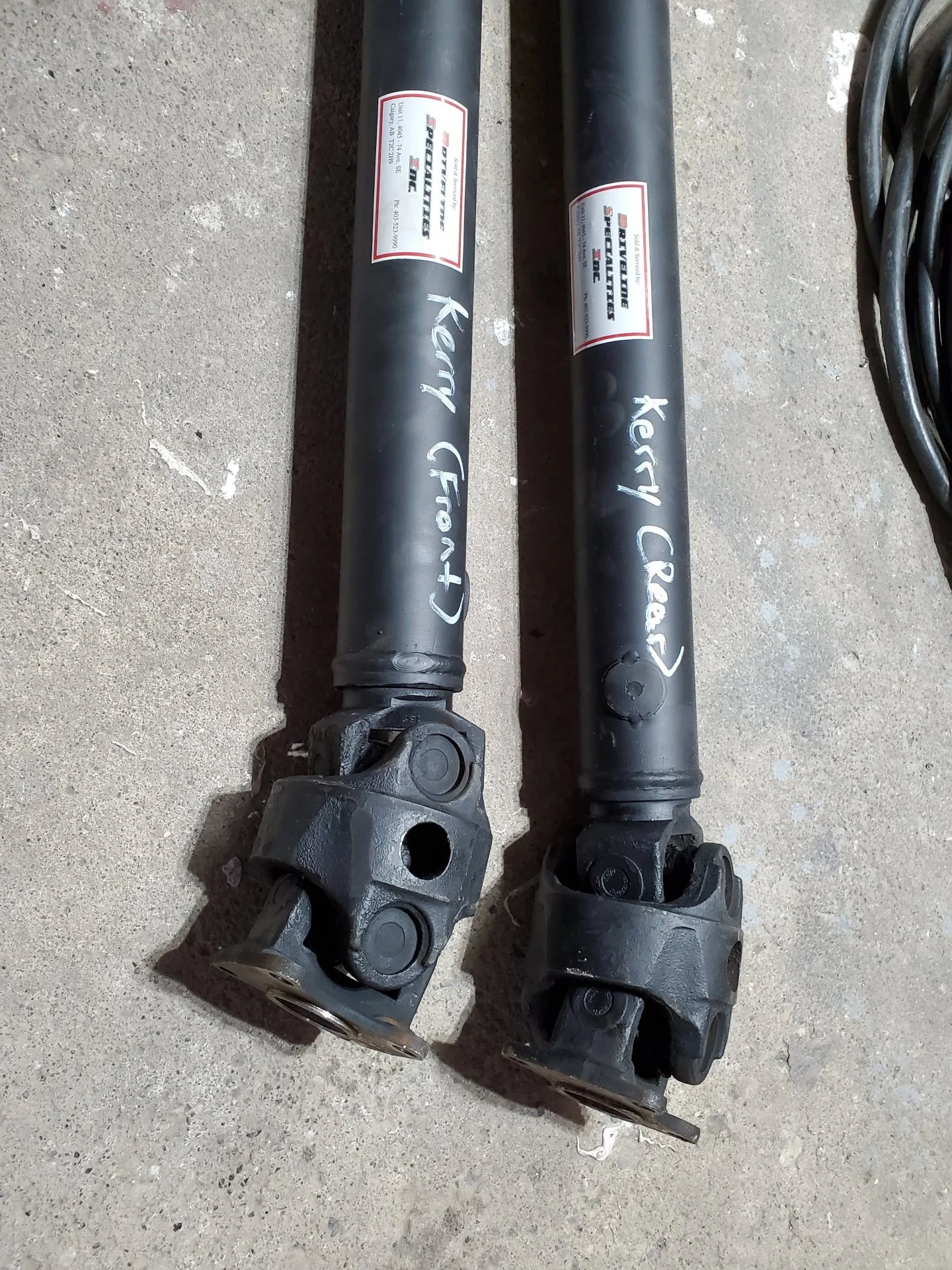

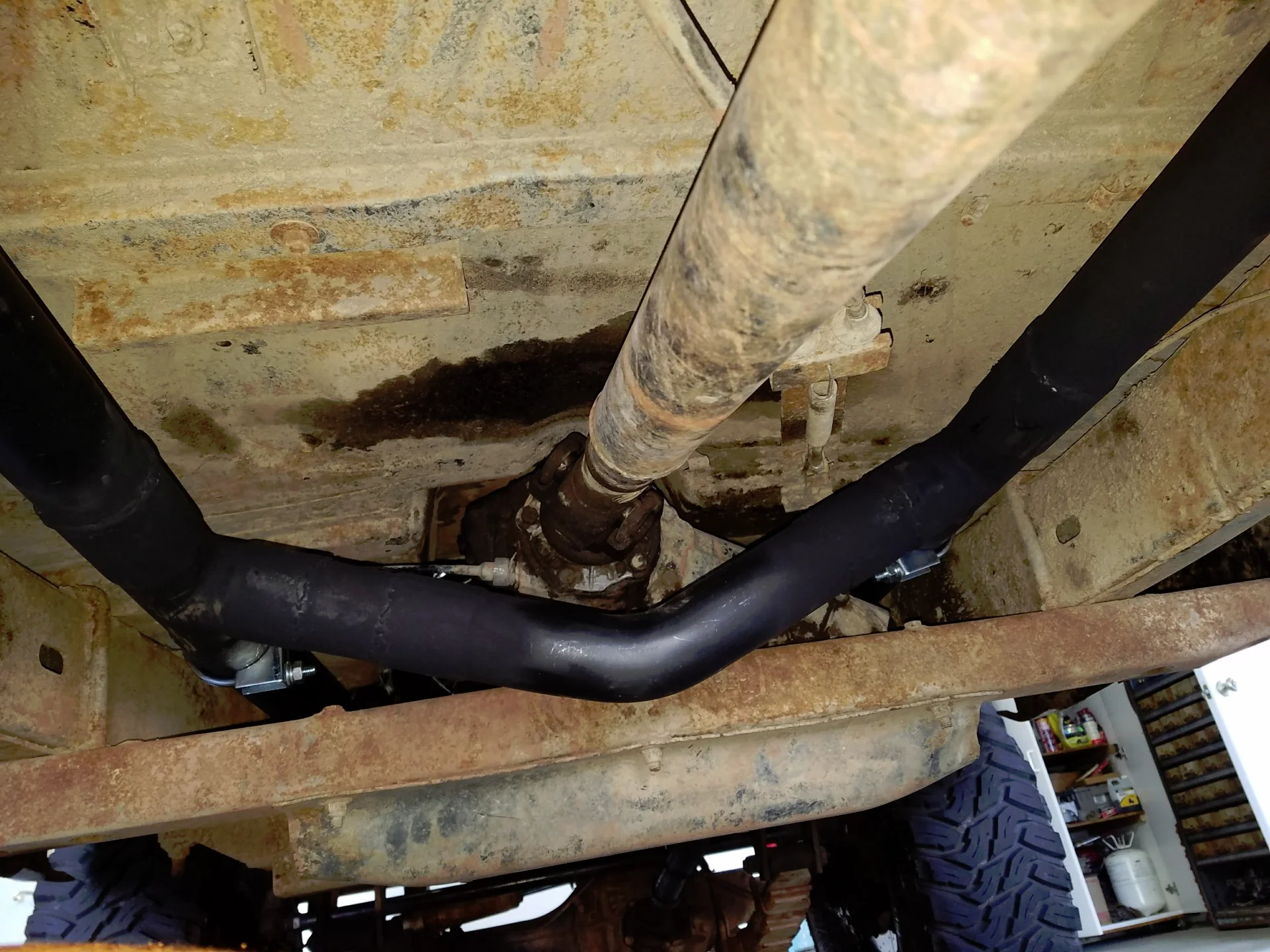

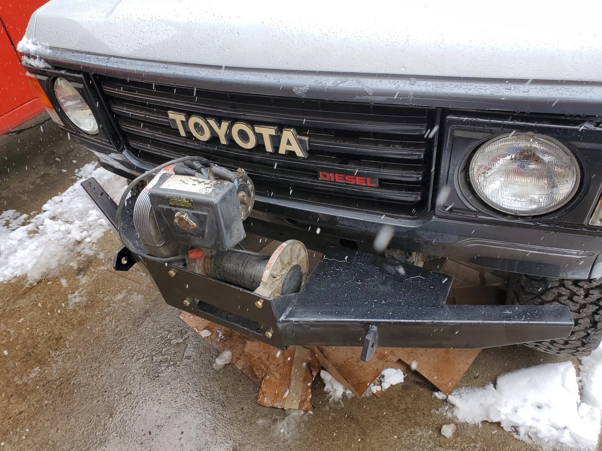

Not much done this past weekend, eldest came home with a request for a new front bumper, so that knocked out a couple of days. Managed to collect the pig on Friday with the new driveshafts though - hefty CVs, probably going to have to go back and modify the tunnel... again. Can't take it in for the exhaust as planned until the shocks come in, was transporting on a tow dolly and it was whipping pretty severely on the way home, so that has to wait a few weeks. Probably work on fuel next. In other news, the saga of the electrical harness continues, apparently there was a challenge with the idle control on the Spitronics ecu my guy was working on, so its been upgraded to a Link Monsoon - hopefully that will be in the mail this week.
