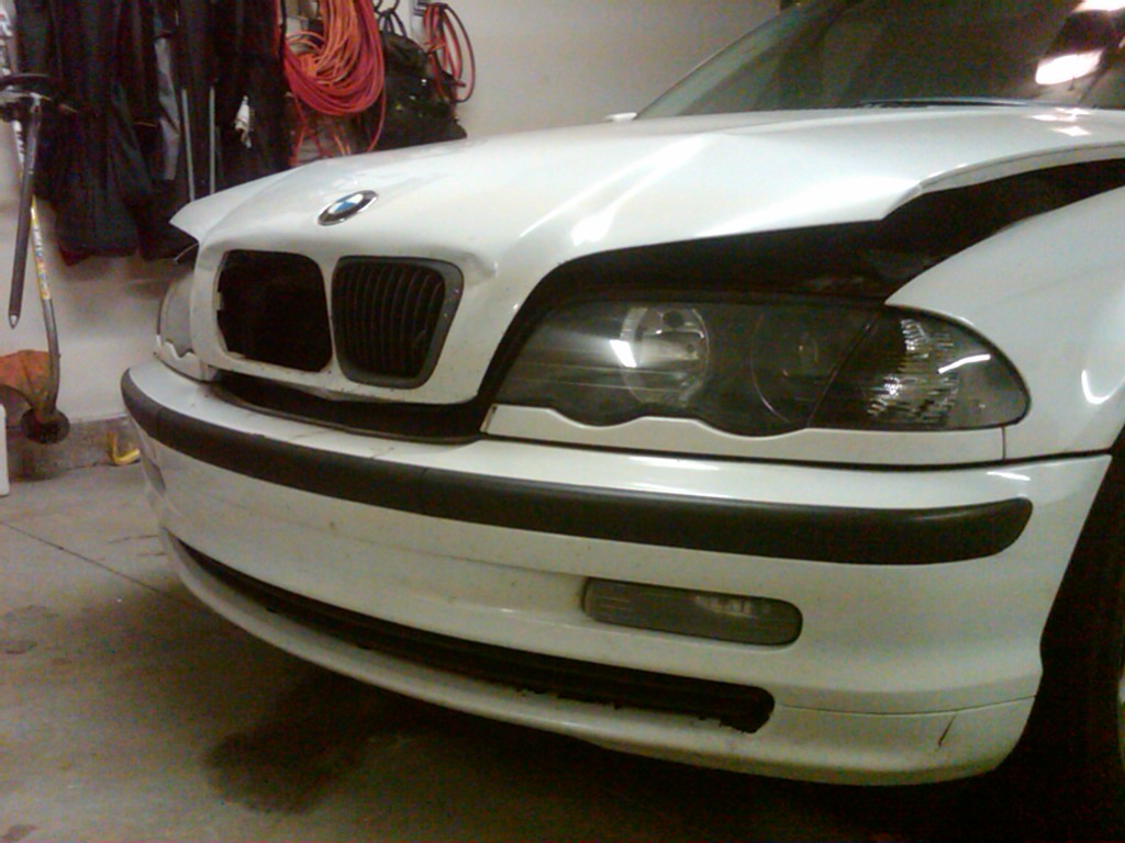

Small fender benders usually are worse than they first appear.
True story... my old roommate backed into my car one night, and this was the damage. We were thinking it would be around $1k to fix. Nope, $3300.
