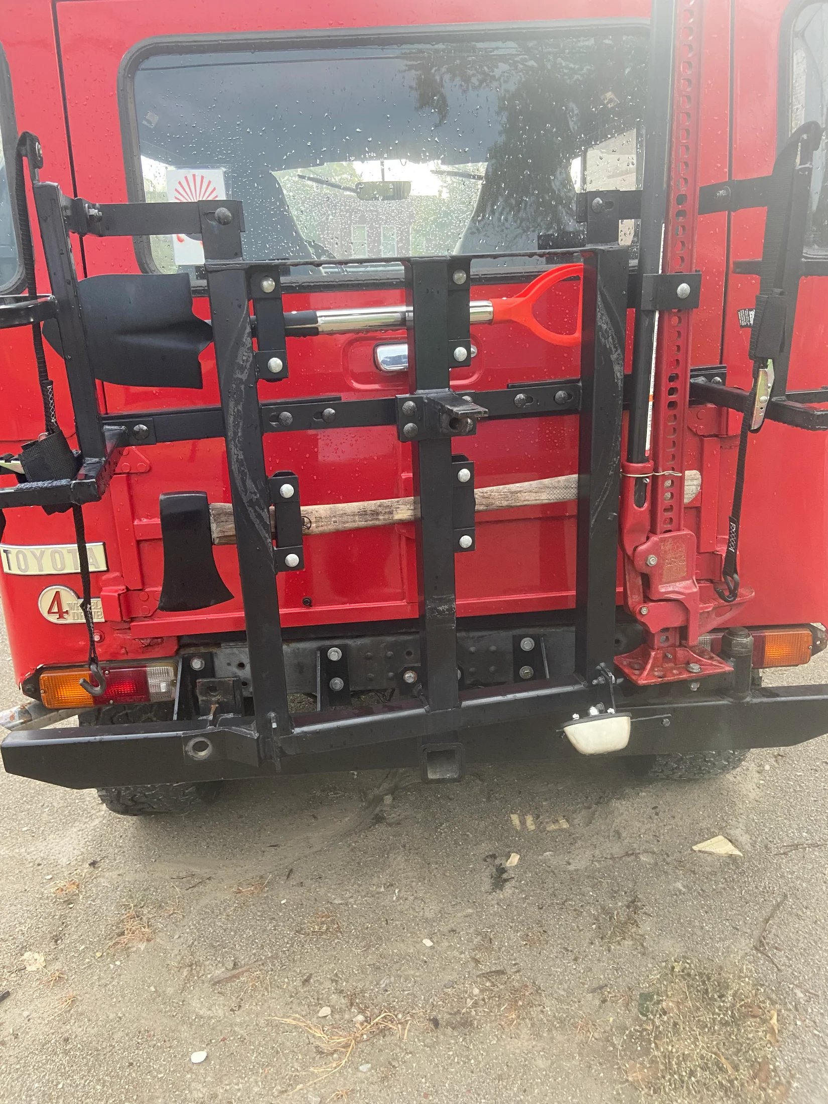

its on the right side. Here are a couple of pics.

I'm glad I asked. That's quite a contraption. Where do you want the license plate to be? Where's the spare tire go? I can't tell if it's a drop down tailgate or barn doors or....
Barn doors.

Your wires would have originally been on the drivers side with the spare on the passenger side. I would check on that side. If you plan to have it near the driver side you can use the wires from that side. If not, I would make sure the PO properly terminated the wires. I agree with Mattresking, it’s best to get confortable reading the factory schematic, there’s no better resource. Also make sure it has a good ground.
first-what yr is the truck?--then get a factory wire diagram for that year--the pics show doors that are not stock, no plate mounting holes, so where ever it was originally, it's not there now(unless the framework is covering the view). The wiring will need to be routed prob from under the frame somewhere-depending on yr, might be rh or lh--my guess is LH-this truck appears to be earlier than a '75('toyota' and "4 wheel Drive' badges are on the left(and the wipers are on the top)-maybe '71-72? that little black hole under the ax support may have been the exit point for the wiring
Thanks for the info. Its a 1974. And I have the wiring schemetics I found for the year. Youre prob right about the exit point under the ax
