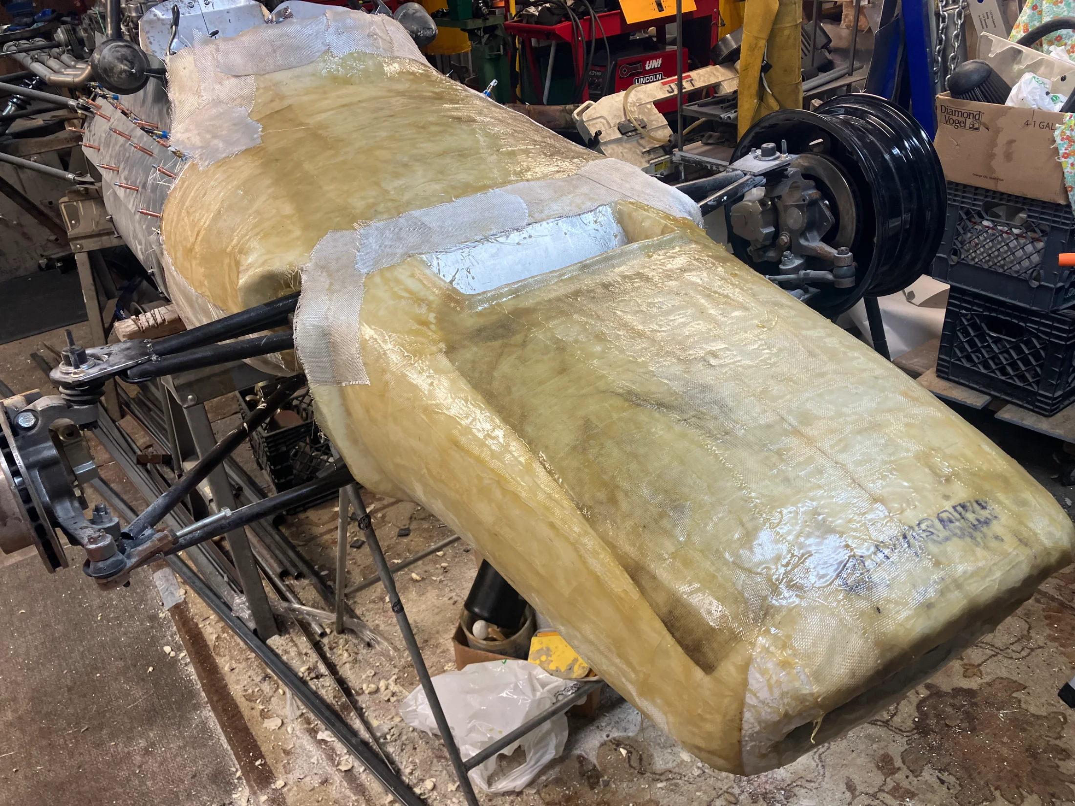

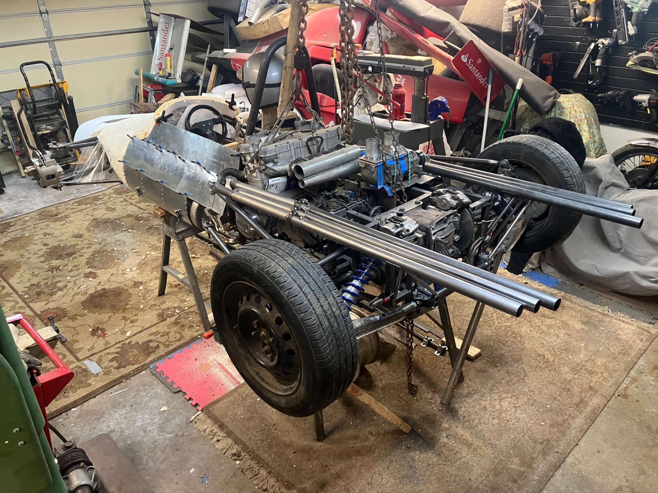

I don't know what I'm looking at, but I love that flat six exhaust shooting out the back
It’s a little open wheel car I am building to resemble an early to mid 60s Grand Prix car. The six flat pipes pay homage to a French GP car from the era called a Matra, they had a V12. The Matra sounds unbelievable, hoping mine sound similar.
Mine is a Kawasaki, in-line six from the 80s, a super charged it as well, with a small Eaton M45 off of a Mercedes SLK.
