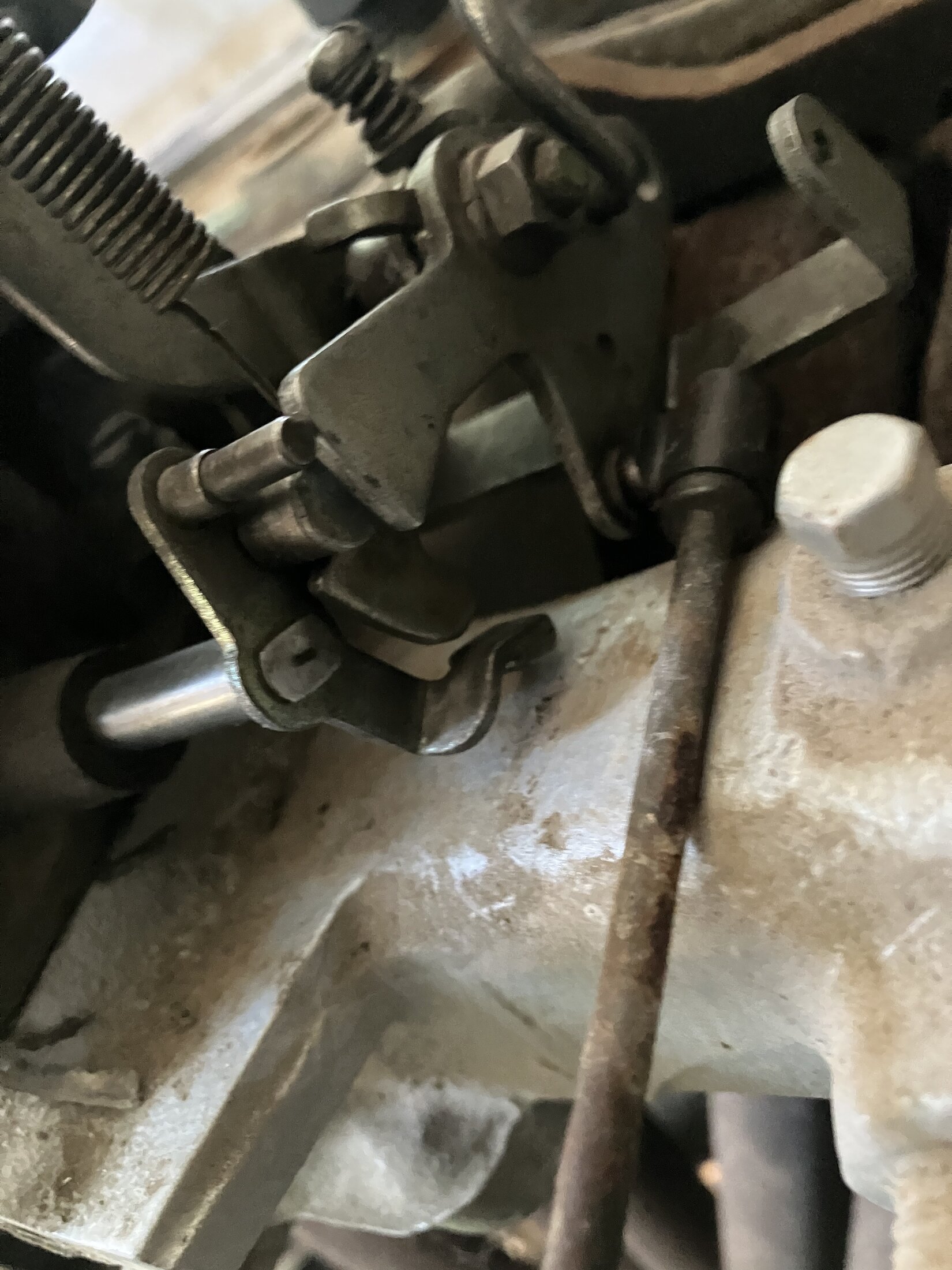

1. Why does the secondary linkage hit my intake manifold? (See pic) The engine is a ‘75 2F, the carb is a ‘77, should work fine. The carb spacer is in the correct position from diagrams I’ve seen. What gives?

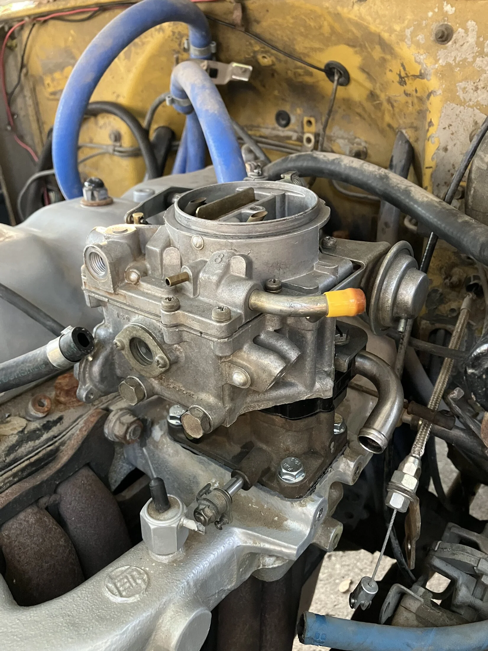

2. I’ve never got the Holley to run well in all these years, so I purchased the OEM Aisin and did a rebuild with Keyster parts. I know my way around carburetors but I’ve read that the 77 to 79 is notoriously difficult to tune. Great.

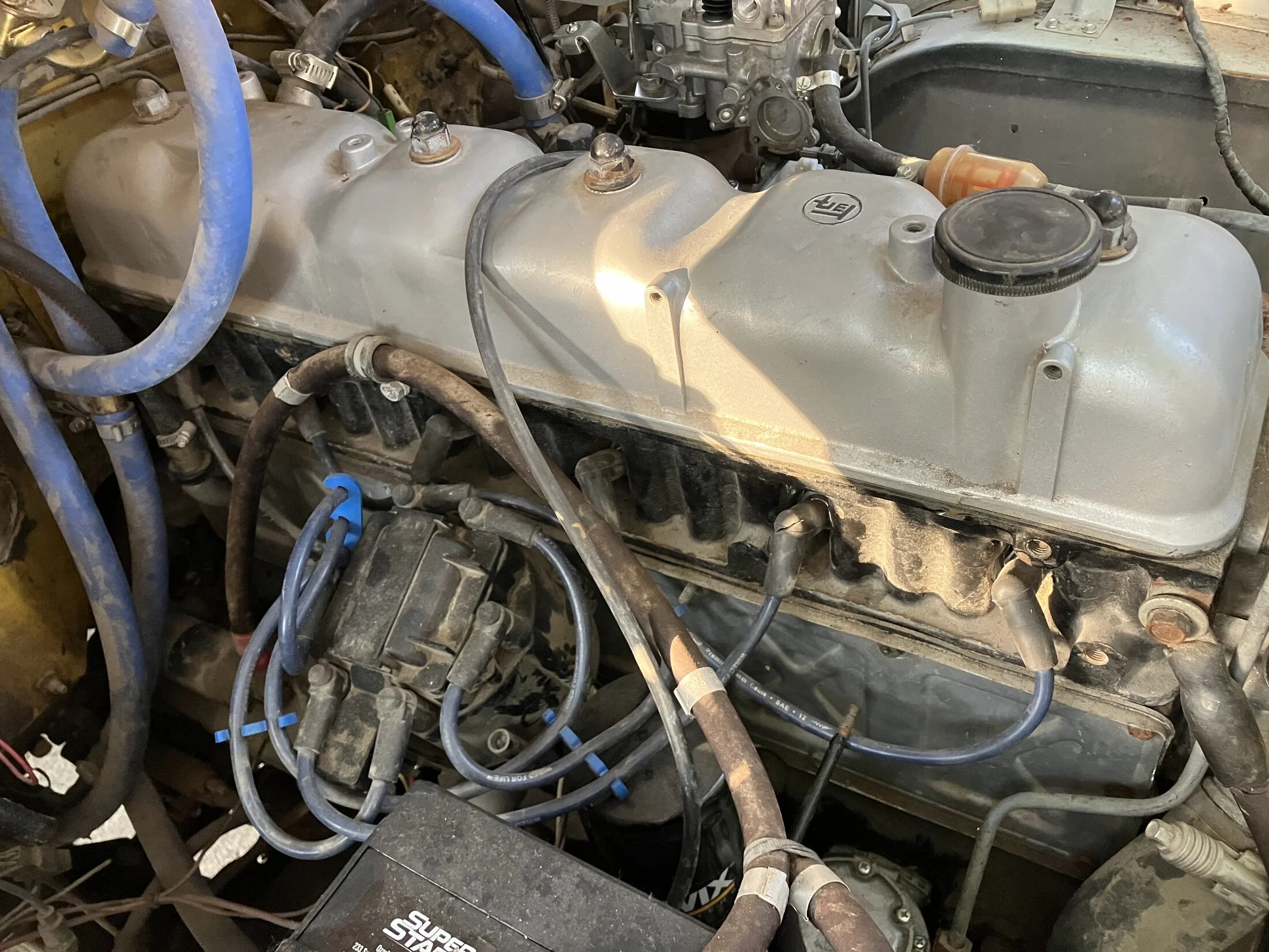

3. My cheap HEI distributor wobbles. I’m guessing the shaft wasn’t machined perfectly round. The bottom of the shaft seats perfectly in the oil pump but I still don’t trust the set up. I’ve read that I need to put a 60 series distributor on it. People want $400 for a used one on eBay so if I’m going to put the time into tracking one down for a reasonable price I want to know it’s the best one for my setup. Otherwise, what other HEI set up will work with my OEM 77 carb?

From the looks of it your missing the heat shield with spacer piece under the carb. then you will get your clearance issue resolved.
Looks like you are using an early style intake manifold. Im sure someone will chime in if I am wrong.
have you tried a different HEI distributor?
Get rid of the gm dissy.
Throw a city racer new oe dissy and pertronix at it.

I will look into the heat shield clearance issue, I figured it was some type of spacer that I was missing.
So an HEI will work with the factory carb? It would be nice to go Toyota, but at this point I don’t care. I’ll just buy a decent quality HEI conversion unit.
The oem electronic distributor on my 79 had a wobble too. Took me a while to figure it out. But once I did, I located a FJ60 ignition setup (big cap distributor, igniter and dimpled pushrod cover) from members here.
The upgrade made a huge difference in my case. Those big caps have a solid reputation for dependability, and that water resistantant cap is nice too.

Have several of the new OEM points distributors in stock here. They're about $300 and would be a drop-in for your 75, we also have new proper OE coil/ballast resistor setups in stock as well
If the distributor is loose that is will definitely screw things up.
Several other easy issues in your pics.
1. Missing carb spacer (have new in stock along with proper OE studs/nuts)
2. Fuel filter between pump and carb (this line should be metal all the way to carburetor. We make stainless steel replacement line for this
