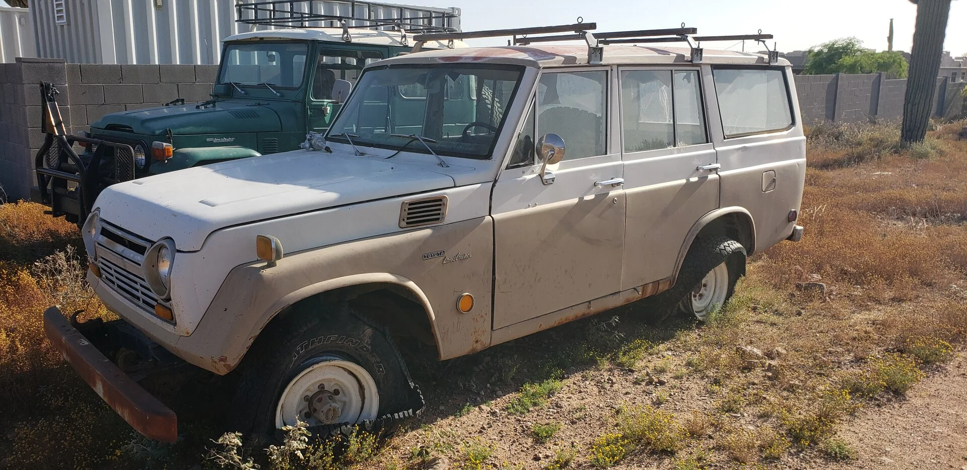

I acquired this 55 via 2-way swap deal and ended up with a decent 55. Never owned one, didn't need it, kinda dig it.
I'm going back on what's been done and how it all started.
When I got it:
Spent a bunch of time and much anxiety cleaning this thing out. Between the several dead rodent carcasses, poo, ya know. Bad.

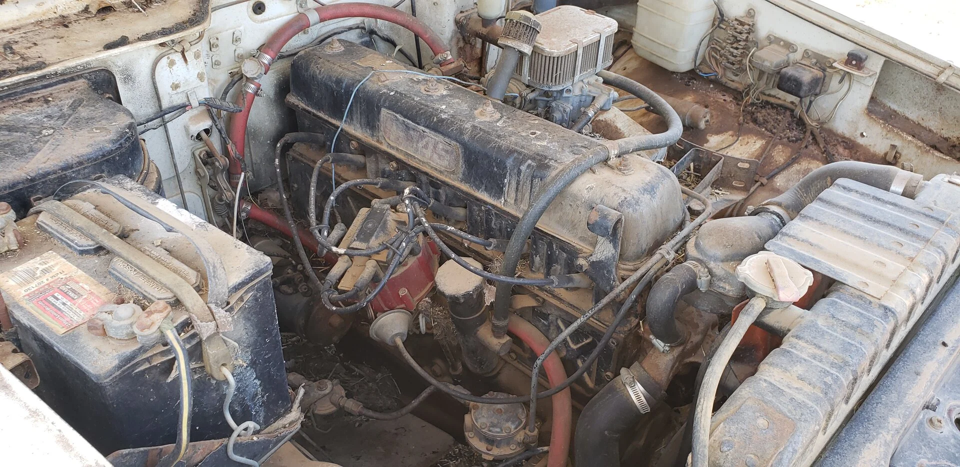

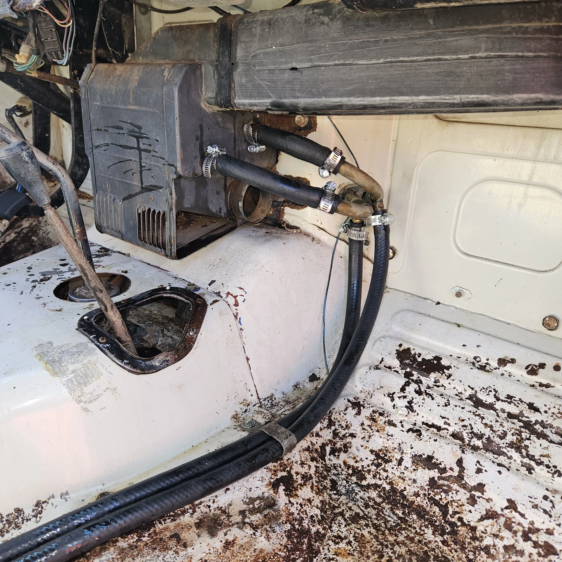

I've completely revived the cooling system (new hoses, new housings, thermostat, belt, water pump... all new heater hoses. Rebuilt the rear heater.
All the gauges and senders now work. The horn and the dome light and most of the outside lights.

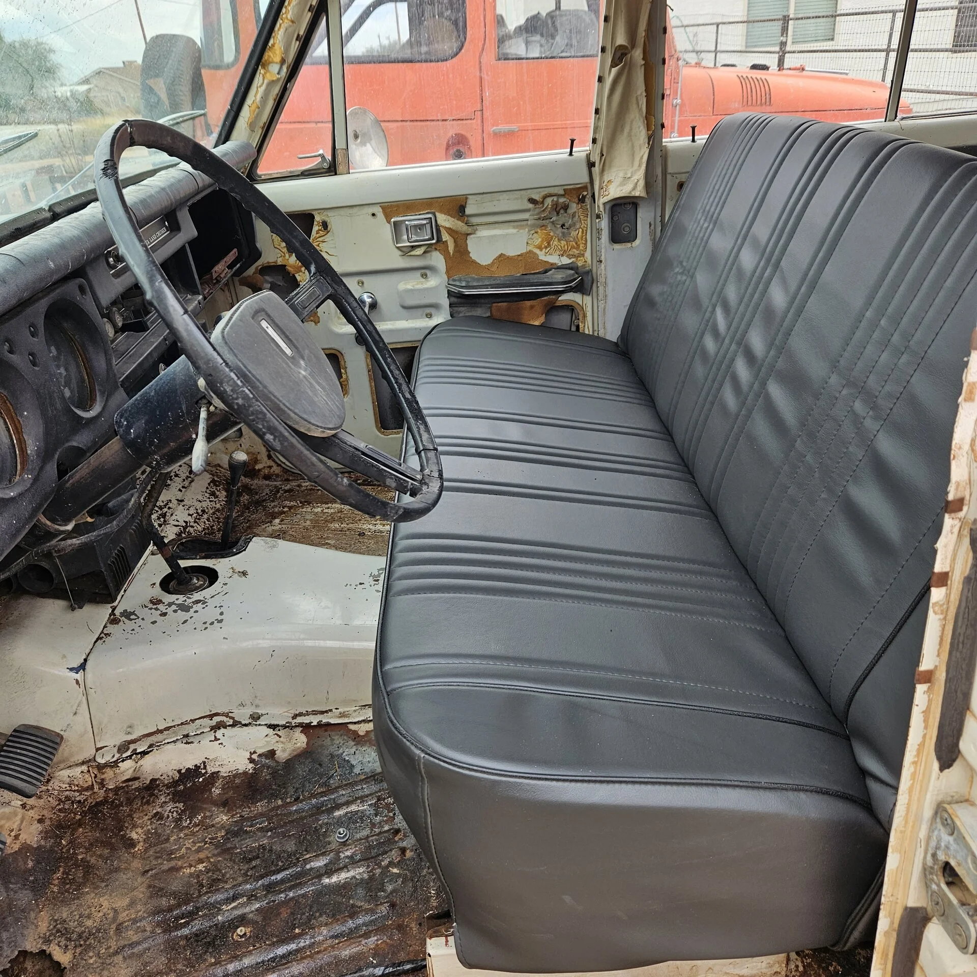

Redid the front seat.

The interior looks slightly better now
Yeah, I'd said that is slightly better. :) Looks like someone converted it to a floor shift.
Not sure. The shift diagram on the glovebox door looks like a floor shift

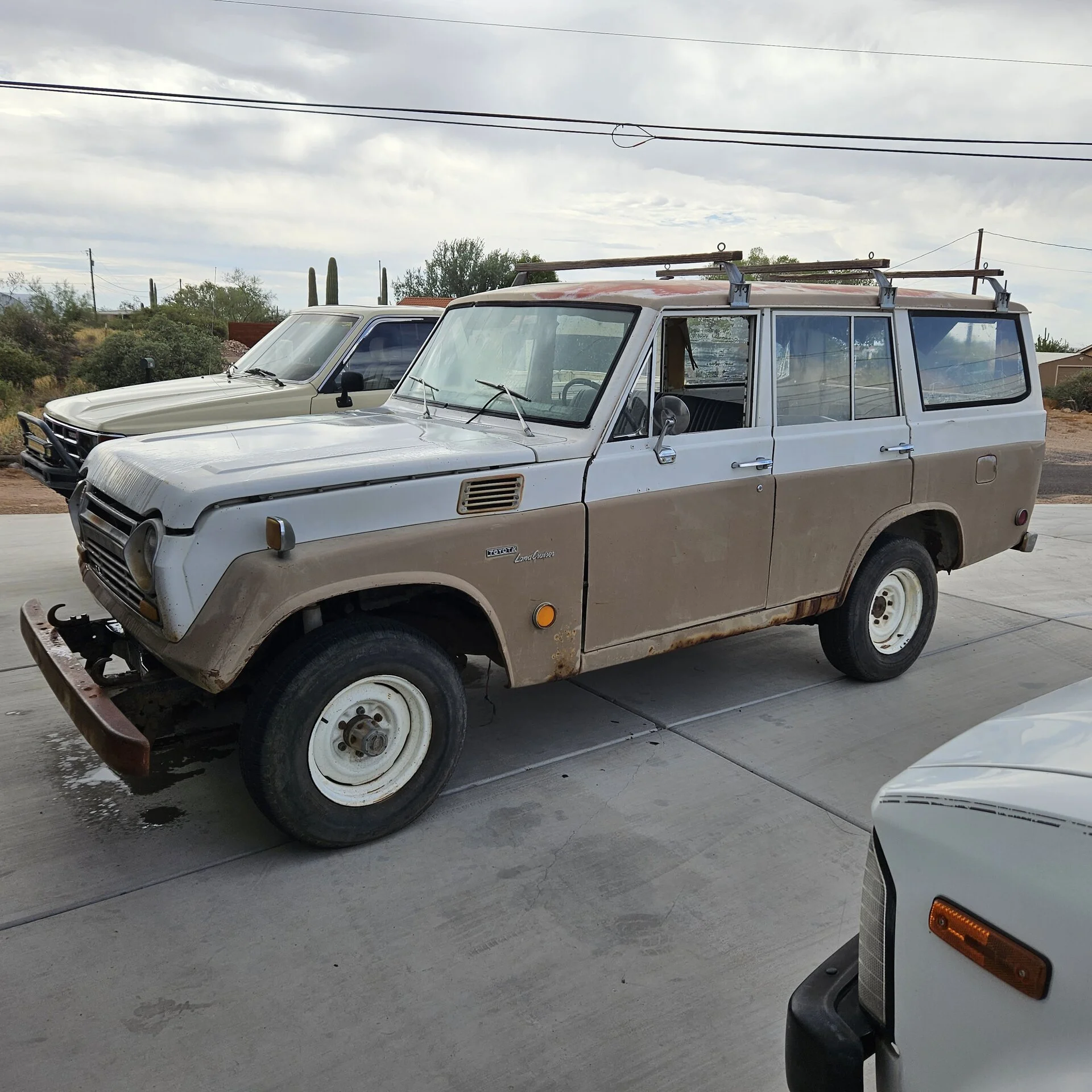

How it looks now on the outside. Yeah, it's got some rust. :frown:
But it runs and drives, the brakes work, the coolant system works, the gauges work, the headlights and wipers are horn, too!

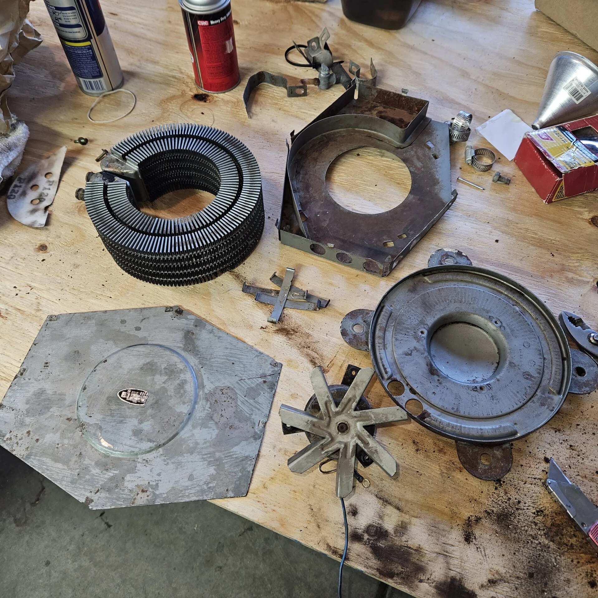

During all this, I refurbed/cleaned the rear heater. All new hoses and clamps, too.
