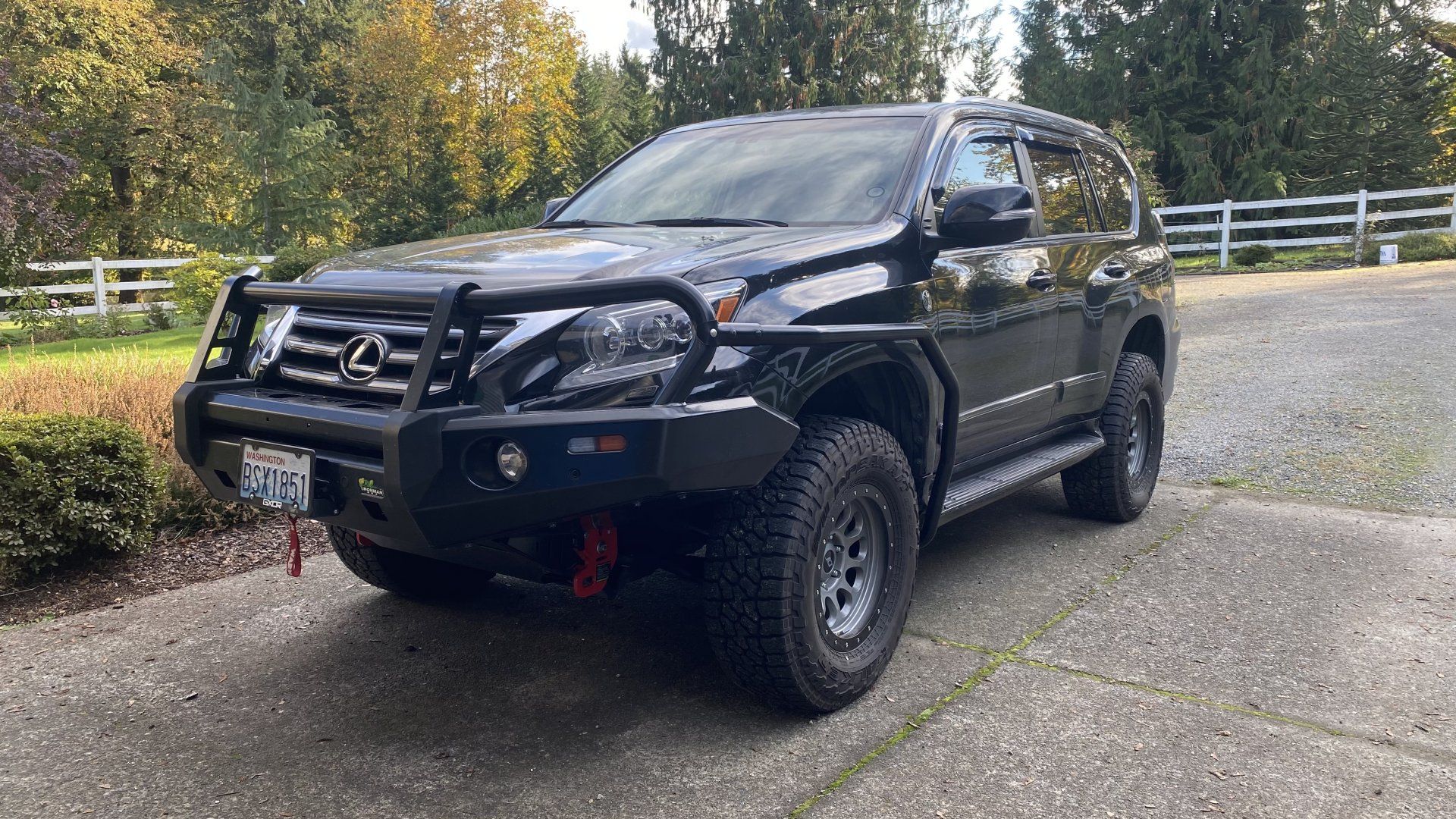

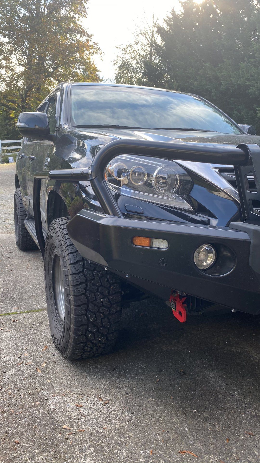

There is slight rubbing from the tires at full lock. I’m going to see if I can get an alignment again with max caster. My last alignment was done at a Meineke so yeah... hopefully it clears it.
In the mean time I wanted to keep my side steps because I don’t have sliders picked out yet. So I pulled off the slides just like you would if putting sliders on. I trimmed the step metal core about 5-6 inches off the front. This would also give some from for the bottom of the side rail. I believe the step trim on a Prado is shorter. The side rail still was coming in contact with the side step so I cut the front portion off. Either way I would of cut them up for sliders anyhow so no big deal.
I've always liked the front quarter fender guards!
Thank you. So do I. I wish it was a little more level however I totally get it that it wasn’t meant to fit but it fits well enough so I’m happy.
There's always the hillbilly way... pound to fit, paint to finish! Just get a big'ol sldege hammer and make it happen! o_O

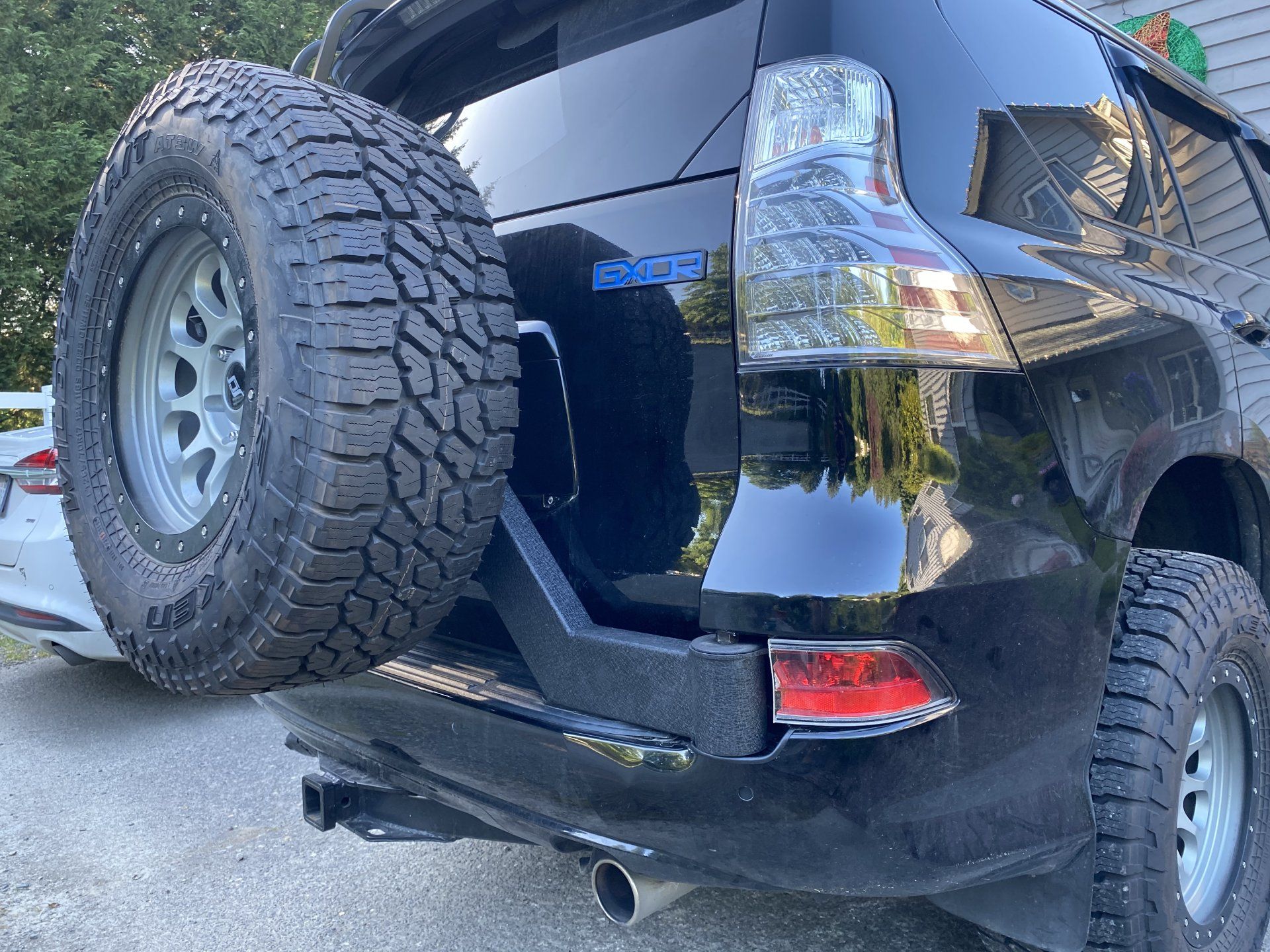

Just an update on the carrier. I added another set of bolt, bushing, washer and nut to get a another contact point for the hatch bracket. Now the carrier is extremely stable and almost zero wiggle up and done on the tire. I’ve also blacked out the chrome trim with black vinyls. Bonus was having a little extra time and I was able to take the band saw to the old reflector light to fill in the hole. It may not be the prettiest but it works for now
Super disappointed. I loved how this turned out and had planed to do this rear tire carrier on our GX but Rugged Ridge has discontinued the tire swing out and I cant find anyone that still has one in stock. The GX is my wifes daily driver and she says she does not want to open a separate swing out before openign the tailgate. This leaves the JW which is not my favorite......
the expedition one bumper has a swingout with attachment arm to the door so it moves along with it when you open it. Price is way more than the JW of course
Yeah spending $2500 to carry a spare tire isnt really in the plans currently.
Yeah I know... I'm going to limit myself to 32s so I can use the factory spare location. At least for now...

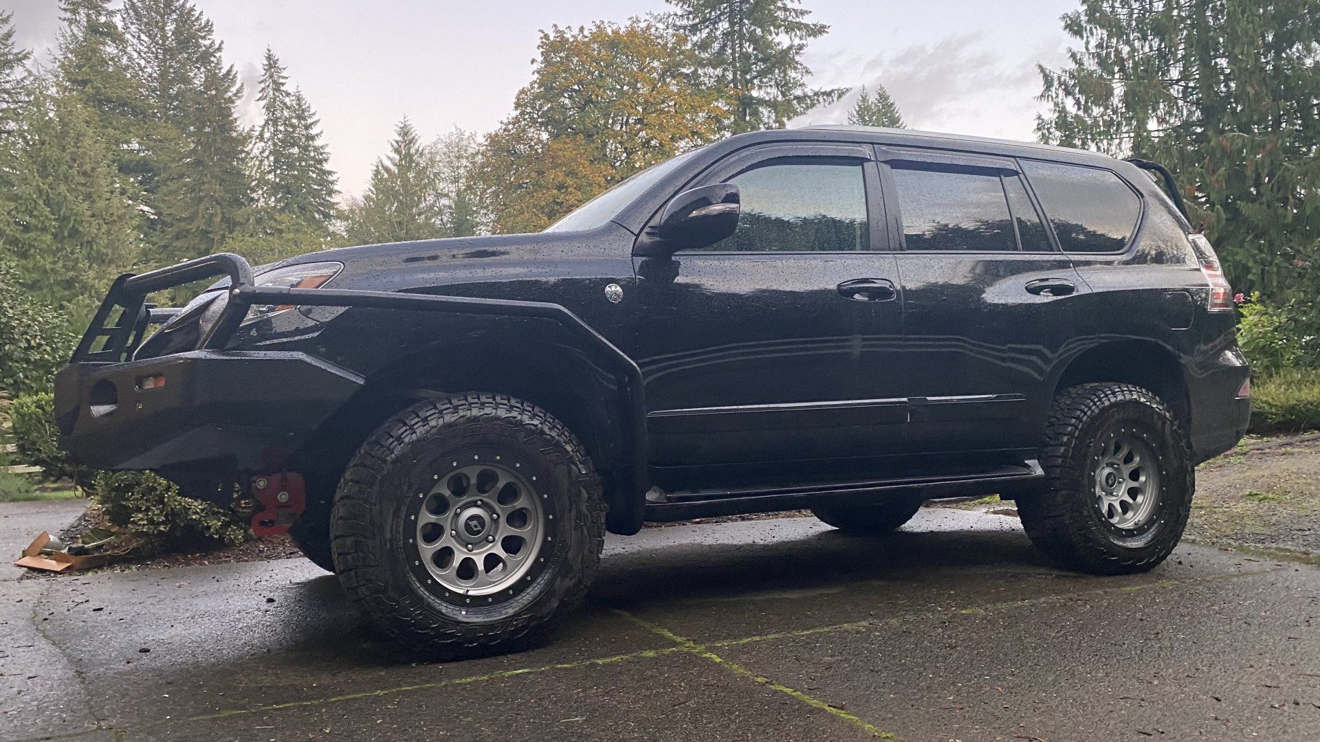

This is why I initially chose 265/70/17’s. Now that I’ve had some driving time with them I’ll keep this size, I like the way they perform so far.
I'm either doing that size or sticking with the factory 18" wheels, haven't decided yet. All else being equal I'd just as soon have 17s.
Beautiful build!!!
1. Those 33s look much larger on your GX. It has me considering 33s again over 34s. Nice wheel choice too.
2. How much overall lift did you gain with the added weight of the bumper and tire carrier? Any idea?
3. That tire carrier! Wow. Best looking option I’ve seen by far. Nicely done and way to dive into a big (and I’m sure scary at first) project.
