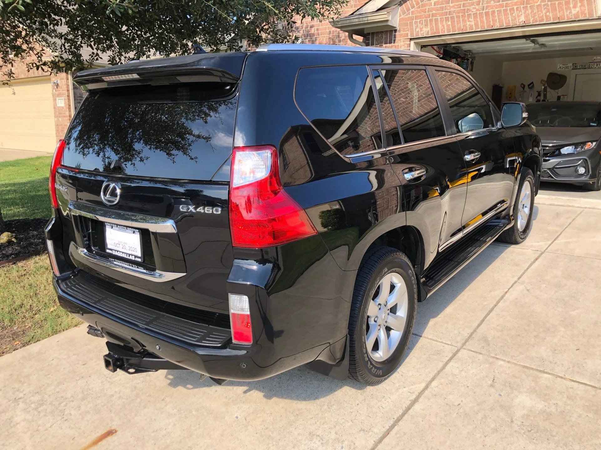

Here she is on Day 1 all nice and clean...

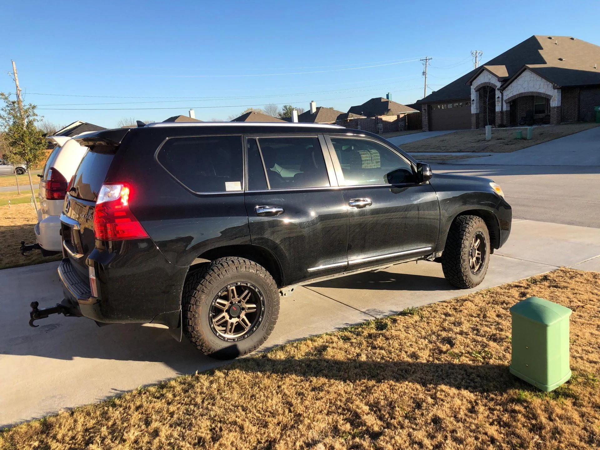

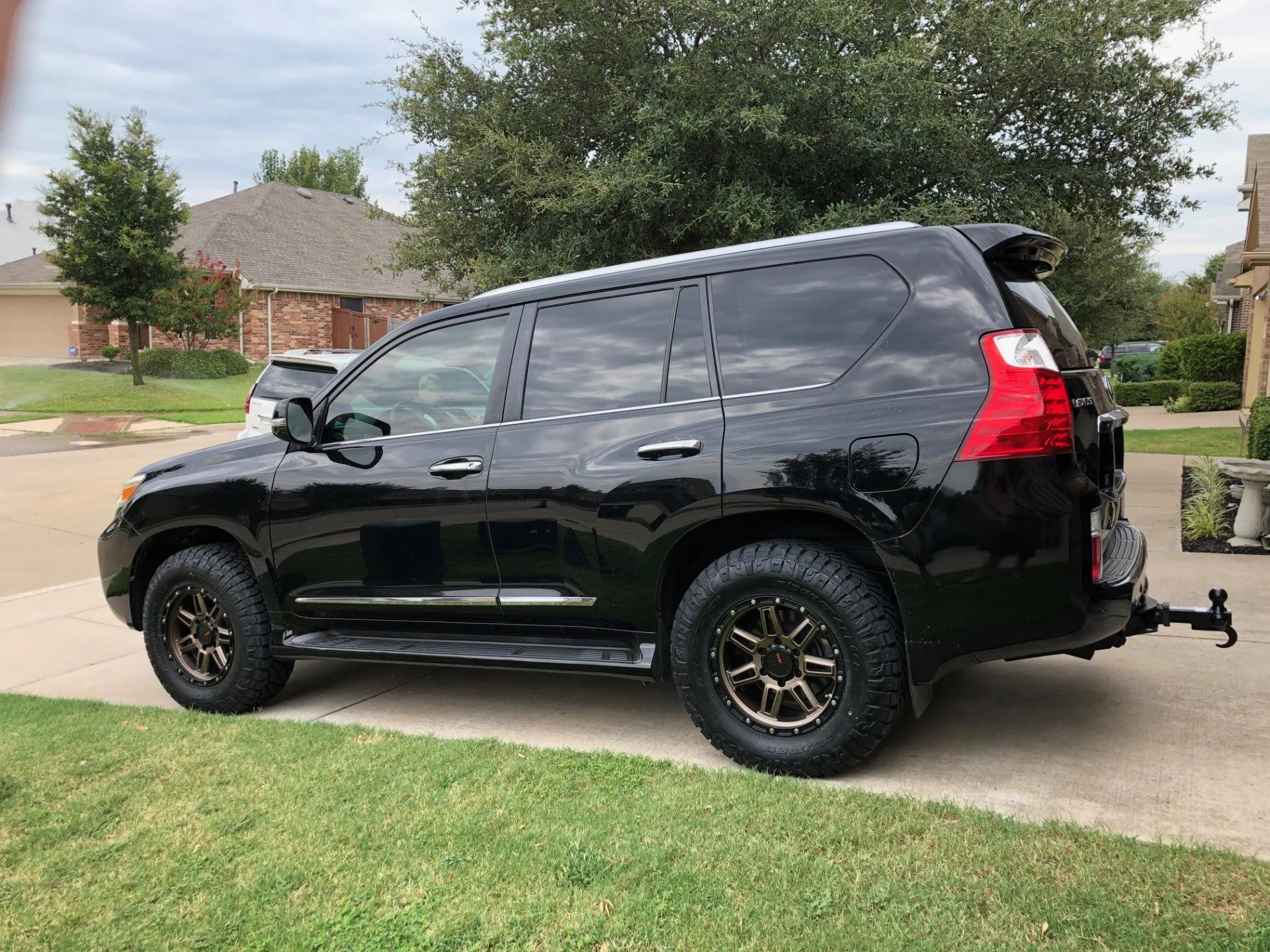

The first series of mods were pretty straight forward. Starting with naturally wheels and tires, which was an easy decision since my wife picked out such brilliant wheels and tires for her 470. Also added an anti-tailgating device. Note, already scrapped it once on a rather steep inclined parking lot driveway. Whoops...

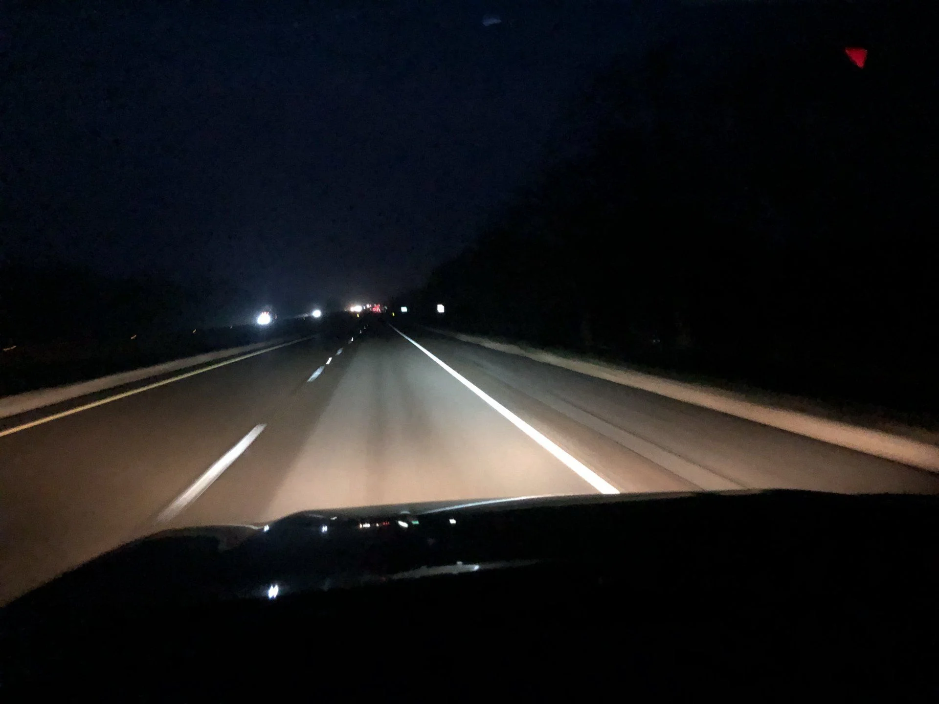

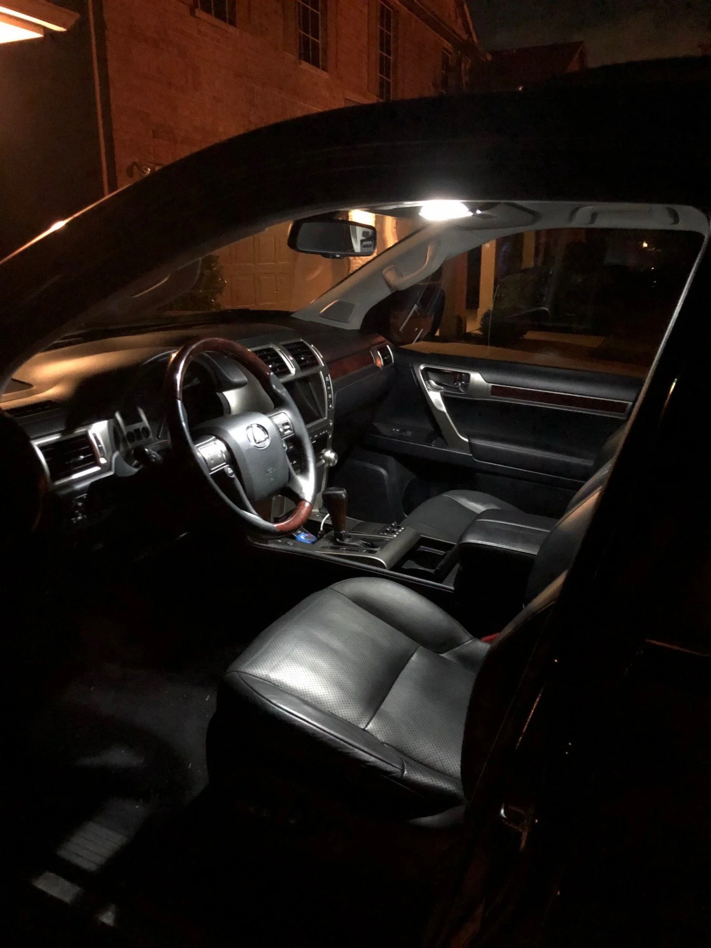

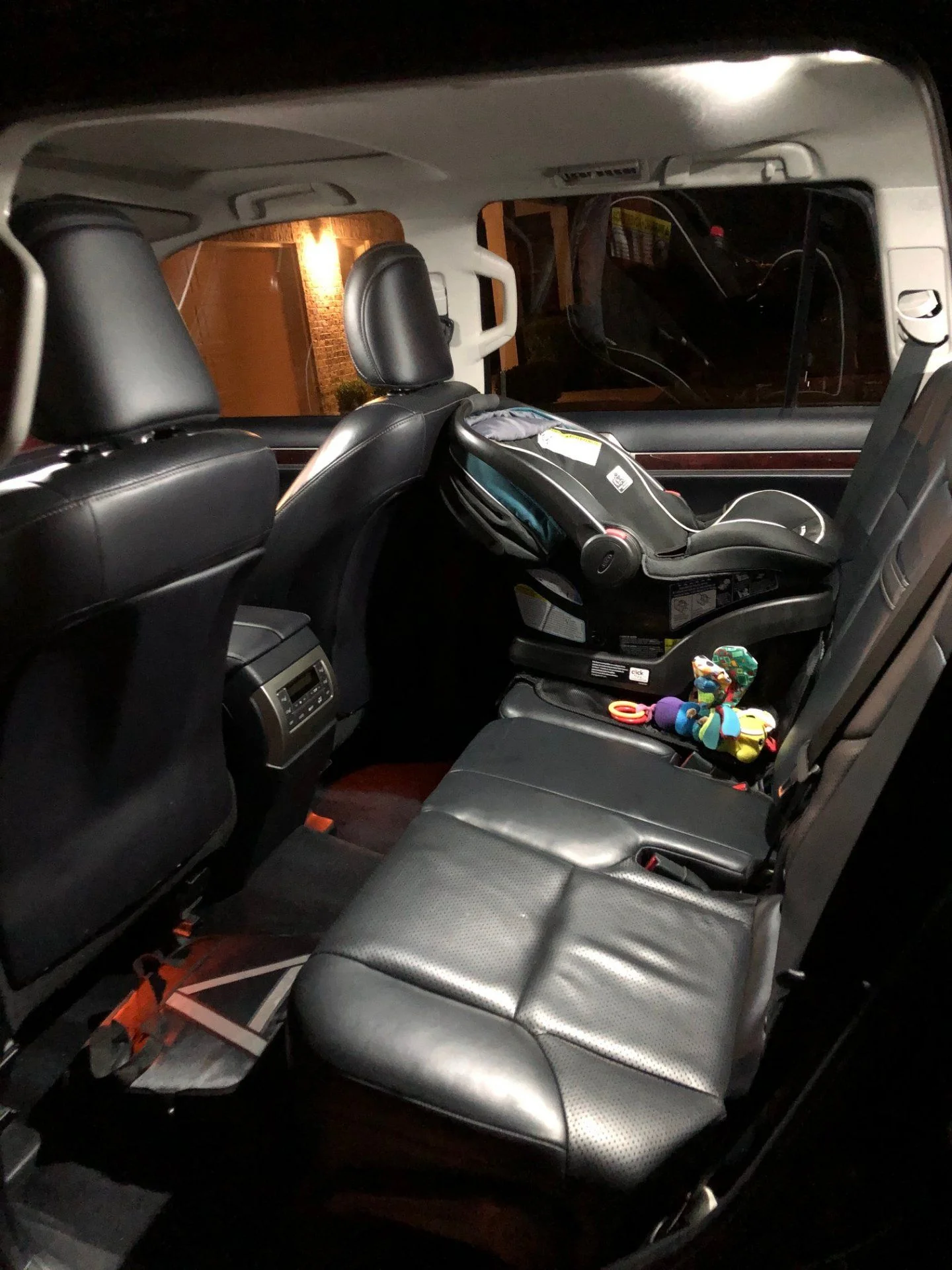

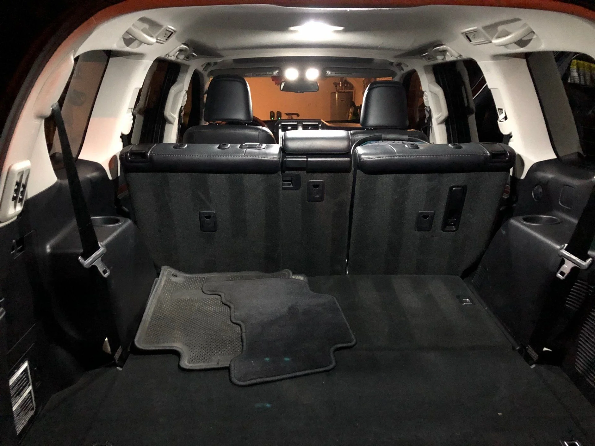

Next step was LED light replacements inside and out. Note to self, put the sunshade up on car seat so the baby's preciously beautiful blue eyes are not blasted with LIGHT. I'll also include my recent LED low beam and high beam change. What a difference this makes!
~80mph on I30, sorry for the blur. Blame the iphone and HDR.

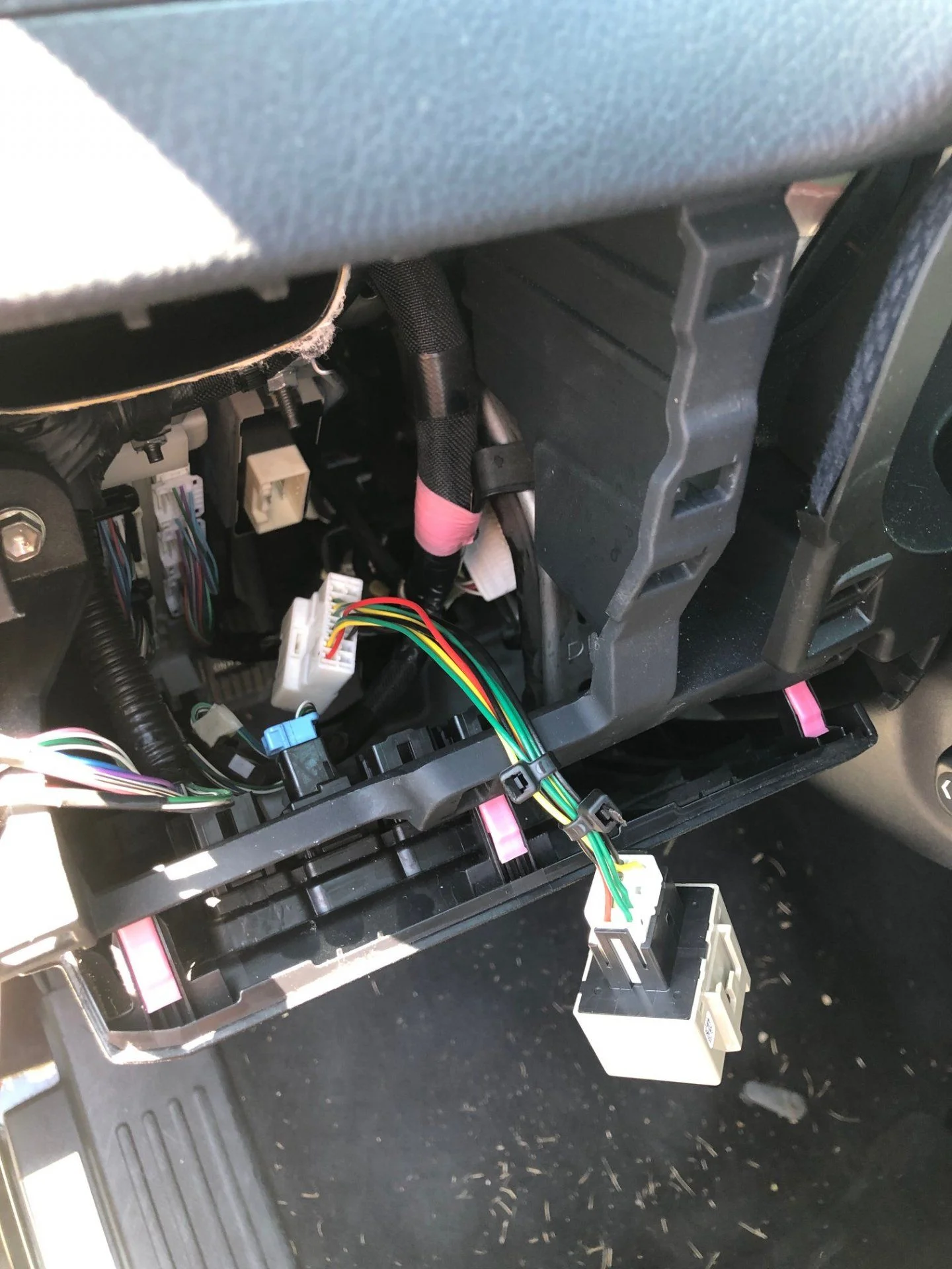

For the next step after the interior lights once we moved to the new house was tackling the hyper flash from changing out the turn indicator bulbs to LEDs. For that I built my own harness. I've got the materials to build two more but I may just hold off and keep these parts as spares.

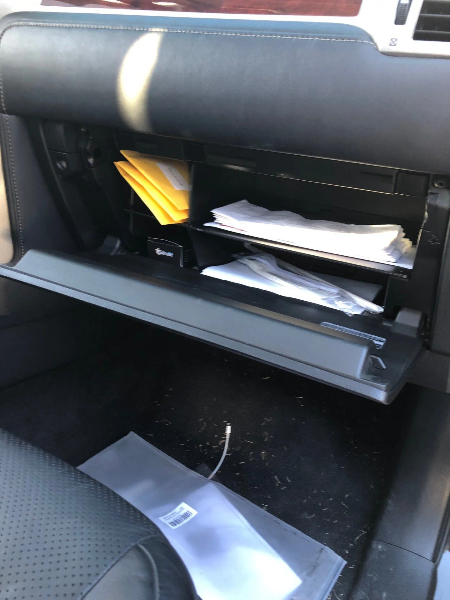

Lastly, installed a glovebox organizer insert...I just felt like it needed it to be useful. Sorry for the blur, I'm going to take another picture and replace this one.

Couple of things, where did you get your clove box organizer? Between extra first aid, HAM radios, frequency finder, manuals, etc. my glove is a mess, things always sliding out when I open it.
The other is that I love the super bright LED's in my rear bumper for backing up at night! I need to also add some proximity lights on the roof rack in the rear so I have more area flood lighting at night when the rear door is open.
They sell the organizer on amazon, it’s for both the 5th Gen and the GX. I ordered one a while back but I misplaced it before I could install it lol, I need to look for that over the holidays because it looks extremely useful.

@Tex68w got it, I purchased that glovebox organizer off of amazon. It is EXTREMELY useful and inexpensive. There is a 5% coupon on this item right now so I suggest getting one sooner rather than later. The plastic feels quite sturdy too FYI.

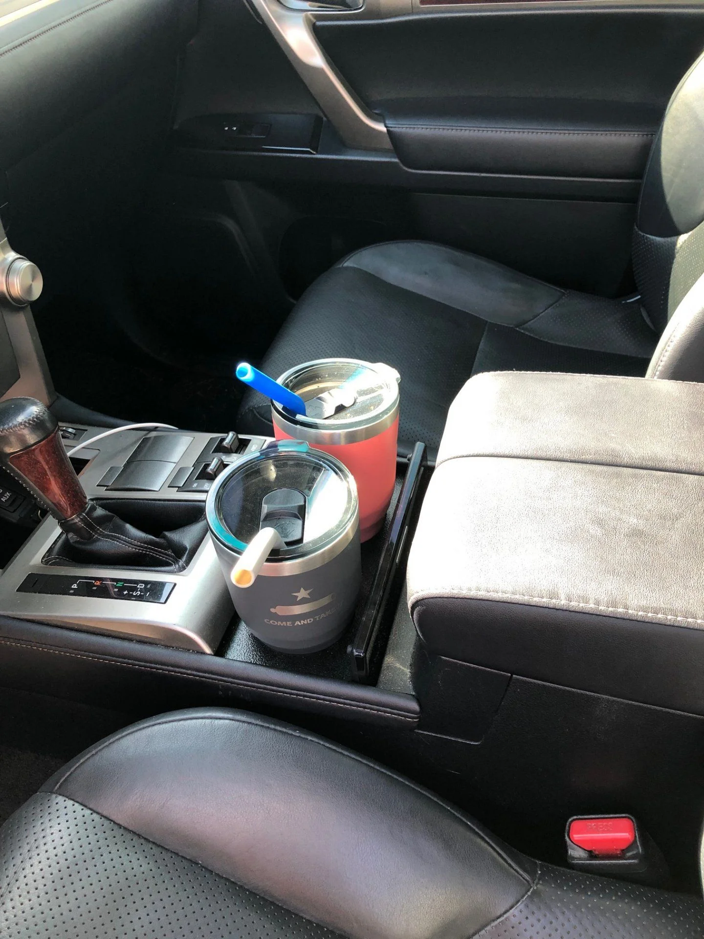

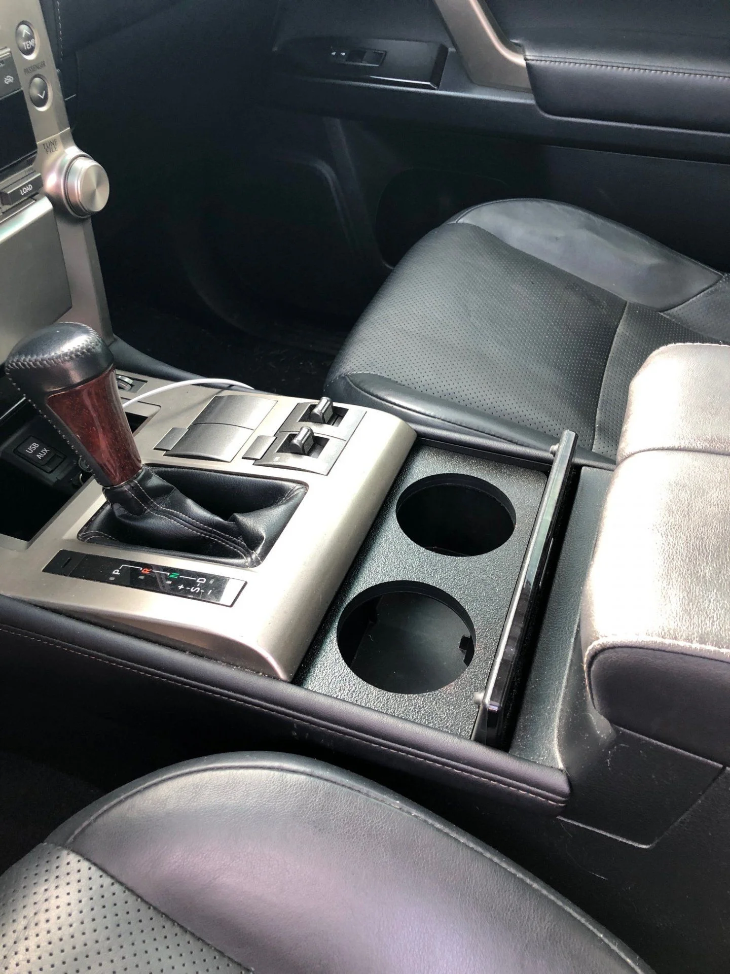

Forgot to post this, quite possibly one of the best quality of life improvements. We have one for our 470 as well. The 3M VHB double sided tape I linked to holds this thing in there very securely and handles fully loaded large tumblers with ease.
Great idea!
Can you still close the cover? Or is it too thick?
I could also see that as a simple wood shop project. Get a nice piece of 1/8" - 1/4" sheet of your favorite grain, a hole saw and a little varnish.
Oh, and don't forget the 3M tape!
I may make one! Thanks for the idea!
We recently added one in ours and I can't believe how much better it is with the larger Yeti cups. Good idea with the 3M tape, I'll have to do that.
Great idea!
You lose the option of being able to use the cover. I left the cover on there because it adds a level of rigidity to the cup holder insert. They are well worth it and quite inexpensive. It is in my opinion the best mod for a 470 or 460 for under $50.
I wish I would of paid the extra for the engraving but I'm satisfied nonetheless. Don't forget to use the VHB stuff, it'll never move. Even when it was blazing hot outside Texas style it wouldn't budge. Too bad you wouldn't be in my neck of the woods so I could let you use some of mine.
Oh yea, a reference pic with Yukon tumblers. Rtic also fits perfectly.
Good advice! Yea I figured why the hell not and paid extra for the logo. I agree that it's one of the best mods under $50 for the GX.

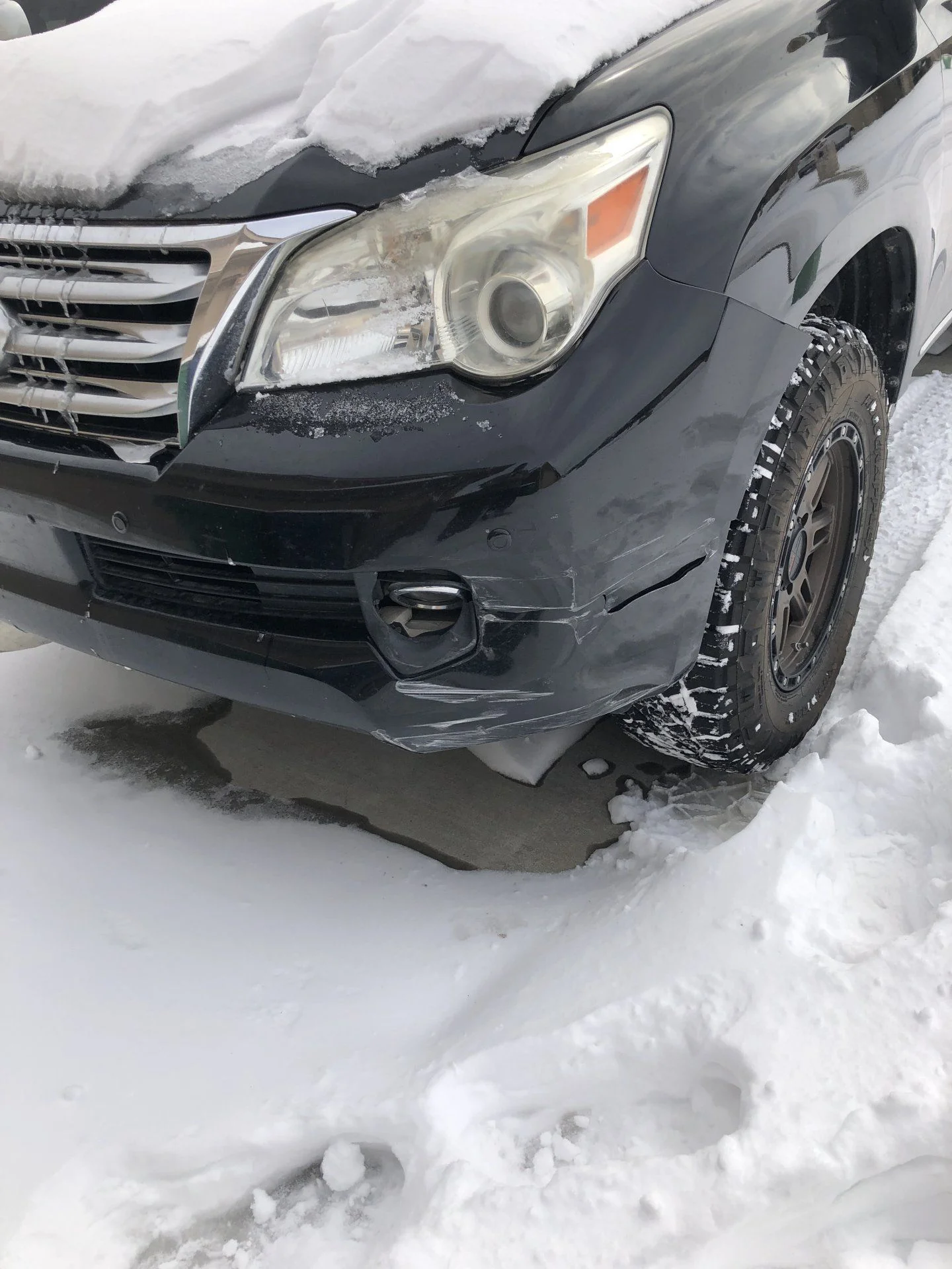

Well I kissed a guard rail @ 2mph so it’s time to think about off-road bumpers sooner rather than later.
Other than the metal tech, what other off-road bumpers require no cutting and is a direct bolt on replacement?
