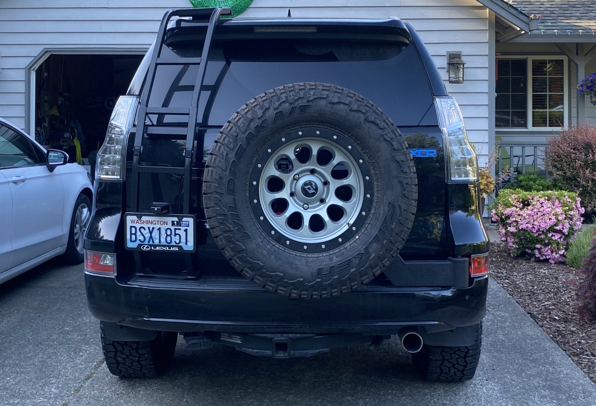

Thank you. I’m sure am happy with it. When the rig was stock and I was trying to envision it, wasn’t quite too sure how it would turn out. But I’m loving it now.
Yea it's hard to look at these trucks in stock form and see the potential. When we first got ours I had very little desire or passion for the build because they look so awful in stock trim. It'll never be the aggressive, rugged, manly looking SUV I want it to be but they do look a hell of a lot better modified.

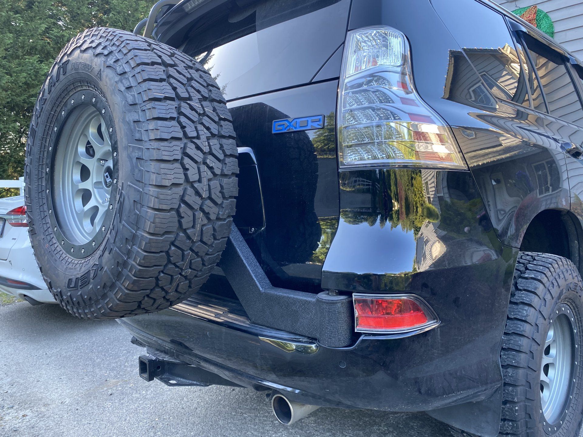

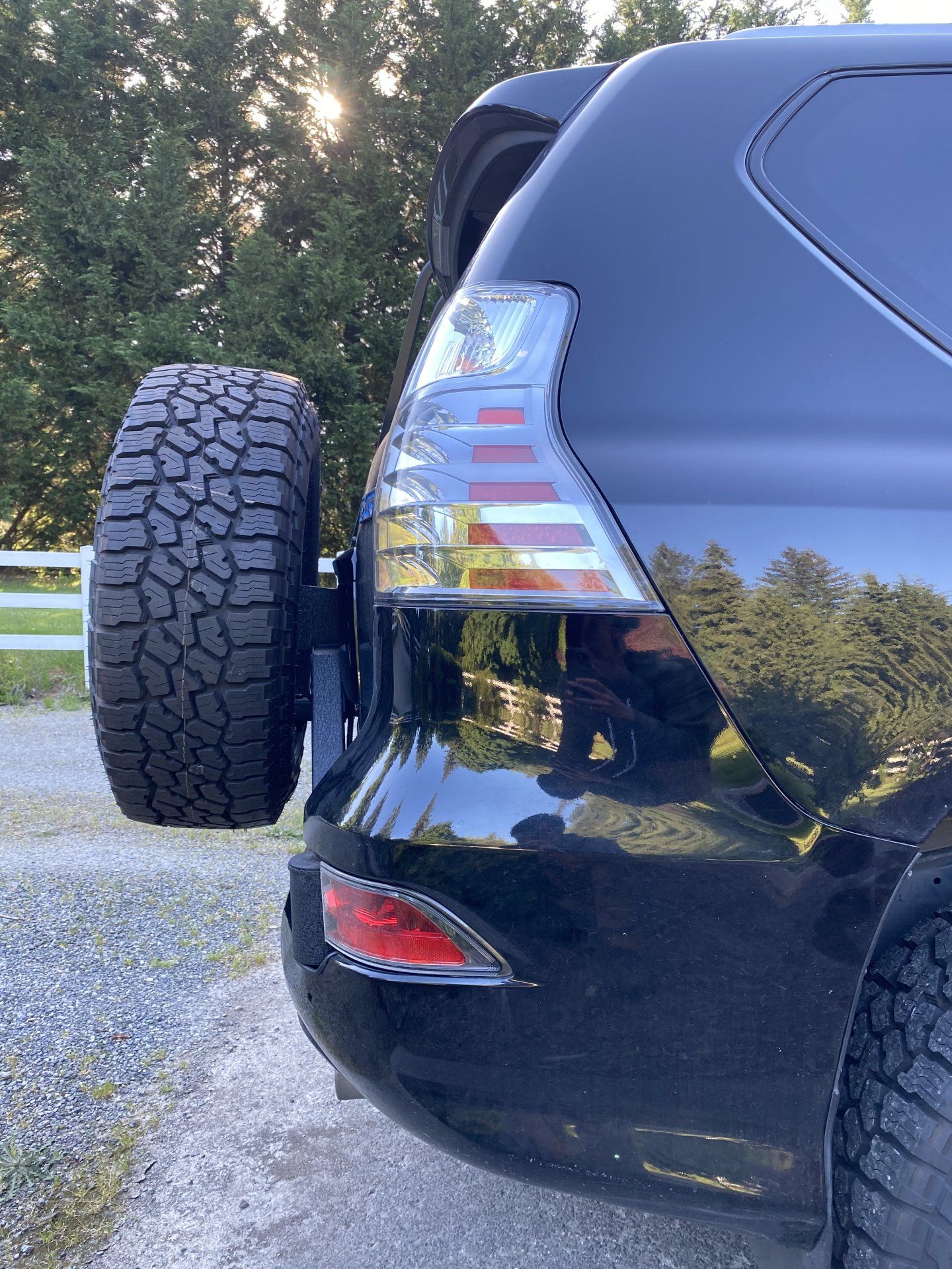

That is a very clean setup for a swing-out spare and keeping a stock looking rear.
I imagine you could also frabicate a bracket to the ladder to carry a Hi-Lift jack when needed.

yes that was my thought as well for the ladder. There’s also enough room to possibly do a mount on the other side for traction boards as well. Just have to figure out the details.

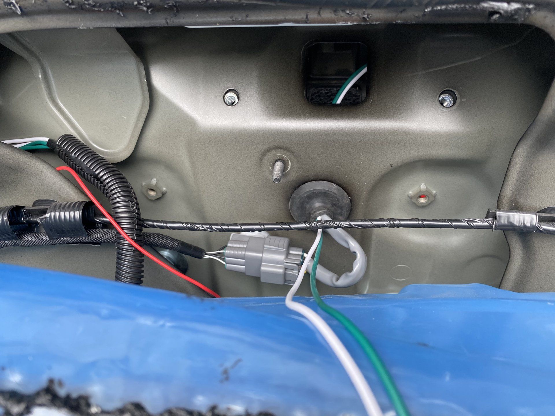

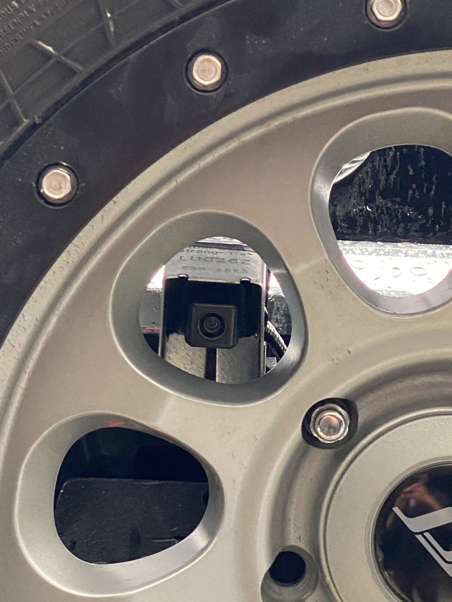

Got to extending the wire if on my back up camera. Had some 18g primary wire laying around just cut the factory camera harness where there was 4 wires and extended to the length I needed. I picked up wiring loom as for it all covered up and zip tied.

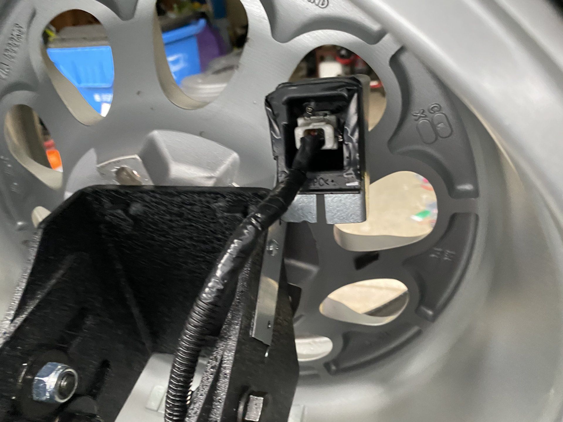

Went to Home Depot and picked up some Simpson strong ties that would/could work as a camera hood. Still need to move it and make a few adjustment before painting but it works. Camera still picks up a little bit of the rim but at least I can see what’s behind me.
Had to relocate my camera as well. I mounted on the bottom of my jerry can mount.
I first used an old USB cable I had lying around but the wires were too thin and had very poor reception.
Went to Lowe's and picked up a length of heavier gauge 4 strand wire and it works great!

This is just the old USB. I didn't bother to post when I swapped out the wire.

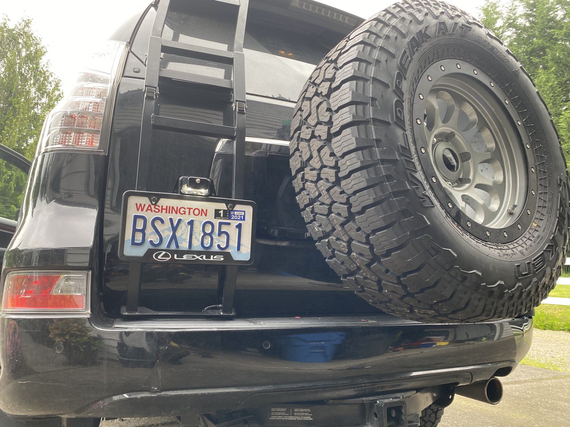

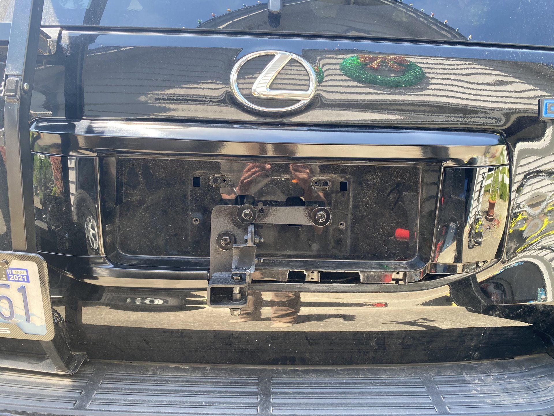

Just received a replacement license plate light. It works now! Got one off amazon for cheap.
LED License Plate Light for... Amazon product ASIN B07937BQYJ
Pretty easy set up. I simply extended one set of the factory plate light wires so that it was long enough to make it reach where I wanted it. I used solder heat shrink connectors and the worked out well too.
120PCS Solder Seal Wire... Amazon product ASIN B07S62KYSL
I also used a simple two wire water proof connector for the ends do I could unplug it if I want to move the plates. Right now it’s ok there since I don’t have a roof rack yet.

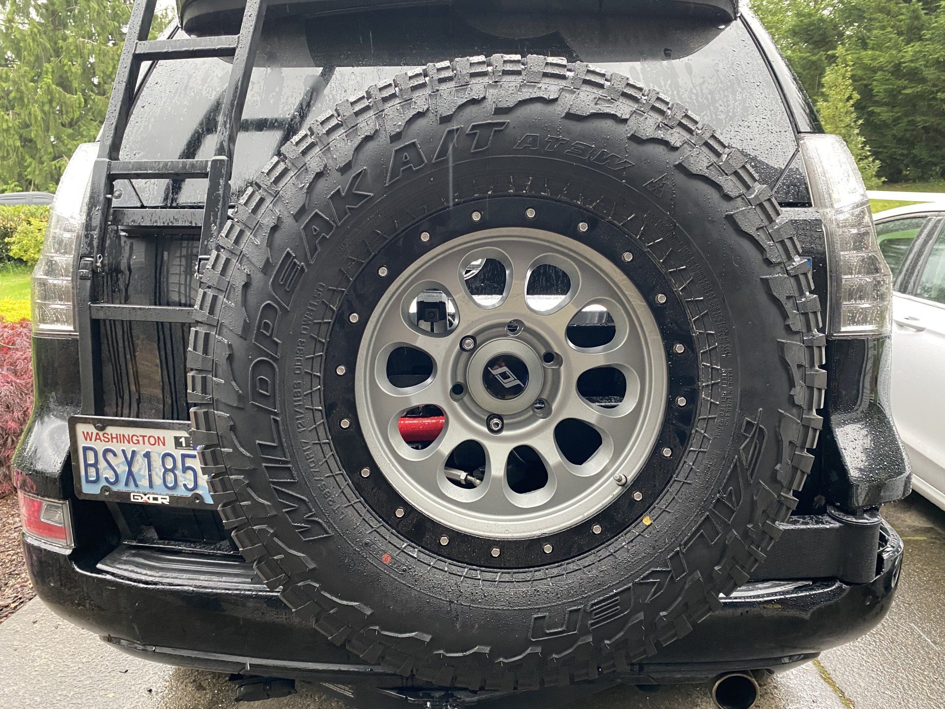

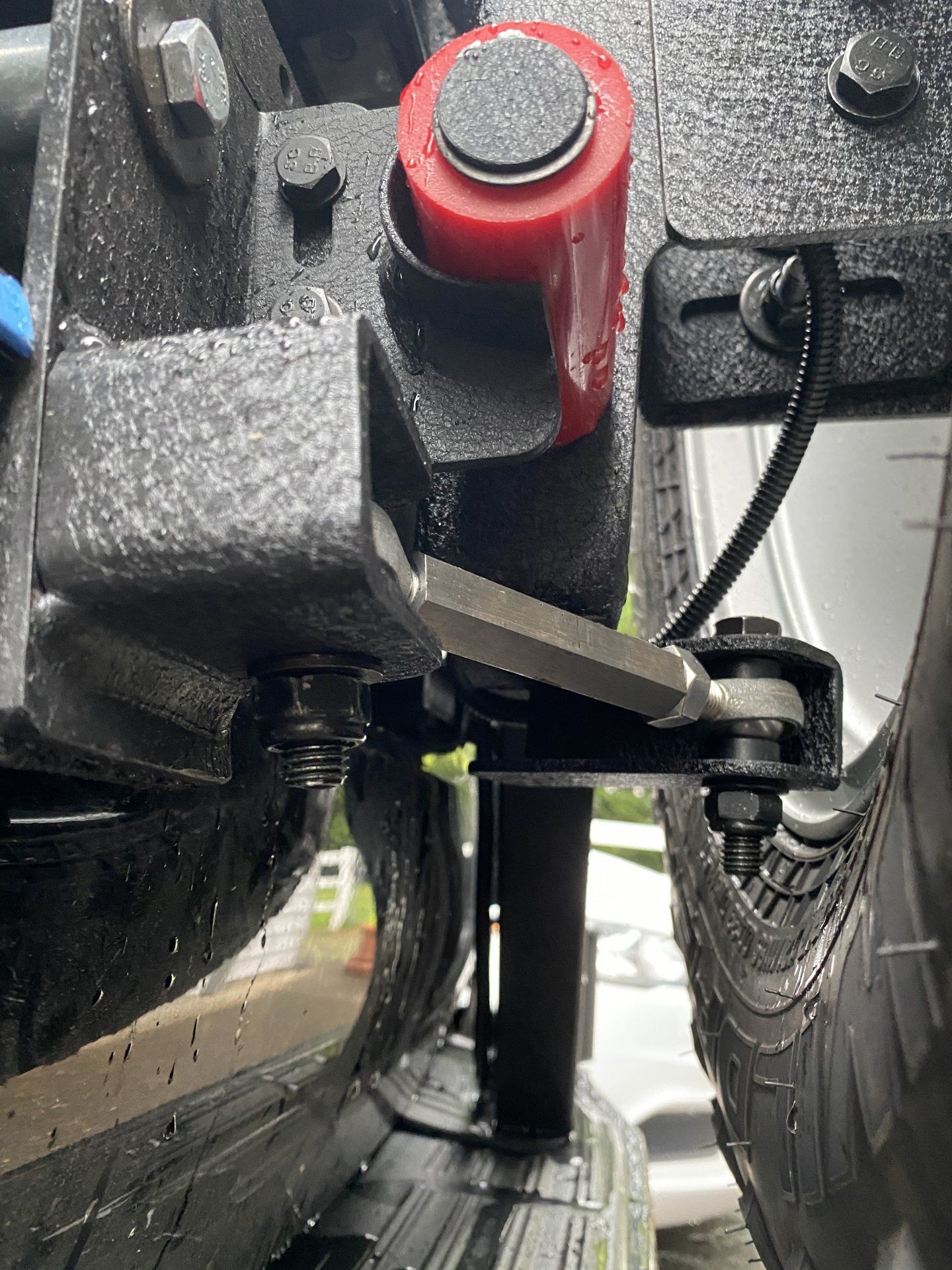

Just an update on the carrier. I added another set of bolt, bushing, washer and nut to get a another contact point for the hatch bracket. Now the carrier is extremely stable and almost zero wiggle up and done on the tire. I’ve also blacked out the chrome trim with black vinyls. Bonus was having a little extra time and I was able to take the band saw to the old reflector light to fill in the hole. It may not be the prettiest but it works for now.
That came out VERY clean!
