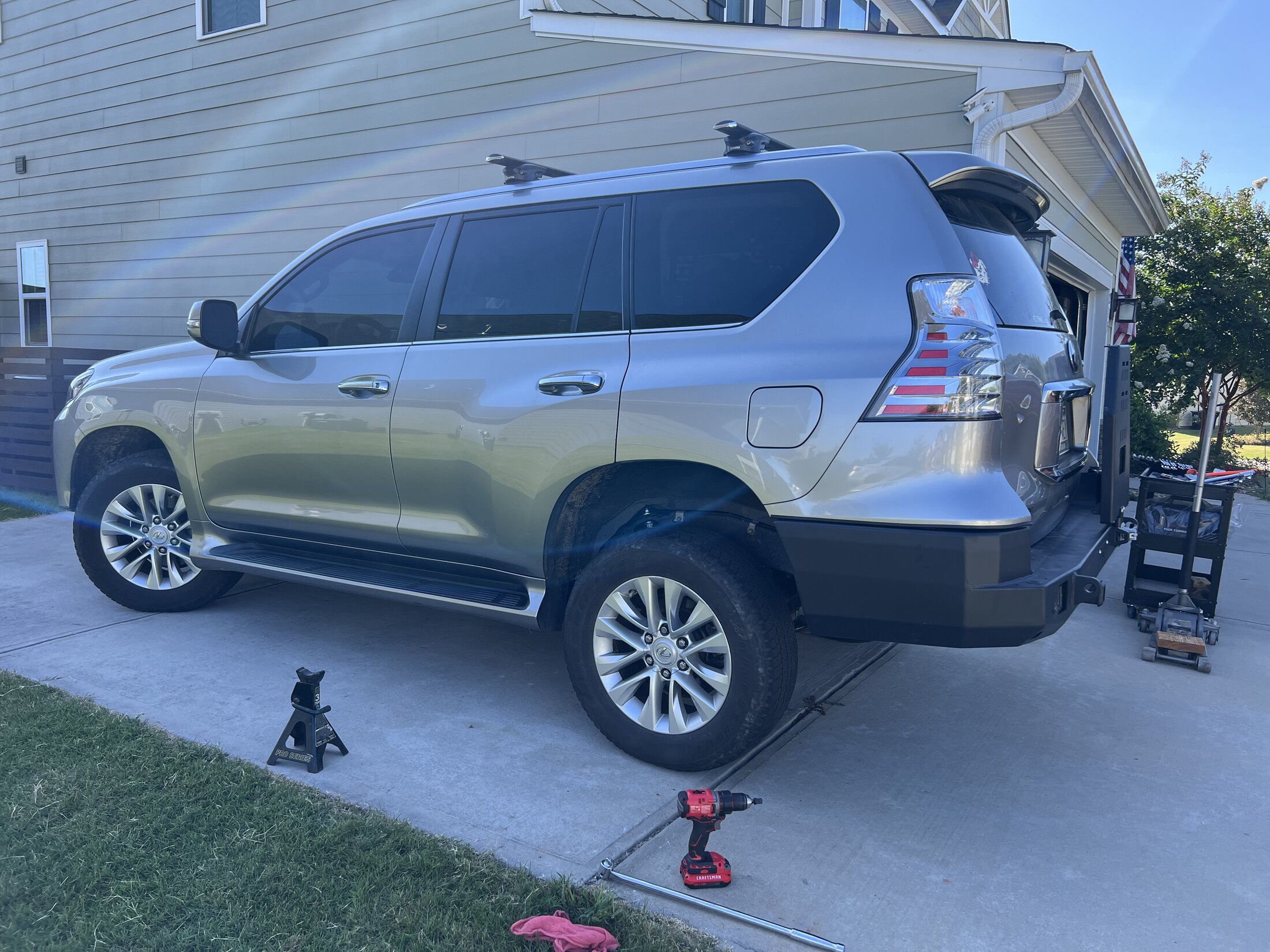

Alright, here’s the update: I’ve got the 2.5” Bilstein 5100s on, Victory 4x4 front and rear bumpers. Now I’m debating the best tire size. I plan on using the stock rims. Looking at MT Baja Boss AT 275/70/18 but not sure if that’ll rub or make contact with the stock front UCA? Seen a few posts where that might be a concern. Any thoughts?
Alright, here’s the update: I’ve got the 2.5” Bilstein 5100s on, Victory 4x4 front and rear bumpers. Now I’m debating the best tire size. I plan on using the stock rims. Looking at MT Baja Boss AT 275/70/18 but not sure if that’ll rub or make contact with the stock front UCA? Seen a few posts where that might be a concern. Any thoughts?View attachment 3952451View attachment 3952452CH]

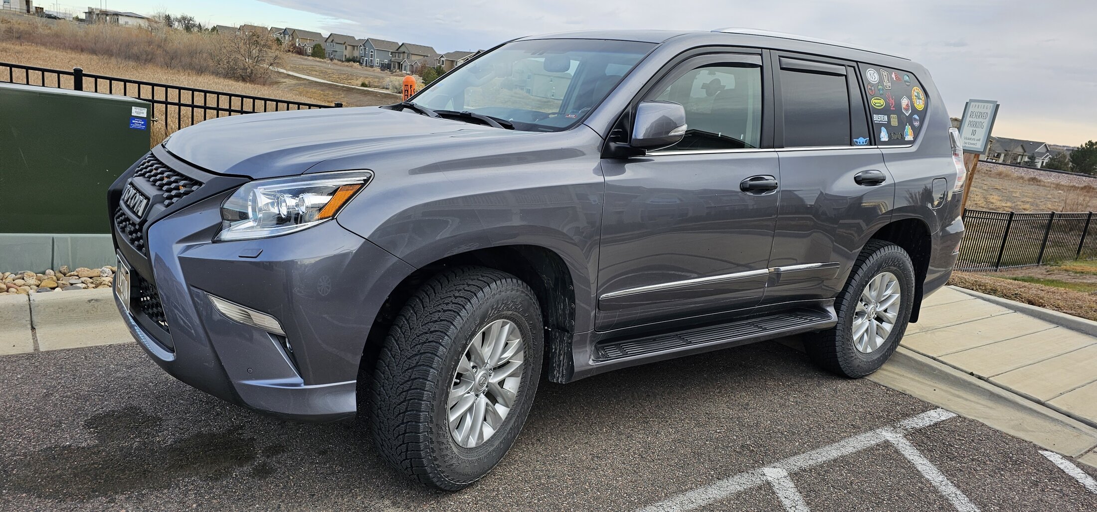

I have 275/70R18 Hakkipiletta snow tires. Do they rub, yes. Is it anything more than cosmetic, no. My 285 70r17s rubbed a bit that way and my 285-75r17s rub a bit that way as well. Usually under ver hard breaking. Not enough to even be able to find it on the tire.

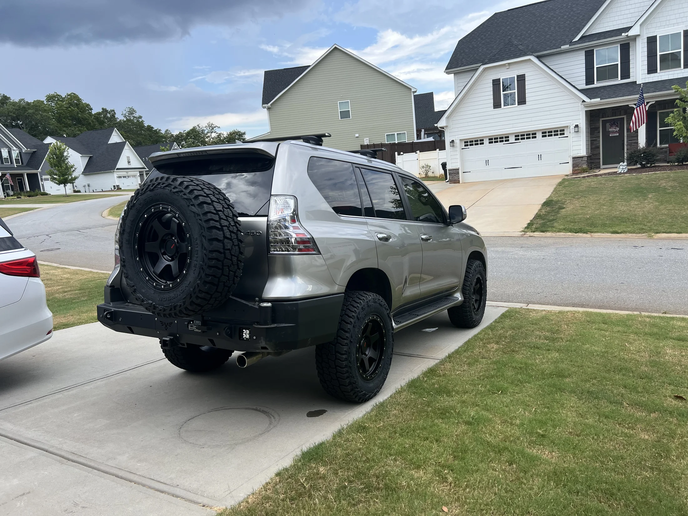

Well I’ve upgraded the tires and wheels (275/70/18 MT Baja A/T on -15 offsets) and I’m stoked but I’m getting more than just fascia rub…see pics (taken at maximum wheel turn). I did 2.5” rear lift and 1.75” front but I think if I bump the front to 2.5” (Bilstein 5100) then it might just clear without having to grind any metal. I also haven’t done an alignment yet, that’ll be later this week but not sure that’ll help in this regard.
Yes, thats a lot of negative offset for a 33. Those take way more scrub radius than my 34s on oem steelies that are + 25.
In a J150 IFS lifting doesnt increase clearance. That's something from solid axle trucks. You will need to push liners and for sure do a BMC with that wheel tire combo, and I pushed the big tire no BMC game further than anyone.
