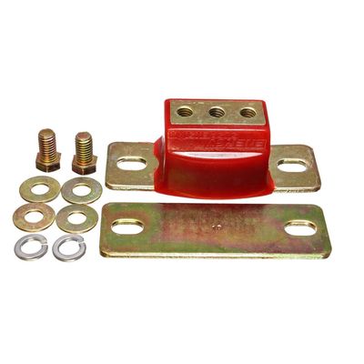

Had my first issue since I've started driving it this weekend. The two bolts holding the transmission crossmember in had loosened and fallen out, making for an interesting drive home. I got a couple of new bolts and put them in, but found out that the mount was stripped. Ordered a new one from my local Autozone. Moonshine will be down until Wednesday when it comes in.
http://www.autozone.com/autozone/pa...1y7rZ6o36u?itemIdentifier=354590_270987_5933_
http://econtent.autozone.com:24999/znetcs/psb/en_US/2/0/1574/egs17112.pdf
Napa has a completely different part number ( of course ) but the part will be in this afternoon. Booyah!
http://www.napaonline.com/Catalog/CatalogItemDetail.aspx?R=BK_7355860_0326937923
This is what the mount I'm using looks like:

Most recently you can see my problem. In this picture you can see the threads in the tranny mount, but when the new bolts went in, they pulled the rest of the threads out. Minor setback, but a relatively easy fix with a floor jack:
